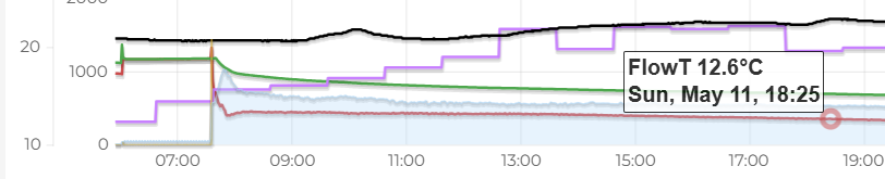

whilst cooling my flow goes as low as 12.5 degrees however return is circa 15 so somewhere in the middle. I haven't noticed any condensation anywhere Really impressed how well it works and am sure will be even more impressed once I get my solar installed if the G99 ever comes back!
Hi all, I have used our heat pump to cool house for last three days and I have been blown away how effective it has been. We have the 7kW Vaillant with UFH. It has dropped the internal temperature on the ground floor 2 - 3 degrees which doesn't sound a lot but it has made all the difference. Just wondered who else was doing this?
