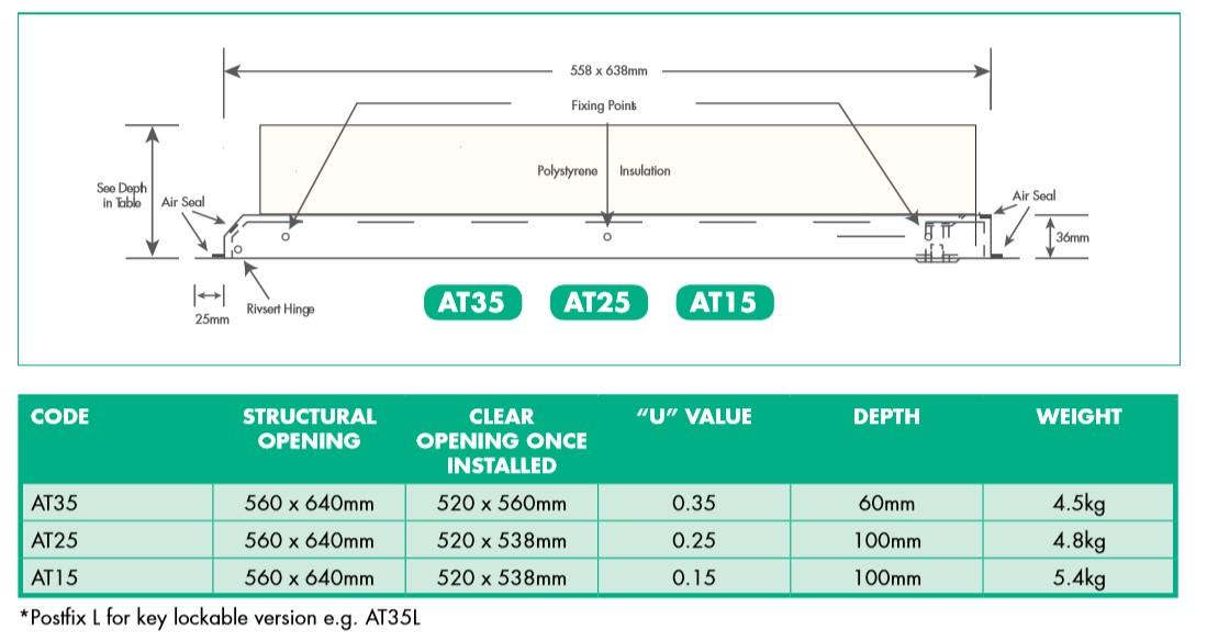

https://www.accessbuildingproducts.co.uk/product/air-tight-part-l-hinge/ Jt -
Loft hatch and ladders for timber frame passive house
JtG replied to kaye's topic in Lofts, Dormers & Loft Conversions
I know there has been a time delay - but I too am fitting an airtight hatch and found this product which seems to have better U values than the option discussed already. Is there a problem with it please? Here is the description: Airtight at 600Pa of positive or negative air pressure (12 x the standard required) GWP and ODP rating of zero Exceeds NHBC requirements Spring loaded “easy to open” high compression catch Inner & outer neoprene memory draught seals Invisible pre-fitted hinges for a quick easy installation Robust long lasting zintec steel design Smooth white satin powder coated in RAL 9010 Slim frame for contemporary unobtrusive aesthetics Projects into the ceiling space a mere 2mm Air seals without the use of sealant or caulking Three models exceeding Part “L” -

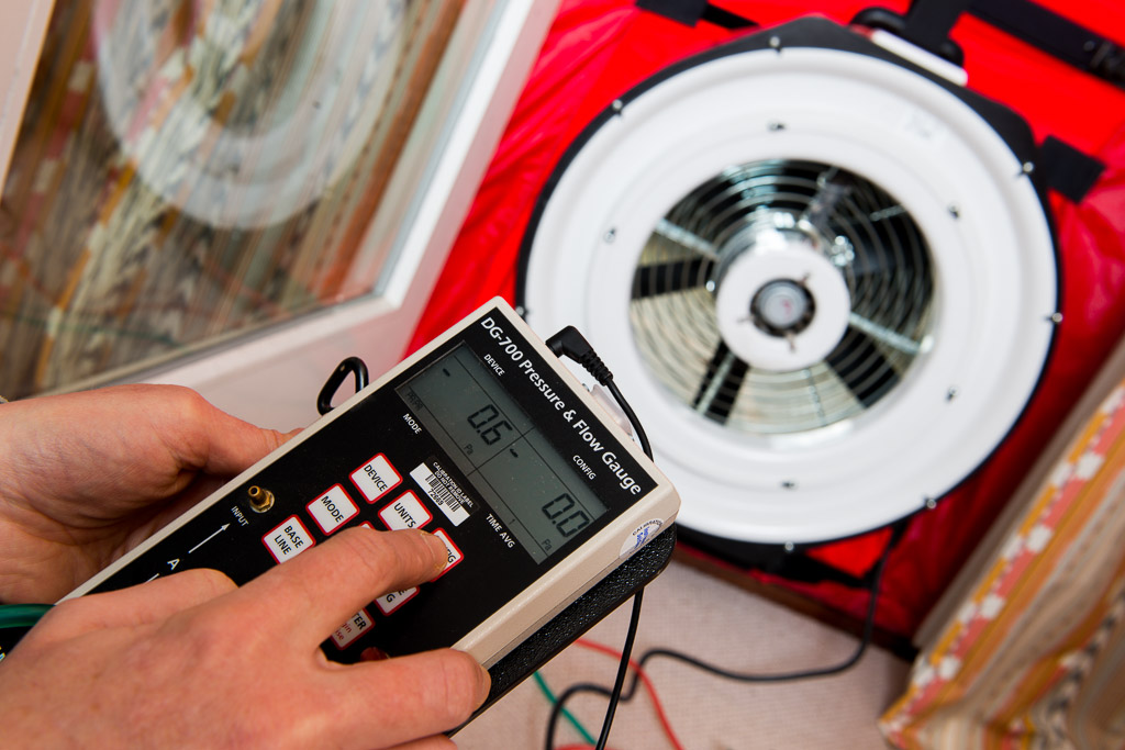

I think it's running around inside - as the outside air moves to replace the inside air that the fan removed?? -

May I have the contact please? Also what was the scope of your final report if you don't mind? I'm wanting to finish up with data for a whole house retrofit plan. It's strange. I've had 2 other quotations for thermal imaging that were in line with mine -
I'm trying to arrange one for my house but need one or two other properties to justify the expert's journey. WHY WOULD YOU WANT ONE? They measure how well a house holds onto to the heat and where it's being lost (Bring out the insulation foam and tape!!). This is the basic data on which you can decide how to upgrade your property with insulation, heat pumps etc. HOW'S IT DONE? First the warm property is sealed up; Next a fan is fitted in the front door to suck out some air from inside; Then using a thermal camera you can see the flow of cold being sucked into the property. WHAT DOES IT COST? £600 for four hour test plus cost of travel WHO WOULD DO IT? ( link removed by moderation team ). She knows I am looking to put together enough properties to come to this area so contact her or ask me
