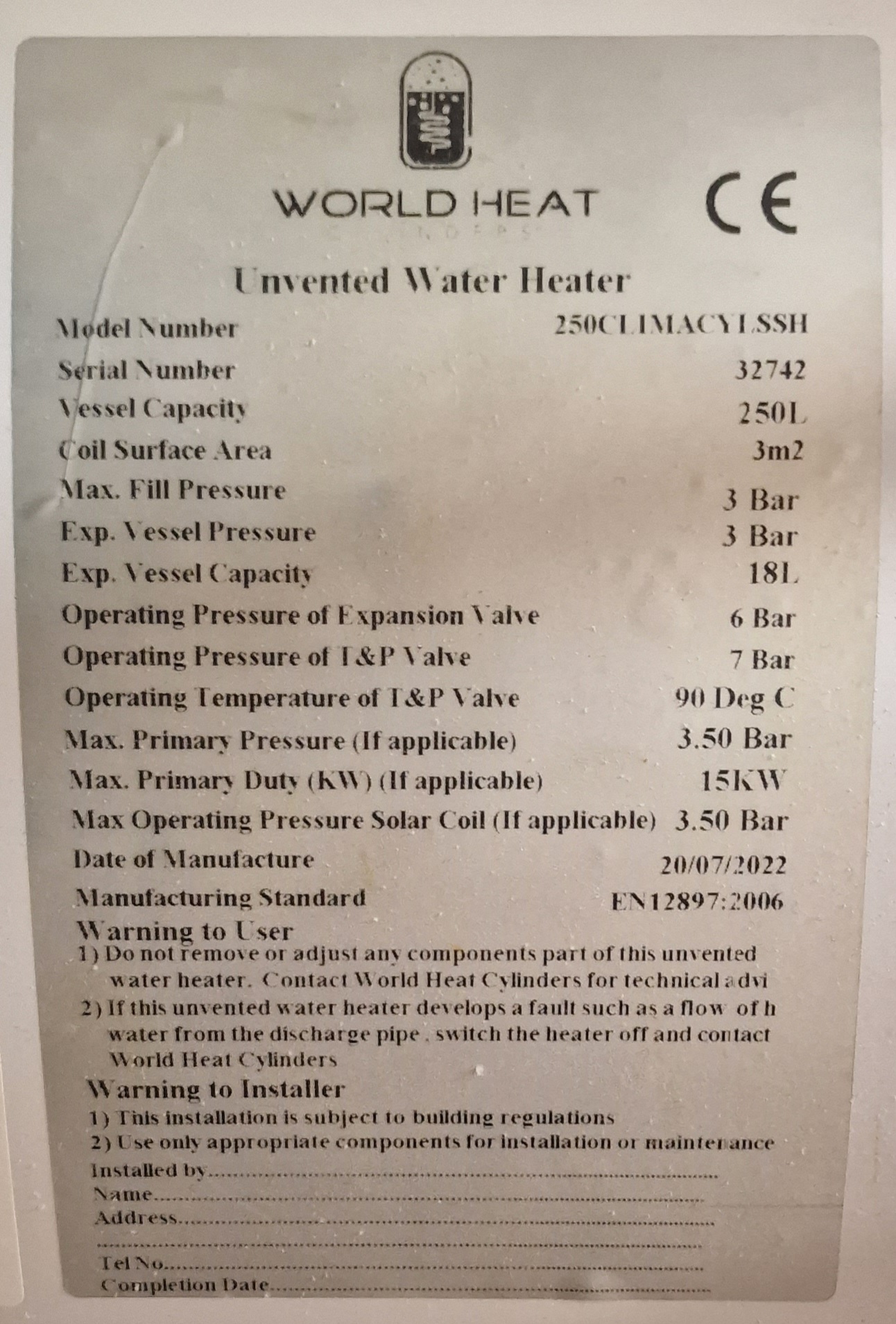

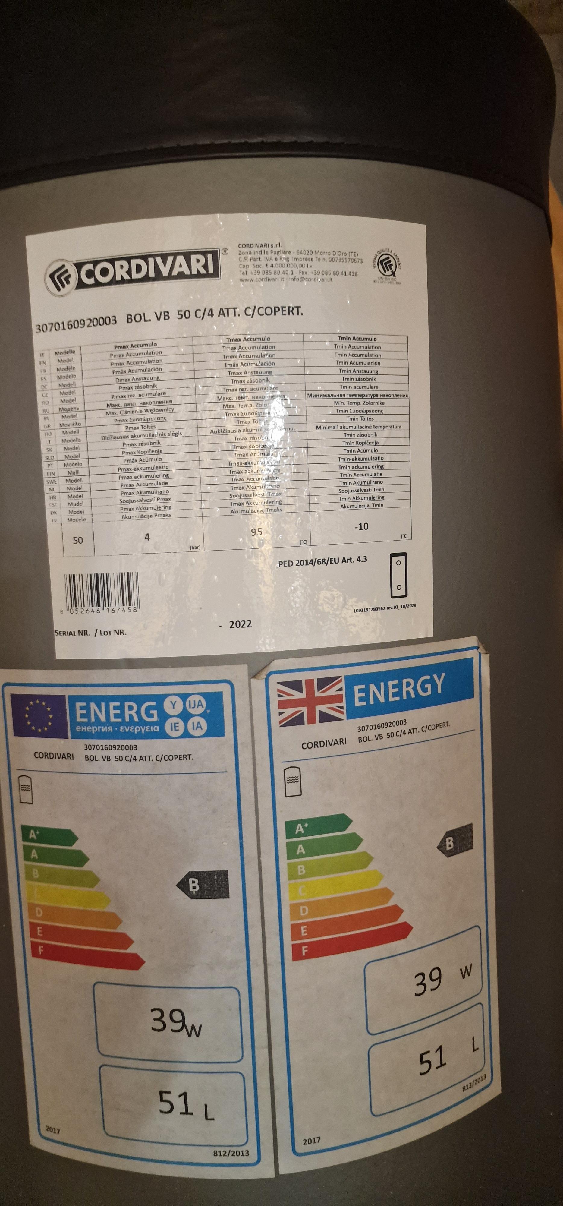

  1. Thanks for all the responses. I'm not sure whether my two tanks ( not including expansion vessel )are top rated tanks. The smaller ( 50L ) of the two is B rated see picture label small tank and the other larger 250L tank see picture large tank. It was installed in December 2022. The pipes are all covered and buried in 400mm loft insulation. The tanks just sit above it all on a raised platform. So it appears all is as expected and the temperature loss is normal. Any thoughts about the noise issues?

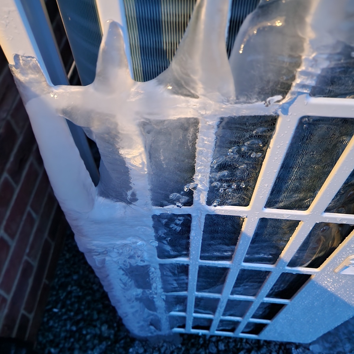

  4. Thank you all. I poured some tap water over it for a few minutes to de-ice it. Only a couple of fins are bent ever so slightly. I hope this doesn't impact on it working as it should? Thanks

  6. My newly installed ASHP Mitsibushi Ecodan has unfortunately been sprayed with tap water from a cracked outside tap after the current cold minus temperatures. I could hear running spraying water and looked outside to see one side of the unit covered in ice an inch thick. My question is. What should I do? Leave it to that naturally, which at the moment will take ages? Turn it off all together? Poor very slight luke warm water over the side - no electrical wires or connectors on that part? The fan isn't inhibited and is running just fine, however I think it sounds more noisy at the moment. Any advice would be very welcome. Thank you
