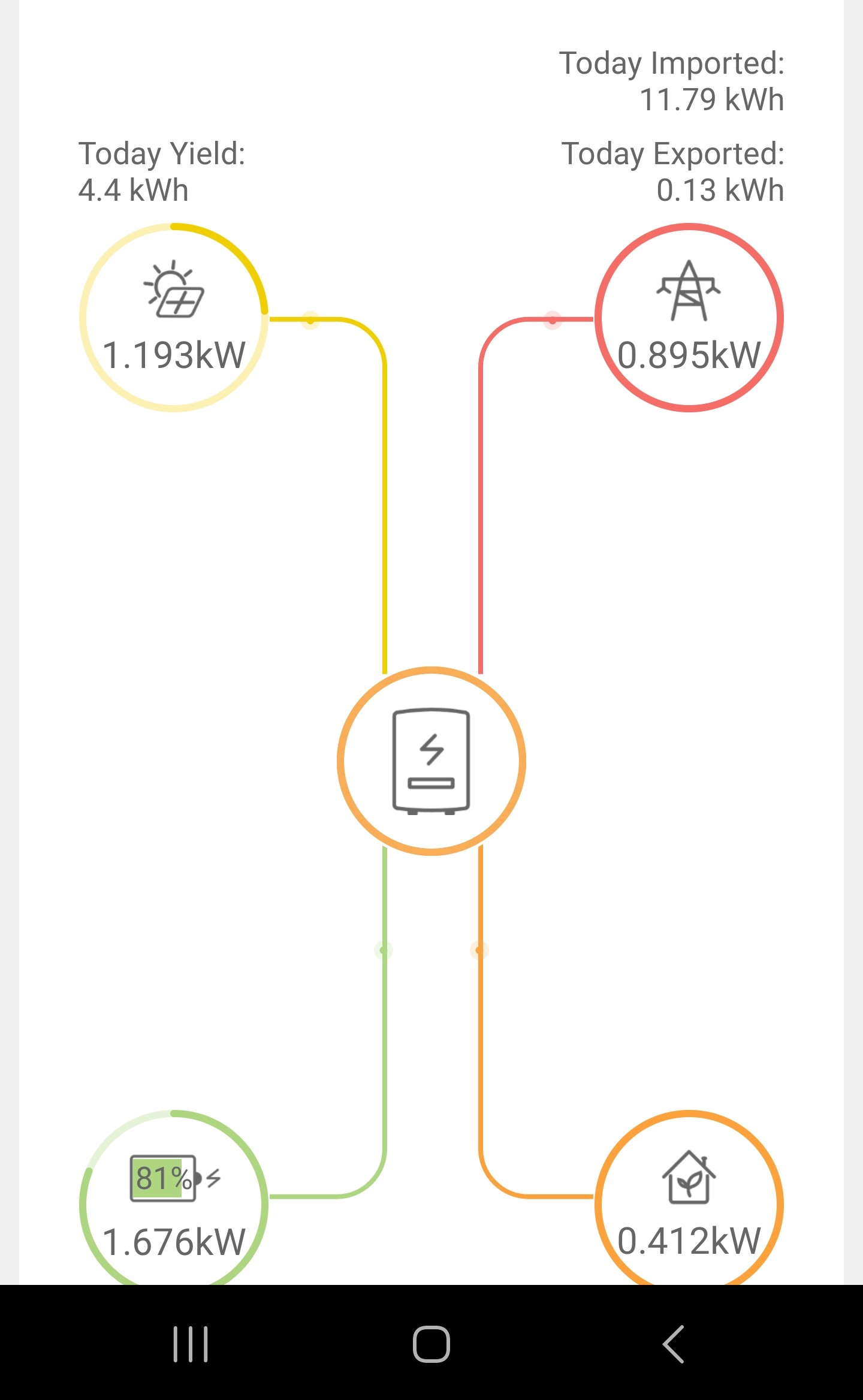

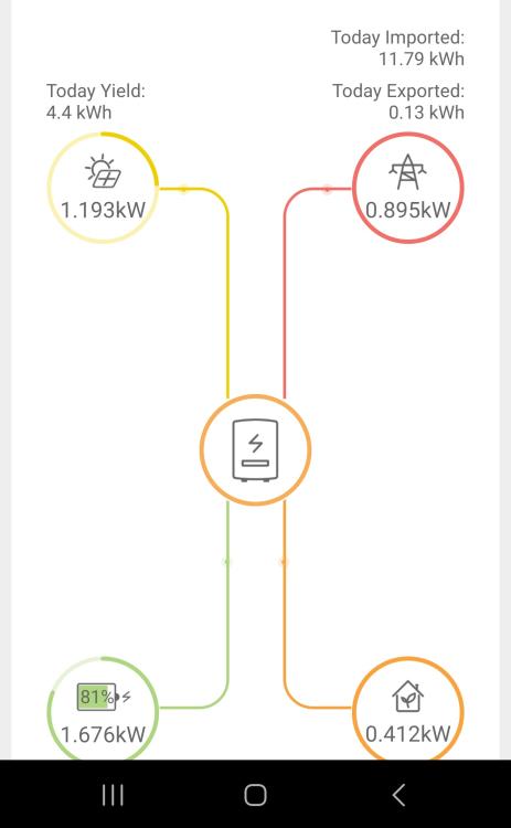

Hope you don't mind me jumping in on this thread. My installation has a Solis inverter and Pure Drive battery. The Solis Cloud Monitoring App shows that all PV generated power always goes to the battery both day and night. This indicates that there is no self use energy being generated albeit the solar charging of the battery in effect is doing that but it suggests that the battery is constantly being charged as first priority to provide solar generated energy. Does that make sense? I thought the order of generated solar power was; Self Use, then Battery charging ( when self use needs were met at any given time ), then back to the grid (if self use met and battery was full) I'm unable to get any assistance at this moment in time from the installer. I've attached an image to show the predicament. Thank you
