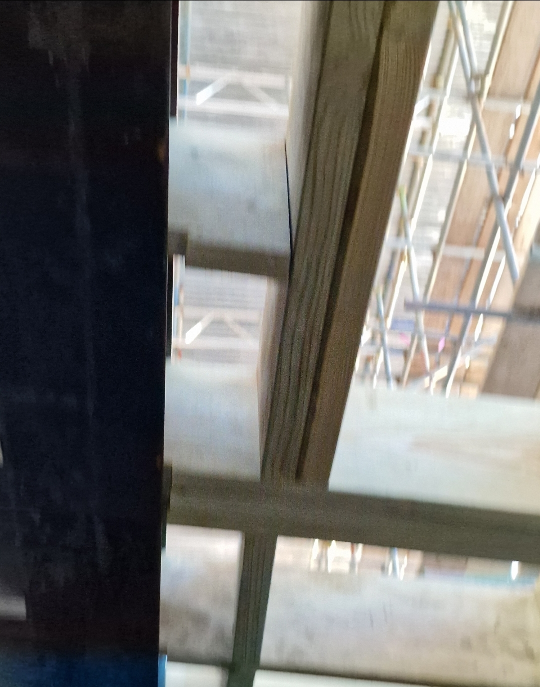

  1. The brickies have built up the inner leaf of thermal blocks slightly inwards to meet the inner leaf of the old bricks which were 115. This means the wall plate sits on the corner end of the new extension inner leaf on full thermal bricks but where it joins the old house sits only on 50% of thermal blocks, with other half hovering over cavity. My worry is that the weight of the roof joists may cause cantelevering into cavity. There are dwarf walls about 80cm in from the eaves. But not sure sufficient to

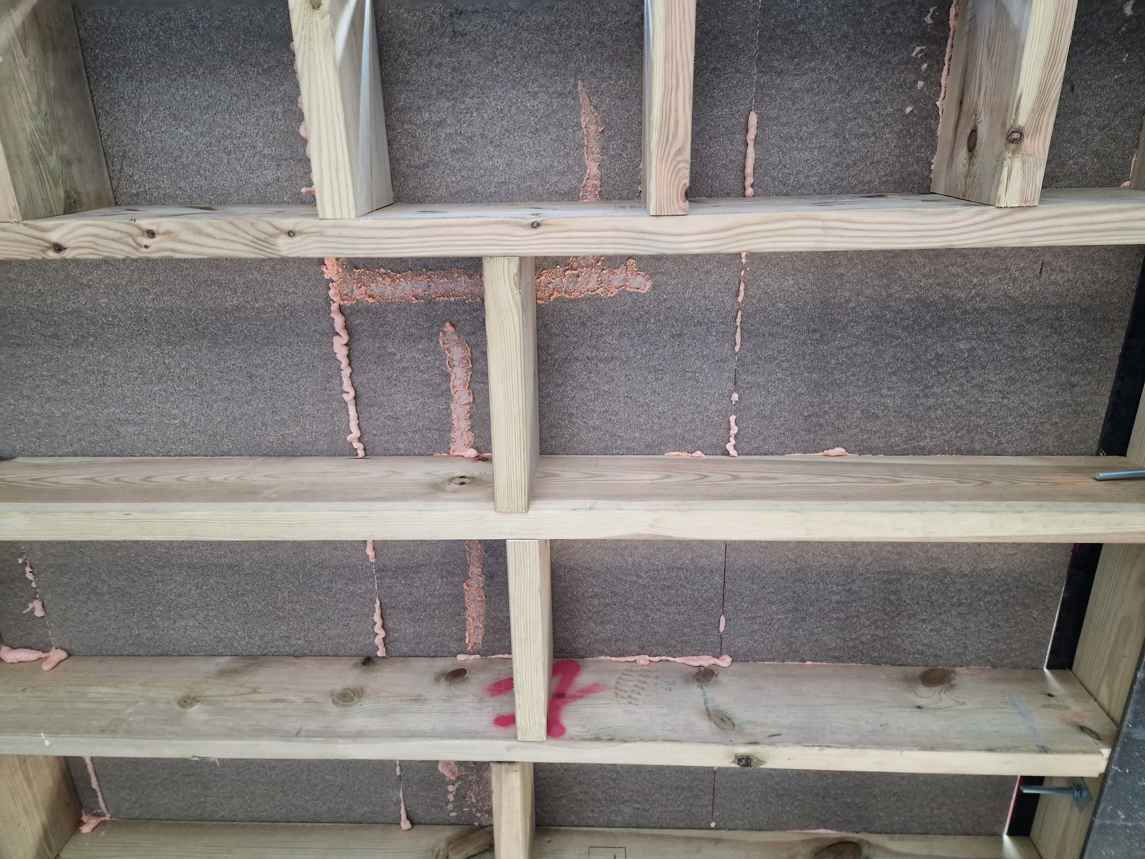

  4. Yes engineer happy...but couldn't get over the noggins being loose. I thought screws were not as good as nails here due to lack of lateral strength?

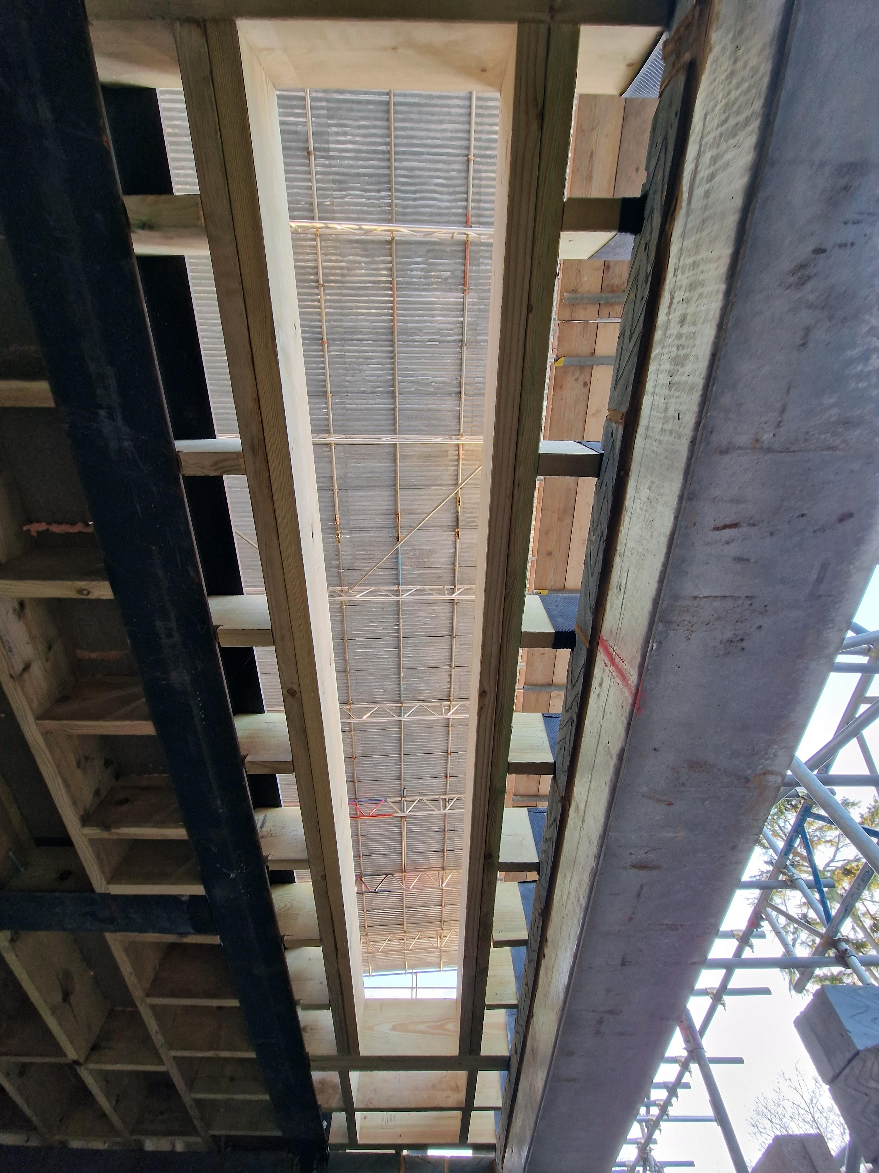

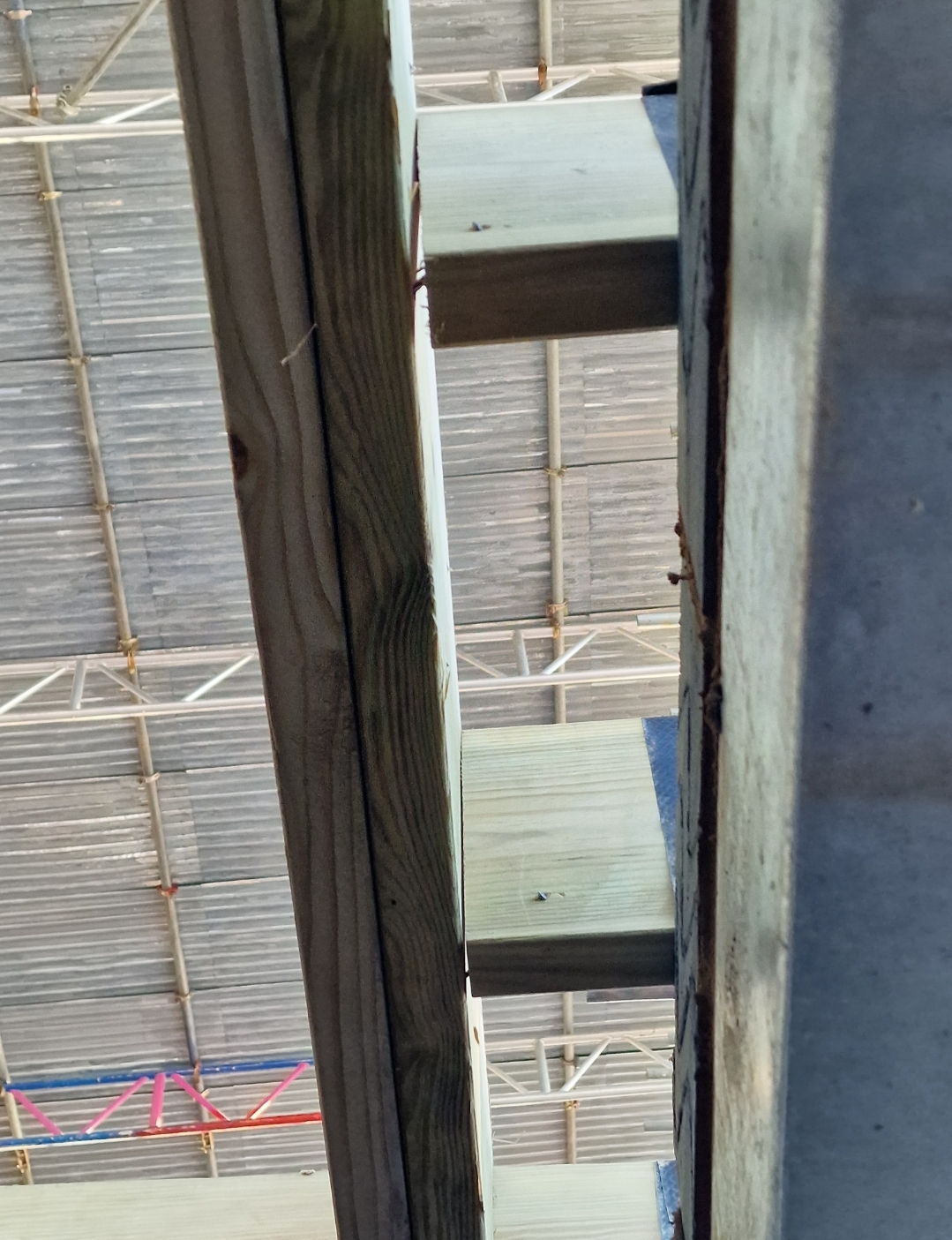

  5. I have a 3m x 0.45m flat roof skylight on ground floor within a small width flat roof ~ 80cm ( 2nd floor setback behind parapet above). Engineer has specified doubling joist on width and longitudinal run, builder on widths has tripled for further strength (as per photo) But I can't reassure myself whether on such a large run the triple joist will take weight without significant deflection. There are 7 ~ 16cm lengths of cut joists/noggins in-between as per photo, one side sit into steel and the other resting on inner leaf of brick work. These are simply nailed in. Are these too short a section to provide further structural integrity when loaded or are purely to dress the roof.
