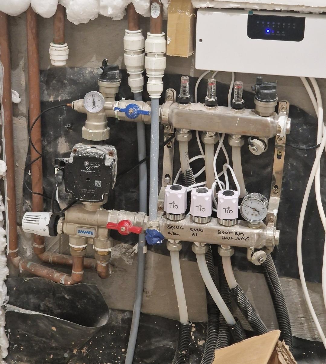

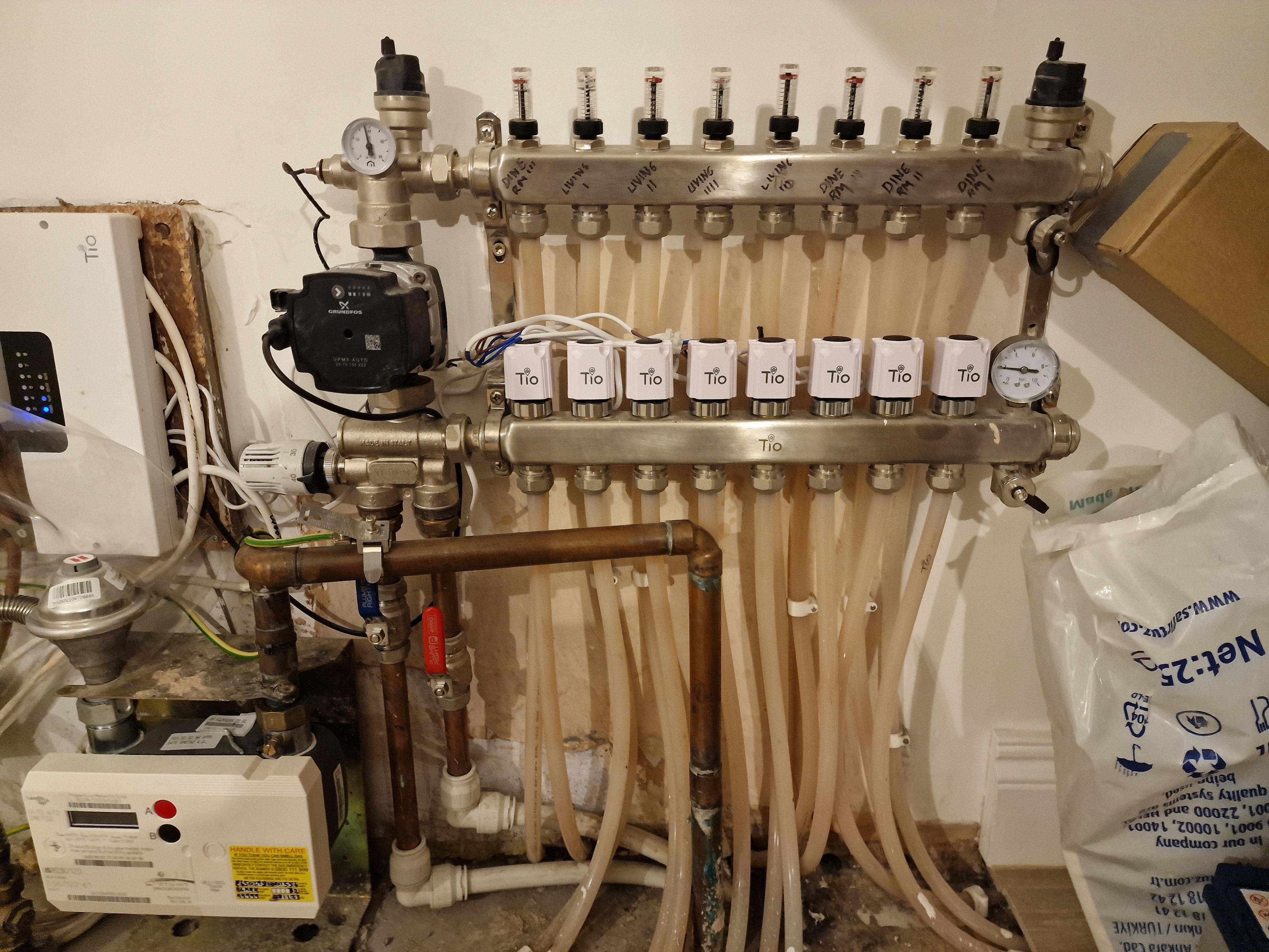

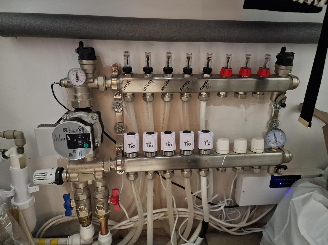

Oddly,out of 4 manifolds , one of the piping have started to show brown discolouration. See below. Using heat gun there does not seem to be any leaks on any of the runs to suggest contamination from tiling glue. So thought maybe corrosion...but why is this occurring in just 1 manifold and not all...or could this be contamination from small leak. Not sure of inhibitor was used on any of the ufh manifolds

Good suggestion Dave, guess a bit late to do that now. Why is the temp warmer on the first config reading on the circular thermomemter, is it because it's not having a valve stopping entry? -
Have 4 manifolds in my property for a wet ufh...3 of the manifolds have been fitted with the hot and cold valves before the pump and one with the valves after the pump. Not sure if there is a correct way and why it has been done in the 2 different ways as manufacturer spec suggests the former. The latter config u can feel hotwater being fed to the manifold even when not running but on other not...otherwise performs well. See photos
