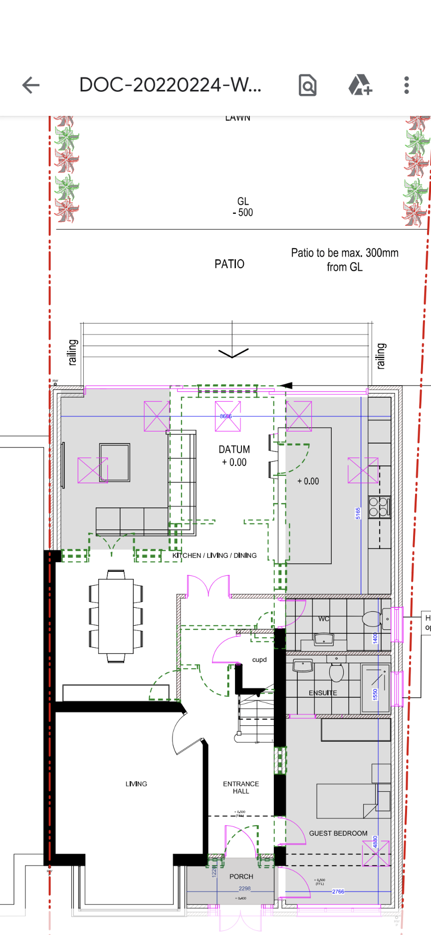

Wet UFH on ground floor suspended floor. Marriage with an extension
DCG replied to DCG's topic in Underfloor Heating
The grey bits are all new. The bit where it says DATUM will be demolished and absorbed into the open living area so will not be suspended floor. The entrance hall, living room and part where dining table and chairs are shown are all on suspended floor. Would be grateful for advice on: 1. Air bricks at the back of the house. Do I need to create a tunnel to the end of the patio (patio extends 5m beyond sliding doors) so that air can enter the void? 2. How to create the insulation for the suspended floor and lay UFH on top. 3. Is is reasonable to wish for uniform heating and cooling of the ground floor given we are marrying two floor types. 4. Optimum number of zones for my ground floor. 5. Should I have hive or similar controlling the upstairs radiators and downstairs towel rails. And UFH controls for the UFH zones? Thank you! -
Hi folks I am new here. First post To introduce myself, I have planning for a double storey side extension, full width rear extension and partial first floor rear extension in NW greater London. I am looking for some advice on how to get wet UFH on the ground floor. It's straightforward enough for the new bits of the ground floor but the existing bits of the house are on a suspended floor above a void. I think the void is probably around 300-500mm but probably closer to 300mm. I say this because I have seen some of the void depth at the back of the house when running some new power cables 5y ago. The house is on a flat road so I assume the same depth at the front of the house. My issue is how best to arrange the UFH on the suspended floor. What to do with the void? How to avoid a creating thermal bridge? How to keep air circulating assuming the back of the house will not have any void? Ideally, I would want the whole ground floor to warm up and cool down uniformly. Is this possible if you are marrying a suspended floor to an extension floor? The UFH in the extension will be laid in screed, is this the case for the UFH on the suspended floor too? I want the screed to act as a uniform thermal store and release heat evenly across the ground floor. My friend has UFH laid on a suspended floor. He says his builder filled the void with rubble (!) and then celotex type insulation, then UFH pipes, screed and tiles. His project only finished earlier this year so not really enough time for any issues to present themselves. Is this an acceptable way of doing UFH on a suspended floor? I have heard that filling the void with rubble is a very good way of cutting air circulation and introducing rising damp through thermal bridges. Obviously, I am very keen for the UFH solution not to be heating the void under the floor and instead sending heat upwards. I'd be grateful for anyone who has seen this issue to give some advice on how to correctly go about getting UFH. If it means I have to keep radiators at the front of the house to avoid issues, I'd rather do that than do UFH incorrectly and store up a problem for later down the line. This is a project to create a forever home. I want to get it right first time and happy to spend money on doing it correctly (although there is obviously an upper end to my budget!) thank you folks
