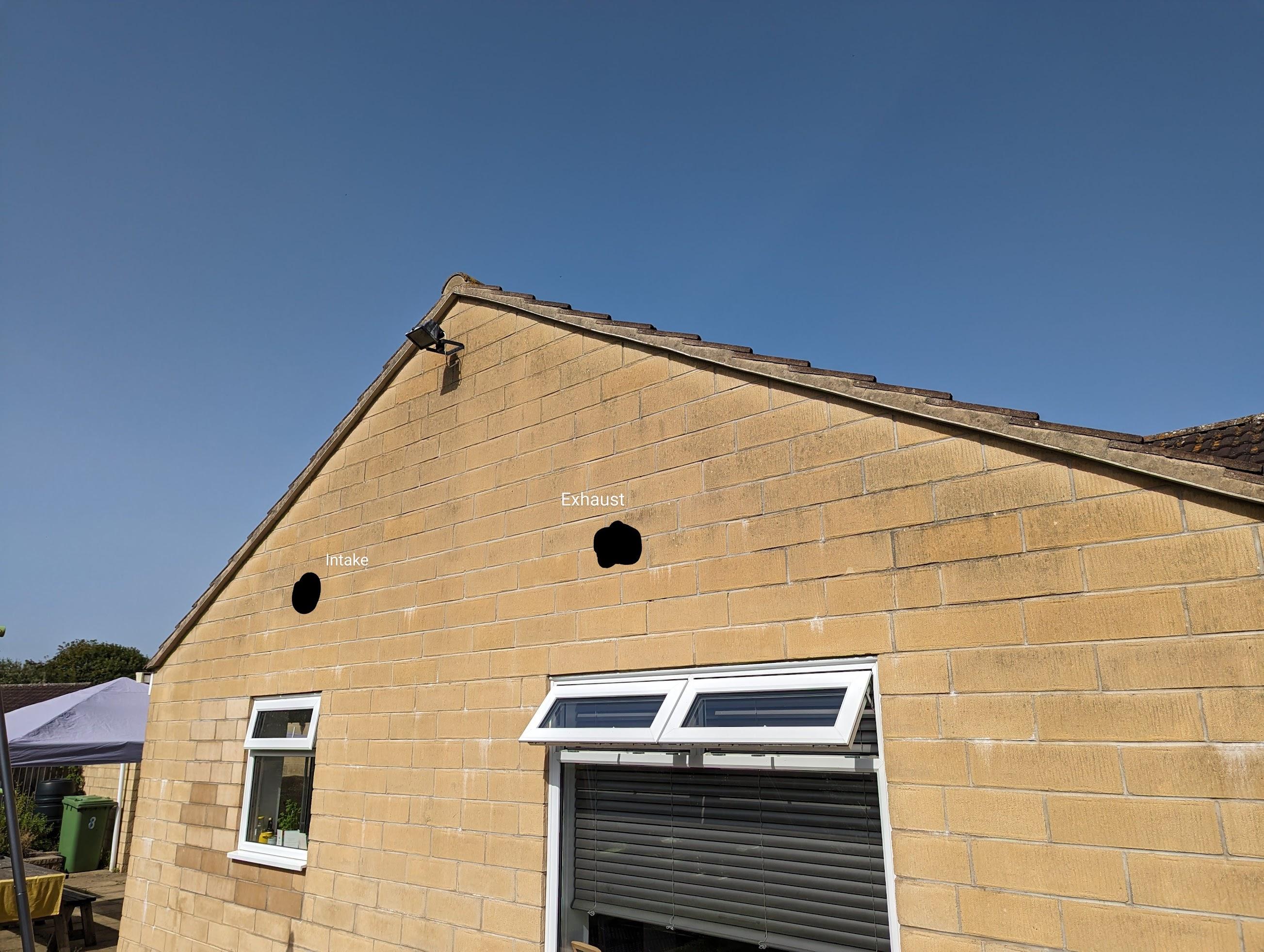

The intake and exhaust will indeed be on the same southerly wall, so they are out of prevailing wind... but I look at the news and see storms across northern Europe and think, "hmm what will be a problem for me if/when that comes here?". My garage roof is surely toast, my solar panels are a small risk, but the MVHR is an unknown. Regardless of how well sealed a property is, a 100mph gust over the external vents will create a big momentary pressure drop vs inside. I guess that will be ok-ish, but there's a high chance it could also cause a significant pressure difference between the intake and exhaust because they are separated by ~2m but within 2m of the building edge, so swirling wind vortexes will surely do "stuff". I'm sure it's not a major concern but I'm just about to install it so I like the idea from @ToughButterCup of some sort of a wind break. I was considering a brise soleil with solar panels on it just under these vents to shade the windows. They'd have an air gap at the back to avoid hot air interfering with the vents, so with a bit of over-engineering 😄 I may be able to bolt some extra protection there, or even raise the sun break above the vents 🤔 EDIT here's a pic... It's all a bit close together because "bungalow" but this is honestly the only place the unit can go. There's about 2m between the vents, 1m diagonally from the roof. I might move it in 5+ years if we do build a small extension on the other side of the house, but for now once installed those kitchen windows will mainly be shut. I guess that brise soleil would be toast long before the MVHR in this situation 😂
I live on a hill where the wind is generally stronger and, as we see from global news, the weather is getting crazier... So I was wondering: What happens to the ducting and MVHR when the house is hit by 80, 100, 120+ mph winds? Do joints pop apart or damage caused by big pressure differentials? One mitigation could be a pressure release valves on the intake and exhaust ducts. A spring would keep it shut but if a sudden gust comes it would let air out of the duct to reduce pressure. Had anyone heard of any issues caused by storms or even hurricanes?
