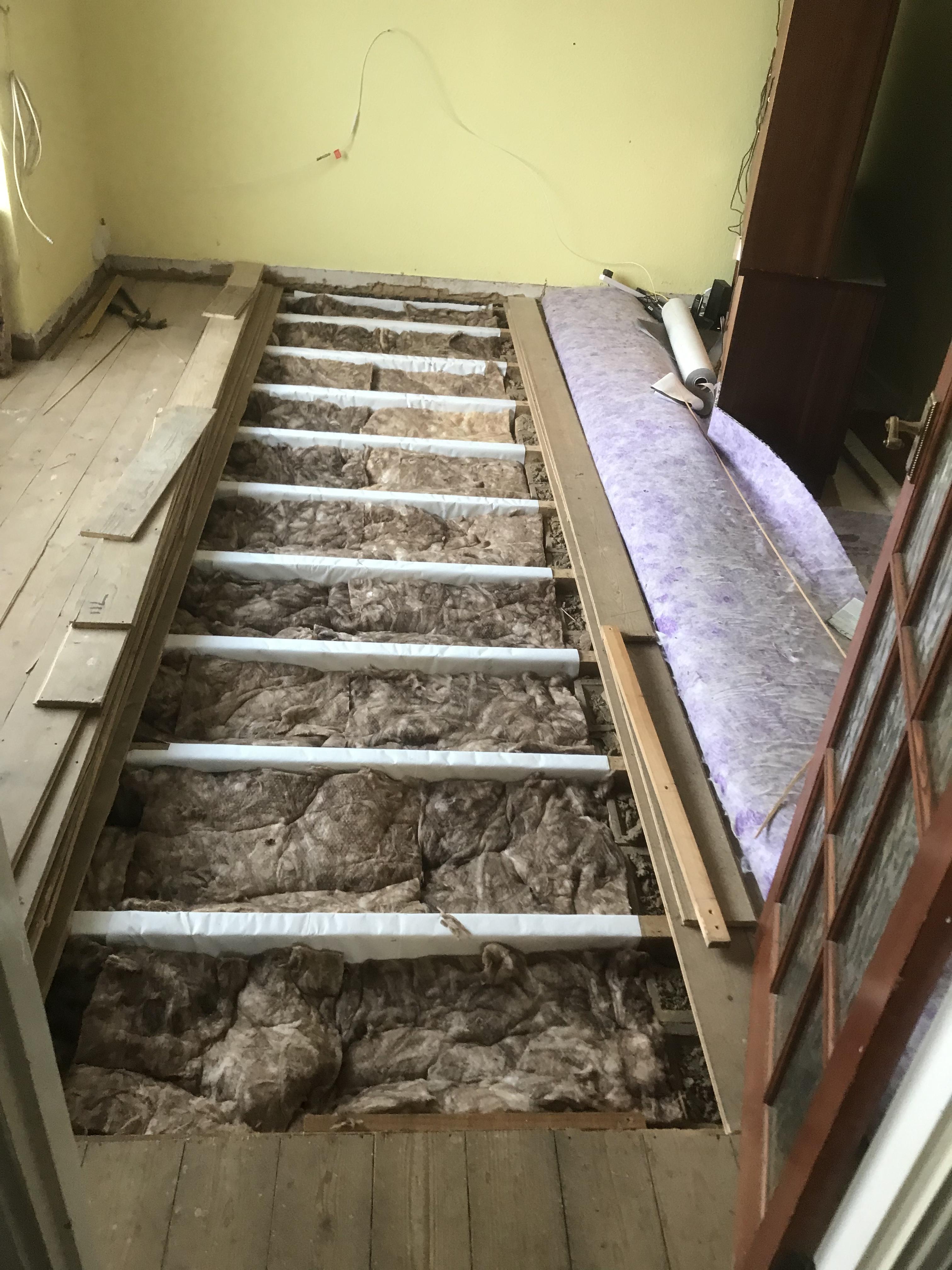

  3. Hello everyone, a previous owner has fitted cork tiles over the chipboard flooring and as we wanting to insulate under the floorboards, it all has to come up. Due to the uneven surface we now have (the tiles were glued down) we will be changing the flooring. Asking which is better; 18mm chipboard or 18mm OSB?

  5. Hi everyone, I have been fitting under my floor between the joists and have been using Knauf Insulation Omnifit slab 35 which Knauf say is suitable for suspended floors. Struggling to find alternatives that say it’s suitable for suspended floor, has anyone got experience of using wall cavity rock wool in suspended floors?
