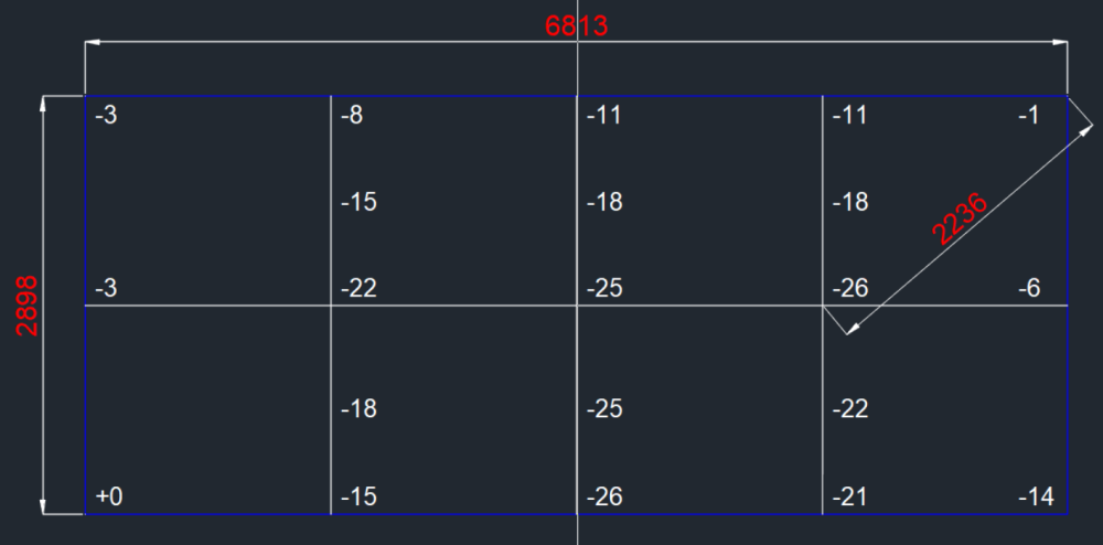

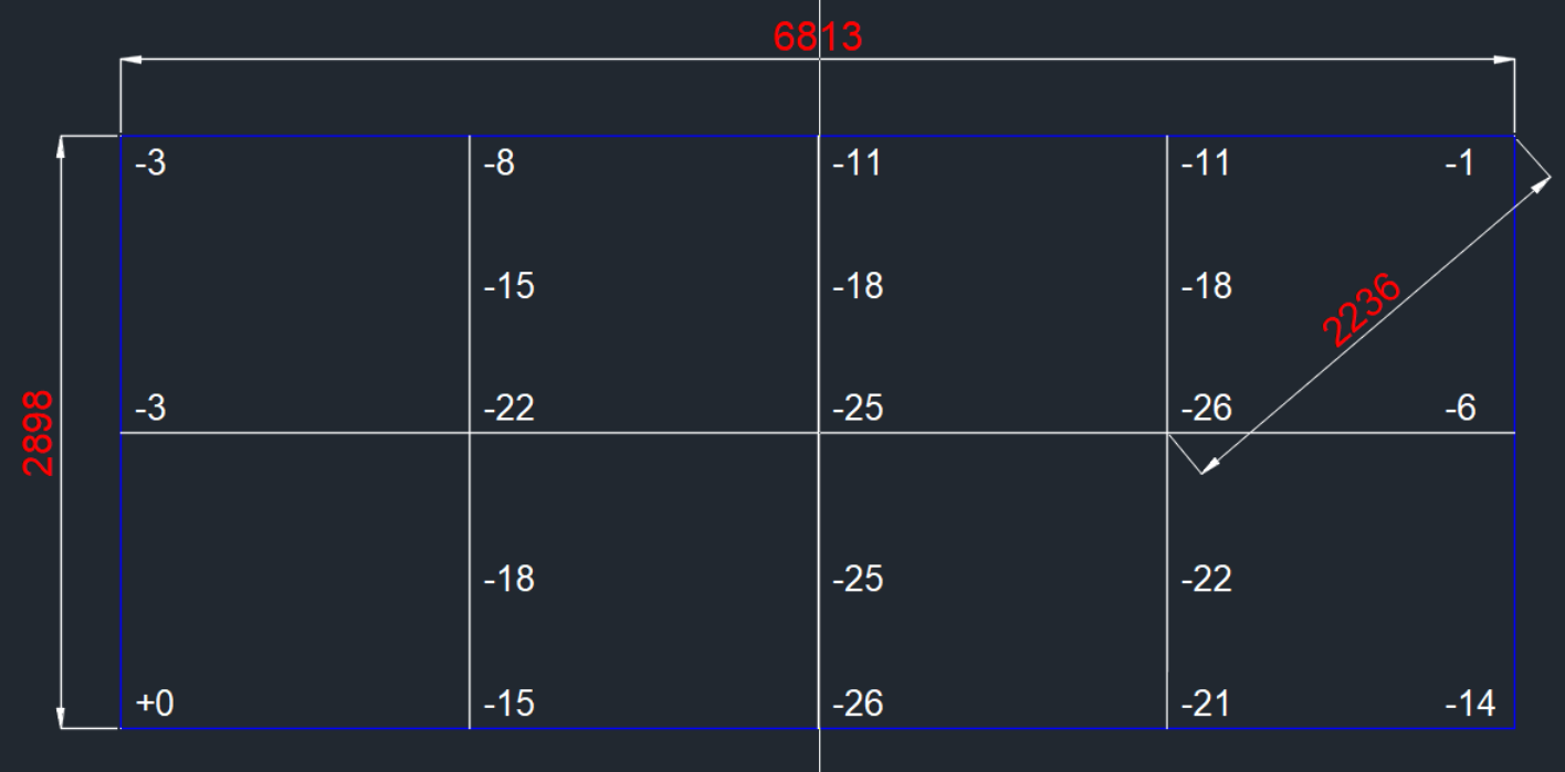

I have a new laid (5 days ago) concrete base 6800x300ish that due to the rain highlighted a huge depression in the middle. There was plenty of MOT1 compacted with sand on good earth (as approved by BI) I will be putting 150mm PIR insulation over the top but im not sure that a 25mm bow is ideal. screed will be going over the top of that but im a little concerned for the insulation being force to bend. I still have over 150mm thk concrete in worse case in the base. Any thoughts / suggestions? Warren.
or even? . do i need to run the concrete base into insulation? i would have to knock the inner course of block off but no issue.
