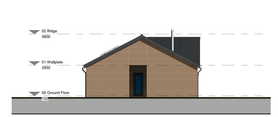

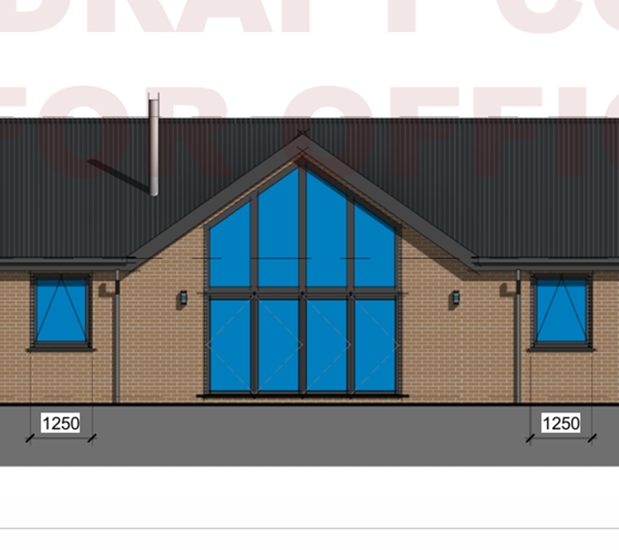

  3. Good evening. We are soon to start our bungalow build. The design has a apex window feature. I wondered if anyone can recommend a company to go to for supply and design of roof trusses and would they include the apex in the truss design? See below an image of the roof externally. It is simple, will be steel or zinc covered seamed roof. Thank you all in advance. You are so helpful on this forum.
