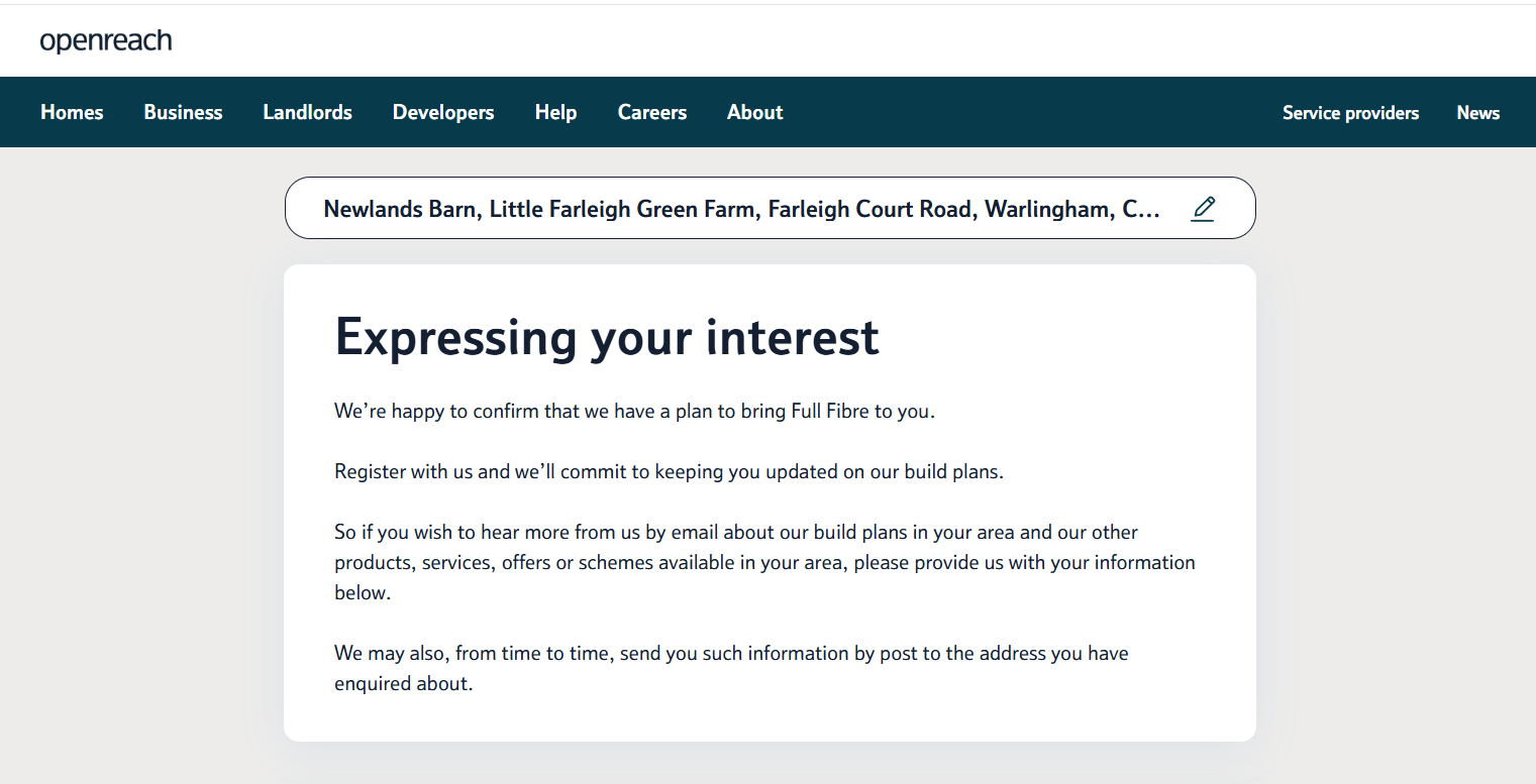

Hello everyone I posted about Approved Document R Infrastructure for electronic communications Volume 1: Physical infrastructure and network connection for new dwellings There is a form to complete and building regs weren't satisfied with my first attempt! We are self builders (single storey house), living on site with superfast broadband supplied by Plus Net. We are semi rural so don't actually get very "super fast". I am trying to put together a diagram to be accepted by BRegs. I am not sure where my Network Distribution Point currently is. I went onto Openreach but they wanted a £60 payment for this information. Does anyone have any advise of how to find this (for free) please? Thank you in advance.

Good afternoon everyone. We live onsite in mobile home and managing our self build. We have superfast wi fi as I work in my day job from home too. Building control asked for a connectivity plan Approved Doc R. I sent them our current super fast broadband bill and I completed the form to my best ability, however, they are not satisfied and say: “Thank you for this. Although the bill shows network capability is available within the site, it doesn't clarify a network provider has offered to provide a connection and which technology will be used to deliver this. I appreciate you advise a CAT6 cable will be installed, which will provide 'gigabit capable network', and you that have stated it would be full fibre wired connection however, a statement would be required from a relevant provider. In addition to the above, additional information would help me assess compliance, such as schematic diagrams, location of network termination points, access points and network distribution points. Please also ensure the form is fully complete, including section 5.” Section 5 relates to the build of more than one dwelling (we are only building one), any advice would be appreciated. Thank you in advance Caroline

Hello everyone. Building inspection has asked for the above even though we have ultra fast broadband to the mobile home onsite which will be transferred into the new house when we move in. He directed me to the Part R Appendix B but looking at the form seems to be for obtaining new broadband. I sent him a copy of our current bill so the same address (mobile home on the same site as the new house) but apparently that isn't sufficient! Any advice appreciated.
