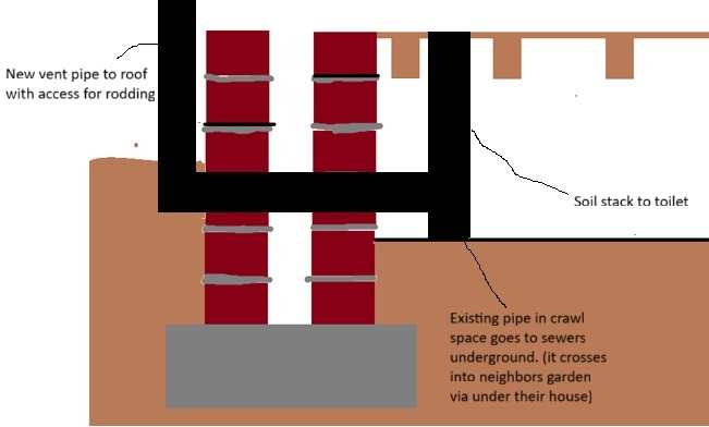

Is it fine even below ground level? Should I tooth in some kind of lintel? And box around it under the ground to stop earth and water entering the subfloor?
Hello, As the title suggests, I want to bore a hole for the soil stack of my home. I wanted to know if that would be a safe thing to in terms of water ingress as it is below the ground outside. If not what can I do to make it safe? Should I put expanding foam around the pipe to not allow water in or should the pipe be excavated around and drained at the bottom? Unfortunately its not an option to redo the pipe underground myself as it goes under neighbours house, joys of council houses! Please see the illustration I have attached. Thanks

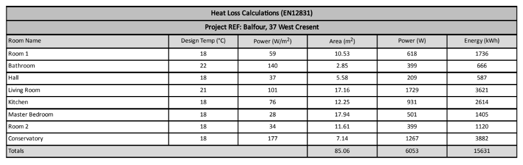

I am very confused, some sources say 2.5 times the BTU (I would imagine watts would work also) for ASHP but this just sounds a bit loosey-goosey advice and could lead to cold rooms. Is this advice sound? It doesn't seem to take into account that I would like to run the system at lower temperatures. -

Gosh, I have to admit, I feel more confused then before. Thanks everyone for the input. I am probably going to have to have a serious sit-down and look into this, or if there are suggestions on who to hire to help with this? -

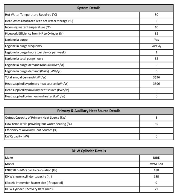

That is great thanks. I have replaced the micro bore with a manifold system and 15mm pex pipe. There is a tank if that is what you mean by a buffer (sorry for my ignorance!) built into the valiant internal unit. Should i install an expansion vessel on the radiator loop also? Thanks for your reply, I will lookup the calculation tool. -

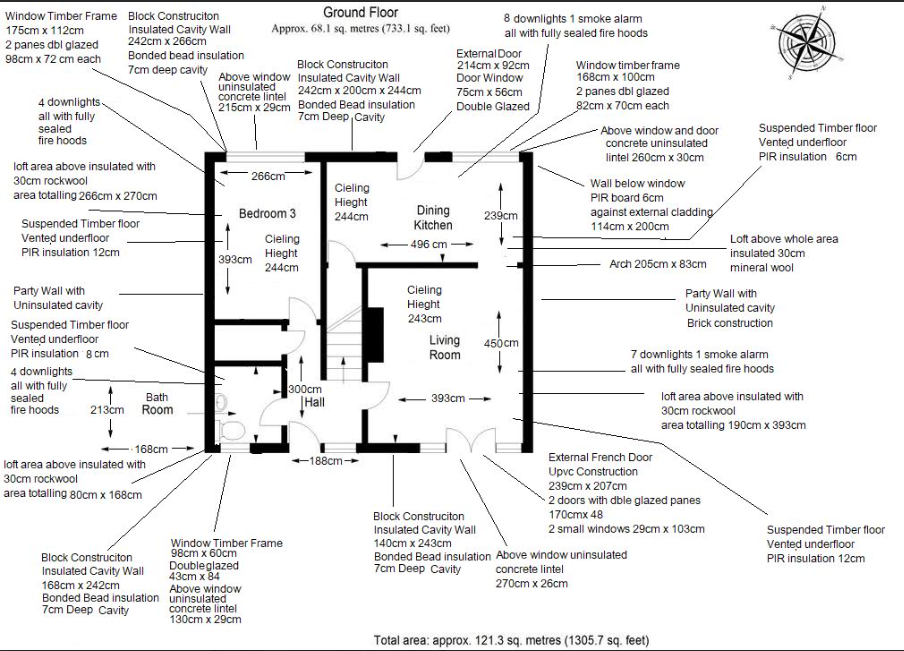

Hi, I had an installer fit an ASHP to my existing heating system. They advised i should upgrade my radiators at the time as it was about 30 years old and micro bore etc. I was a bit strapped for cash at the time of installation so I had no choice but to refuse and come back at a later date to fit new radiator system. As a result I have left my self unsure as to how to scale the radiators for the rooms and what BTU they need to be. I was hoping to run the ASHP as low as possible around 35-40 degrees to reduce long term strain on the system, so have no issue over sizing the radiators. How would I calculate the sizes? I was left with these documents and I am unsure if they are what I need to calculate this out. Also attached is a detailed floor plan of the area needing heated in case that helps. Thanks in advance for any replies, help and support offered. Mike

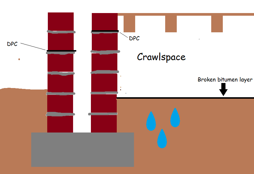

Mike, thanks for the reply. Yes i have already done a bit of air tightening of the floor using a dpm between the floor board and joist which was taped to the plaster forming a somewhat decent air barrier. I also have 100mm PIR board between joists. Should mention another reason i would do it is to make maintenance easier and cleaner as i may need to under there a few more times and possibly again in the future also. For that alone it is worth it to me, I would also like to know if covering the area with a dpm would cause issues. It is only one room and a small room 1.8x 1.9 bathroom. -
Hello, I have been doing plumbing under my floor which has required me to crawl in the under floor a lot. In there, there is some old bitumen on top of the sand. I believe its there to stop moisture coming in through the ground. Problem is, it is all broken up as black jack gets fragile over time so is no longer serving its purpose. The ground is cool damp to the touch even after being left for a couple years. There are definitely no leaks causing it, it is likely there from a previous leak that has been addressed. I wanted to know if it is worth running a DPM over the top as i have a good bit spare of heavy gauge DPM. I was thinking running some weed fabric to protect it from punctures as there is rubble dotted about and maybe the odd screw, then run the DPM on top of it and finally adhere the DPM to the walls below the DPC by a few bricks using expanding foam. Would this be worth it? Would it help keep it dry under there and would it be OK to do so? Any advice is greatly appreciated, thank you. See my diagram below if needed.

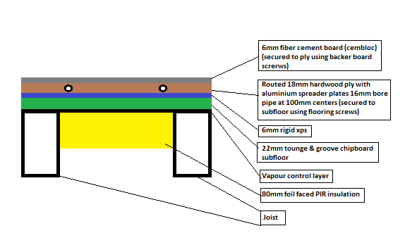

Yes, we did do it about a year ago, which is where the 100mm pipe center came from. But much has changed since then, the property is not airtight, but it is certainly tighter than most and all insulative measures have been carried out. It may be worth another calculation. Do you see any issues with the structure proposed in the diagram (beyond insulation), would this all be functional from a structural perspective? -

I should have mentioned, there is also mineral wool below the pir, to the remaining depth of the joist. In terms of high flow rates, that is the whole purpose of using 100mm centers, the pipes should run at a lower temp should they not? what would your recommendation be? -
Hi, As is attached, the image shows a crosssection of the layers in the underfloor heating system I am planning. I have got a company that is giving me a good deal on routing ply for use as an low profile under floor heating system. The system brings the floor up by 30mm; 6mm cement fiber board, 18mm structural ply and 6mm xps insulation. it will be in a living room and kitchen area and is a wet system. I want to know, If anyone sees any immediate issues with it as shown in the diagram, my doubt I have is if the xps will be rigid enough to support such a system but the reason I was thinking this, is to bring it up to 30mm as it brings the floor exactly level with the rest of the house and a little more insulation never hurt, though it is sandwiching the subfloor because a vapor control layer, so maybe it would hurt if water got in... Please let me know if you would do a system like this any differently, I already have the ply, pipes, spreader plates as surplus from a pervious job, so I am planning to work them in no matter what.
