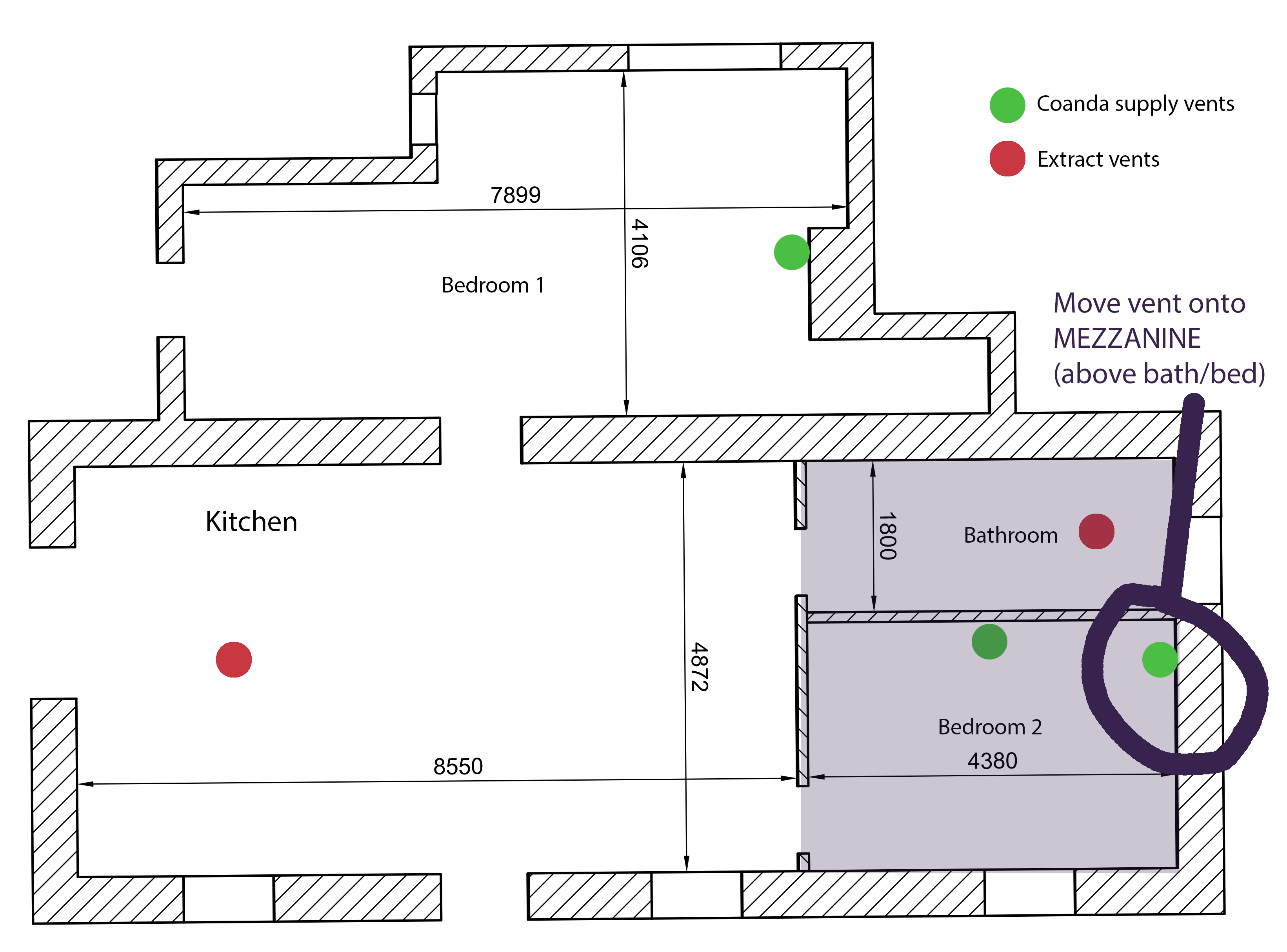

In fact there is a mezzanine above the bathroom and bedroom 2. It will be used for utility and storage (the MVHR unit for example). Not a living arera but will be regularly accessed. Is it worth moving that supply vent onto the mezzanine? -

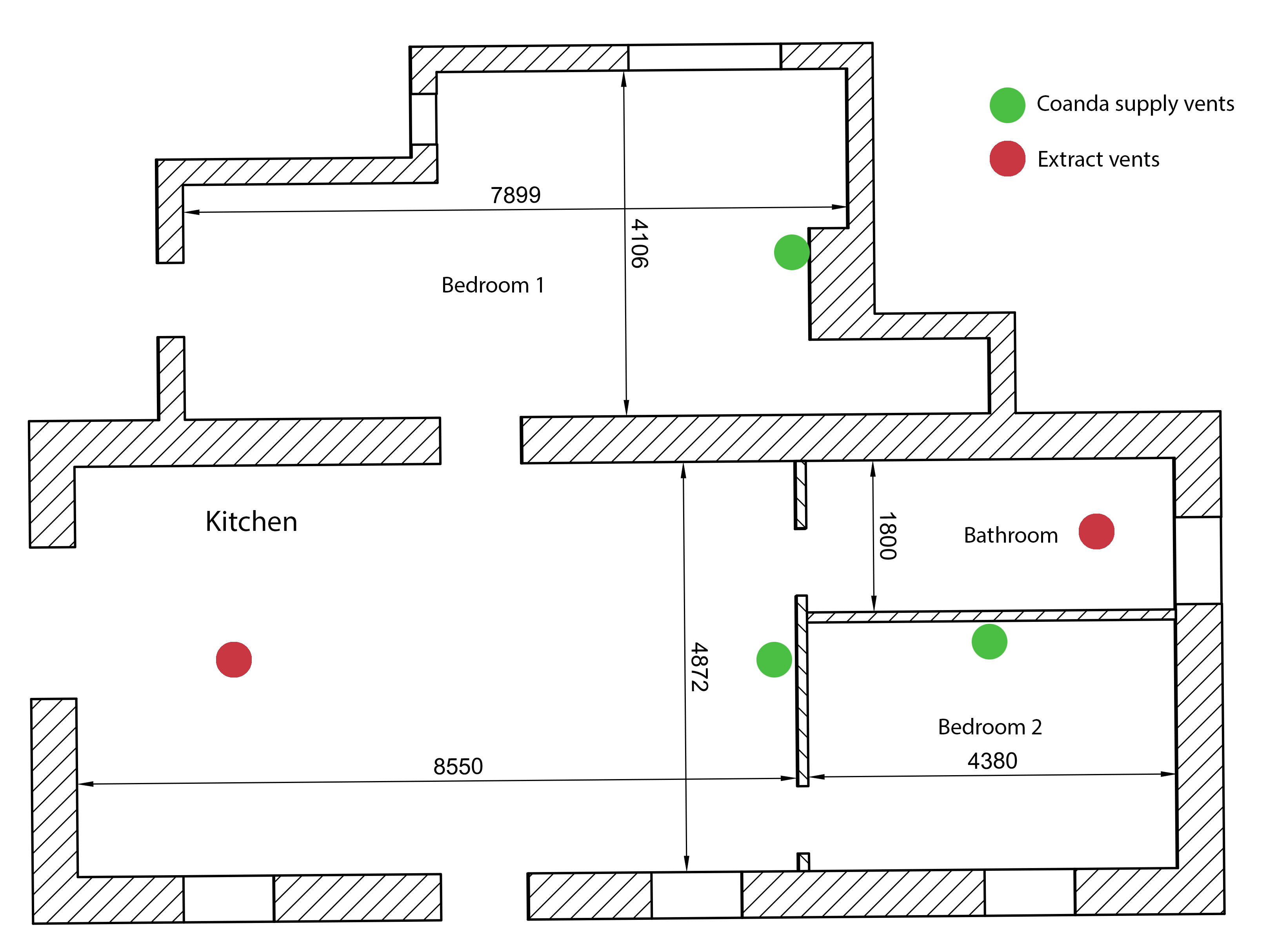

Having got a design I now think I may install it myself. Maybe you would comment on my vent positions (see attached image). These are currently more positioned for ease of install. I suspect the far end away from the vent in Bedroom 1 might be lacking flow. How do they look to you? -
