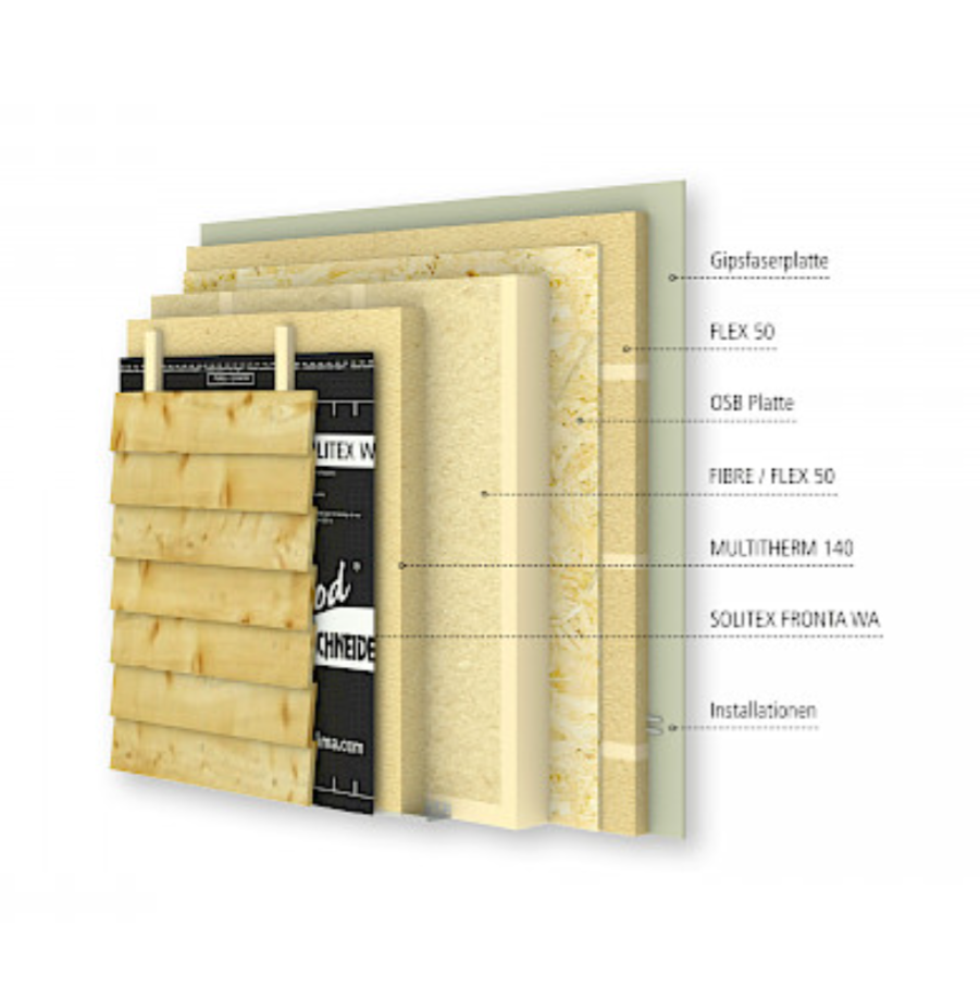

@SteamyTea from what I'm learning in the post Grenfell world you can't have a good idea like covering the wood fibre in intumescent paint. It needs to be actually tested and certified to be accepted. The tests cost £30k and there is apparently quite a waiting list, so you're basically dependent on manufacturers certifying their products and it doesn't look like anyone has certied wood fibre insulation yet. @gavztheouch we have bedrooms above the height where you have to start considering the fire regs. I wish we didn't but planning restrictions (we're in a conservation area) have forced us into a certain design. -

@Iceverge we're planning a factory built frame by All Timber Frames from near Exeter. Aiming for a u-value of 0.1. Rockwool seem to have a intumescent cavity barrier certified for use with their rainscreen duo rainscreen product. If we can't find an intumescent cavity barrier certified for us with woodfibre then we may need to explore whether switching over will be possible. -

@Mike we think it is possibly a UK requirement (post Grenfell) and not required in Europe. This is part of the problem, it becomes a bit niche when it is just the UK so there is no approved details. @ADLIan we're finding BCO won't give advice any more as they cannot act as designers, you need to present them with an option that they'll either approve or reject. -

@Redbeard @SimonD Our planned build up is very similar to the one Simon linked to (image below), except we're planning a batten and counter batten before the external cladding. Our architect has taken the lead in trying to find a solution. They've been speaking to cladding suppliers and cavity barrier suppliers so far and drawn a blank. I've contacted Ecological Building Systems who market a timber frame build up similar to the image and they haven't got back to me (despite a few chasers) so I suspect they don't have a solution. We hadn't considered a render scratch coat. (Thanks for the suggestion.) I'll also check if the architects have contacted the wood fibre manufacturer technical departments and if not get in touch. -

Our planned wall build up is a timber frame, wrapped on the outside with wood fibre insulation and then a ventilated cavity and timber cladding. We'll need horizontal cavity barriers and haven't been able to find any manufacturers who say there product is approved for use with wood fibre. Consequently Building Control won't sign off our plans. Has anyone recently built with a similar build up and found a cavity barrier approved for use with a timber frame covered in wood fibre? Thank you.
