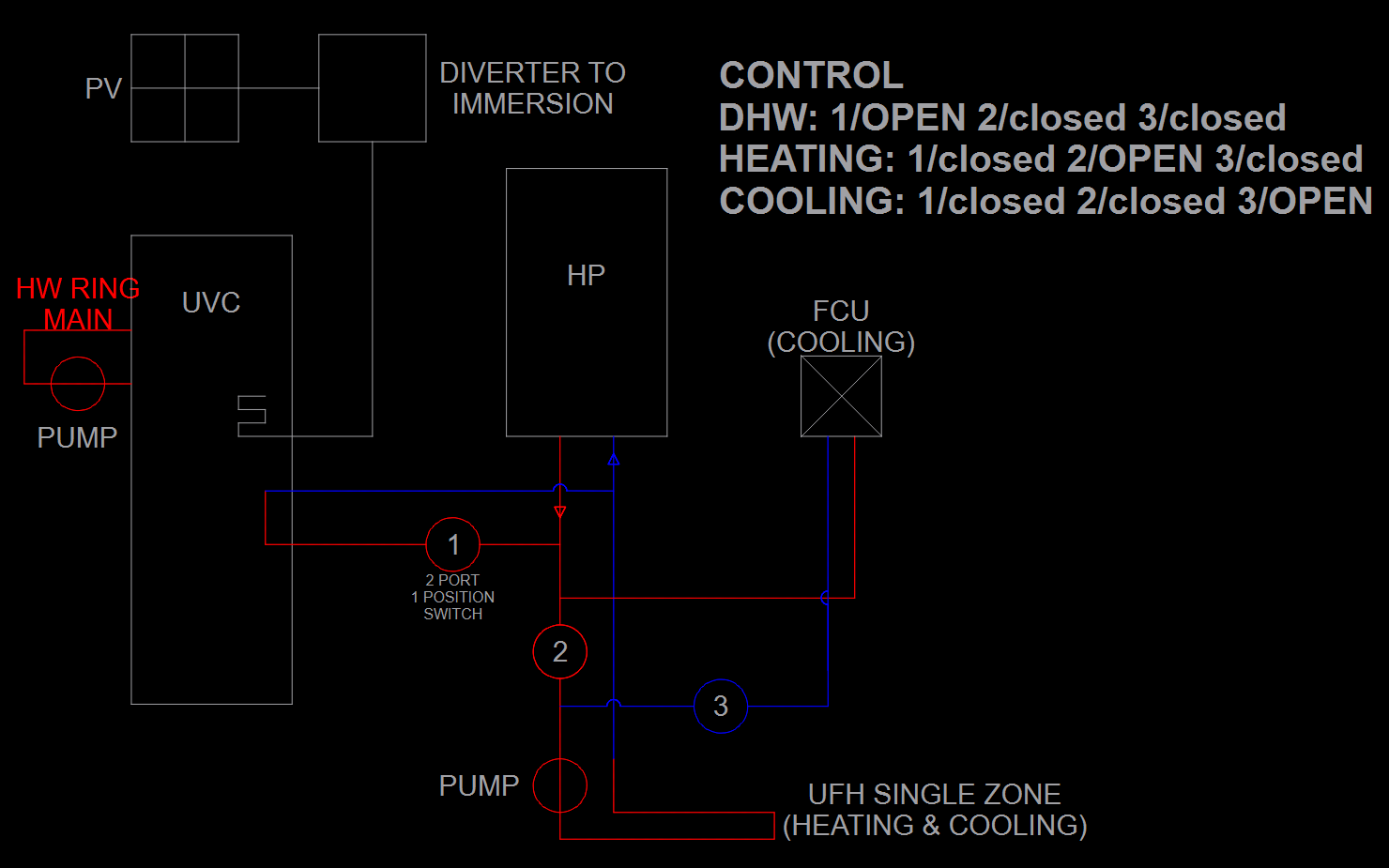

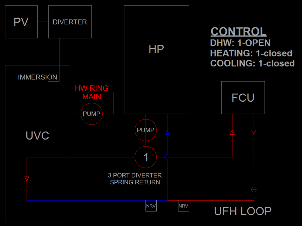

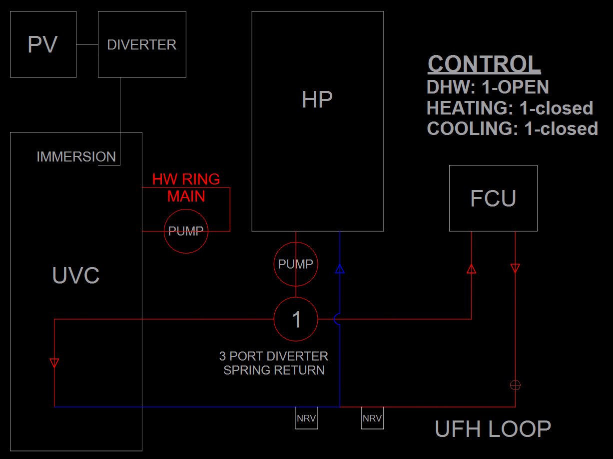

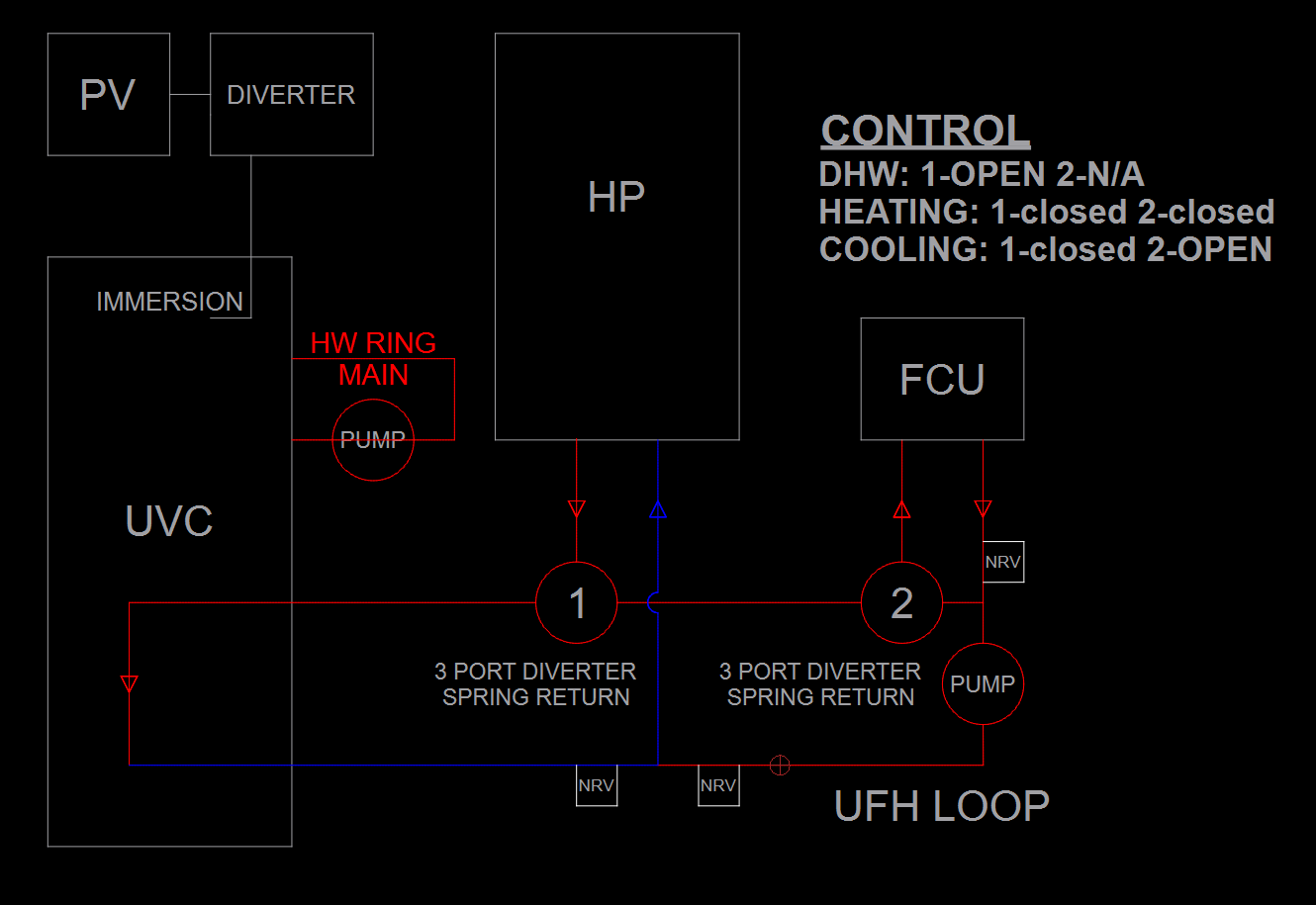

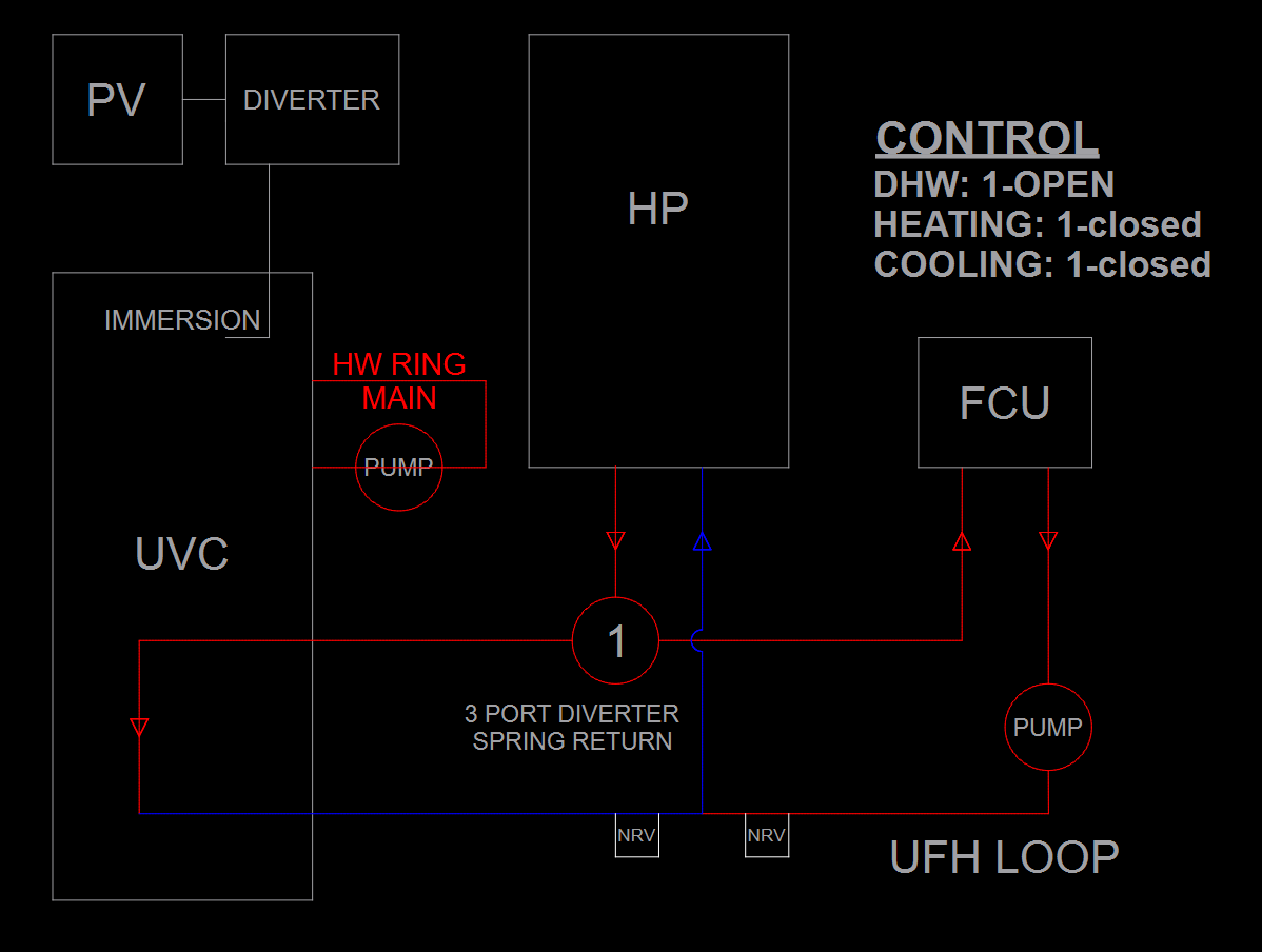

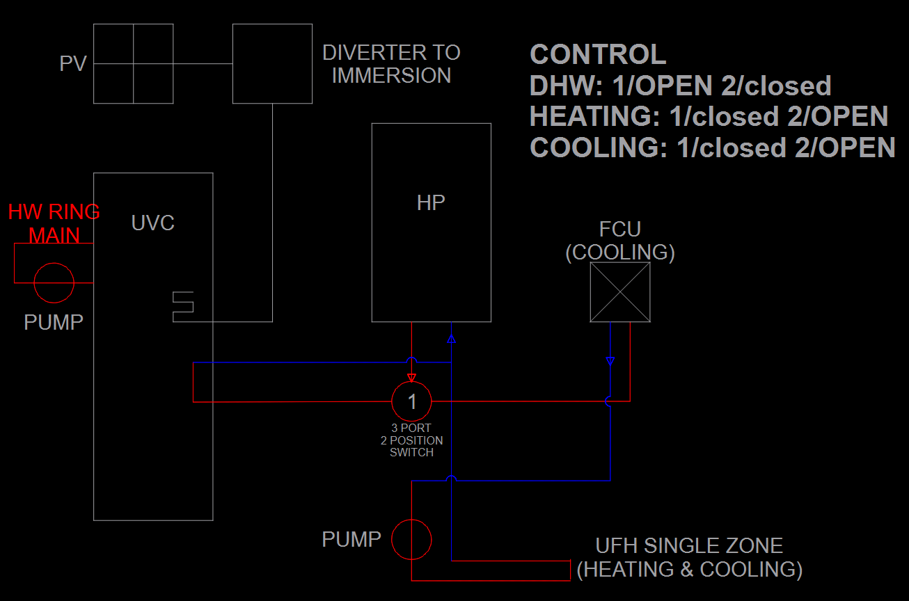

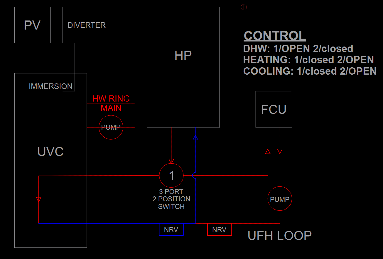

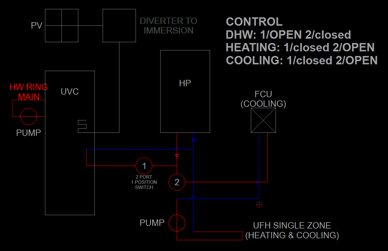

  2. Heat pump cylinder
  3. This is exactly my set up. The extra valve is only on the DHW return to act as a safety cutout. Is it enough to have the diverter only?
  4. Live is fed to the immersion heater via the thermal cut out. This is where the valve can pick up it's power (?) is my guess.
  5. Booster heater and thermistor installed. It's just the cut off valve for the over temp that needs attention. I think I need to connect the valve to the tank thermal cut out - with the BROWN wire connected in position 2 and GREY/BLUE/GREEN wired up to live. Unsure on the ORANGE wire.
  6. ev-ehs-r-290-mono-pjt-ubs-s.pdf
  7. Anyone installed a Gen 7 Samsung A2W heat pump and found out where to connect the DHW safety shut off valve please? ehs-r290-installation-guide.pdf
