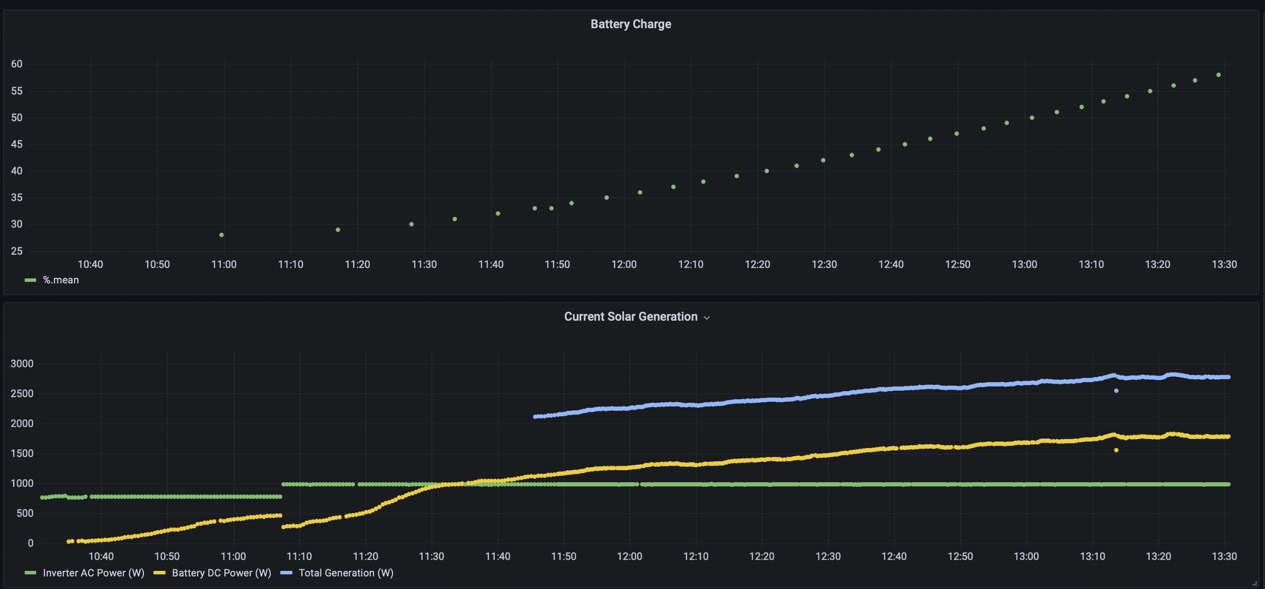

  16. SE8000H, no storedge interface, SolarEdge Battery Bank (the big heavy bugger), Eastron SDM-230 meter being fitted this week (couldn't fit today as we need metal box apparently). The Eastron SDM-230 is not compatible directly with SolarEdge inverters so I will be using a bit of software (https://github.com/nmakel/solaredge_meterproxy) to convert the values. This doesn't bother me as I have to use a wireless Modbus TCP gateway anyway because running an RS-485 cable from inverter to meter would be harder. This runs on a Raspberry Pi with USB RS-485. I couldn't find a meter that directly fitted my requirements for a reasonable price: 1. Compatible with SolarEdge (ideally without any proxies, not just SolarEdge branded stuff other stuff works). 2. Direct connect not CT clamps. 3. 100A single phase. 4. Modbus TCP (we need to send this wirelessly as running a cable would be hard) I have the Raspberry Pi in the shed with the inverter anyway for monitoring purposed so I figured the SM-230 with a DIN mounted Wi-Fi Modbus TCP proxy would nearly tick all of the above boxes. The Raspberry Pi simply connects to the inverted via RS-485 and the meter via Modbus TCP. The non solar edge hardware I'm using in full: 1. Eastron SDM-230 (£50 online) 2. Waveshare RS485 to WIFI/Ethernet,Ethernet to WIFI Converter Module,Rail-Mount RS485 Serial Server, Modbus MQTT Gateway (£40 online) 3. Raspberry Pi (cost me £30 but can vary these days, it might be possible to use an Arduino with MicroPython which would be cheaper and use less power) 4. Waveshare Industrial USB to RS485 Converter with original FT232RL Built in Embedded Protection Circuits (£17) All told about £140 worth of hardware but in return I get: 1. Very accurate power monitoring, fully local, fed into wider home automation system by Home Assistant. No cloud crap, no smart meter that can be remotely disabled. Dumb meter. 2. The system can be set not to export (my meter currently charges me for export as if it were import) and the battery can know when to charge / discharge. 3. Regular (15 second or less intervals) and complete information about all the components in the system e.g. battery, inverter, panels. All fed into Grafana. 4. Hopefully I will get control of when the battery is charging or its various discharge modes without being on the SetApp Wifi. Remember the metering part of this still a work in progress, I cannot confirm this will work until I have the meter fitted Please do not consider me an expert with any of this I'm just trying to make this work. I welcome any questions, suggestions or constructive feedback. Anything you do is at your own risk of course. Good luck.
  17. A different plugin might already offer this functionality, if you skim through this constants file (even if you aren't a programmer) you will see roughly what options are available: https://github.com/binsentsu/home-assistant-solaredge-modbus/blob/master/custom_components/solaredge_modbus/const.py
  18. It is a little long winded but it seems stable enough, I'm using Home Assistant (https://www.home-assistant.io) with 4 plugins: 1. Grafana plugin (https://github.com/hassio-addons/addon-grafana) 2. InfluxDb plugin (https://github.com/hassio-addons/addon-influxdb) 3. HACS - unofficial community app store, needed to install the next plugin (https://hacs.xyz) 4. Solaredge Modbus Multi (https://github.com/WillCodeForCats/solaredge-modbus-multi) I turned on Modbus TCP on the inverter and connected it to my network with the wired LAN port. This gives it an IP that you connect to with plugin 4 above. Right now I can only see data not control anything and the plugin does still use polling, I have the polling interval set to 15 seconds and it seems to be fine. Tomorrow I'm getting an SM-230 meter fitted, I will use https://github.com/nmakel/solaredge_meterproxy to get the data into the inverter via a wireless Modbus gateway and a Raspberry Pi connected to the inverter with a RS-485 USB interface. More details to follow. At this point I will have direct Modbus access to the inverter (not TCP) as this is needed to set any values. We should be able to find out what values to set. The above should let me tell the inverter and battery to maximise self consumption. As for charging from grid at cheap rate that is next. Let me know what you find.
  19. Sorry for the repeated small replies but I can't edit old replies. The battery has been charging all day.
  20. Ok looks like it is charging, all the data returned by the inverter looks correct. I assume it won't discharge until I have metering sorted tomorrow. If anyone has any questions they want answered please let me know. There is very little info out there about this battery and compatibility with various inverters.
  21. Ok got the inverter chatting to the battery via the Energy Net addon board. Looks like it is all working, will find out for sure when the sun comes out tomorrow.
