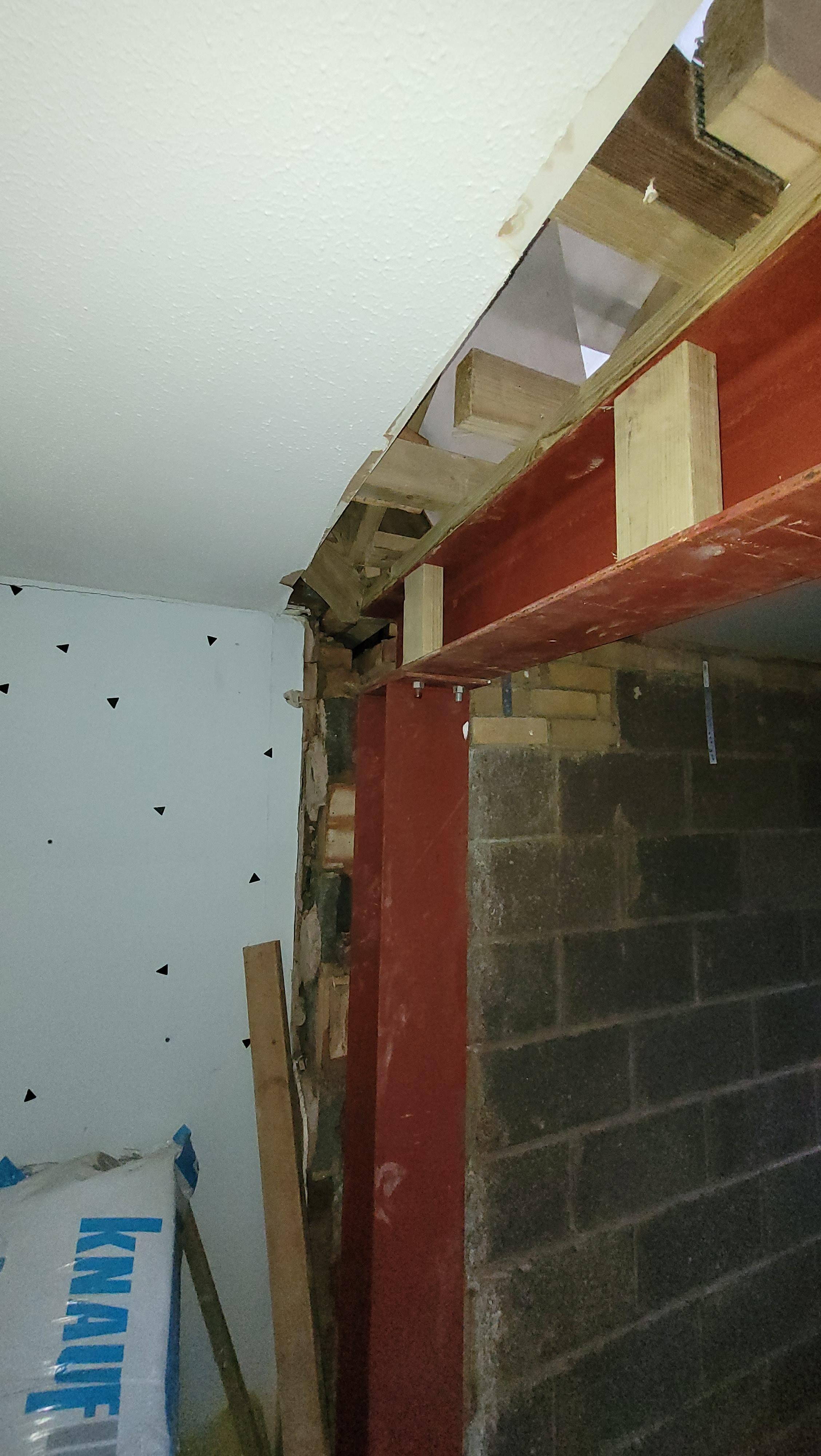

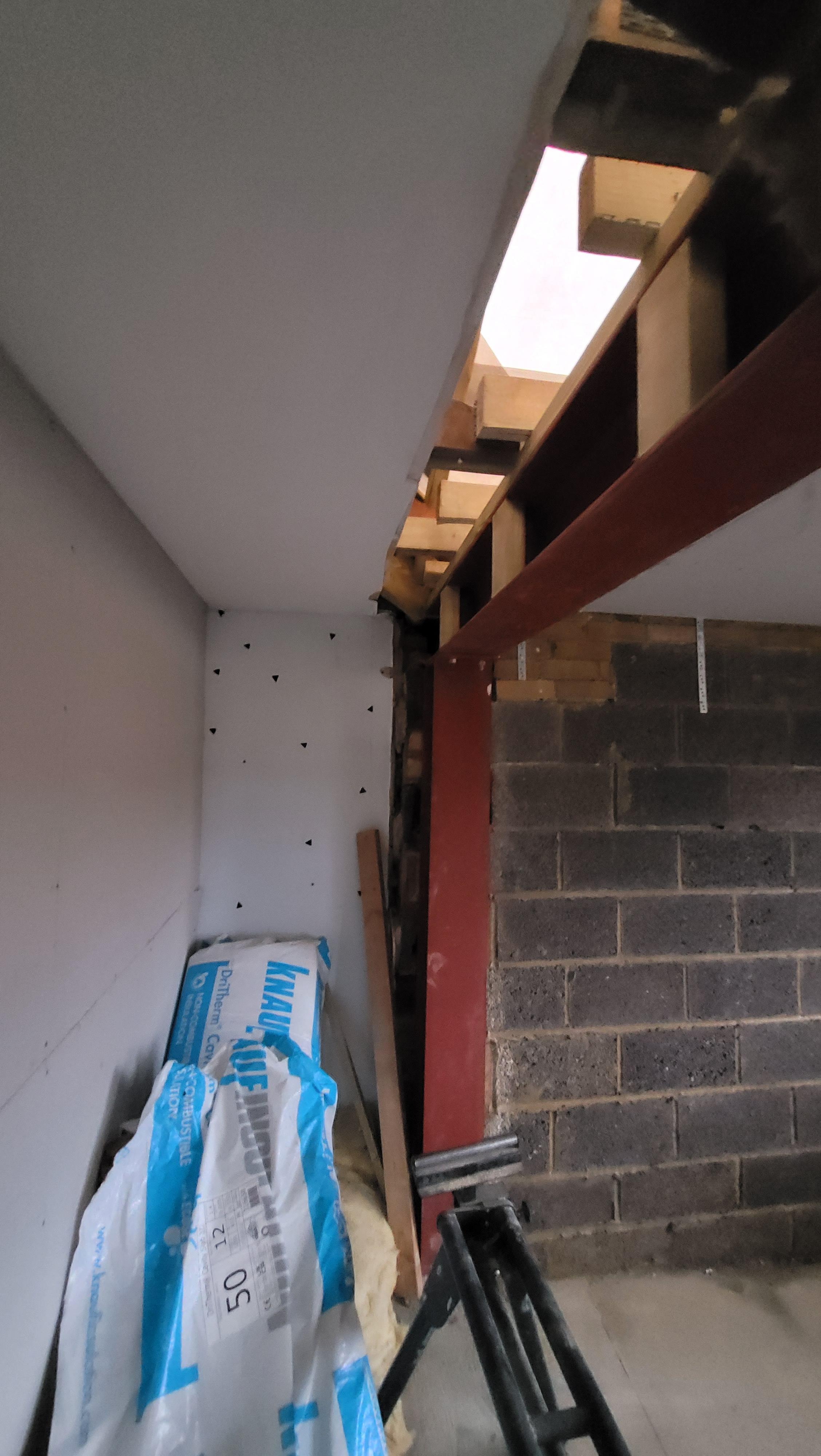

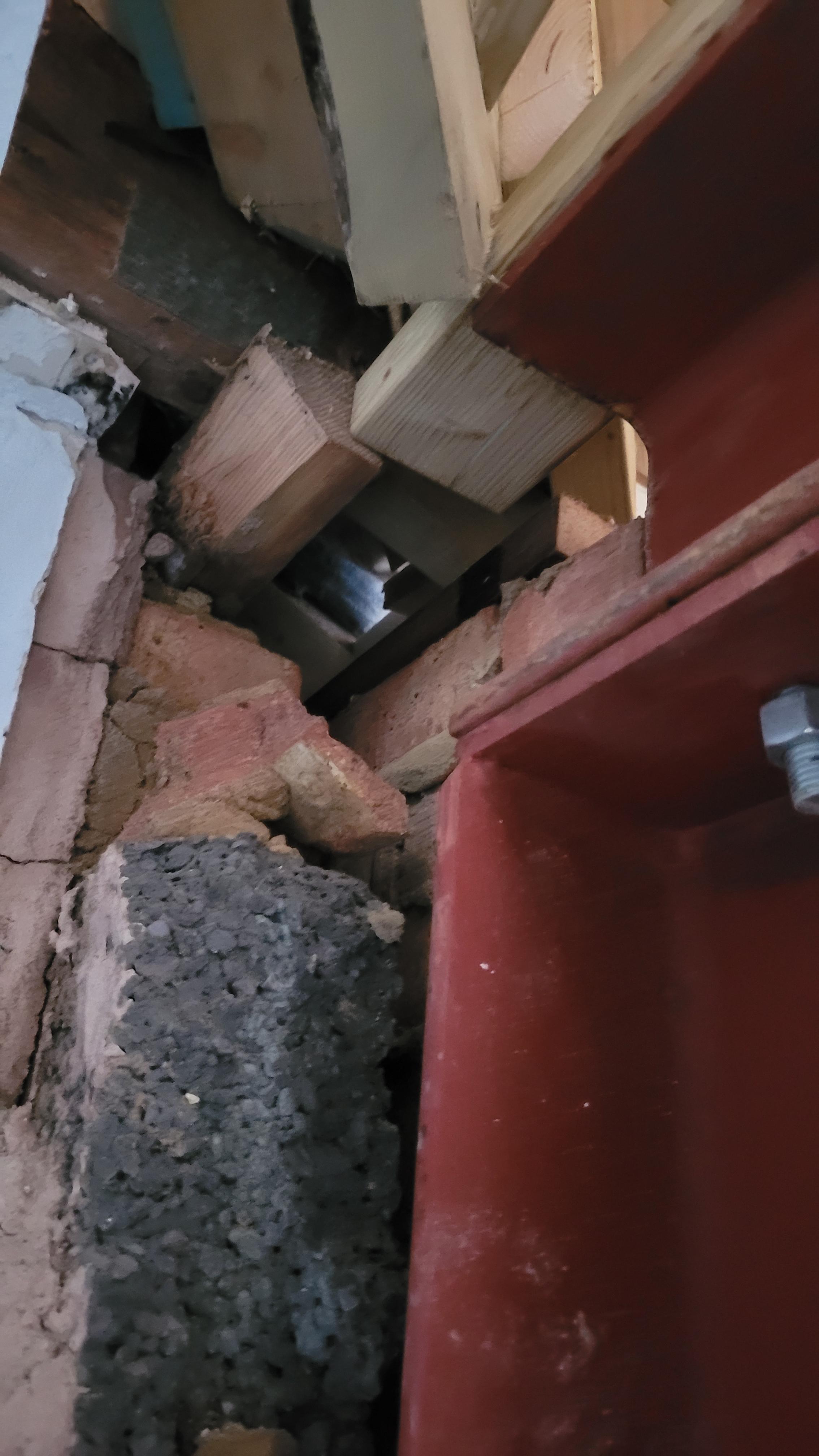

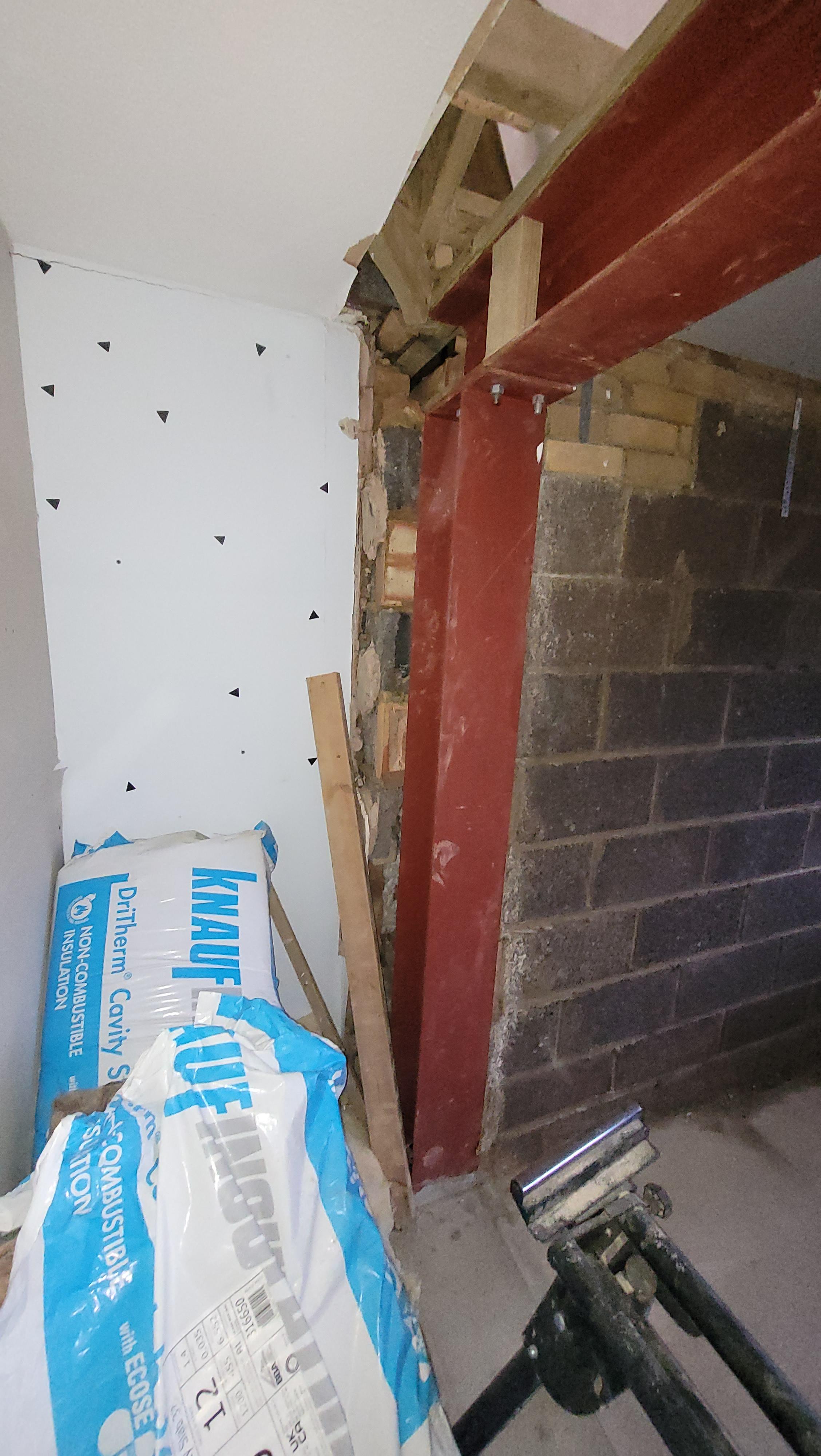

Hi, the plan is for fire resistant boards thankfully! The plan is for rockwool of somekind to be stuffed in to gaps... I feel it'll be a cold bridge though as the elements are pretty much on the other side. I've had so many issues with the build and just want it done.
Hi, the builder has suggested filling gaps in the corner (where the steel and wall meet) with rockwool and then boarding up with plasterboard. Will this be okay, or should some sort of foam be used or even it should all be bricked up first and then plastered?
