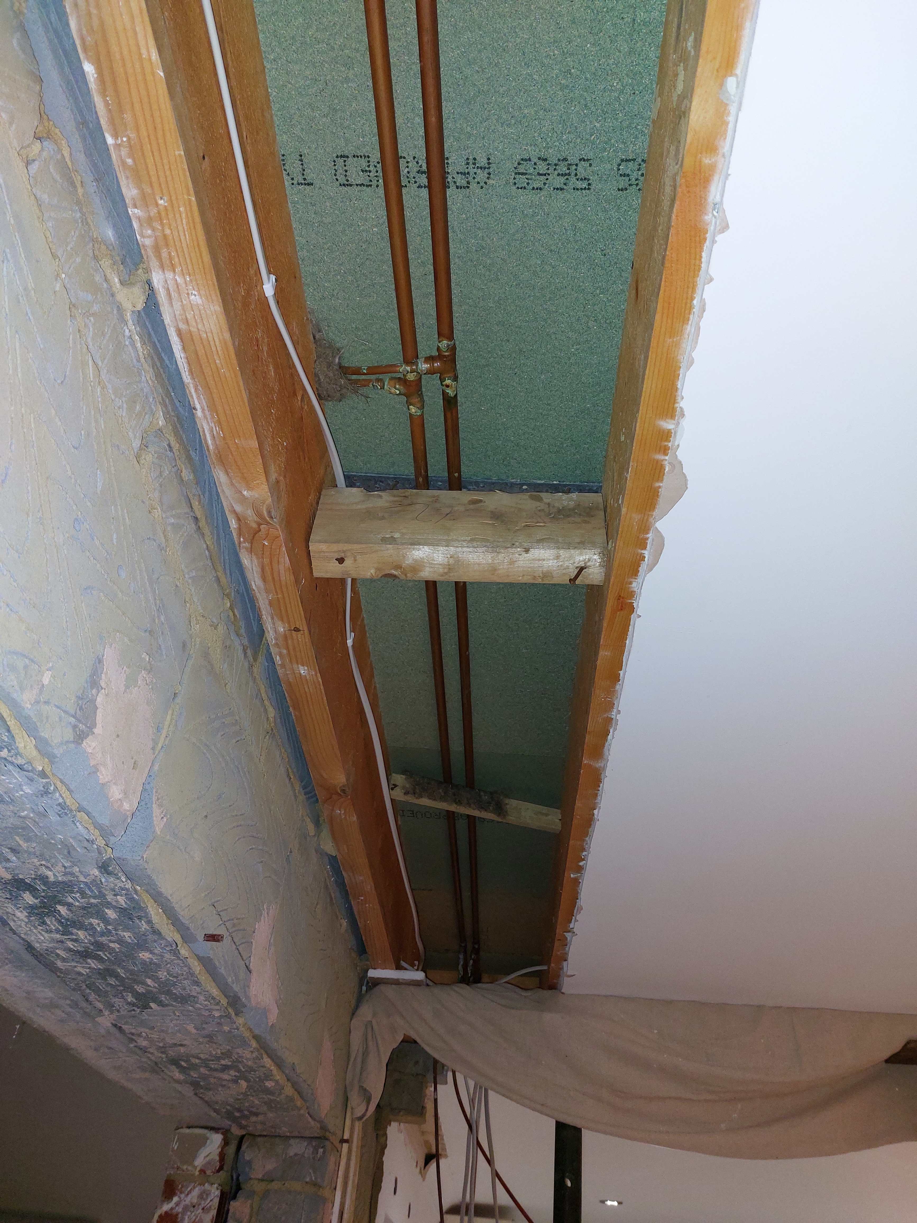

30 Year Old 8mm Microbore Circuit Changes
PhilT replied to PhilT's topic in Central Heating (Radiators)
Certainly worth considering now I know the top floor is mostly 15mm -
The figures vary a lot by manufacturer for example, at 35C the 10kW Vaillant Arotherm Plus SCOP is 5.03 vs the 7kW model at 4.36 (MCS test results). But my calcs look at this in a different way, by comparing an 11.2kW heat pump running comfortably within it's so-called "mid-range" capacity (c. 9kW ball park) vs the equivalent 8.5kW running flat out, at different ambient temps. So an over-sized heat pump could be more efficient or, at worst, no less efficient than the "perfect size" (for want of a better description).
Looking to upgrade to 15mm. I thought the 8mm microbore circuit was fed by manifolds, but removing the downstairs ceiling reveals instead a 15mm secondary circuit feeding short 8mm microbore feeds to the upstairs rads, and long 8mm microbore runs dropping down to the ground floor rads (see photo). This should make things easier because I won't have to hunt around for the manifolds, I can just leave the upstairs rad circuit as it is, run two new 22mm pipes dropping down from the primary circuit upstairs, just after the secondary circuit pump in the airing cupboard, and then connect new 15mm runs from the two central 22mm drop downs to the downstairs rads. Any issues with that approach?
