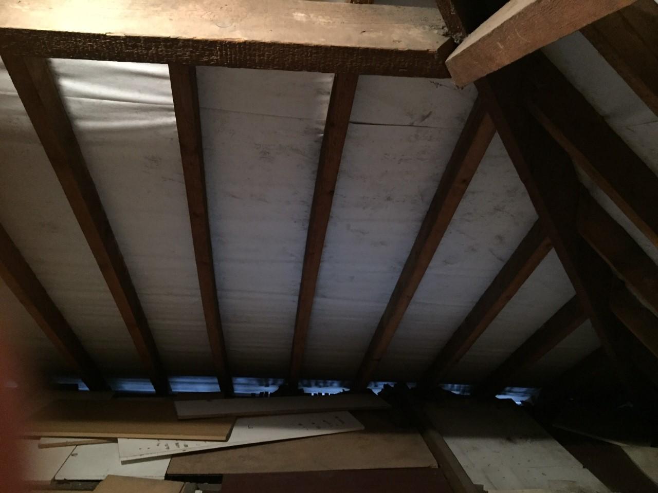

Gap between roof eaves and fascias more than 1"
Janet stone replied to Janet stone's topic in Roofing, Tiling & Slating
Thanks Joe 90, I am waiting for the roofer to visit to discuss how the issues can be addressed -
Also Forum Building Hub community, the roofer fitted white plastic fascias and soffits. He did not fit any white soffits under the roof gable and tells me under the roof gable is not part of the soffit area. Is that true? Many thanks for your guidance. -
Carrerahill, thanks for your comments. I have asked to be sent extra tiles in case the bonding method needs changing in future. I dont know what else I can do? Any suggestions please -
Thanks Jo 90, should the bird guard be fitted from the outside roof or can it be fitted in the loft area? If it is to be fitted from the outside roof eaves, then they will need a ladder or scaffolding? Also will I need to remove the fascia coverings for it to be fitted? -

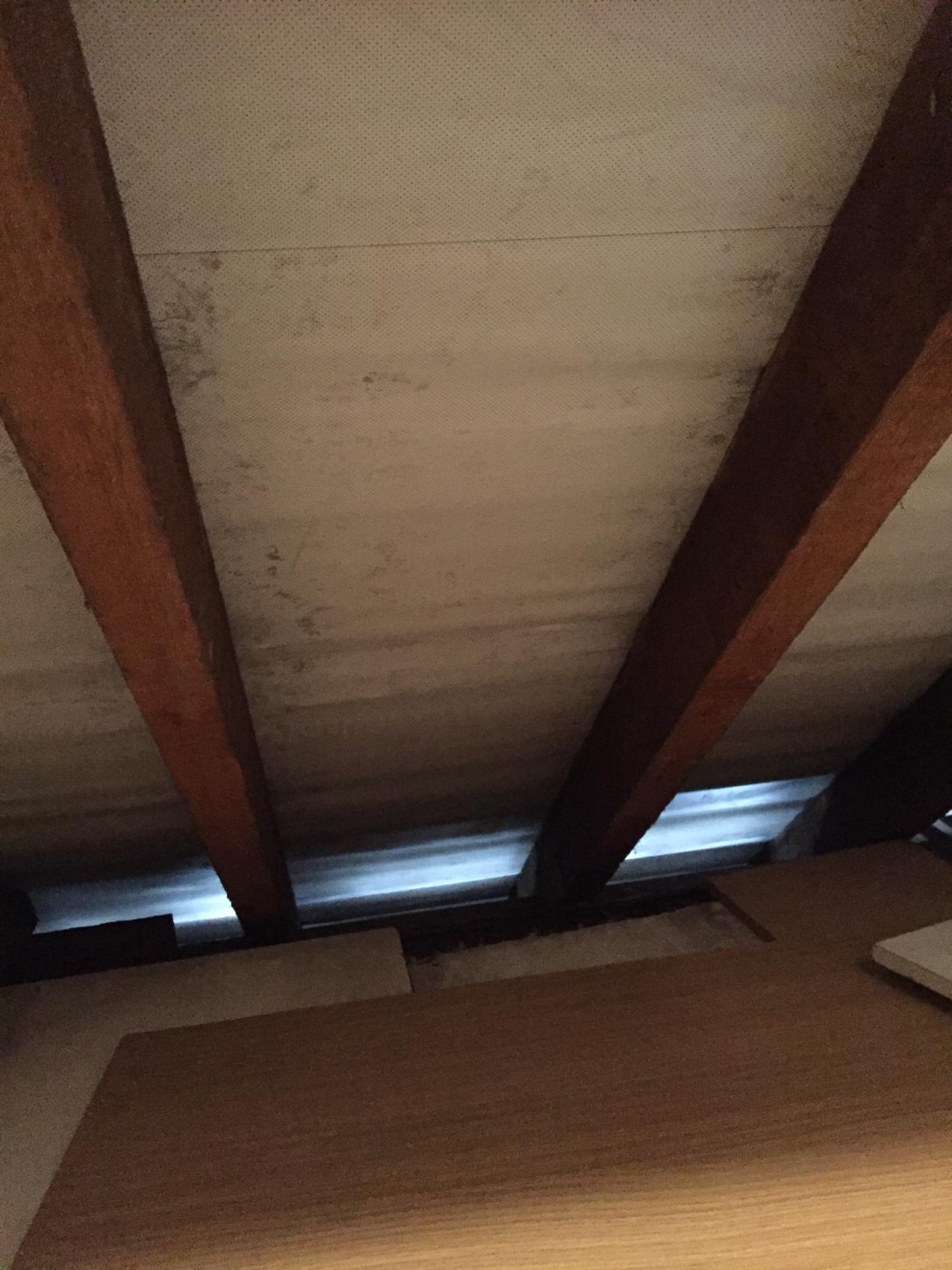

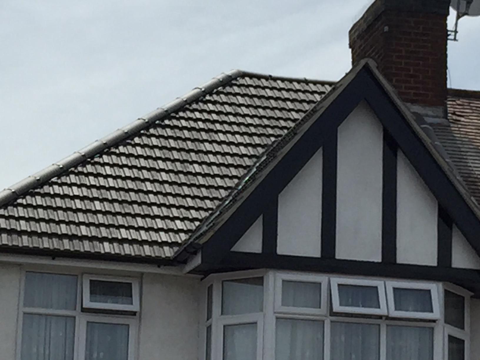

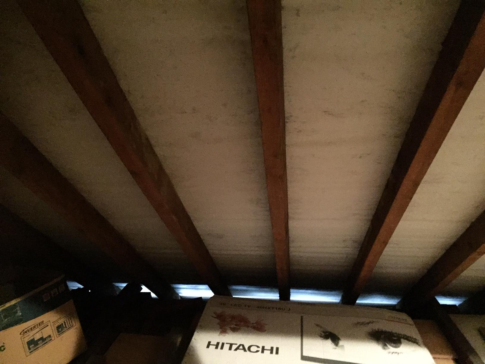

Good morning Building Hub Community I totally replaced my roof about a couple of months ago. I couldnt go into the loft space due to the effects of the dust, following the replacement. I have now accessed the roof space as it has been cleaned. There is quite a gap between the roof eaves and fascias. I am told the gap should not be more than 1 finger width or 1" but mine appears larger. It is covered by felt. I am worried that with time birds, squirrels, bees and other pests will be able to access the roof space? What can I do? I have attached photos below. I will be able to respond to messages this evening. Regards, Janet.

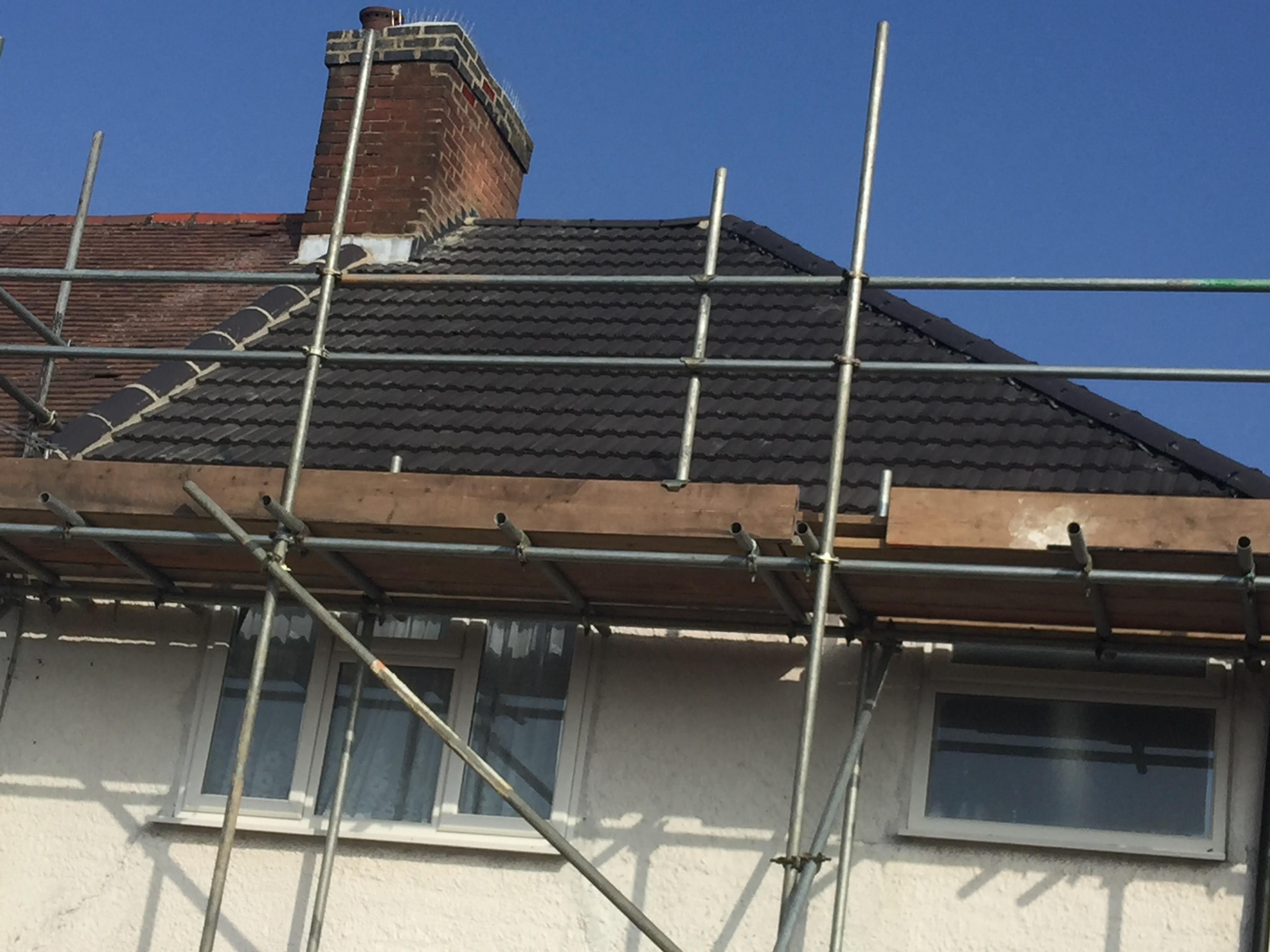

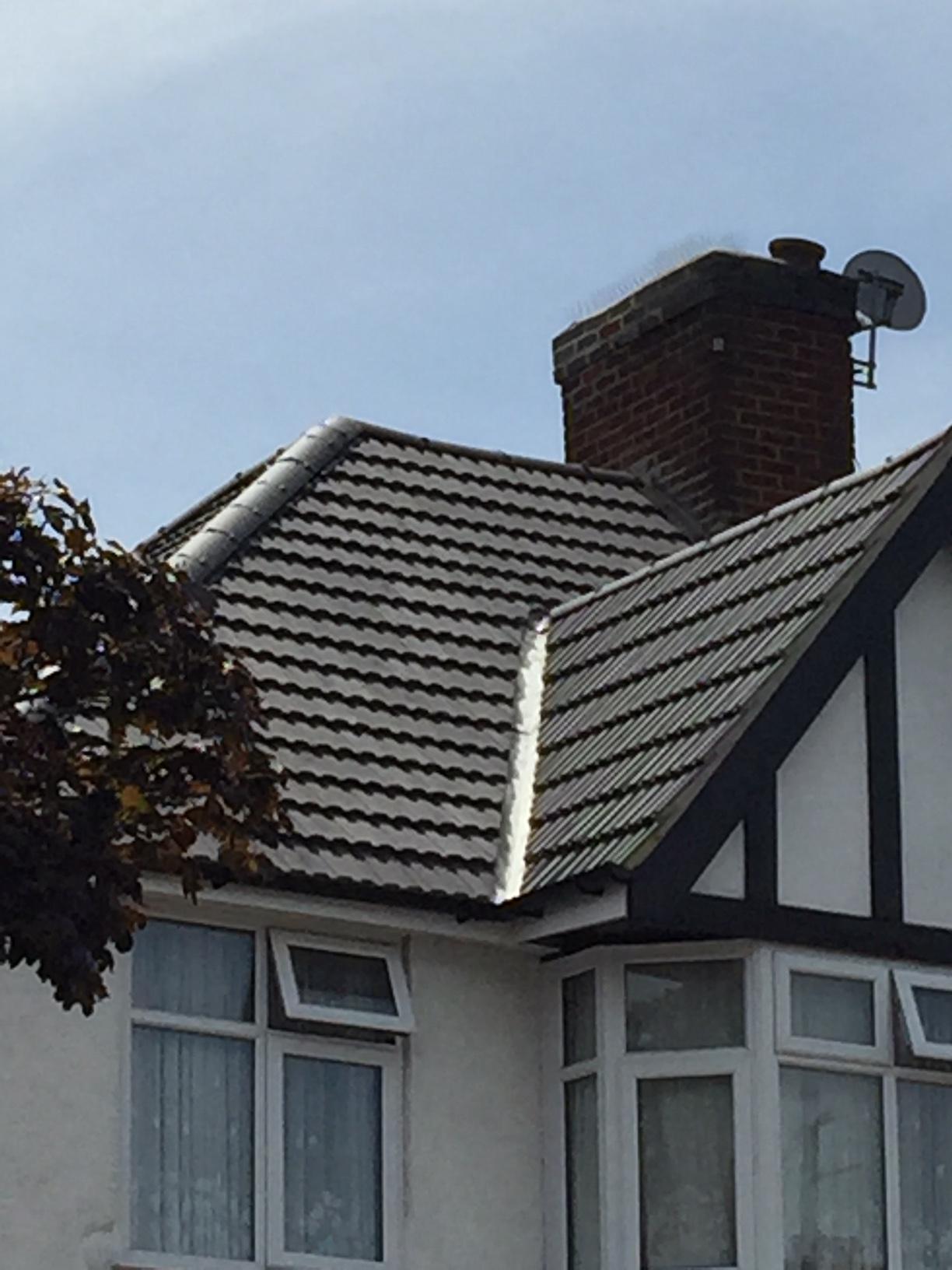

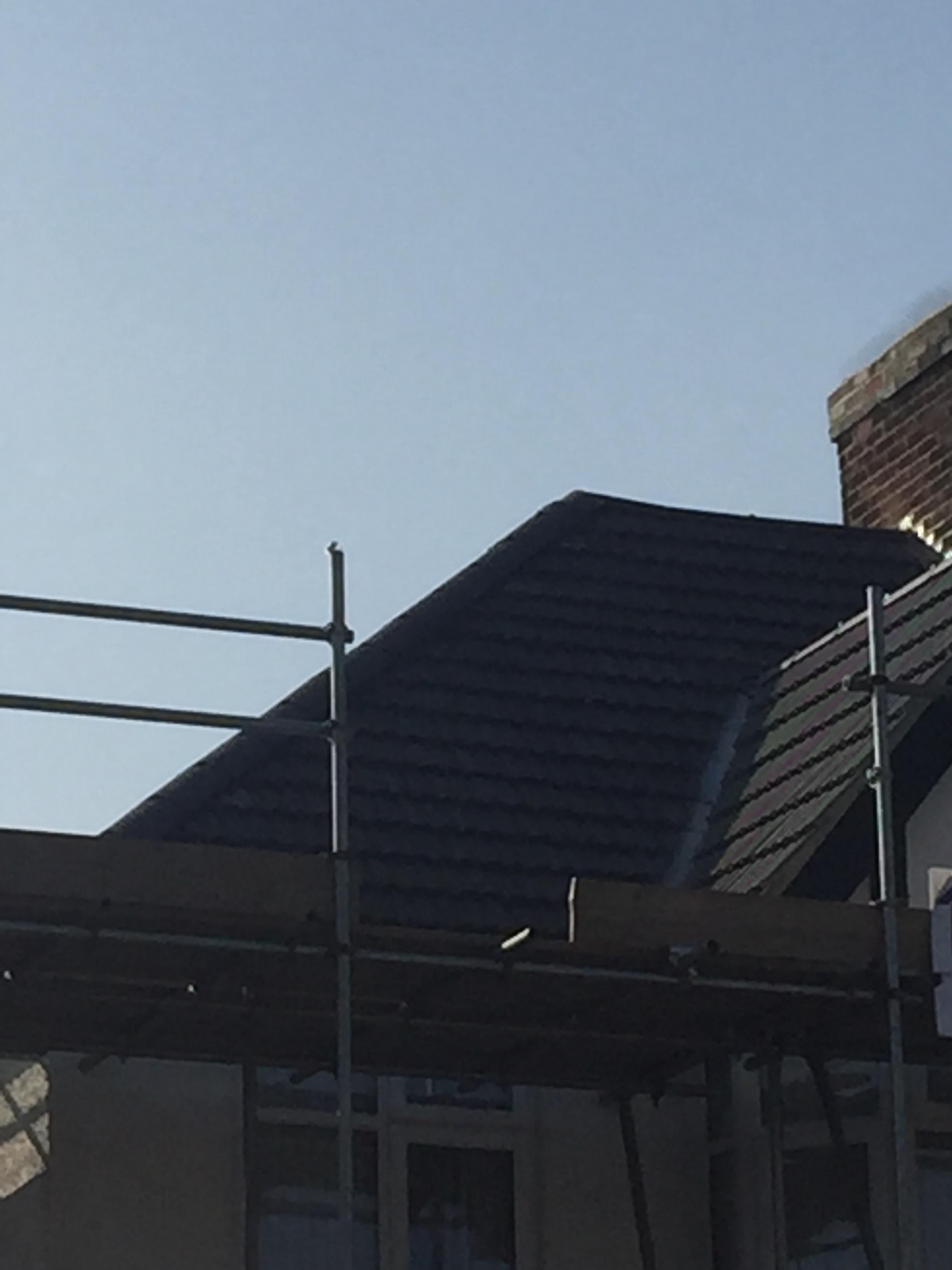

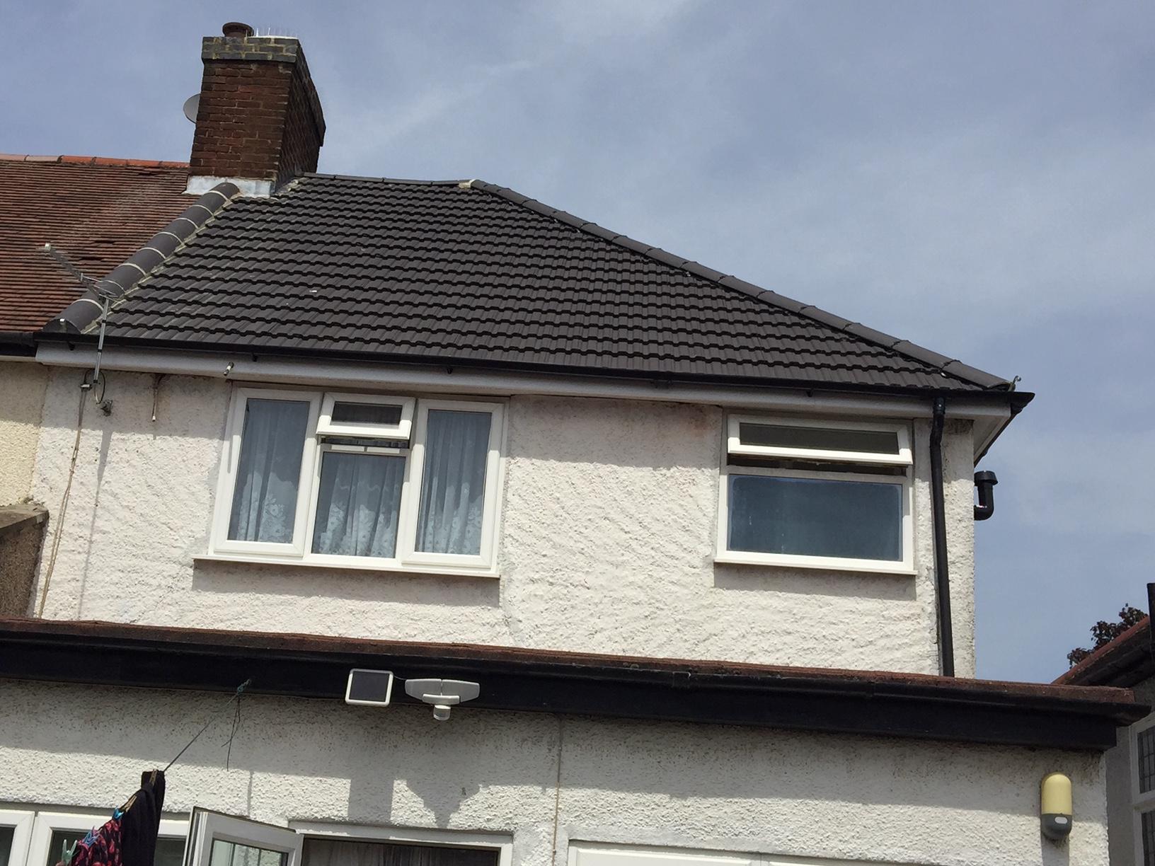

I have put up photos of the front and back roof taken from the ground floor. I will try and find someone with a ladder to go up and take photos from the scaffolding Any comments please. My neighbour who retired as a builder about 13 years ago tells me the roof is well done. It drizzled and I thought some sections of the felt in the loft space got stained with droplets of water. My neighbour says it is nothing to worry about but I am not sure.

Ok I will try to get pictures from the top of a ladder and post it for your comment, much appreciated.
