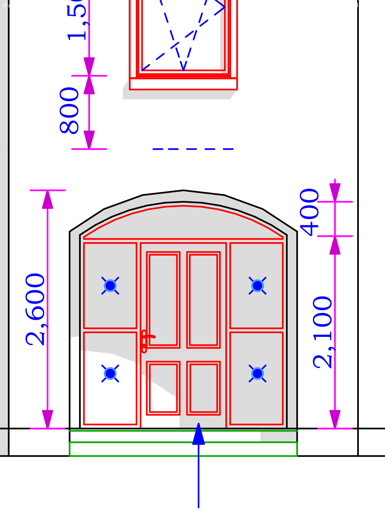

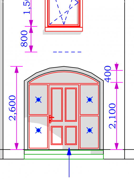

  18. Our builder is building our house that has an arched porch and then the front door set back with 2 side lights and an arched fan light above it. The builder has installed an arched Keystone lintel on the external arch of the porch but on the internal part where the door will go he has put a straight concrete lintel. I have attached a screen shot of the architects plans that he is working from - would it it be right to have assumed that there should have been a second arched lintel or how will the internal arch be achieved for the door to affix to? The first floor slabs are being installed on Monday so want to catch this if necessary before then! Thanks

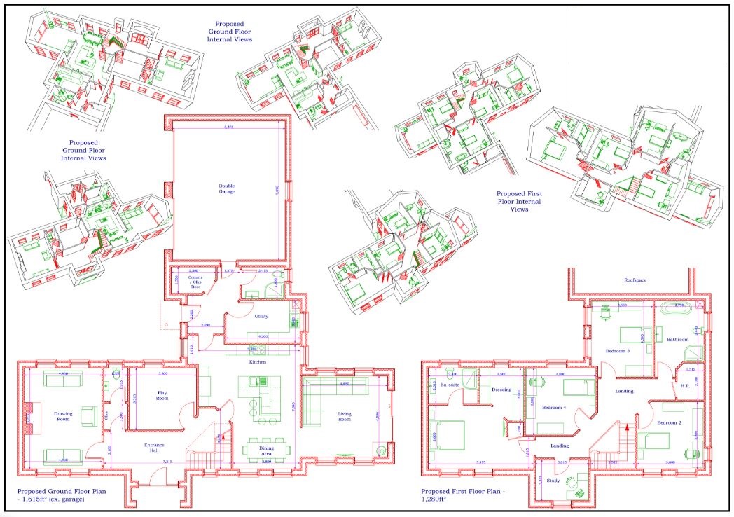

  19. Plans below for as requested!!
