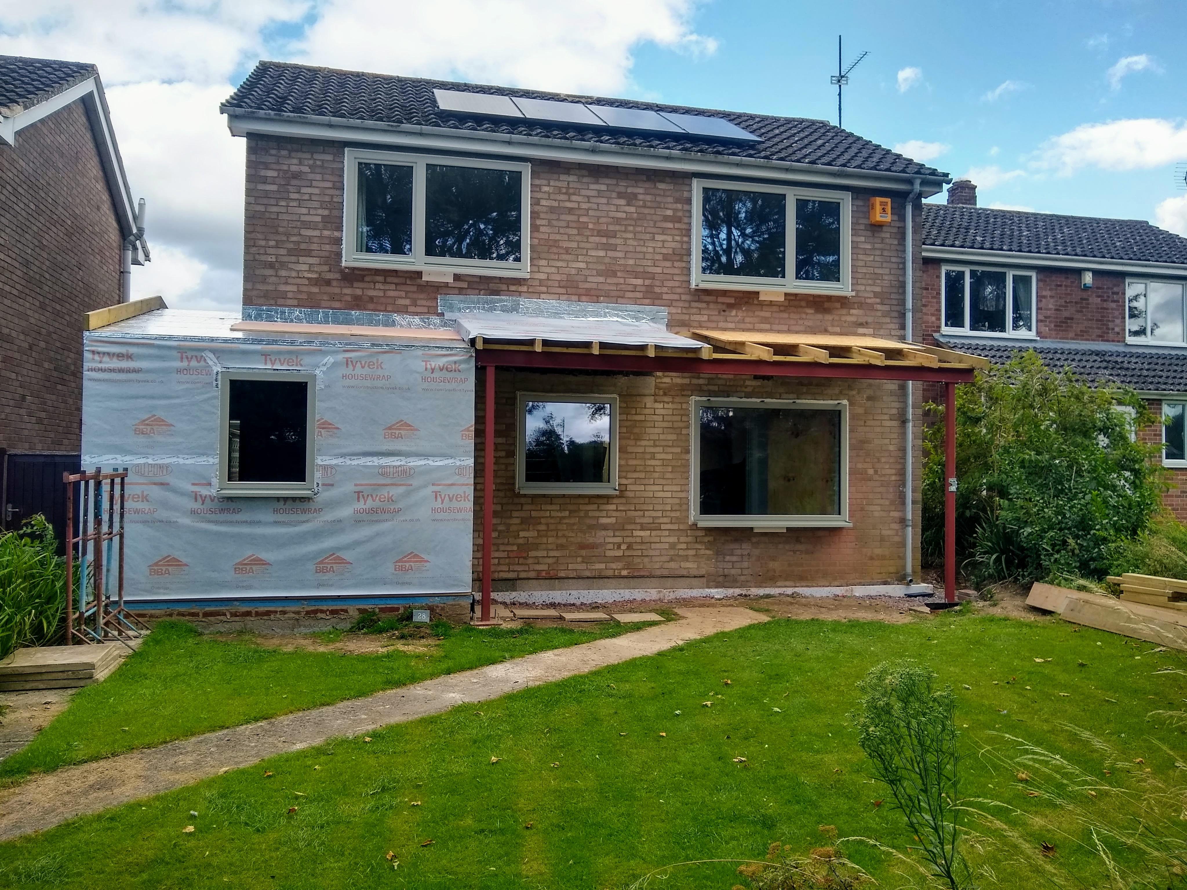

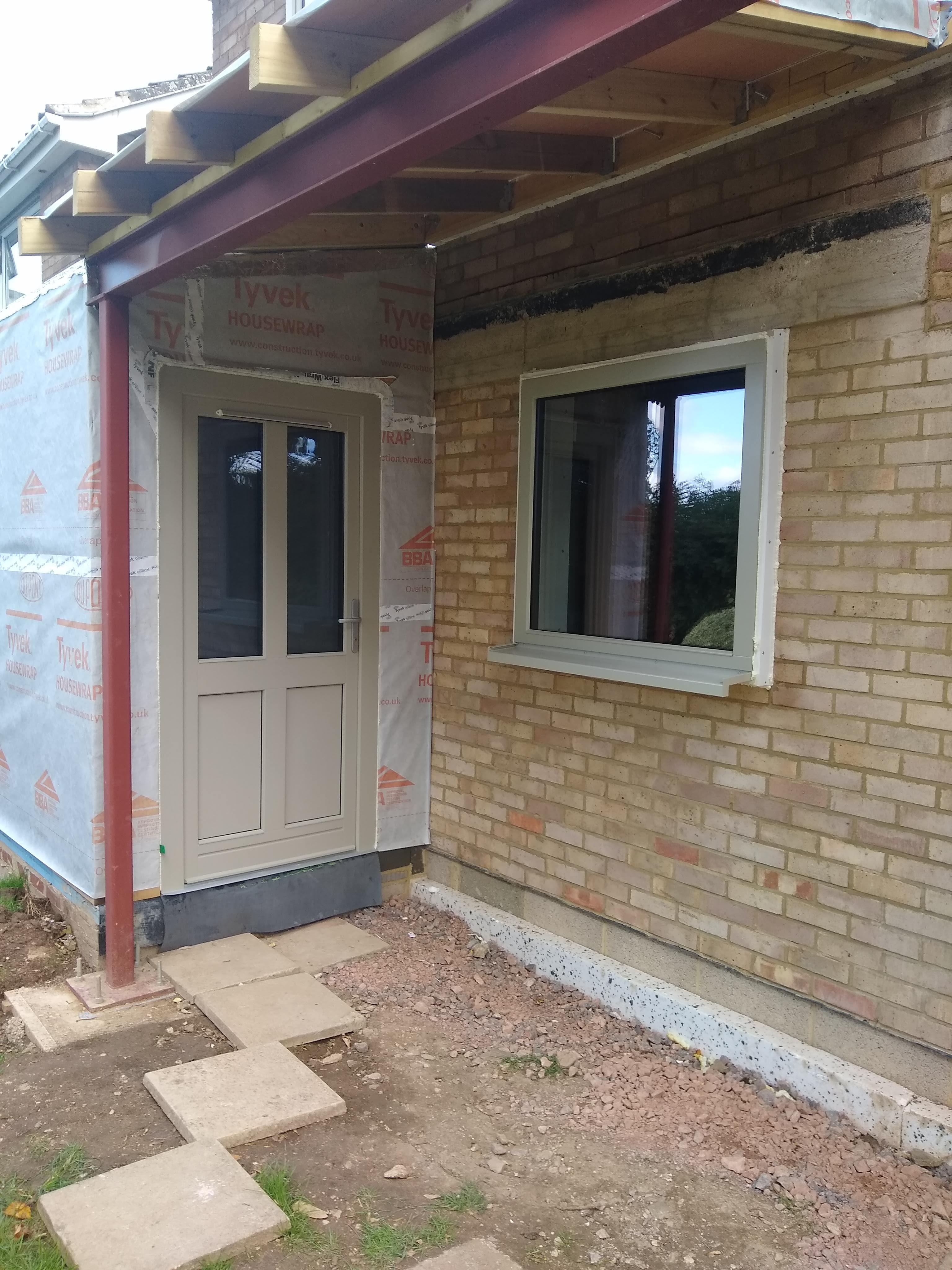

  1. HI, standard 18mm exterior ply, concrete screws into inner and outer leaf of cavity wall, and into conrete lintels IIRC
  2. We have very similar wall build up & had 150mm EWI We made plywood boxes to line the rough openings & project into EWI layer about 70mm For the larger windows we screwed a block of compacfoam to the external wall to add additional support, but not sure it was neccessary.. plywood boxes themselves were very ridged once screwed & foamed in. Additional benefit of air tightness taping being really straightforward
