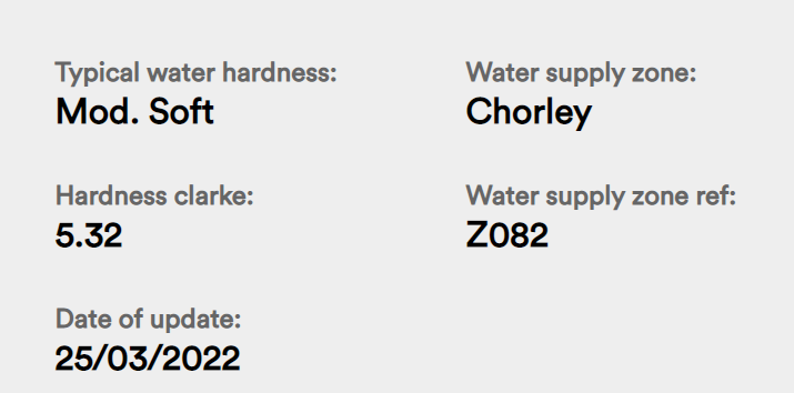

The statement from UU is that "the water supply to this area can vary in hardness from soft to slightly hard". That seems a total cop-out to me. But Worthington Lakes are literally 2 miles from our house (we are south of Chorley on the border with Greater Manchester) so there is every chance our village gets water from there. And the water there is definitely soft. I might just get it tested, though, to be on the safe side! -

That's the weird thing - our water is not that hard. I previously misread this information, and reported the Clarke value as PPM - it's actually 75ppm, which is still relatively low IIRC. Circulating pump is coming out this afternoon to be inspected / cleaned. -

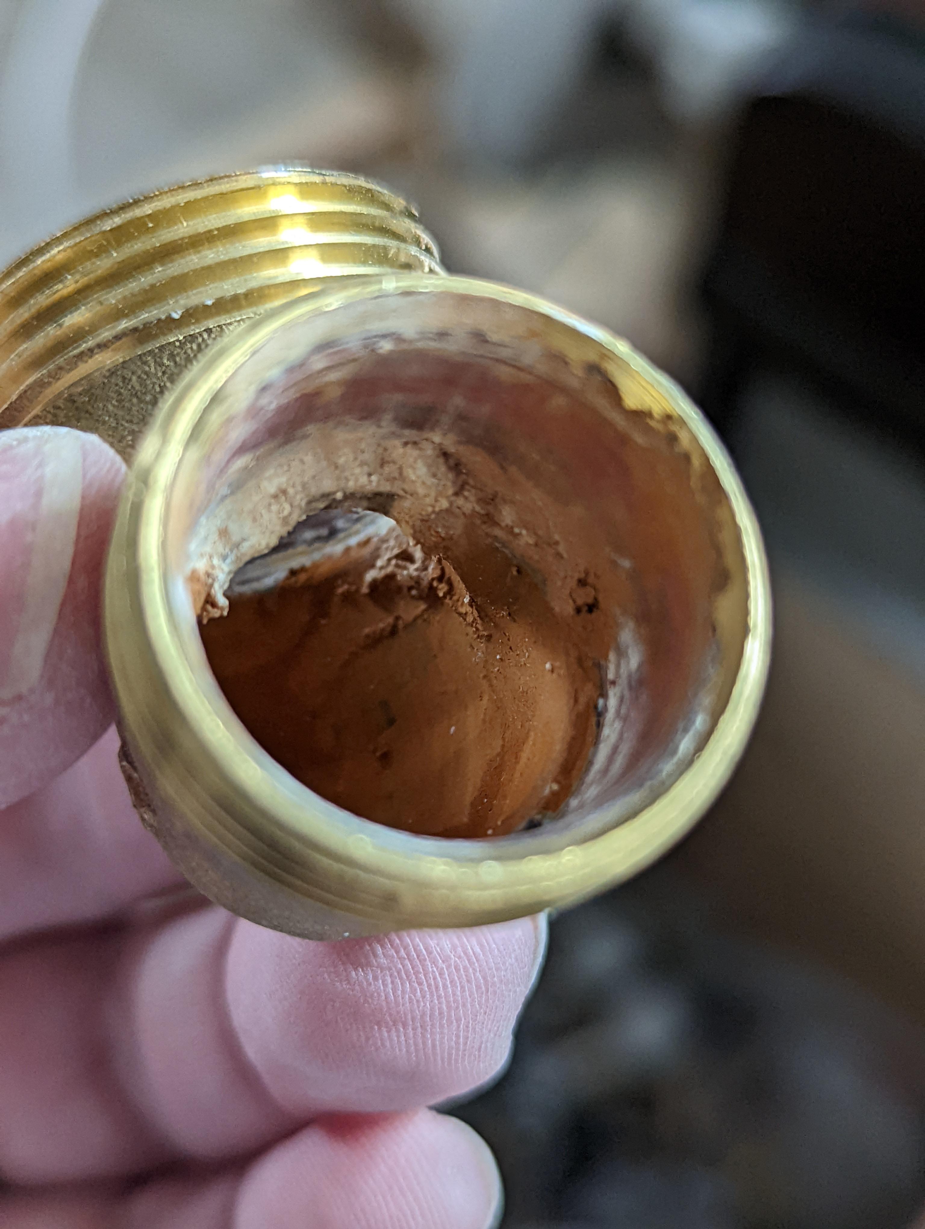

Ok so there is some extensive scaling inside the pipework. Given there was 1 litre of inhibitor in the water, I am not entirely sure how or why it is this bad after a little over 2 years... Is it possible that the cylinder was too hot at some point and this is the result of kettling? This elbow was between the PHE and the cylinder, so I am expecting this throughout now... -

Not hard water - "moderately soft" according to United Utilities (5.32ppm on last check for our area, which was apparently 1 week ago today). We aren't using a water softener. -
