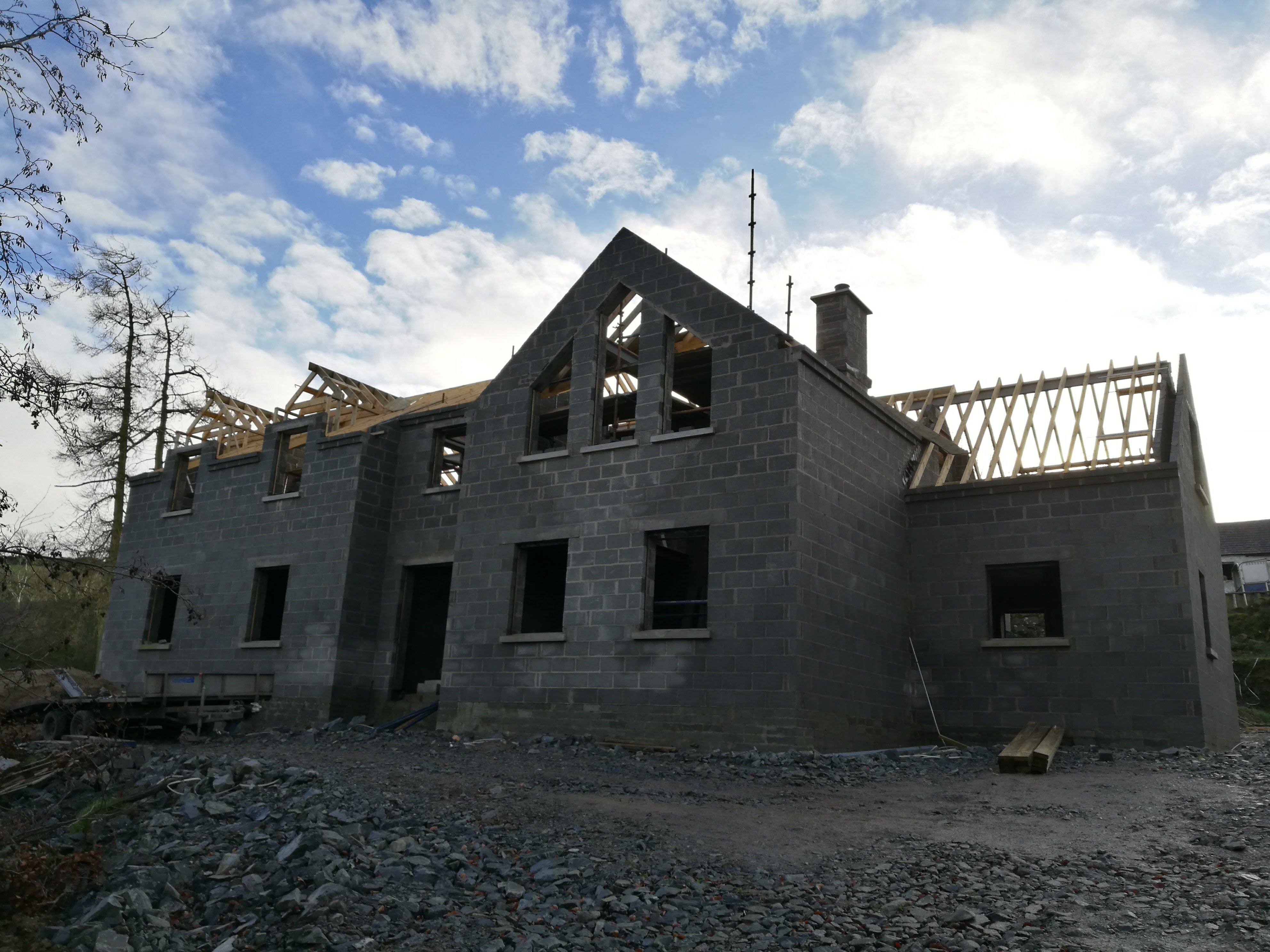

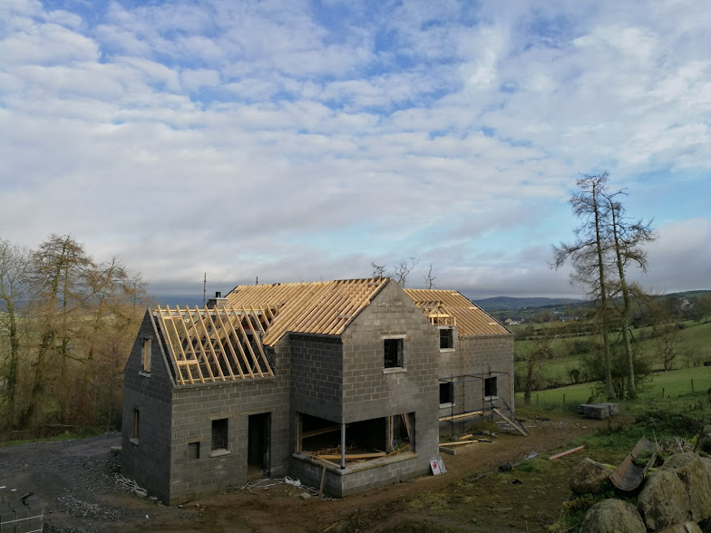

  12. Hi everyone, I've used this forum a few times for bits and bobs of info and thought I'd better join and contribute something back! We're building our home in Northern Ireland...bit by bit! I'm a total greenhorn and we are currently hiring sub contractors for all the work. Started last April (2017) and its looking like it will hopefully be August or September this year before we get in. Slow moving and hugely stressful but as the rest of you say, we have to just get on with it and it will be worth it in the end! I've attached some pics
