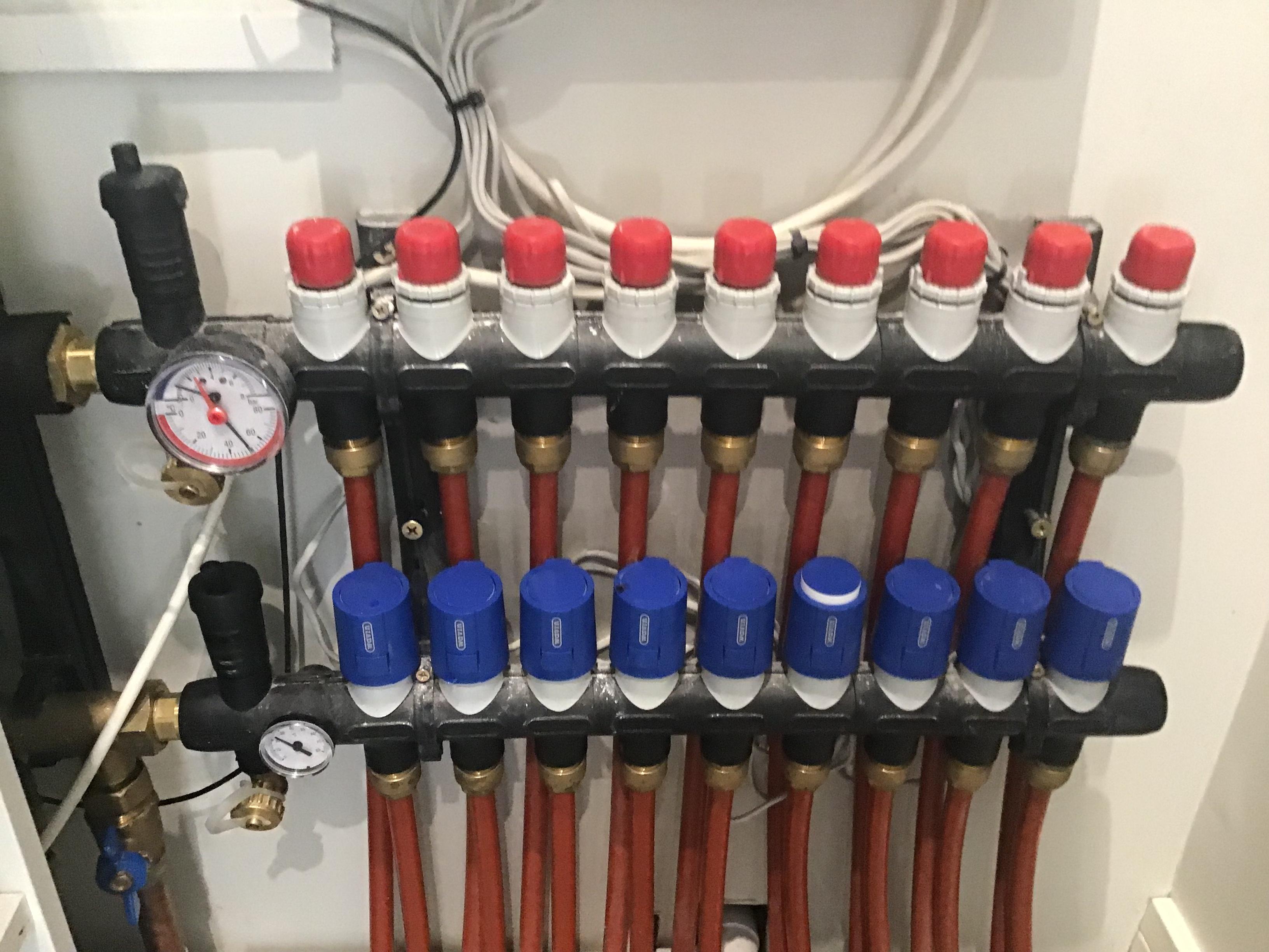

Mattsp's Achievements

  1. Just an update in this issue, I realised that the 2 port Honeywell valve for the downstairs heating wasn’t opening when the ufh system was calling for heat. I have replaced the actuator head of the valve and we are now back all nice and toasty! thanks Matthew

  3. Thanks for the comments, all of the actuators do work/open up, I just switched off all but one zone as a test. All of the actuator heads open up, I proved this when I flushed each zone through with clean water. Unfortunately my manifold does not have flow indicators, so I cannot detect if there is flow through the system. So am now looking for other suggestions to help me diagnose this issue? thanks!
