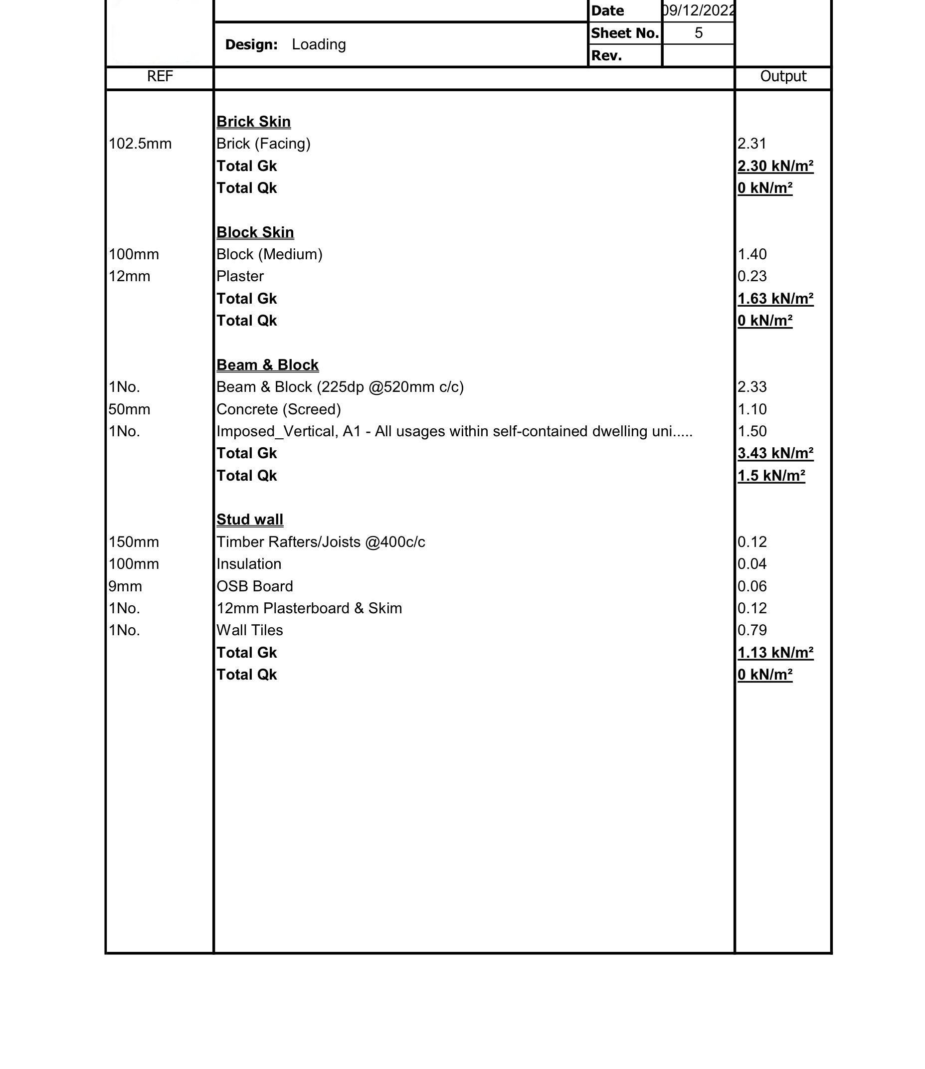

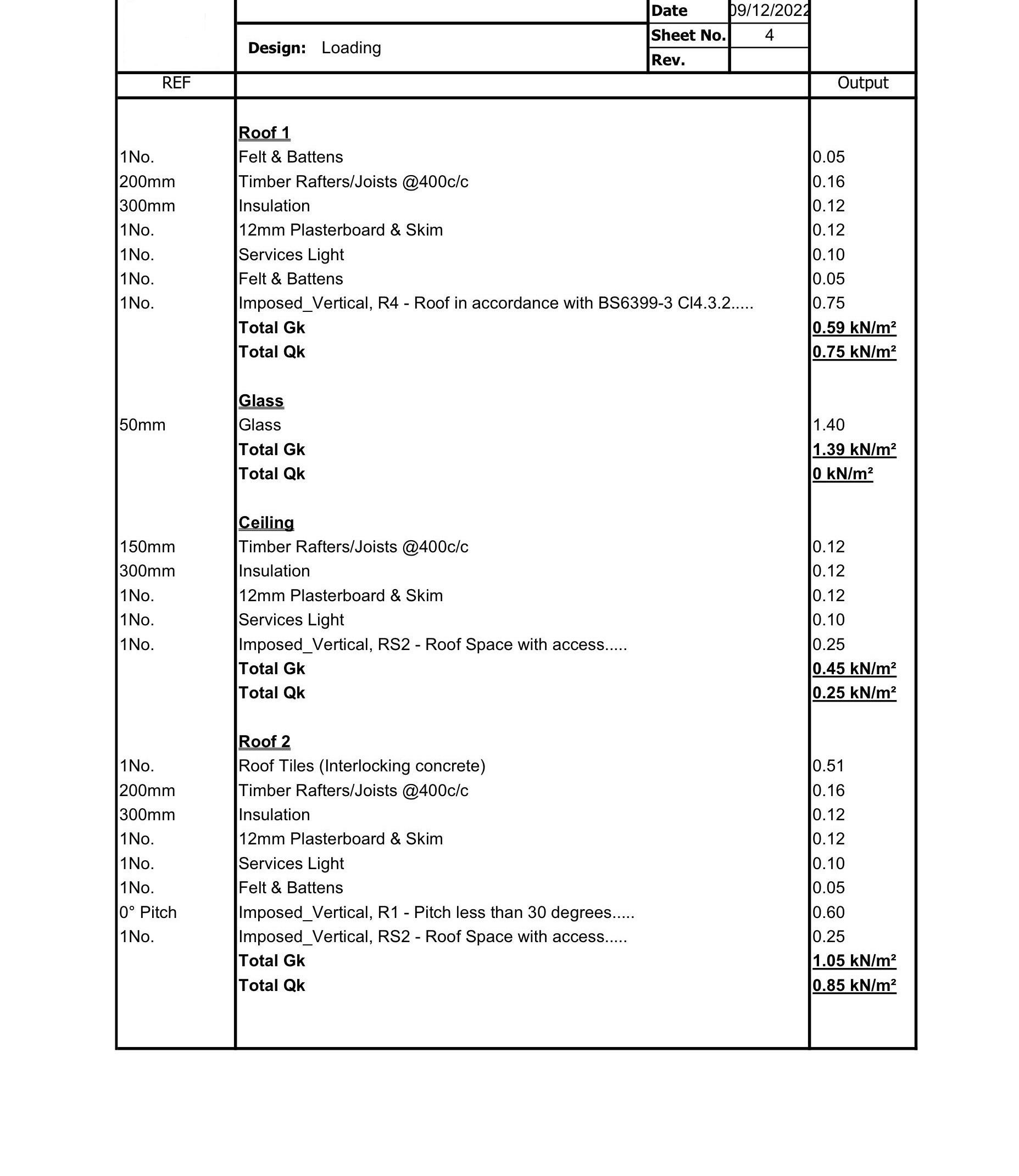

  4. What do these represent? The deal and live weights on the beam. How did he come up with these numbers?

  7. What does it mean? I trust you have gone through the thread, so reading all this, does it justify the design?

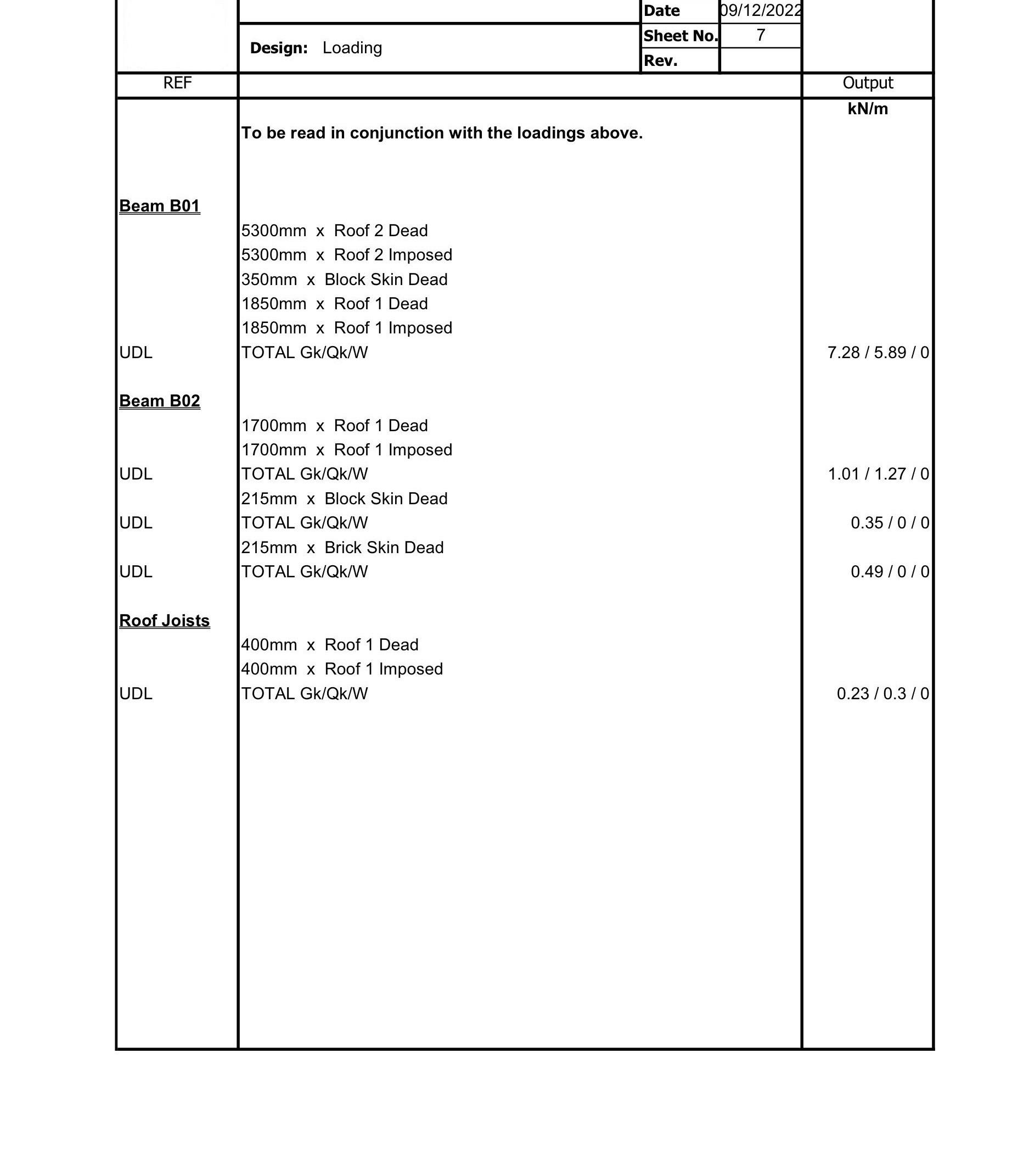

  10. So what does sheet 5 mean? Where did he get those from?
  11. The SE attended and made a full survey before we sat down and talked about my desires and what was possible. He took full measurements and I made sure he knew there will be no near or far future to go up with the build, not even a loft conversion. There are few mobility issues, including steps, stairs, all dangerous around my son and I will not compromise his safety for more unneeded space. so are you saying that the extra block and brick and first floor dead and live loads all part of the appropriate calculations despite they don’t exist?

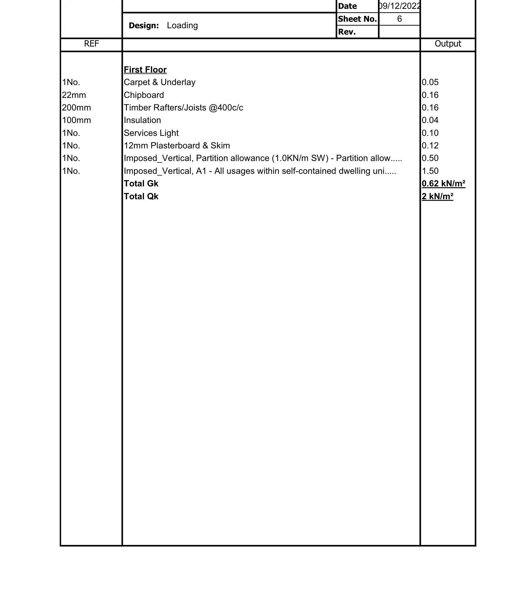

  14. Yes. They have been greedy because the terms were agreed for the build and it stated any alterations will incur extra charges to be decided by the kind of change. These are different builders. Last year’s work is all coming down. BCO said it has to go. These guys only came for the job of taking down the load bearing wall, prepare for and installing the beam. I am doing a phased job due to finances. I just wanted to close the roof so I can move in.
  15. Can anyone see that he is calculating a whole new masonry floor rather than just the loft space?

  20. I was under the impression that he did, but just discovered BCO said everything has to be redone from ground up. He only approved foundation.

  24. On another note, would someone kindly turn to page 7 and tell me this “First floor” is meant to be there for a single story property? I had and have no near or distant intention to have a loft conversation or build anything above so not sure what to make of this. Or is it standard for the loft area?
