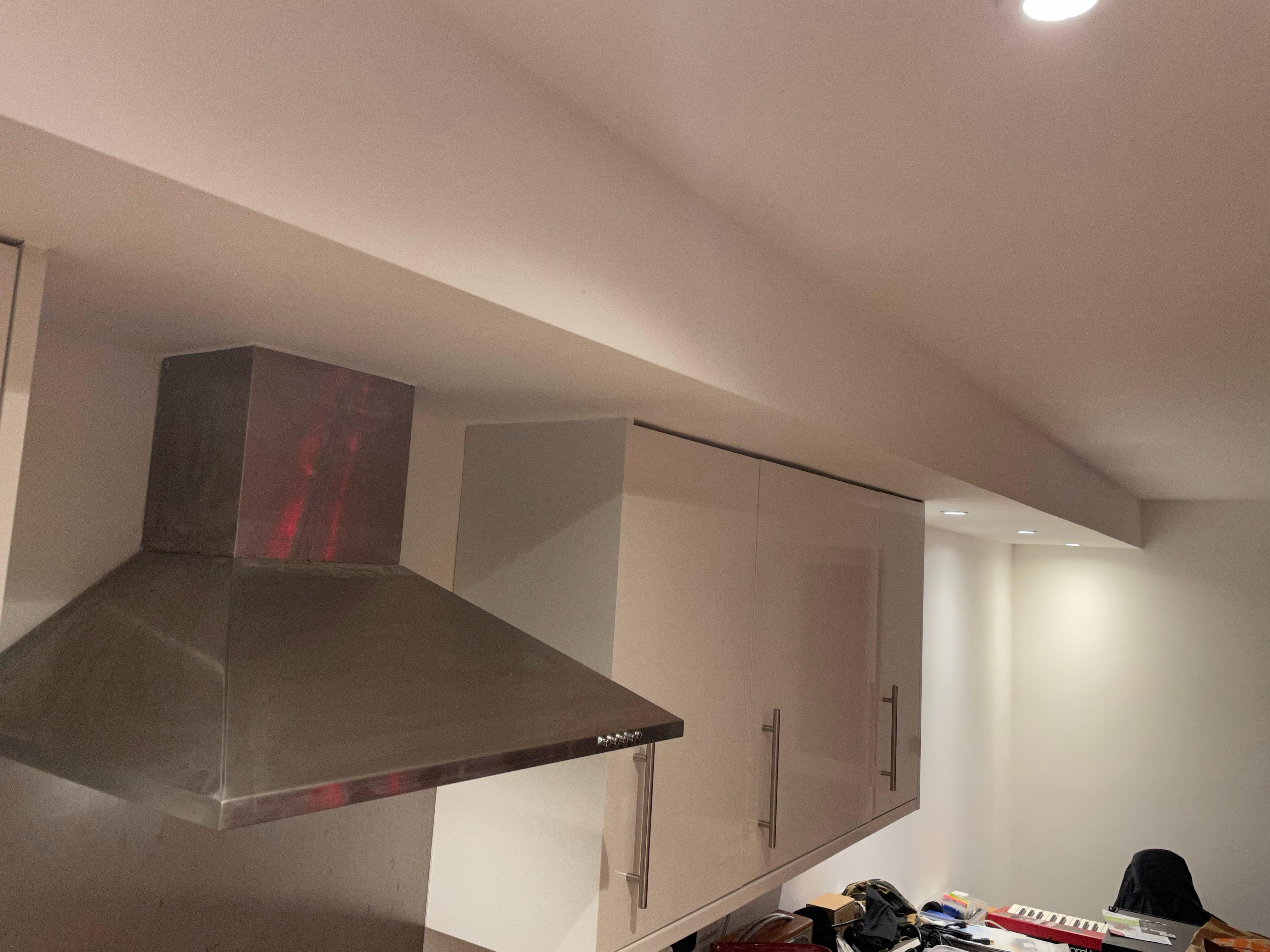

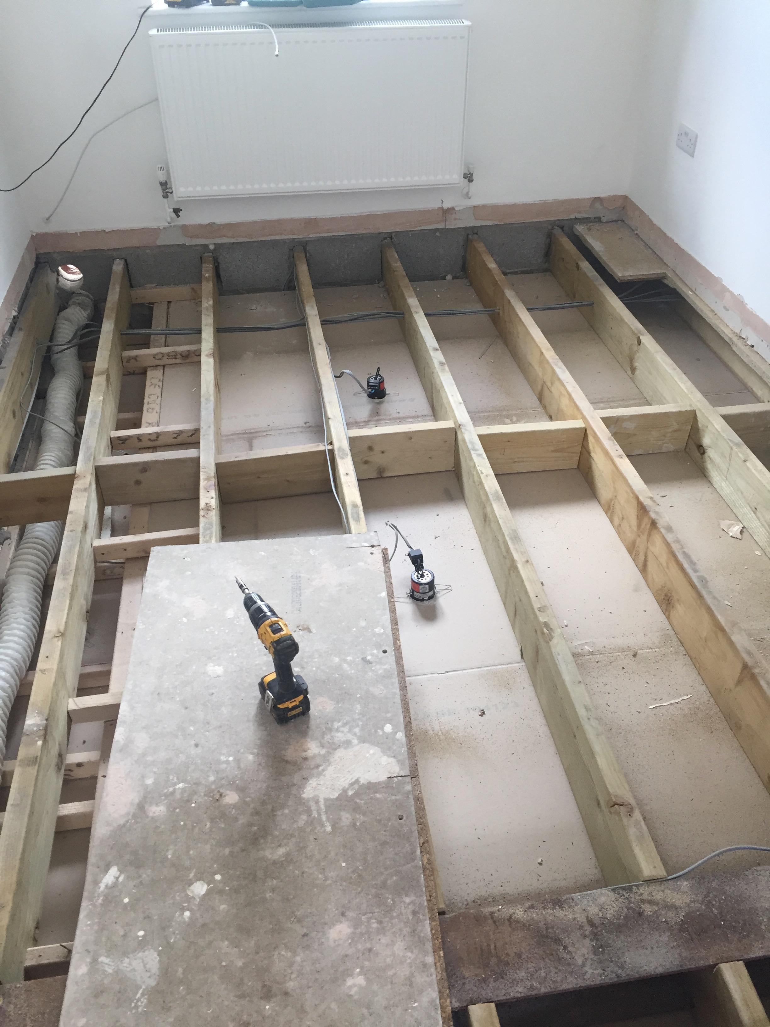

I just realised that noggin in the bulkhead could obstruct a rigid pipe... I'm wondering if I can remove part of the bulkhead joist that's against the wall and core thru directly behind the extractor. Not sure how structural it is..
I found this study that shows compressing flex duct even by about 10% halves its cfm compared to the same diameter rigid (or flex at full extension). I think I’ll try shoving some 125mm rigid pipe in through a new hole. https://www.energyvanguard.com/blog/the-science-of-sag-flex-duct-and-air-flow/
Is rigid duct that much better than corrugated? also, do you know where I can get 5m of rigid plastic 150mm/125mm/100mm ducting? I can't seem to find any more than 2m long
Yeah I ditched the crushed plastic duct and replaced it with new aluminium 100m duct , before I realised it wasn't wide enough for most modern extractors. By then the floor had been put down. I was thinking maybe I could push/pull rigid ducting through a new hole in the wall, though as I said, there's a lot of RW3 in there now that might make things tricky.. Why would it be noisy?
When I was looking around the attic yesterday, I notice the main enormous beam (probably not the proper term for it!) that holds the main part of the roof up (its an L shape roof), is only held in by bricks and mortar on one side. There is a similar sized beam that meets it at 45 degrees on the other side, but I just wanted to check if it looks normal and safe to be balanced like that!
My 350m3/h cooker hood is 4.5m from the exterior wall, and is currently connected to an exterior vent with 100mm aluminium ducting inside a bulkhead. I'd like to have better extraction, 500m3/h or more, and it seems like I need 150mm duct for higher powered hoods. Unfortuately the floor has been glued and screwed down over the bulkhead now, so I was thinking maybe I could connect the 150mm duct to the old 100mm duct and drag it through the bulkhead? It might be tricky because there is quite a bit of insulation in the bulkhead now, and additional timbers to level the floor mean the duct has to bend around a timber as it exits. Then I would need to core a bigger hole in the exterior wall - is it possible to cement up the old hole in the cavity wall and core a hole about 10cm to the right, so the duct doesn't have a kink at the end, or would that weaken the wall? Any other ideas? I would go straight out behind the hood, but there are timbers, pipes and a waterproof membrane that make it complicated...
