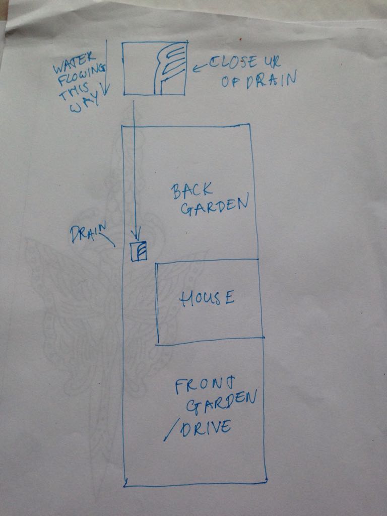

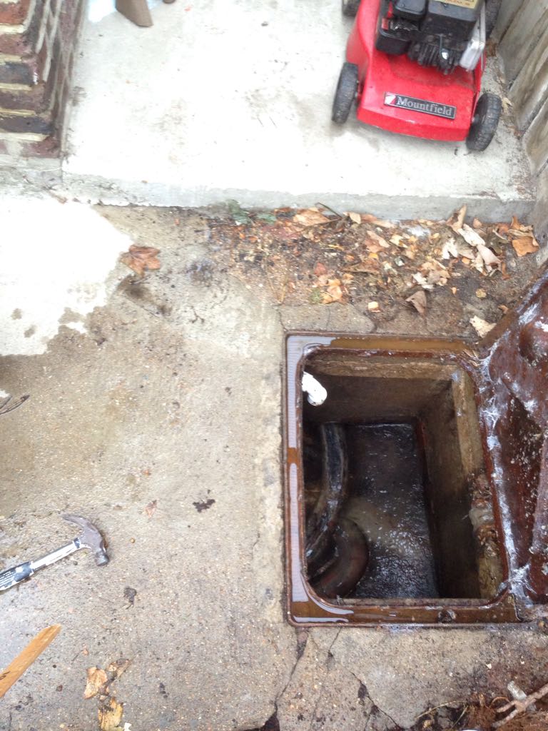

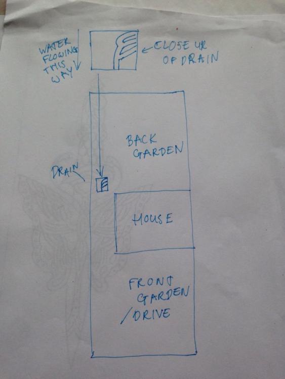

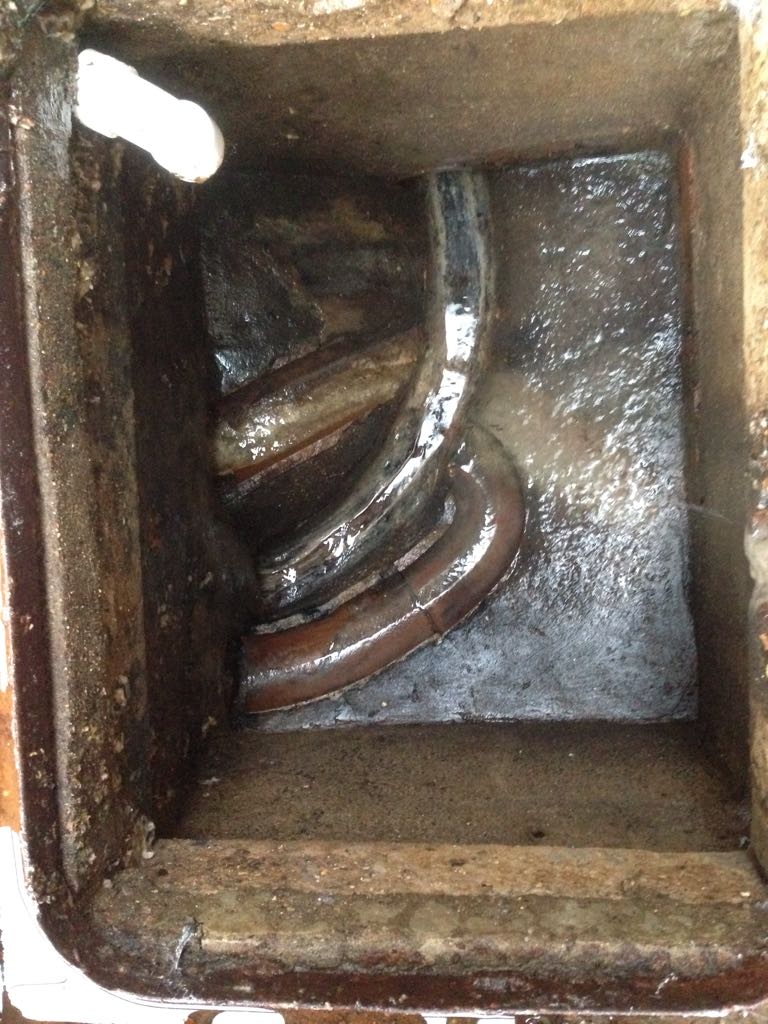

New Member (2/5)

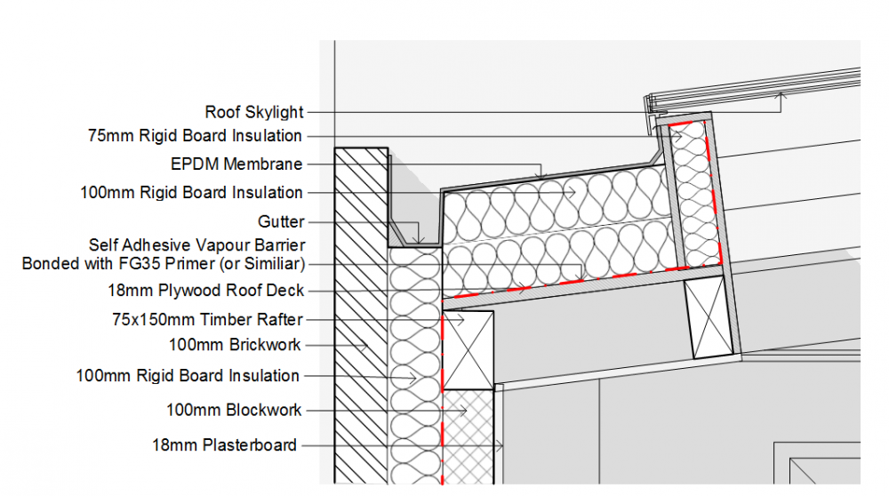

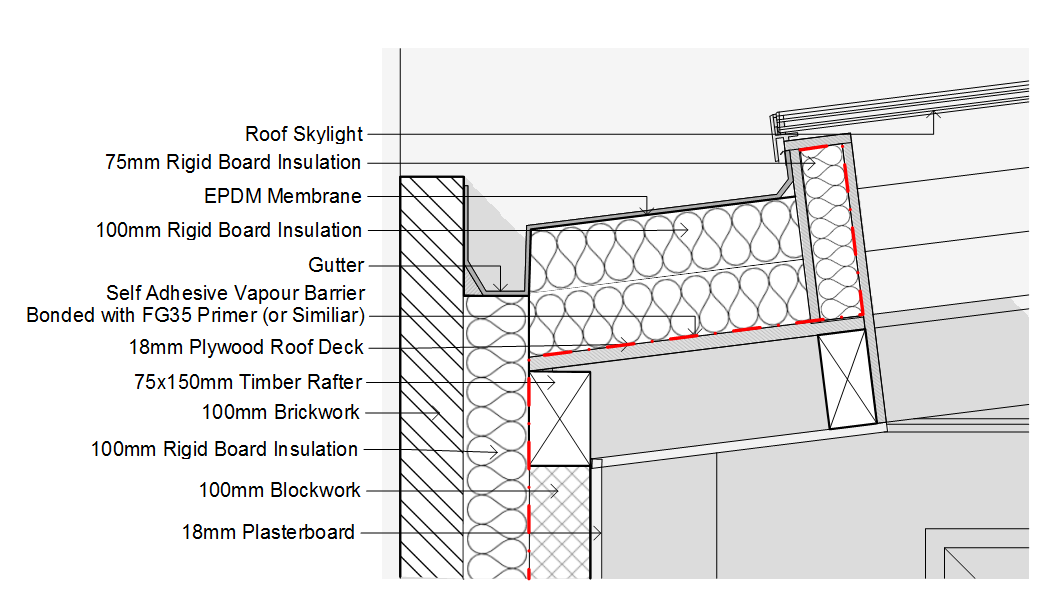

  1. Hi Ferdinand - many thanks for the comments. The detail of the gutter lining finishing definitely needs further development - as you suggest I was planning to mortar into the brick joint. You raise a very good point about access and maintenance, there are two existing windows roughly above the gutters at either end of the proposed roof. These would be ok for cleaning the gutters, although if repairs were required it would obviously be preferable for the roof to be able to support someone. The proposed roof has two large skylights so if the additional weight of a person has to be factored in then maybe I need to run it past a structural engineer before taking it any further. Thanks again, JM
  2. Thank for the tip - I'll have a look into GRP - always thought EPDM may be more likely to leak at junctions so GRP could be a good call.
  3. Many thanks for your helpful replies. I've started the process with Thames Water as suggested and it seems to be going ok! Thanks again! JM
  4. Hi all, I'm designing an extension to the rear of my house and was planning a very shallow pitched roof with a couple of roof lights. Having struggled to find the exact detail online I've drawn up the detail below indicating the roof junction, skylight & hidden gutter. I have little experience in construction and would appreciate any comments/potential problem areas. Many thanks, JM
