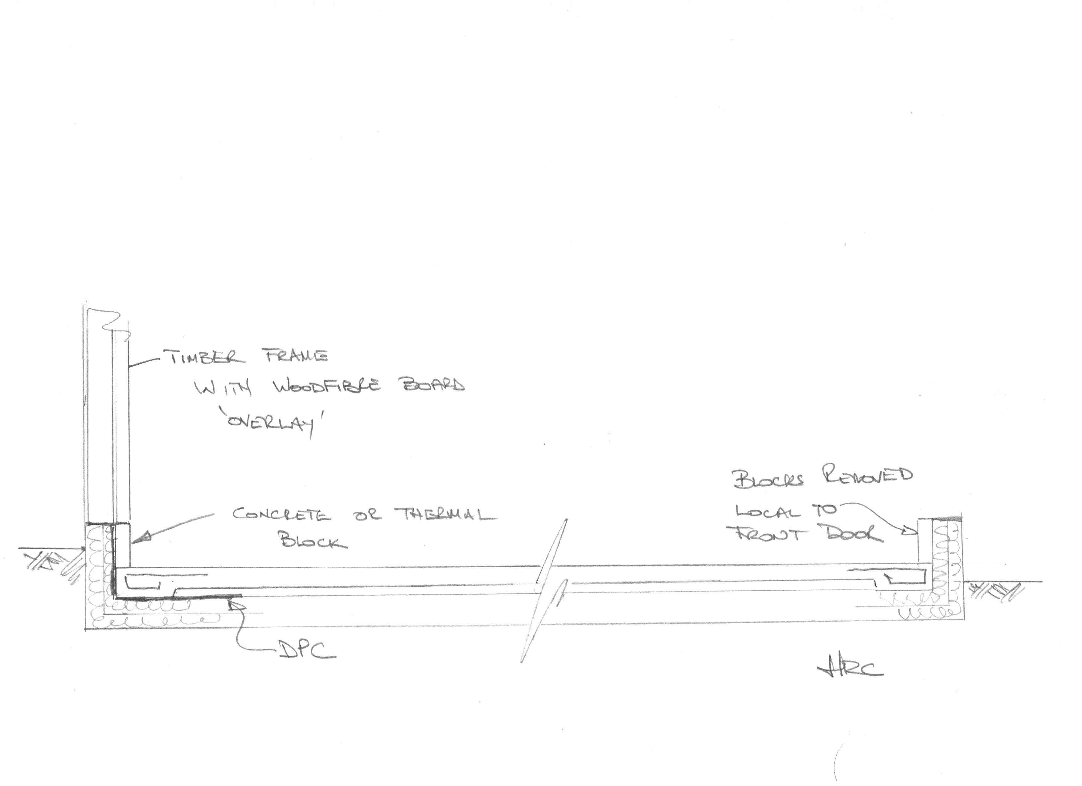

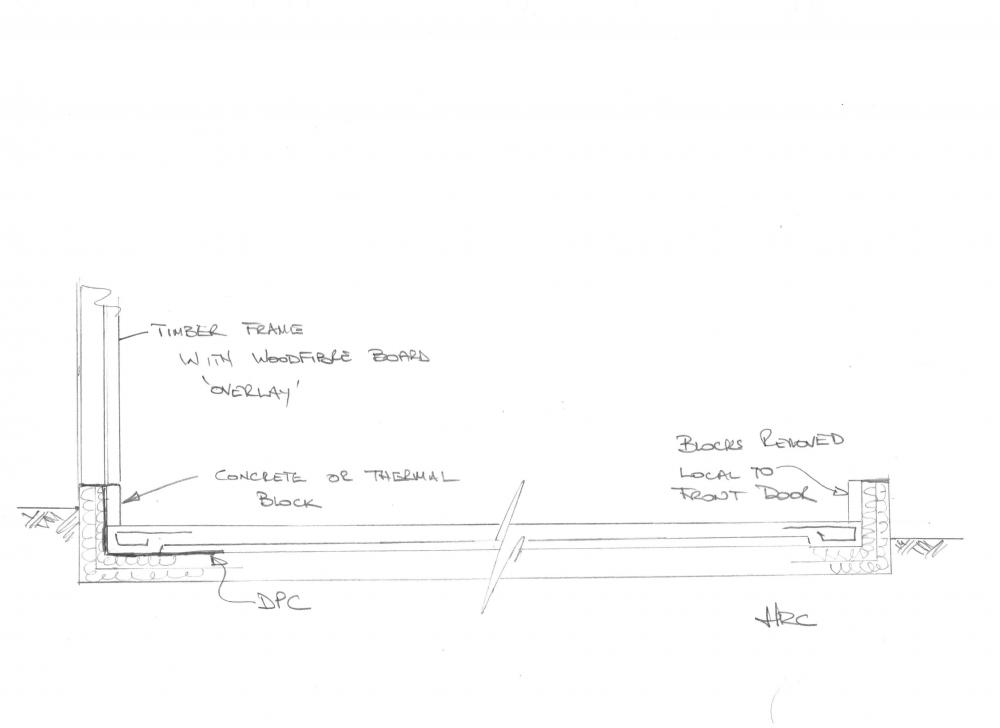

  7. Hi all, thanks in advance. While I'm waiting for the "result", I thought I'd run this idea past the forum, My site has a slope back to front of about 250mm and my thinking is to cast a standard passive slab (Viking/MBC/Kore) except that I would lay a concrete or thermal block, advice please, (cut to size for the slope) along the perimeter of the slab, and extend the EPS insulation up to that level on the outside. Apart from the problem to sort out with steps out to the rear garden, the front should be okay as the ground level will be 'correct' and I can remove the blocks locally - can anyone see anything I've missed in terms of cold bridges/structural etc Many thanks Henry

  13. If the combination of a level concrete foundation and a straight timber soleplate is difficult to achieve a perfect fit would it not be possible to lay a neoprene or EPDM strip, say 3mm thick to take out any imperfections?
  14. I am about to raise this with Bentleys (and a couple of other points). I was considering the EPS external insulation (ala passive slab) would be higher externally and thus give some support to the external woodfibre, which would 'overfly' all the wall/eaves joints and prevent cold bridging. The external cladding, depends on planning approval, would then 'join' with a rendered protection at low/ground level which would protect the EPS H
