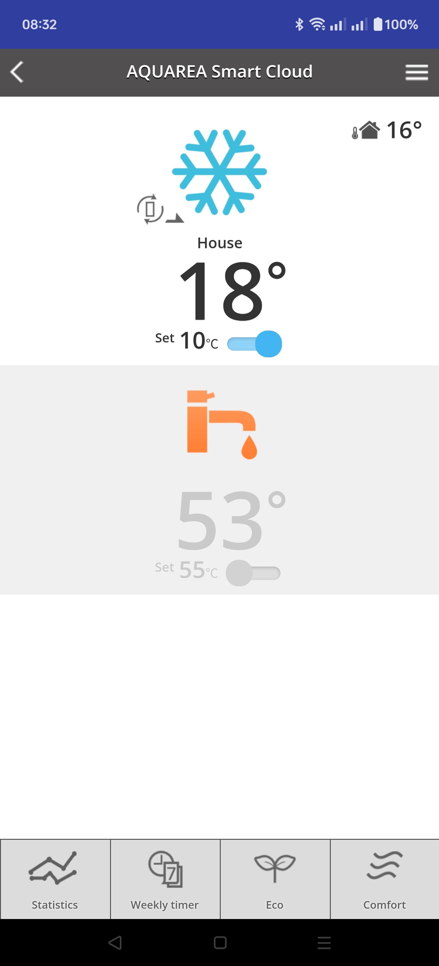

Well, I don't think I did anything, but that's it running now! Is there a lower outdoor temp it won't run below? I was playing in the evening last night, so possibly just too cool to kick in.
It has zone & sensor set to use 'room temperature: water sensor' to sense demand so I can use a compensation curve. When heating is 'on' it then keeps its loop at the set temp, which keeps the buffer at the temp, which keeps the heating at the temp. I run open loop in winter, so although I have room controls, they are all set up at 22, and I don't think the (heatmiser) heating system is electrically or logically connected to the HP. That said, I can create 'demand' by setting a room temp up to 30 degrees when it's warm to get the heating water circulating, but the buffer and HP loop stay at 20, despite a target temp of say 12. I'm hoping someone that used the process from the manual above to unlock cooling can confirm if anything else was needed.
(Wouldn't normally have it on at these temps, or set this cool, just did this for the pic). But no activation of the HP and therefore no cooled water ☹️.
I've just tried this but am not getting cooling. Unit is cooling enabled, I have a target temp of 12 configured as a 'direct' temp, cooling shows up through the whole UI, but it's not firing up to actually deliver cooling. Does something physical need added as per post 2 or 3 from the start of the thread? Either a terminal short or cooling stat? For heating I'm just using the water temp to call for heat, so no heating stat or connection to the heating system.
