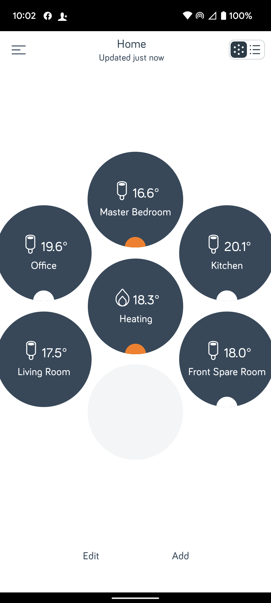

  2. I've got an ThermaV Monoblock installed with a Hive thermostat and I'm beginning to think the hive is a bit crap and causing problems. Set temp is 18.5°C, as soon as it hits 18.4°C lots of energy getting the system up to temperature then 18.5°C and it's off again. It's wasting a bunch of energy. Does anyone have any suggestions? I've complained at hive for not giving any options for hysteresis so it can swing 0.5°C either side of the temperature target but they fed me some BS about the hive algorithm is the most efficient at maintaining a comfortable home temperature. I'd be willing to try just using the native LG controller but that doesn't seem to have any heating controls available. Can they be enabled again and if so how? Any suggestions for other thermostats that actually work properly? Thanks.
