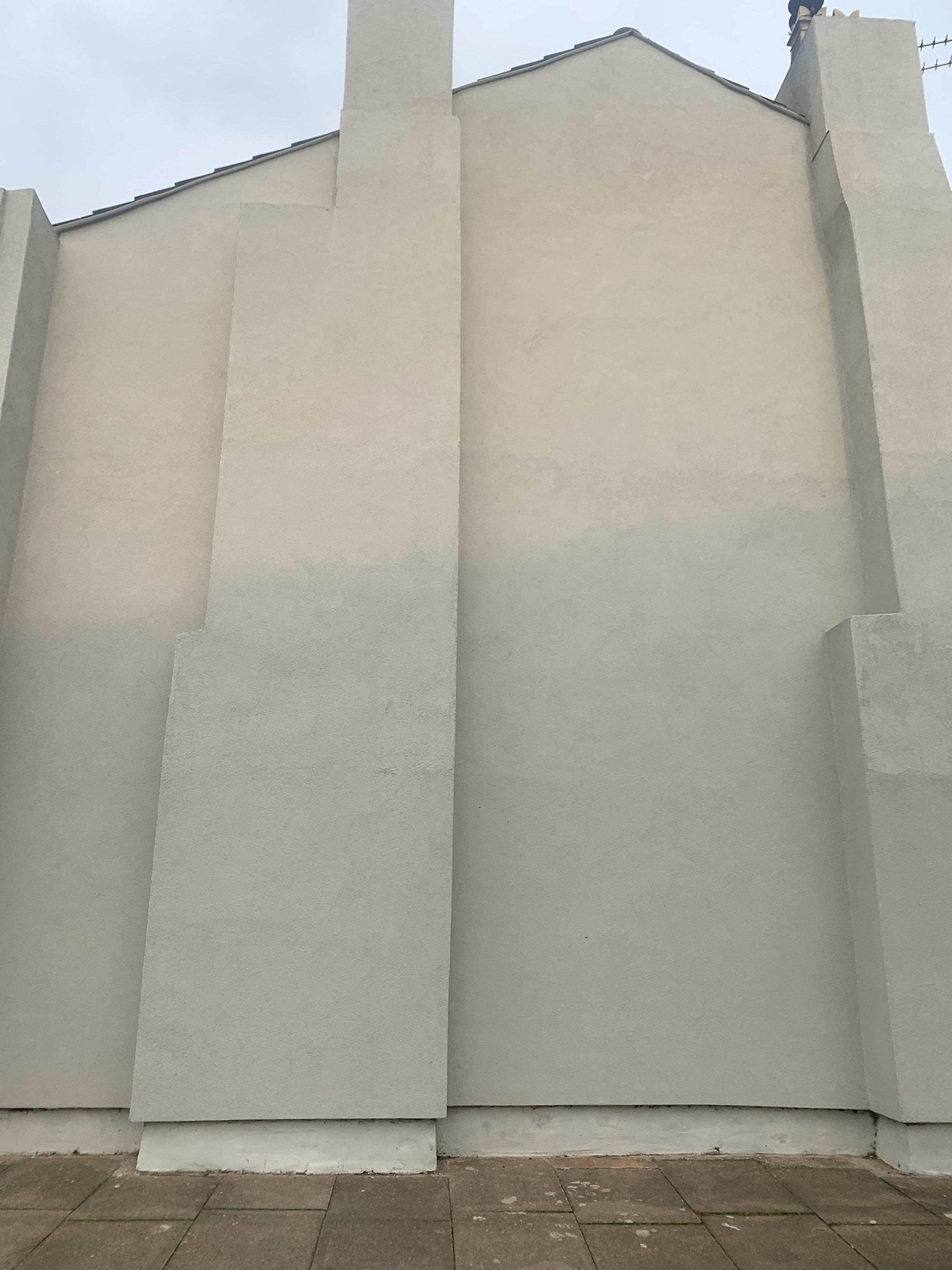

  1. Hi hoping for some reassurance I had rendering done on a large gable end and am happy with result - but they have used concrete to fill the gap below the render to ground level. This is because the exposed brick work was in a terrible state. Can anyone reassure me that this concrete is suitable? My questions are if there is a better alternative ? They are due to come back to do other work so could raise this with them when they return.

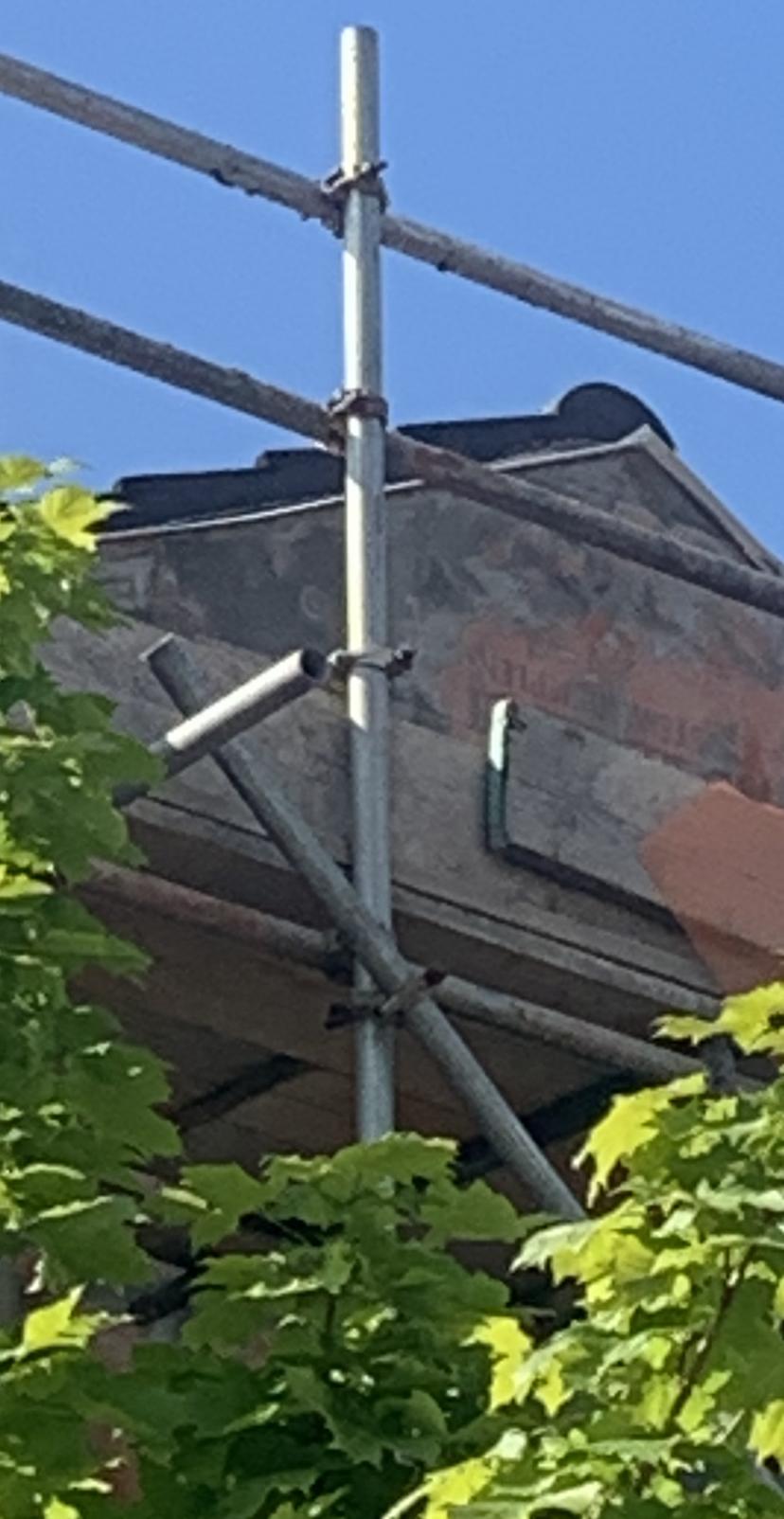

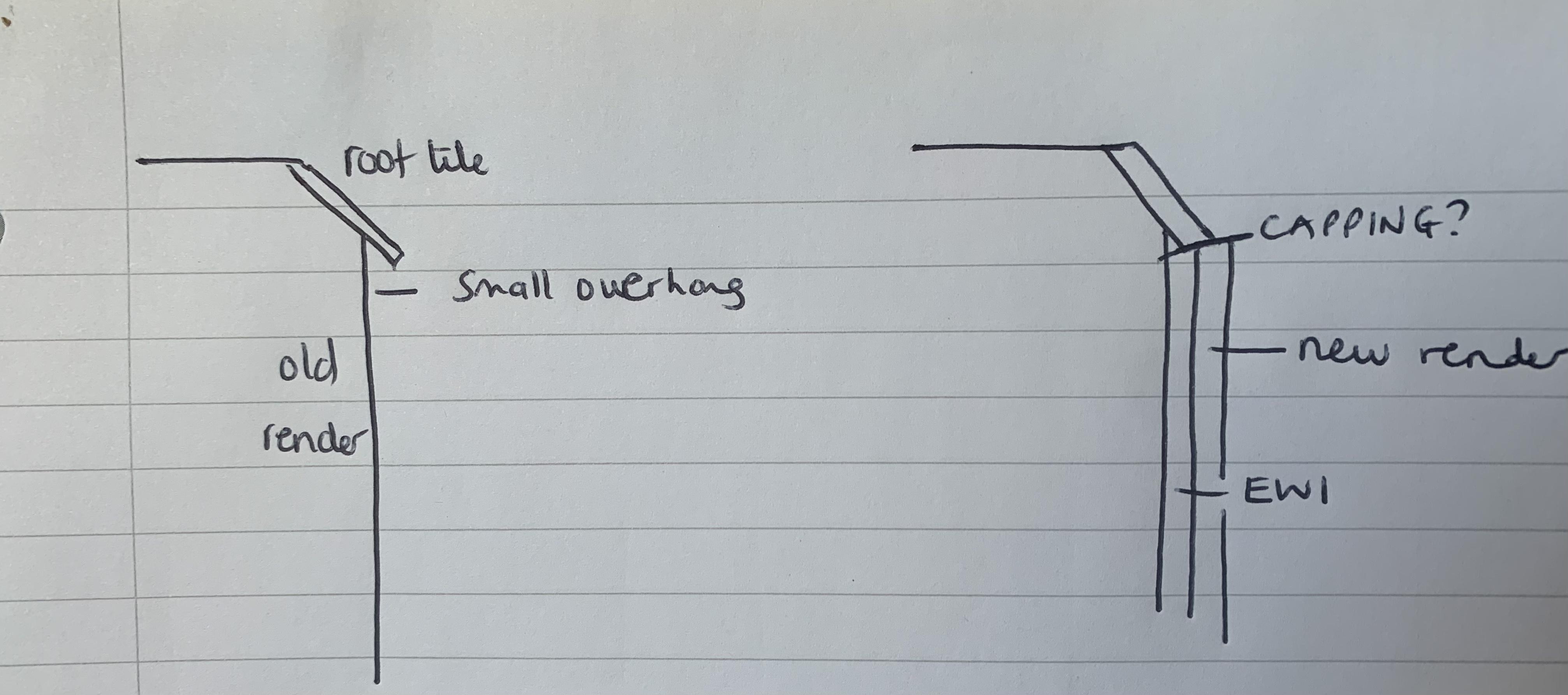

  3. Hello Having my gable end re-rendered currently with external wall insulation beneath and the extra layering means there is very little roof tile overhang left. They have placed a ‘capping ledge’ along the top of the render as it meets the roof edge, fitting just under the roof tile edge and assure me that that will be water tight. i am asking them about a dry verge to make sure the top of the new render is fully sealed. Do you think this is necessary? Photos showing the white plastic capping - not yet rendered to the top - and my hand drawn diagram to explain the current ledge they have
