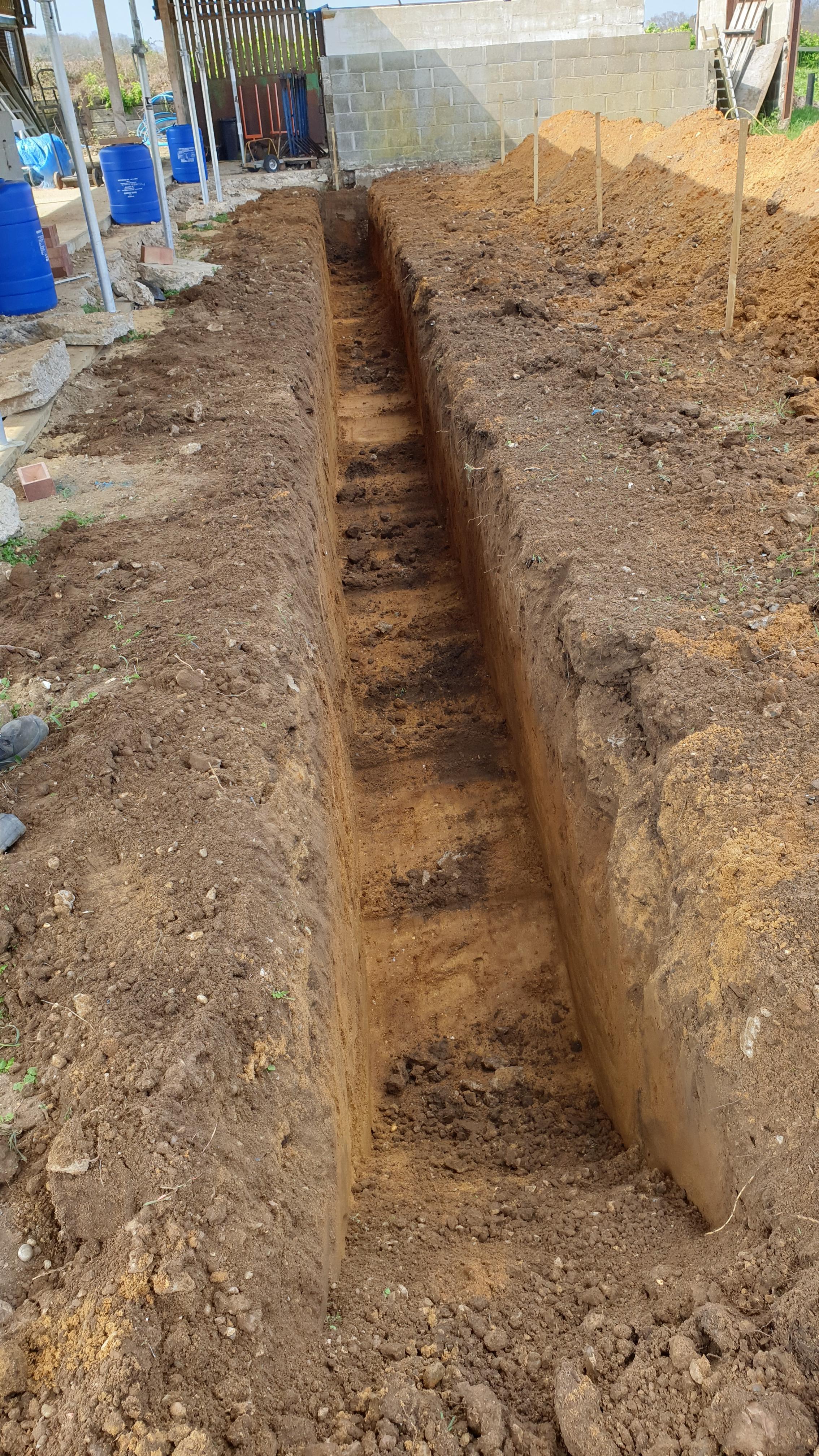

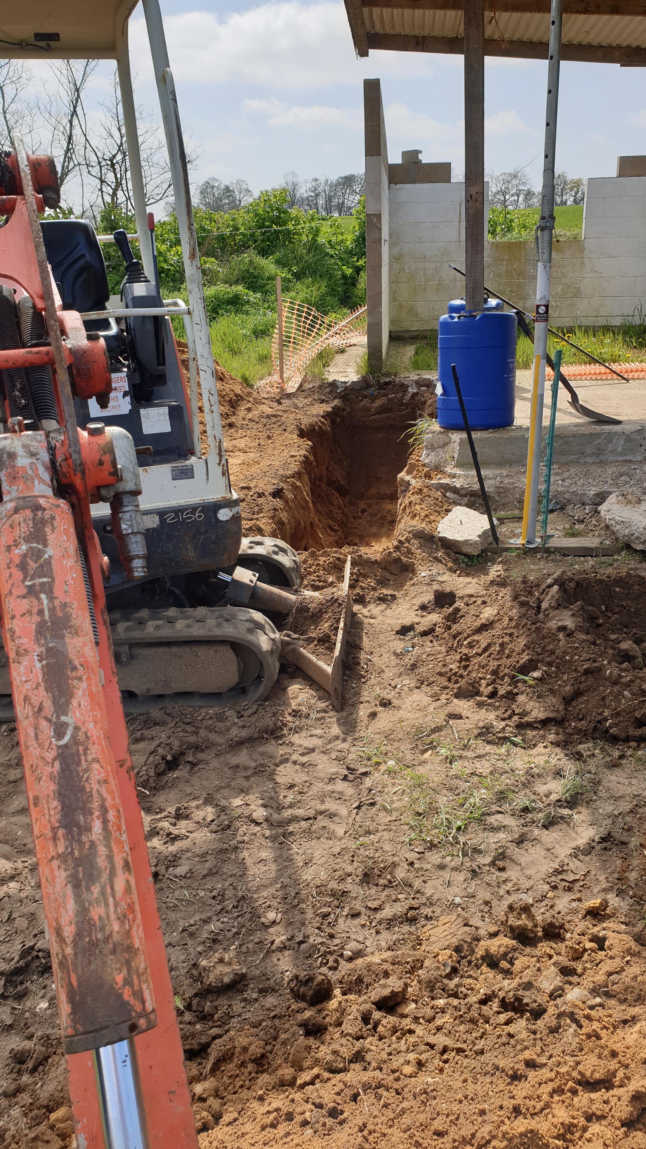

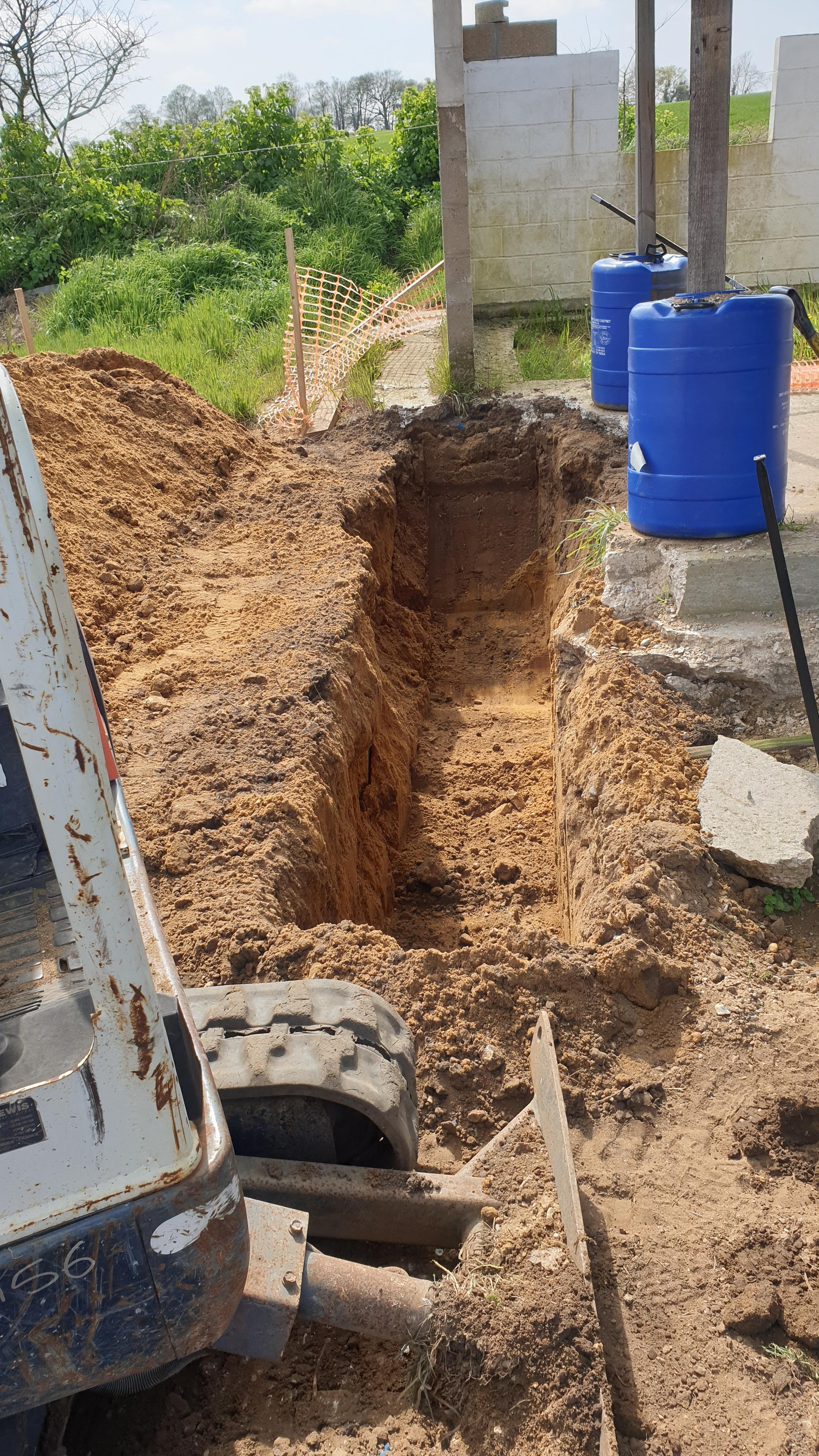

We did have an issue last week, he had dug a trench, we had torrential rain and one side fell in, some of our soil is very sandy so fine to build on, but need almost digging, inspecting and filling in one day.

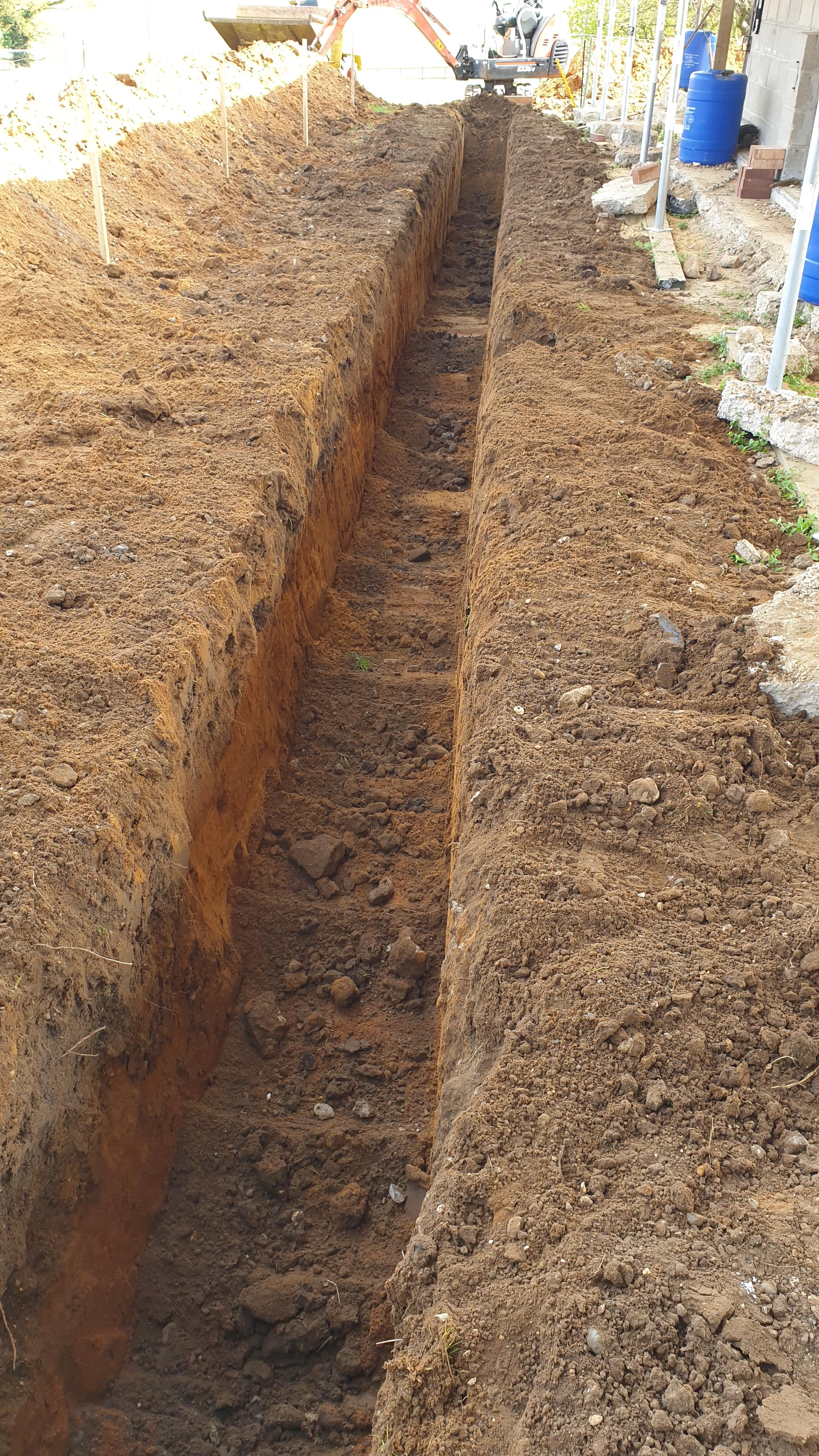

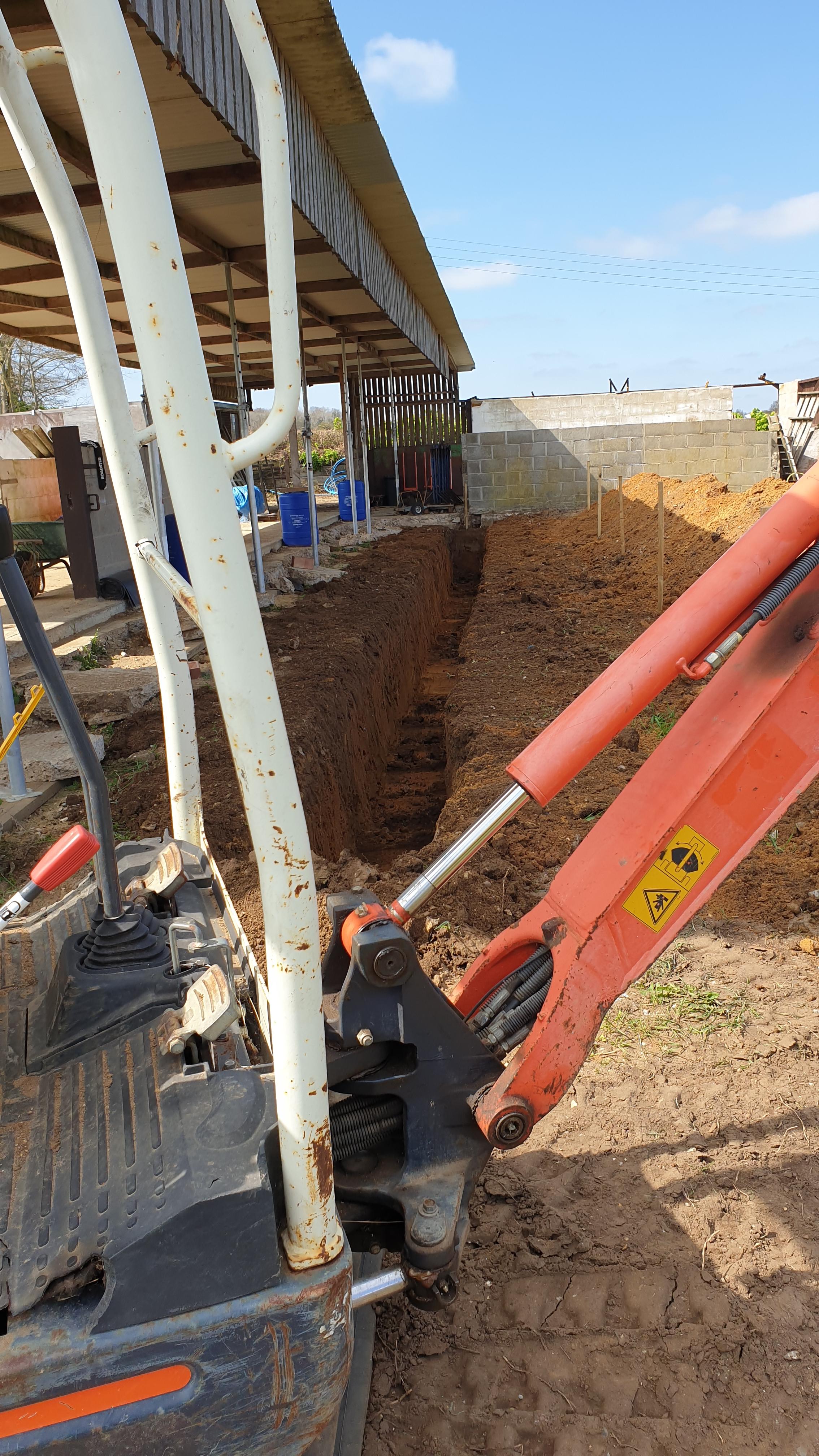

He has today dug the main parts of the first trenches and BC are coming Thurs am to look with concrete coming Thur lunchtime and then BC coming back later to look at this as he's got a local inspection as one of the local mansions for a few hours.
Still lots to do for this, one end needs to be shuttered to allow for the underpinning, we need to fence the area for safely before someone (probably me) falls in.
We need to put level markers for the depth and check if any of the sides need supporting.
