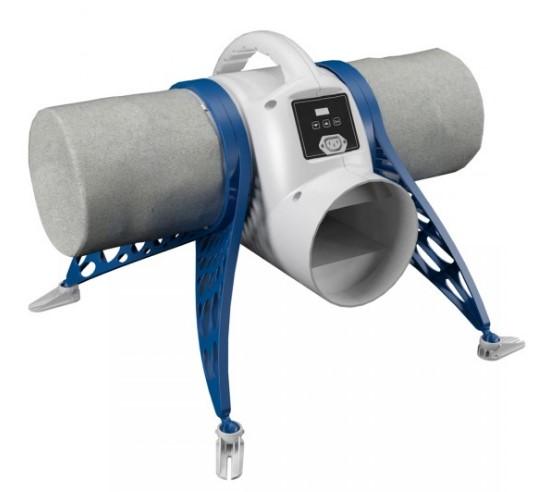

So I am hoping to do External Wall Insulation and Windows possibly next year. I also want to tackle MVHR and air tightness. Currently I have a Positive Input Ventilation unit but am finding it too cold now the temperatures have dropped so I've disconnected it.
I put F7 filters on it as I live beside a main road. Interested little unit but I'm ready for something bigger and better now! The main problem is retrofitting a MVHR system! The solar PV was interesting as the equipment couldn't be fitted in the attic so they had to run 4 x DC cables down to the kitchen where the inverter and batteries are located. That's given me the experience of how difficult it was! A load of 75mm ducts would be even more fun!! I'll get an installer as I think the regs have changed again and it requires signoff in ROI now but I'll get as hands on as they allow. I want to line up an air tightness test sometime in the future but plan to tackle some air tightness stuff if I get the MVHR installed:
