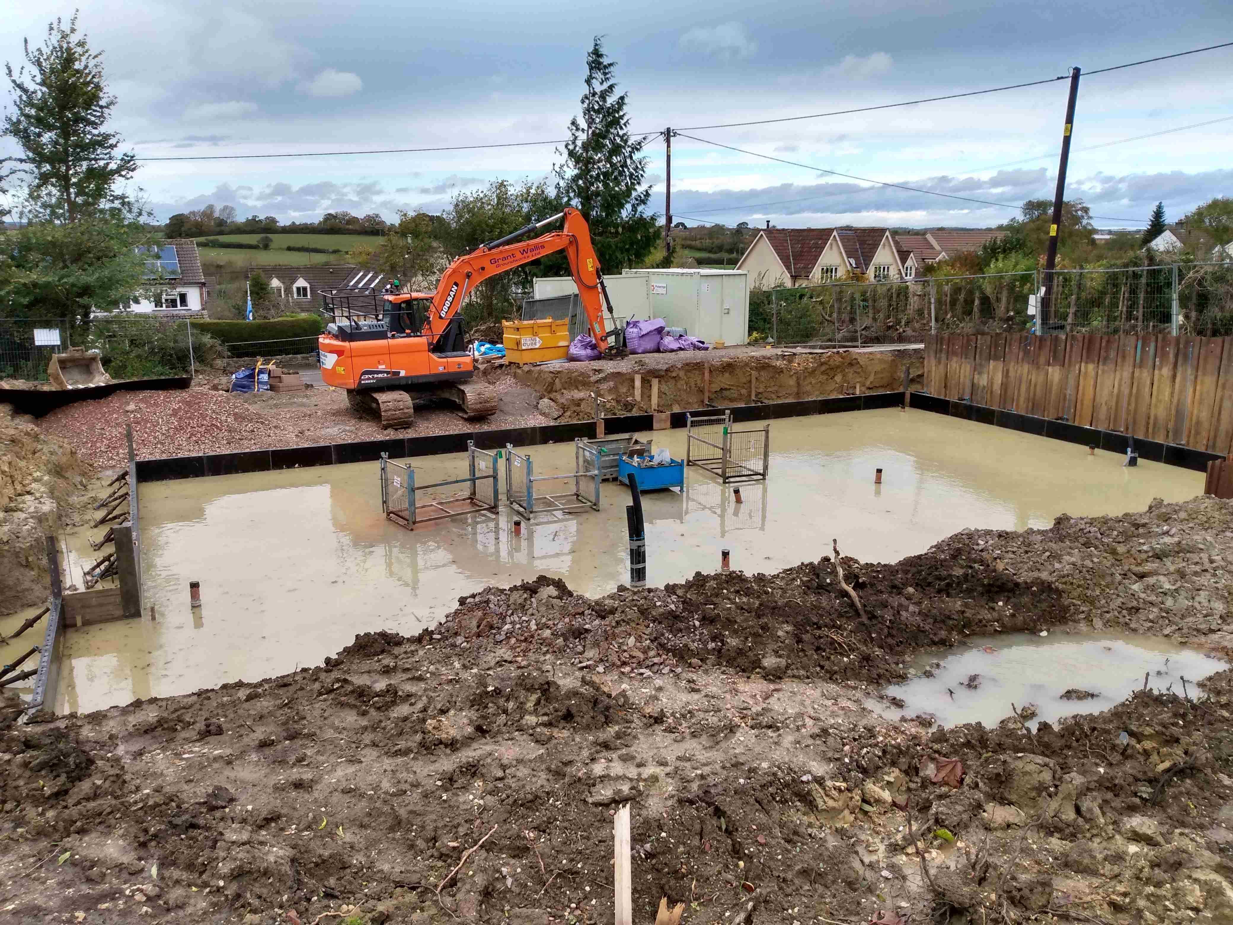

The video for Week 6 doesn't have Thursday and Friday as the camera played up (I blame Halloween) but good progress. this week.  You can see them laying in the service ducts and drainage pipes and then laying a thin 'blinding layer' of concrete = our first pour. They then went on to put shuttering up around the edge ready to fit the waterproof membrane and then the steel on top. By Saturday (see photo) the rain had filled it up quite a bit and the black shuttering you can see round the edge keeps it in a treat (or is that Trick or Treat?). The problem comes is that if this happens after the membrane goes down and before its weighted down with the steel then the membrane floats up. Lets hope its dry (ish) next week. And see below we can now officially pump it out on Monday.

Question re the steel sheeting  - presumably to create a safe working area by preventing ground movement. I'm considering similar (will leave ultimate decision to demo & ground works co) - My question - did you hire or buy the sheeting and did you self-install with an excavator or sub-contract that out?
Red Kite
Posted
The steel sheeting was installed by the groundworks contractor and was planned into the design. The longer side is onto shared drive so is there for 2 reasons, to stop the drive way  falling into the hole and to protect the workmen. We did not have enough space that side to batter the clay back. The additional section was added when they found some loose sand in the clay. They were fitted by the excavator with a hydraulic hammer, this is very skilled as you have to keep moving the excavator arm to keep the sheets vertical . The steel sheets are hired in  but all part of the quote!
