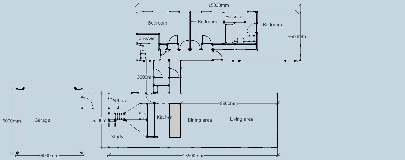

Having looked at the general style of the house, I started developing and refining my ideas about the internal layout. Whilst our last house had worked really well for us, I wanted to learn from it and (hopefully) avoid some of the minor niggles. Having carefully assessed how our last house worked, we concluded the following;
Utility room needed to be a little wider, ideally with vaulted / raised ceiling to accommodate a clothes airer / pulley.
Of the two living areas we had, one was used 95% of the time. The main use of the second living area was as a space for someone to go to read a book etc, so a large second room wasn't required, only a suitable escape space.
Not having a dedicated study was a pain.
I also had to incorporate a small but challenging wish list from my good lady;
The kitchen had to have an island (a peninsula was not acceptable).
A mezzanine of some kind had to be incorporated.
The latter requirement for a mezzanine dictated in large part how the design developed. Vaulted ceilings above the height I could achieve with a raised tie or scissor truss were required, as was space for stairs, and the ability to look down from the mezzanine to the main public areas.
In the end we came up with the following layout;
finished externally with a mix of render, timber cladding, tile/slate and metal roofing, to reflect the dual building style of the dwelling.
I had the plans drawn up and properly scaled by someone I found on a freelancing website.
