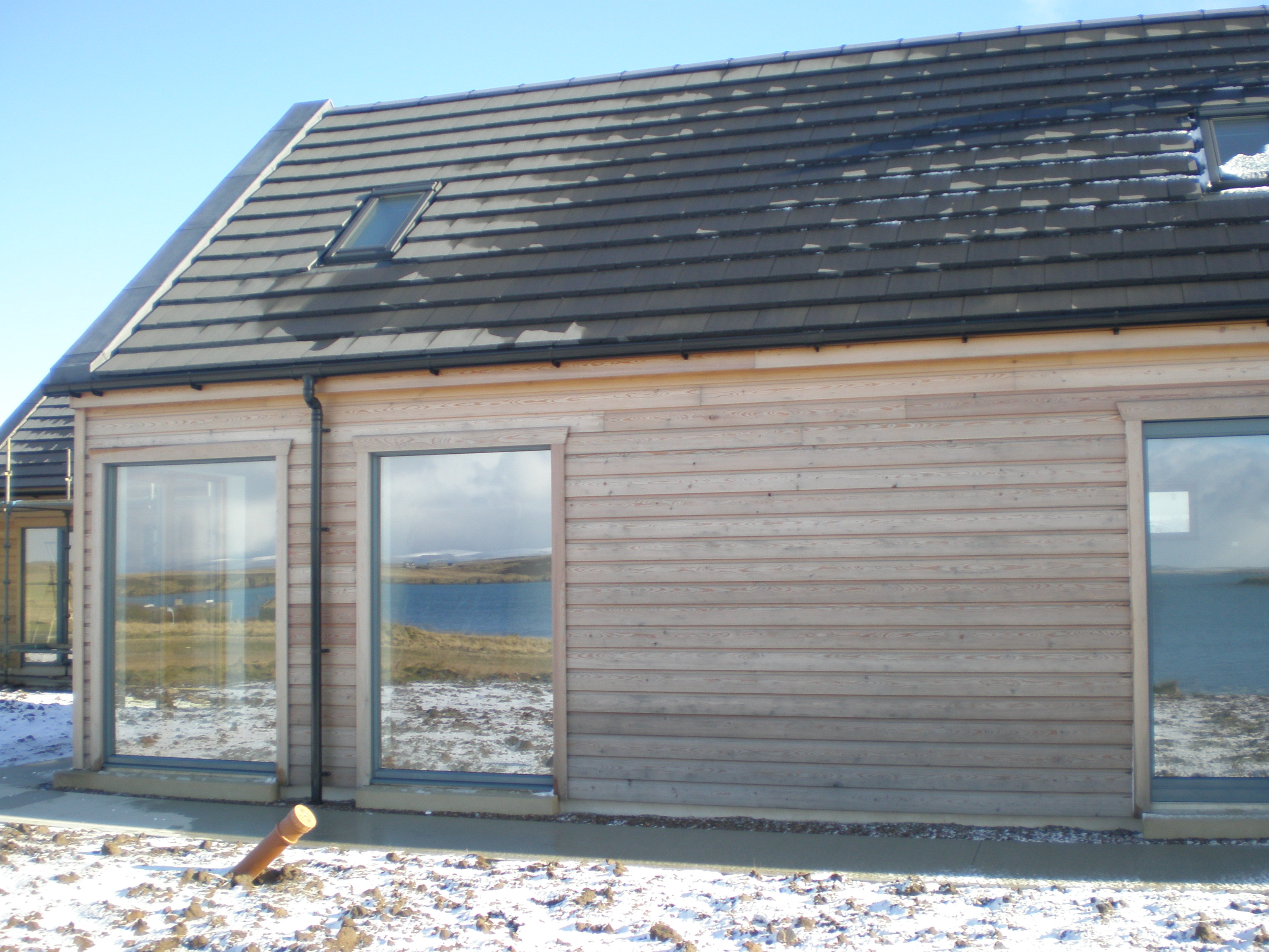

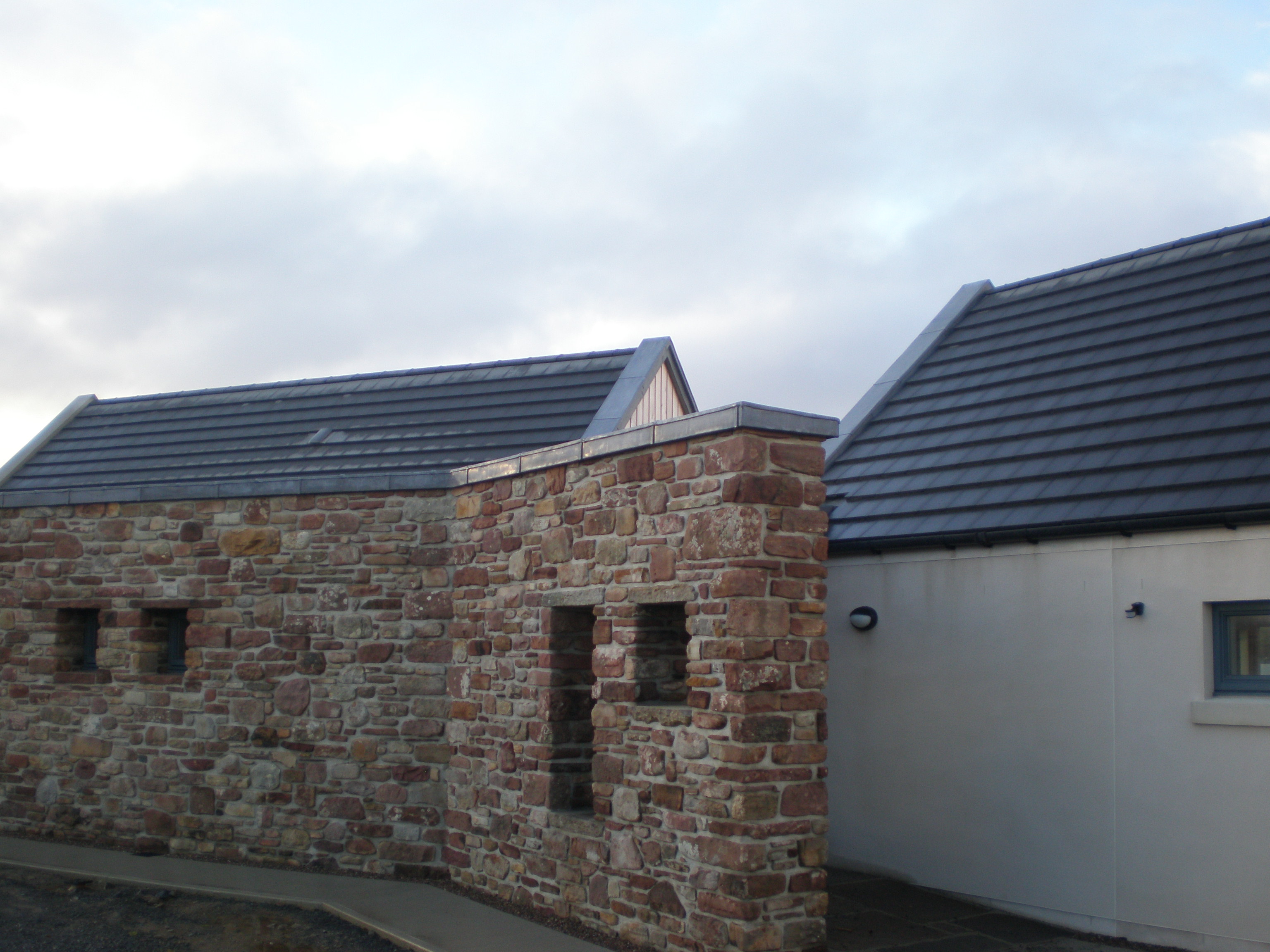

We had planned a mix of concrete tiles and profile metal sheeting for the roof, but concerns regarding profile sheeting, and the additional costs of a standing seam roof made us think again. Purely by chance we passed a house under construction which like ours, had a mix of render and timber cladding but was under an all tile roof. The finishing touch, which tied the roof to the differing wall finishes and gave the house the look we were after, was the use of a local verge treatment – lead covered skews. Having a passionate hatred for the look of dry verge systems, this was the perfect solution and should ground the house as a modern interpretation of the local vernacular;
After consulting with our planning officer, the changes were accepted as a Non Material Variation. We were fortunate as changing to an all tile roof was acceptable within the conditions specified in my original planning permission.
