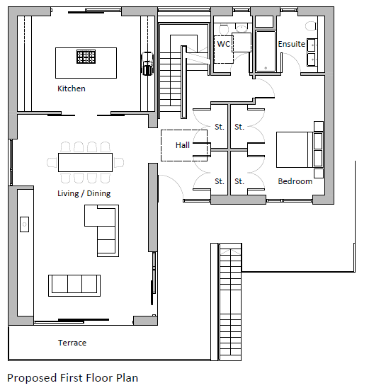

We were making good progress with the architect; we had agreed on the new external look and received an updated internal floorplan, which was a big improvement over the layout that came with the plot.
We received the first draft from the architect on 7th July 2016, and agreed on the drawings to submit to Planning on 18th August.
During those 5-6 weeks, my wife and I sat with the plans, "walking" through the house, working out how we’d use each space, and going back to the architects with suggested changes, questions and tweaks.  Looking back through my records, we had 7 revisions of the drawings, though at one of those was solely a request for the addition of dimensions to the drawings.

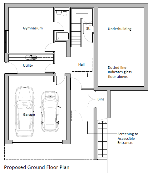

Entrance Hall
I’ve not mentioned this so far, but one of the features we did like the original plot plans was a glass floor in the entrance hall, to allow light to flood into the basement. That had disappeared from the plans, so we added that back in.  With us combining the two bedrooms, we also manged to address the issue we had of limited storage just inside the front door and added new cupboards there.
Here’s the floor plan that was submitted to planning. We also extended the terrace at the front of the house, to allow us to set up a table and chairs to enjoy the view. This seemingly small change would cause us all sorts of problems in future.

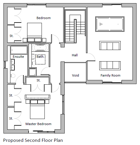

Here’s what the upper floor plan looked like
The basement area remained largely unchanged:

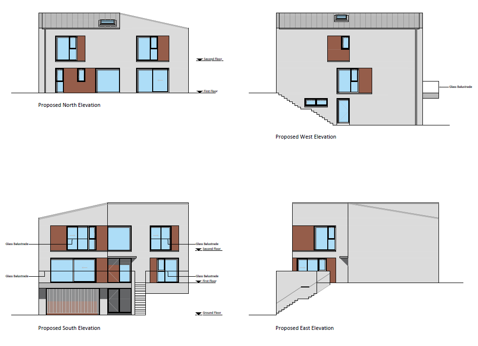

The externals changed a bit to accommodate the new internal layouts:

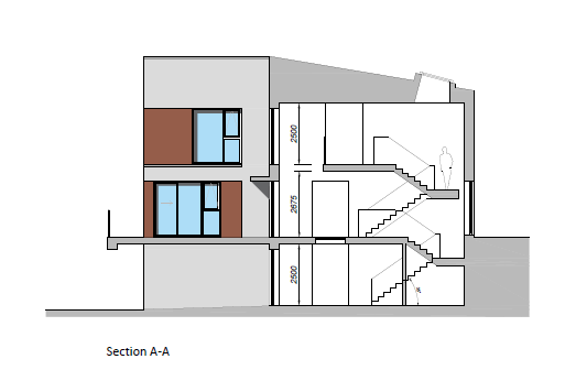

And a sectional view:
It was now in the hands of the Planning Officer.

Addressing your Planning Condition comments from a previous post.
>E/W elevations - we've houses either side (one existing, one in planning) and we have a Planning Condition relating to that
>"No windows or openings shall be formed in the east or west elevations of the dwelling hereby approved"
That would make me slightly annoyed partly because they already had a granted PP which violates it, and partly because I reckon it is unlawful. Talking about the pipeline side, you have a clearance of at least 7m at 90 degrees.
The purpose of PCs is to make a dev acceptable in Planning Terms, and to safeguard the amenity of neighbours. Here there are multiple ways you could safeguard the amenity of neighbours without banning openings ... eg for ground floor a condition to install a 2m fence, or to make sure that windows can only look straight out via obscure glazing or deep narrow window bars (think fins on office buildings). No need at all for it to be so broad.
Even Fife Council's own fugging blessed Guidance Document has tables and diagrams demonstrating acceptable window arrangements in exactly your situation without any need for a fence or obstruction.
http://publications.fifedirect.org.uk/c64_Minimumdistancesbetweenwindowopenings.pdf
And the PP is granted so you know exactly where you have to be in relation to the windows on the other house. And if they are obscured there is no in-looking so perhaps you don't need to worry anyway (maybe overlooking of garden excepted if they are able to use it).
Perhaps we could have a thread about that condition in the light of the requirements. I think I am about right, but would value critique of my view.
>We also had to change the the Dining Room window to a high height narrow window - it was either that or obscure glass.
Similar considerations, but closer and with the other property built.
That is now a sunk cost, however, and I think you can only shift it via a Full PP or an Appeal against the condition within 12 weeks of receiving PP. And perhaps you are willing to tolerate it.

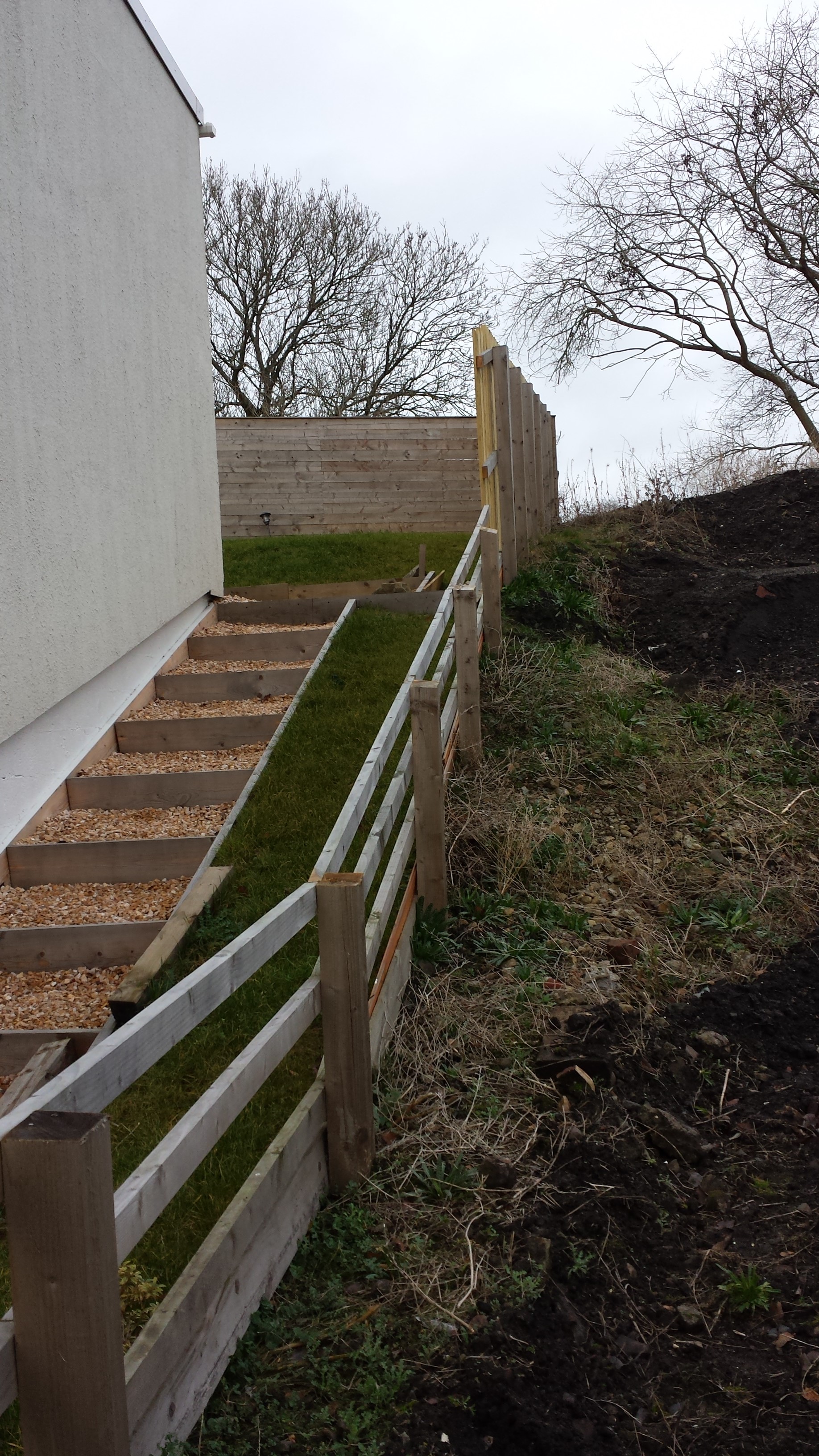

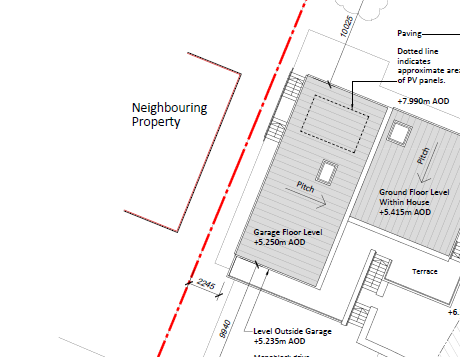

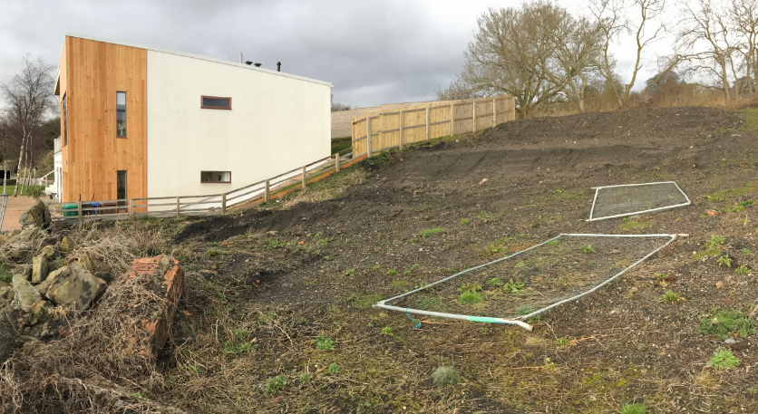

Wow, thanks for this. I figure we've about 2 meters to the west of our plot, with another 2 meters to the house there, but I'd have to do some work to determine the distance based the angels. Here's the house to the west.
And the gap on their side (I took this picture as we're not sure if we'll need a retaining wall for our stairs at that side of the house - i think our mud is holding up those steps):
And the site plan:
It's the vertical planes I need to work out to determine the actual distance.
I agree, there's no reason we should not be allowed windows on the east elevation though. The 12 week appeal period has long passed.
