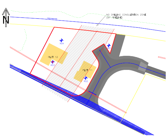

In December 2015, a boring rig was on site to do its thing for a mineral report. This was required (in addition to the coal authority report) to identify whether there were any coal seams in the area, and also to get a general view of the underground minerals which would feed into decisions on the preferred foundation design for the structural engineer. This was arranged through the builder.
The drilling was to take place across both our plot and the one to the east of ours. Unfortunately, due to reasons that are still not clear to us, only one borehole was completed in our plot. You can see here that R03 was not completed. We’re still not sure if this could come back to bite us.
The bores that were completed went to a depth of 30 meters, and did not raise any concerns about building on the site. This is an excerpt from the Mineral Report:
Quote
Based on the encountered conditions and absence of any evidence of unrecorded mineral workings, the stability of the site is therefore considered to be satisfactory and no further works are considered necessary in this regard.

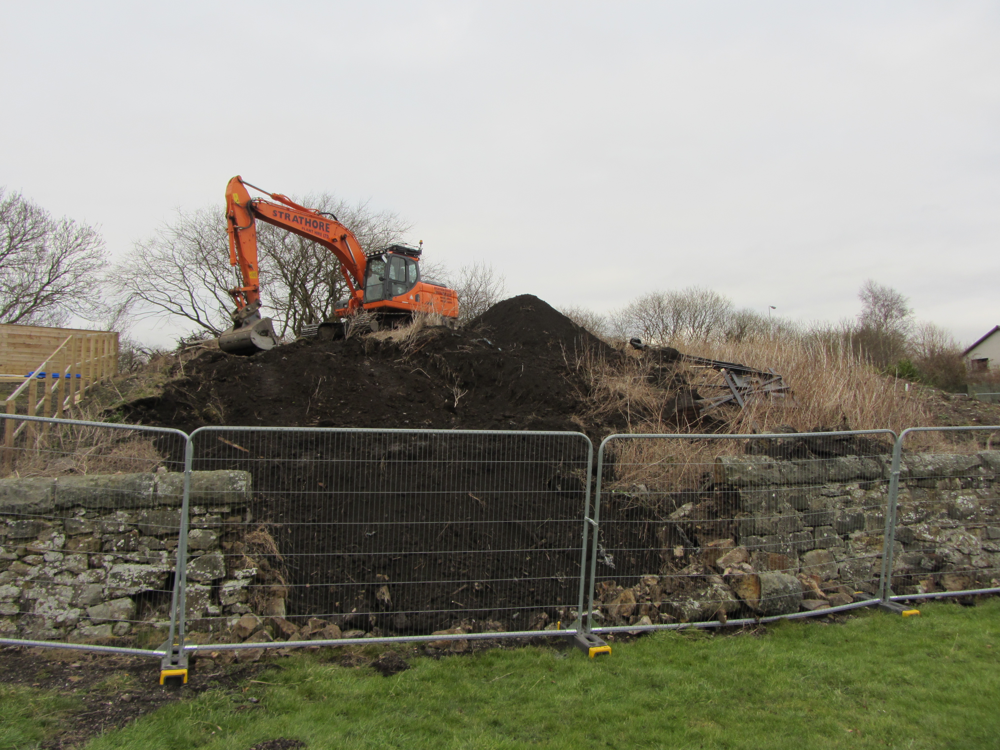

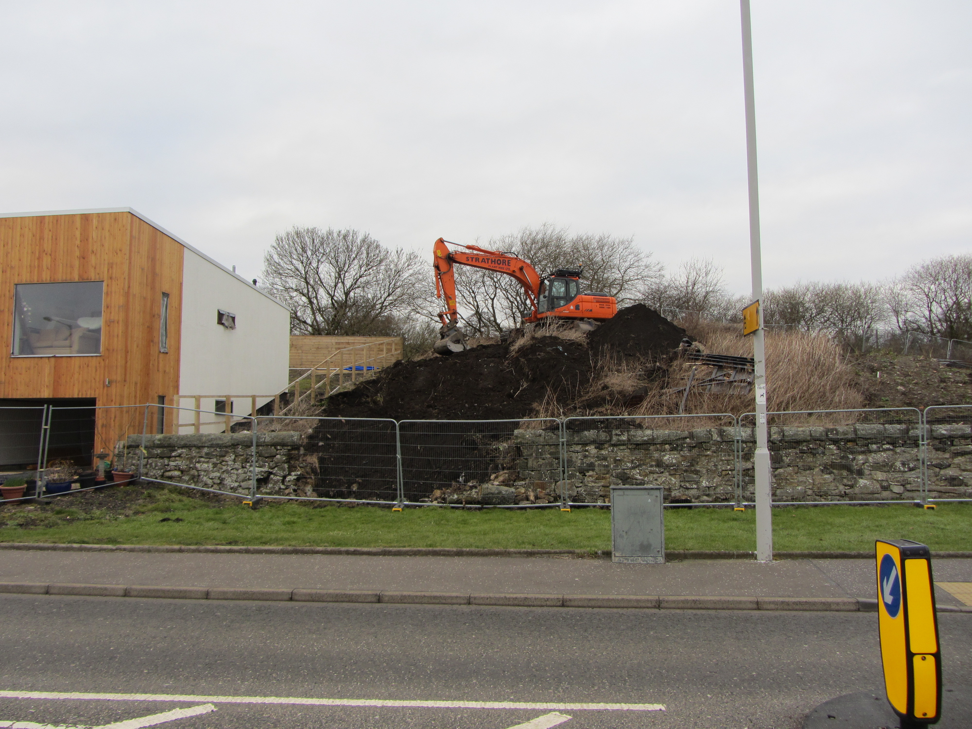

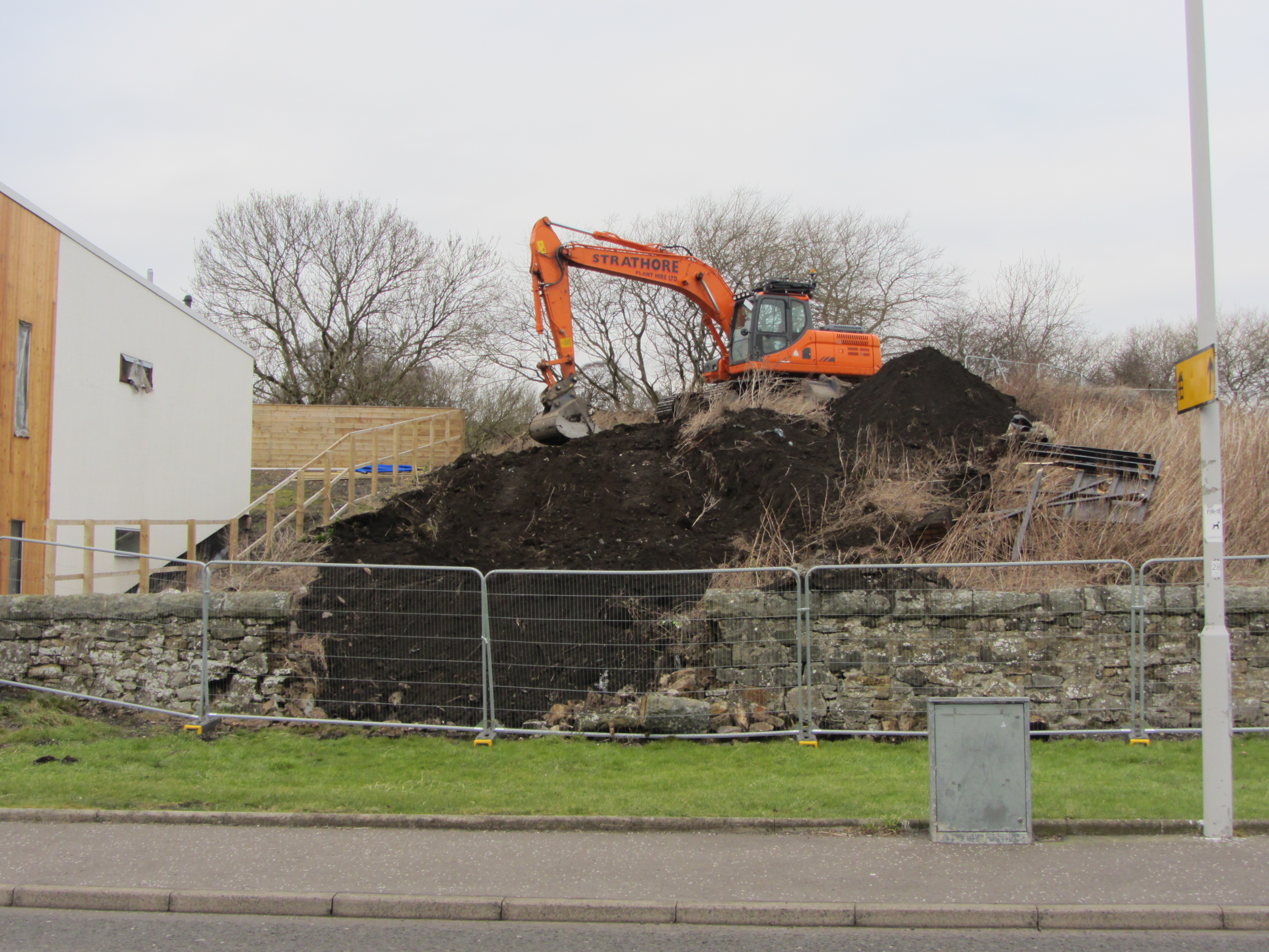

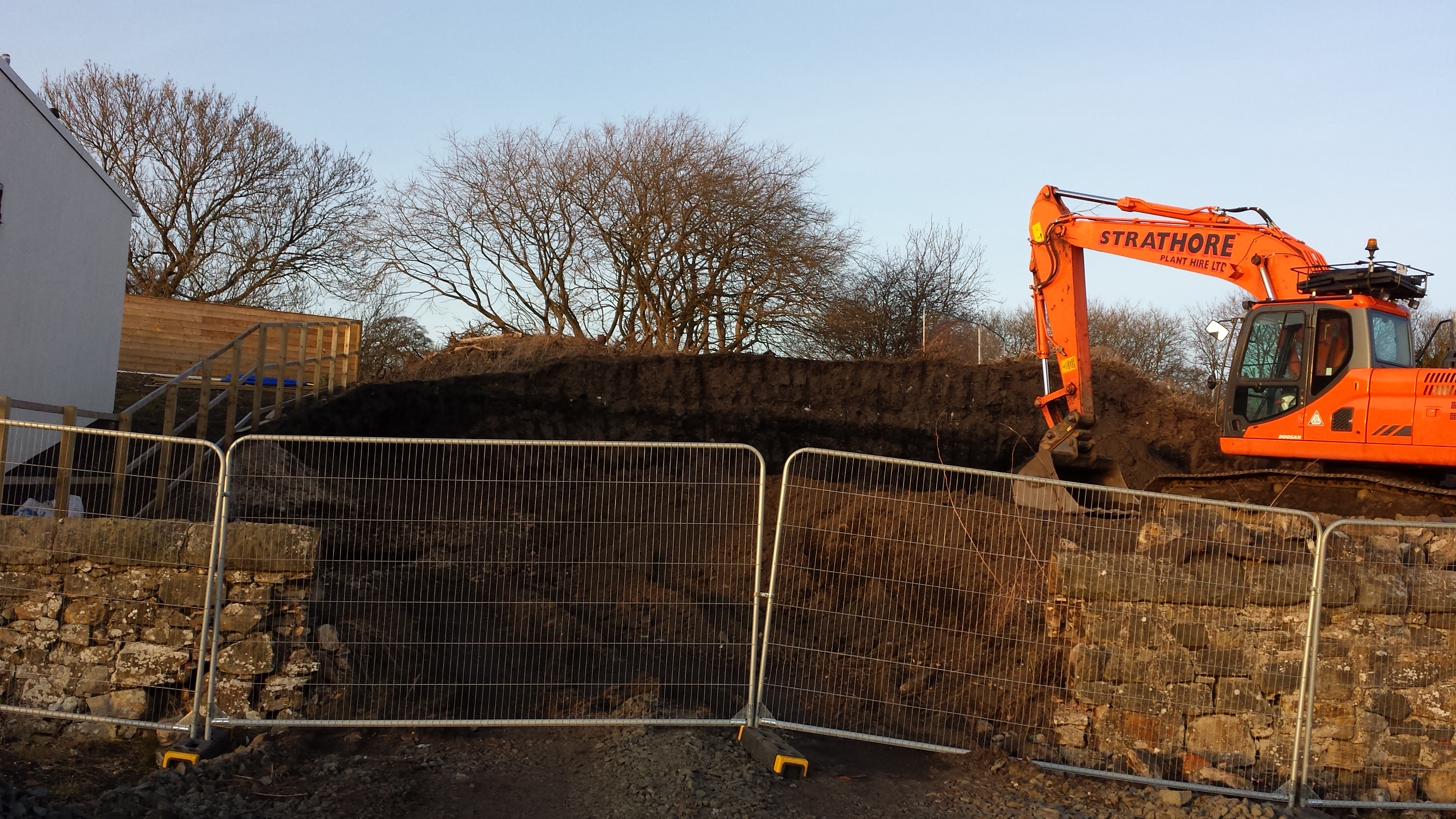

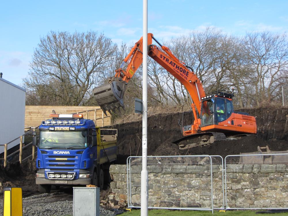

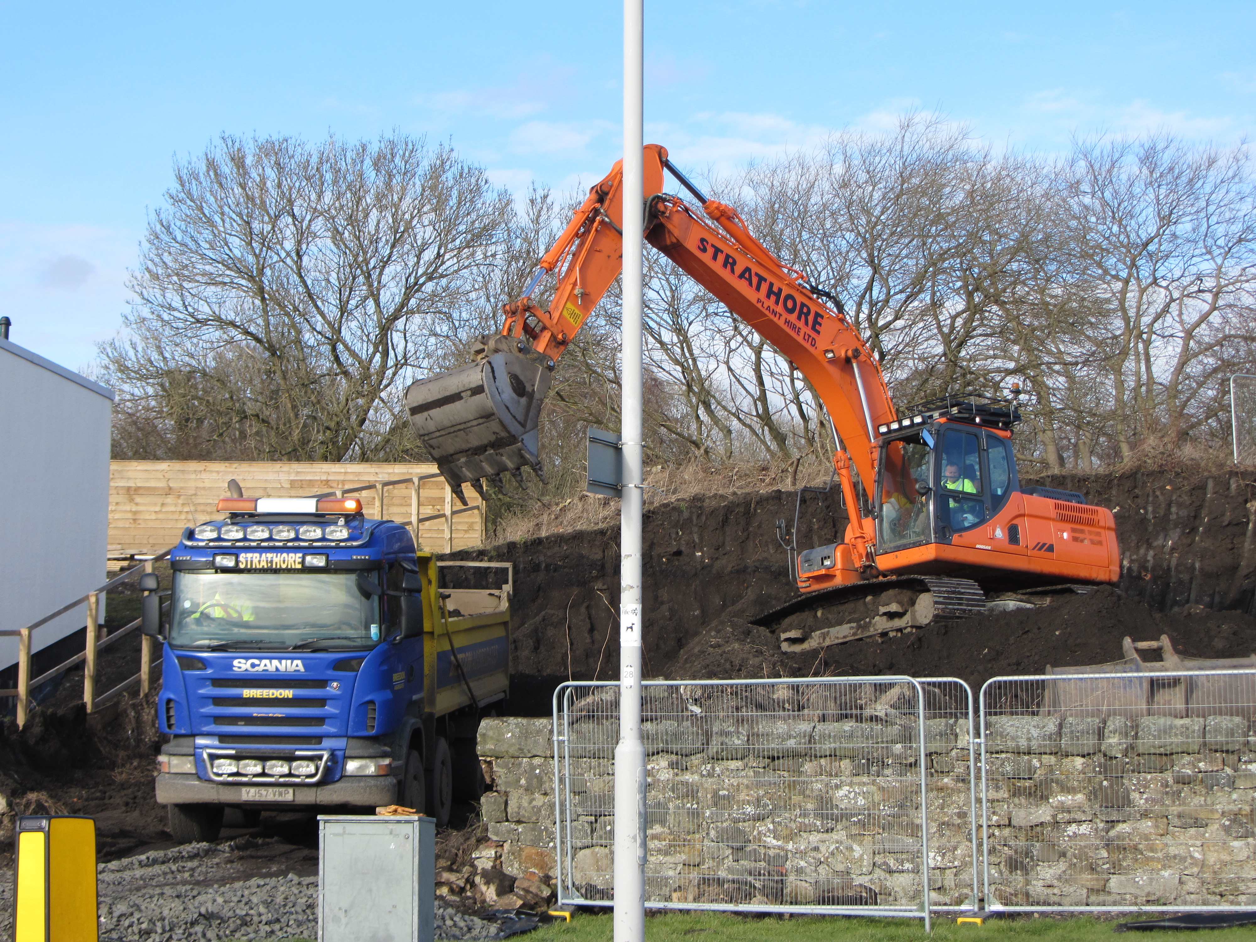

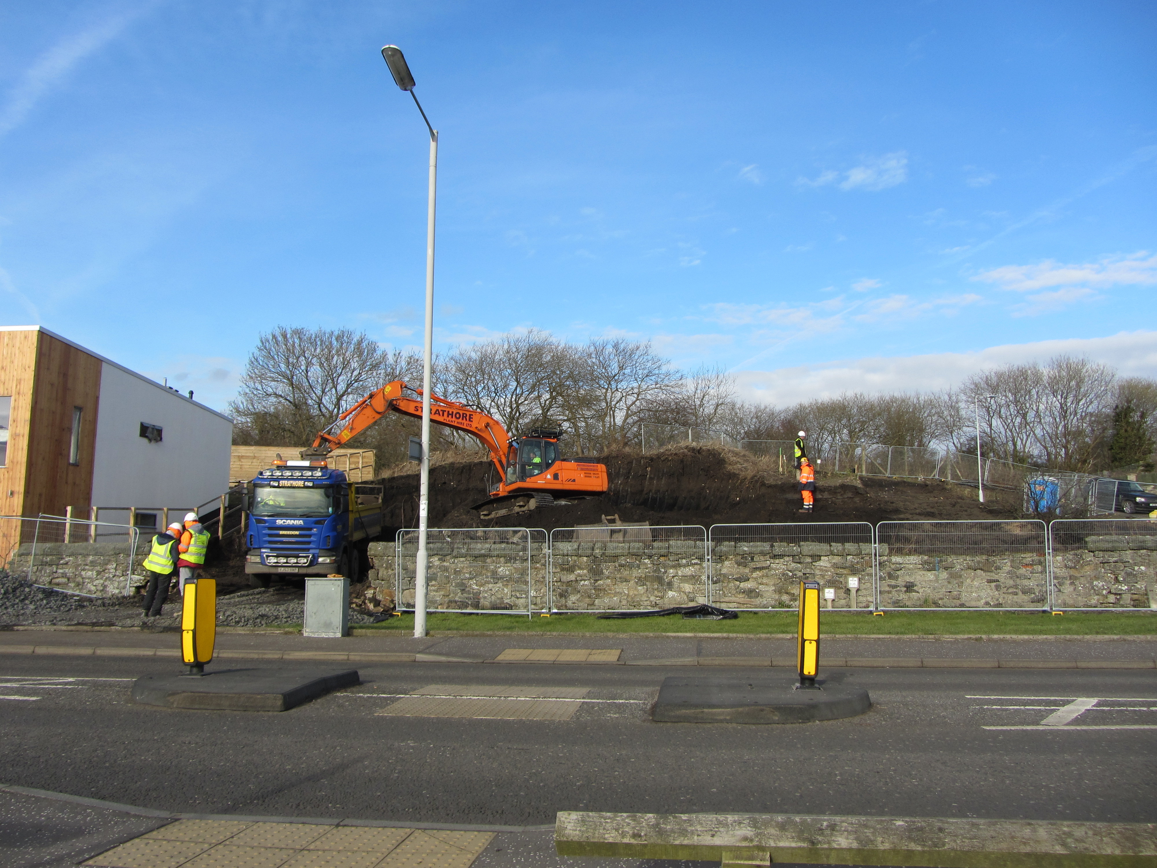

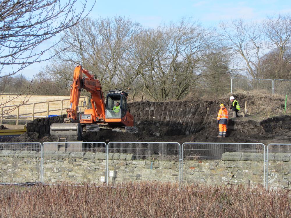

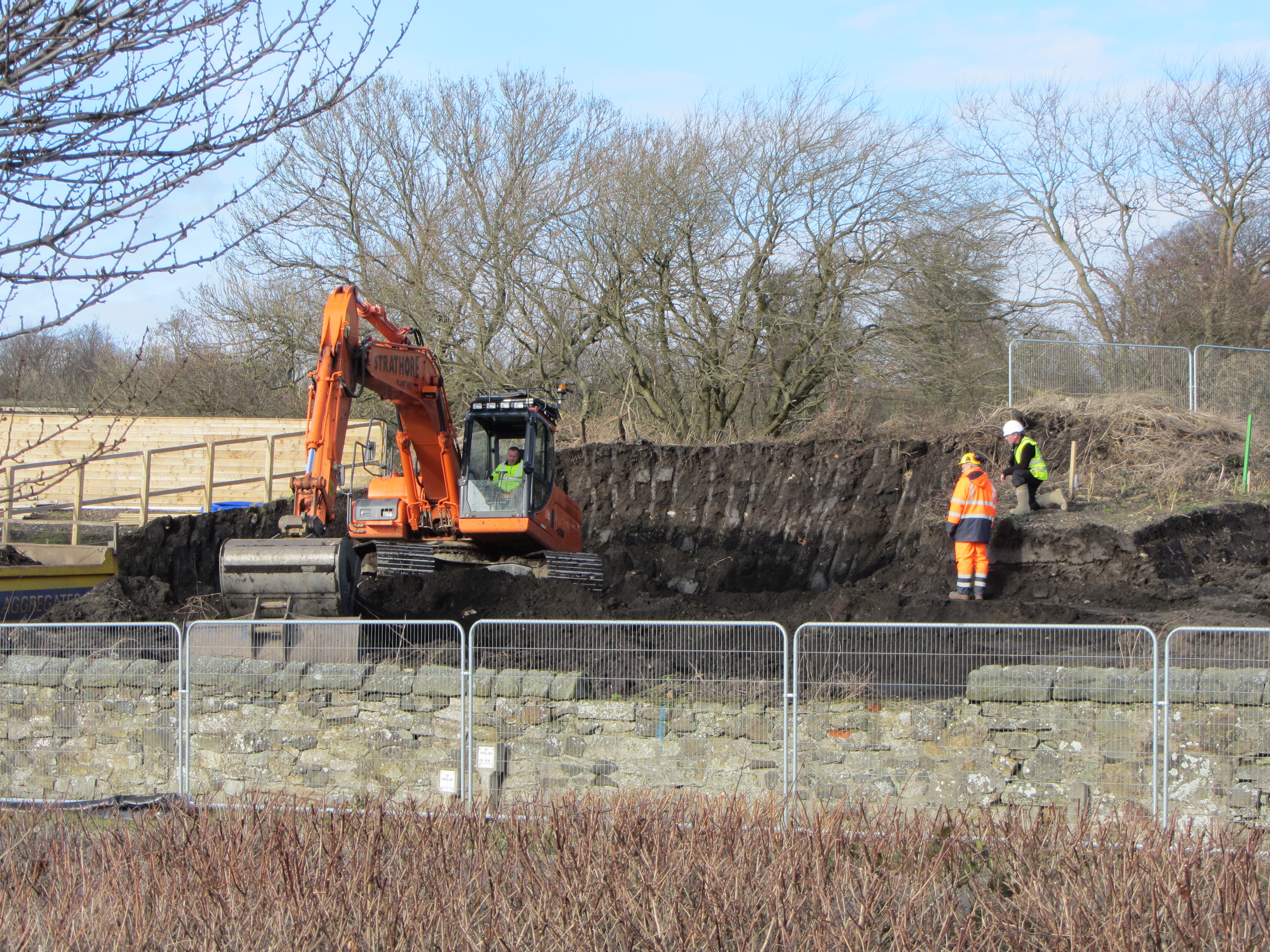

More visibly, towards the end of February 2016, we did a soil shift on the site (again, instructed via the builder). We lifted around 2000 tonnes of soil across both sites

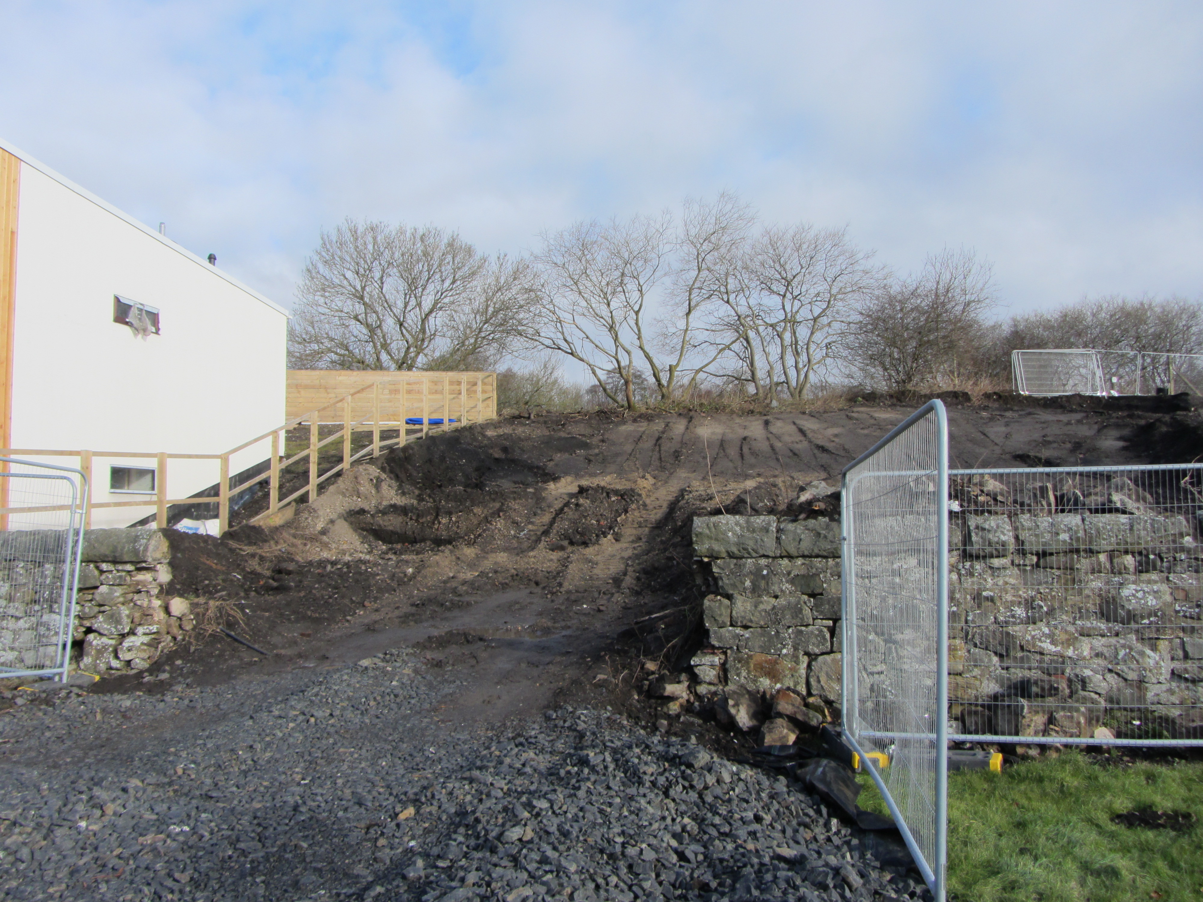

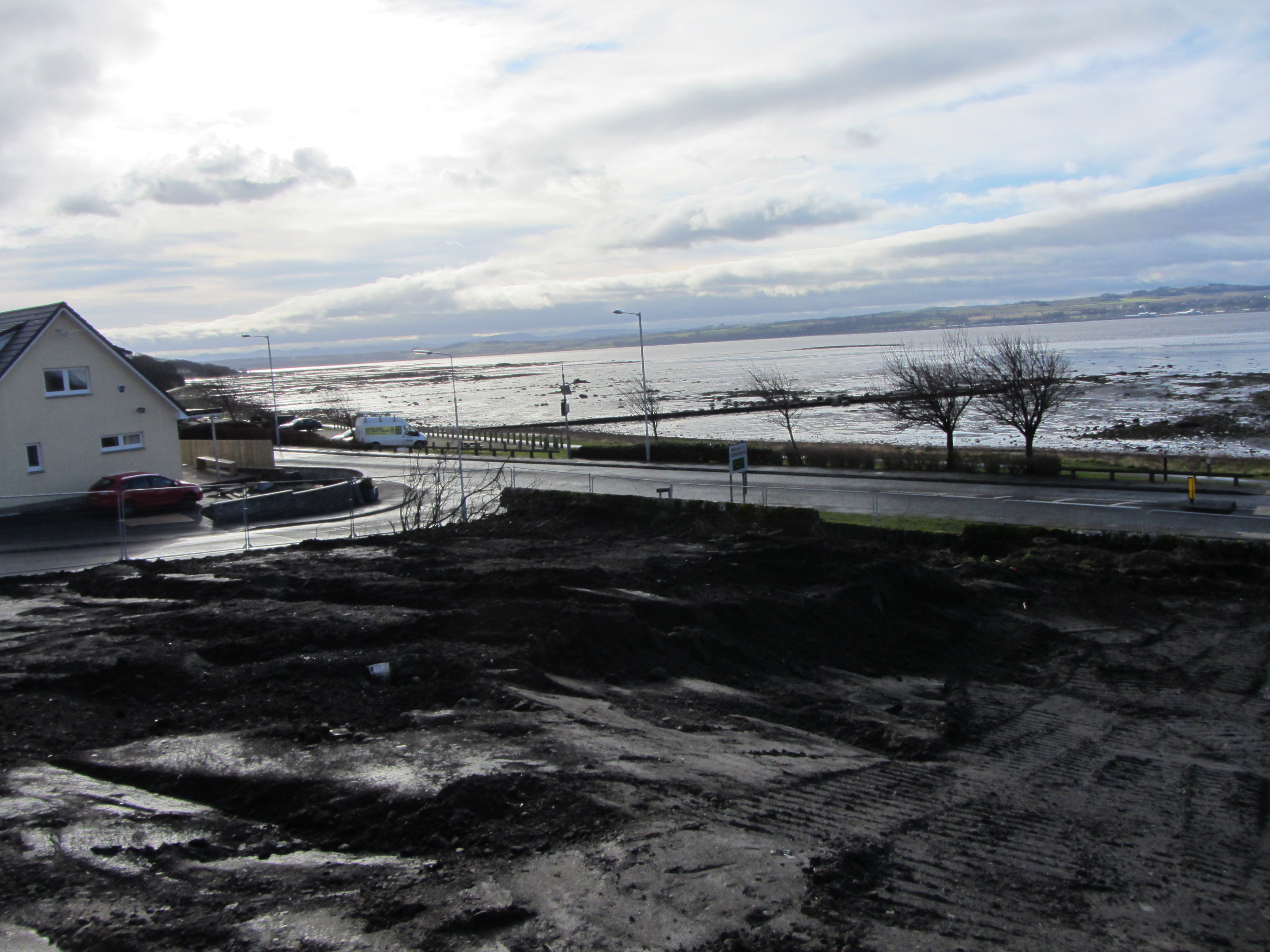

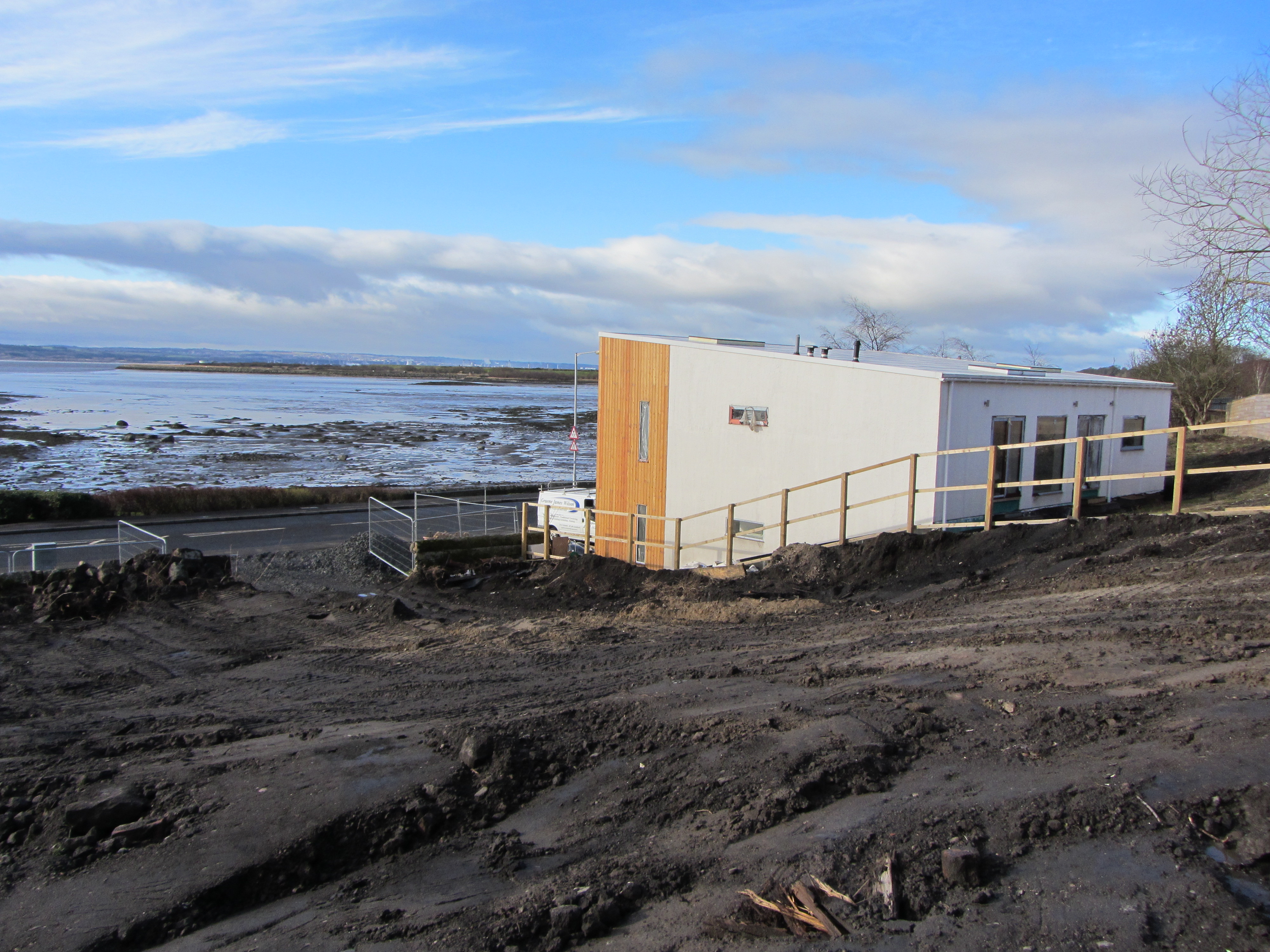

This is how the site was left. The trees at the back of the site were meant to be removed, but the team ran out of time. We chased this afterwards, and it was always going to happen, but never did. I’ll get to the reason for that in a future post.
We’ve also since found out that, contrary to what we now know should be best practice, the topsoil was not separated from the other brown waste before it was taken off site. This will potentially costs us when we get to landscaping our garden. Another item added to the list of the many things we've learned in this process.

A few things puzzle me.
Where will you be making your site access, and how does that fit with that lamp post, roadside kiosk, and crossing refuge? will any of those need moving?
Re separating of soil? are you intending to have your own topsoil "stored" offsite to be brought back later on?
Link to comment

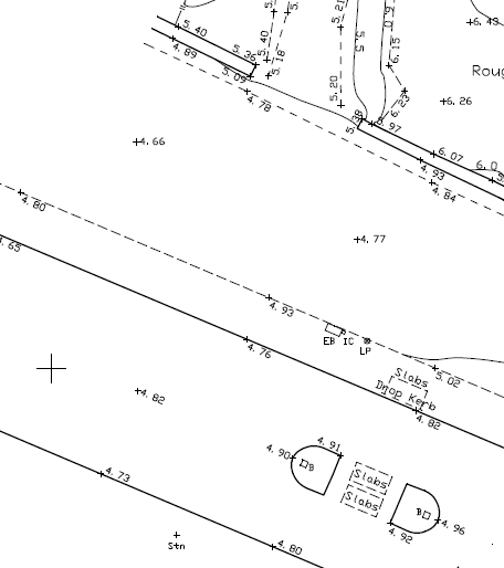

Site access will have to be carefully managed. The intention was to build across both plots at the same time, but that may no longer be possible, so it will be from the roadside, via the whole punched through the wall.
We do have a few meters either side of the house to get small diggers past the house (but up a slope), but it will require careful planning to get the big diggers in and out of the top of the site before the house goes up.
There should be no issue with needing to move any road furniture. Our roadside entry pretty much aligns to where the whole has been knocked into the wall, and you can see the road furniture in relation to that from this topo survey excerpt.
Its too late to store any topsoil now - it was all taken off site. It could have been stored at the top of the plot (there is a bit of space there). We've been told that if we want anything to grow, we may have to bring new topsoil onsite.

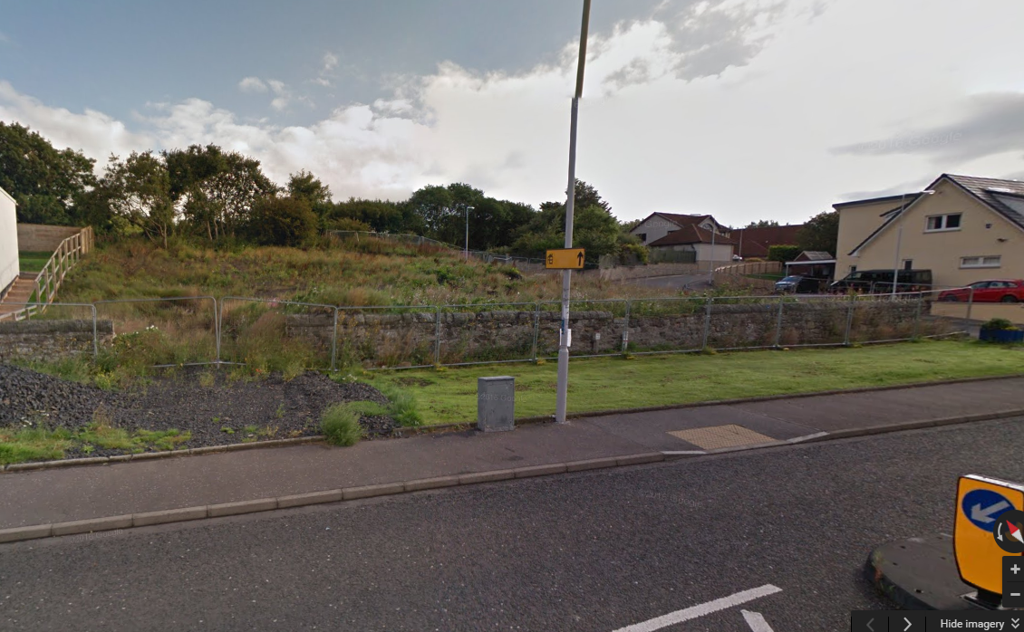

We have planning condition to provide 3 off-street parking spaces, and a turning area, but nothing more specific. There is also the need to maintain 2x60m visibility splays and there is a 600mm height restriction along the front of the plot. The service strip runs there, so we're limited to what we can do there anyway.
So no need for a road, just a driveway (at a gradient not exceeding 1:10)
This screenshot from Google Street View shows the entrance in relation to the lam post and traffic island. Out plot runs right up to the kerbside.
