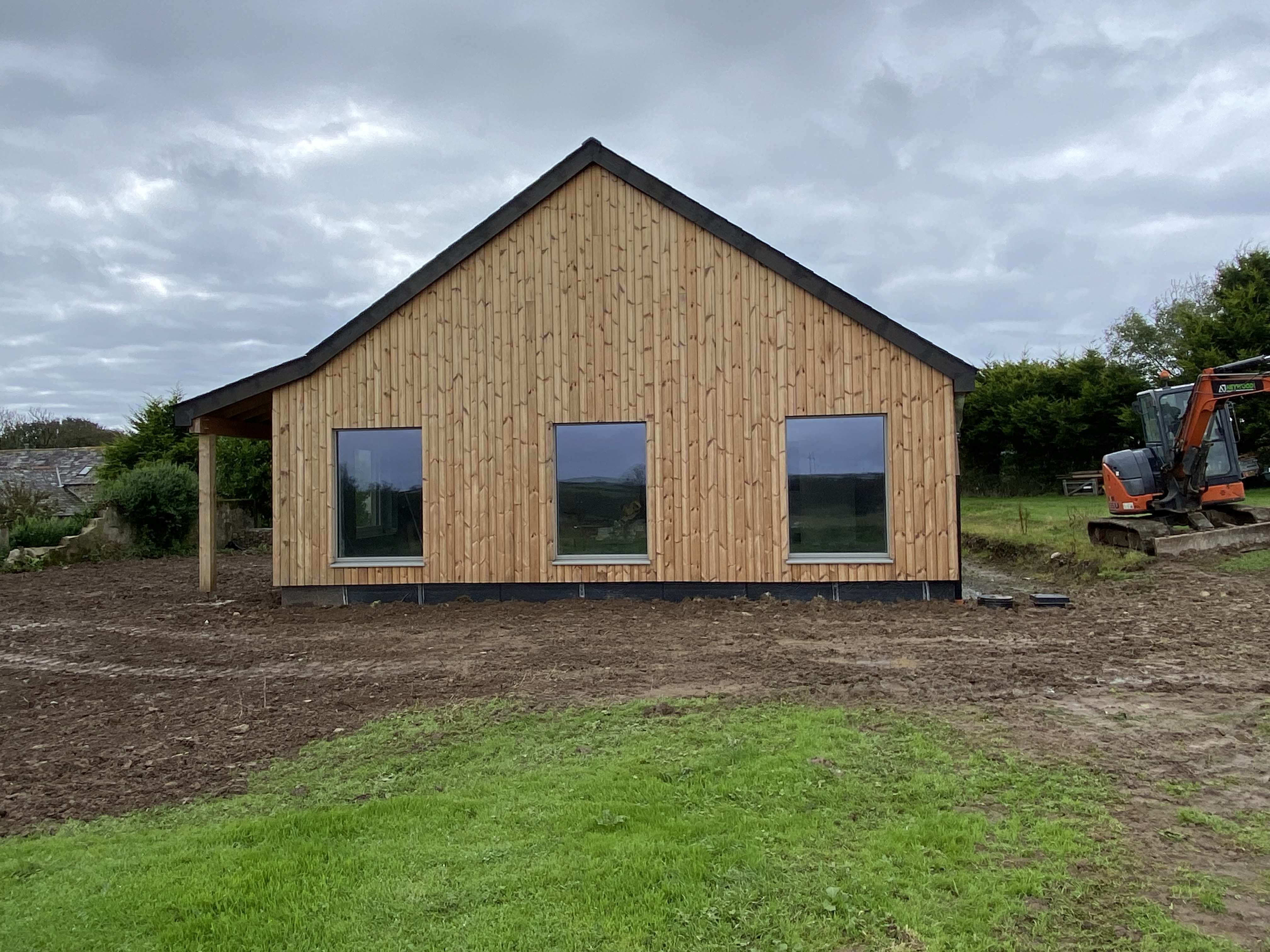

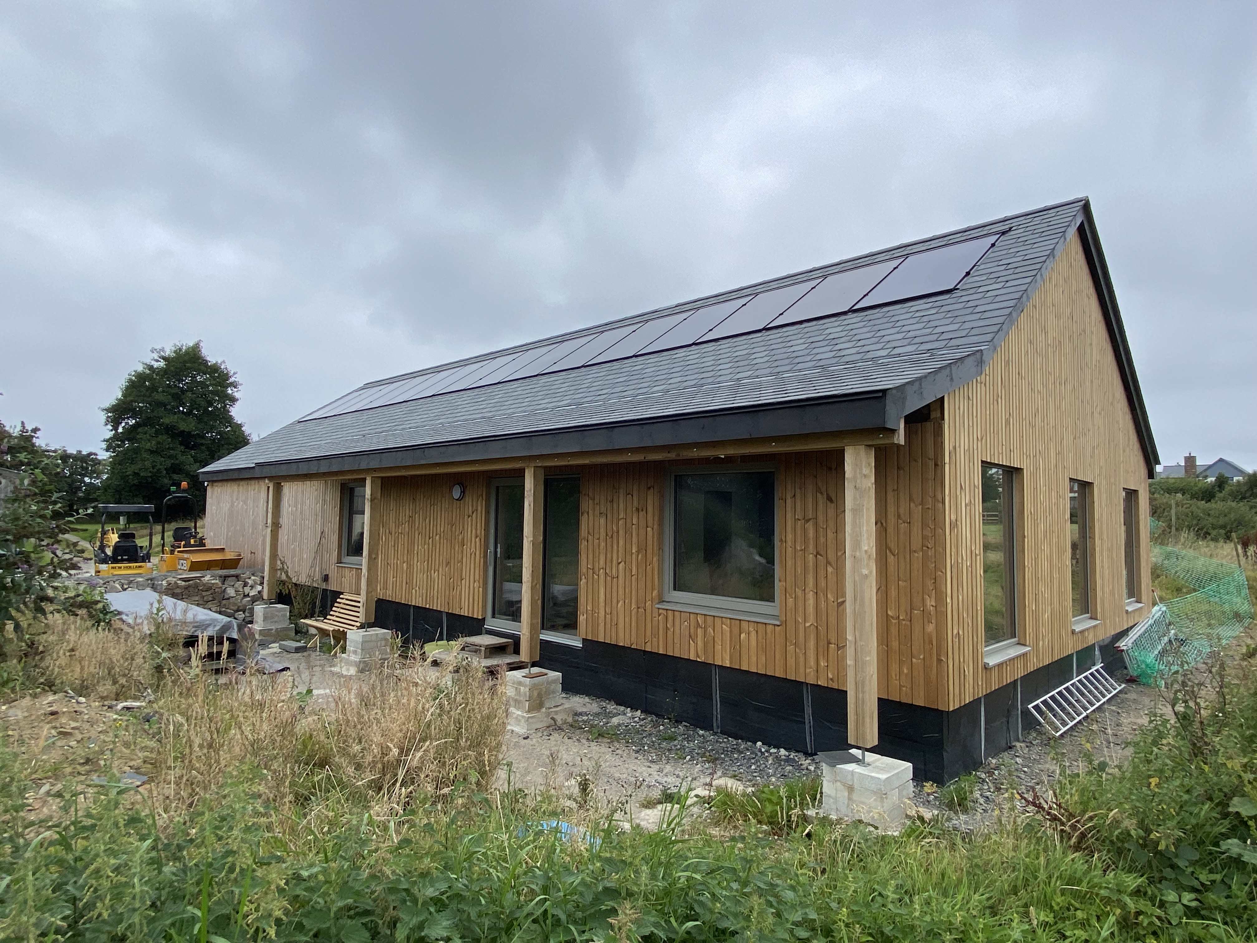

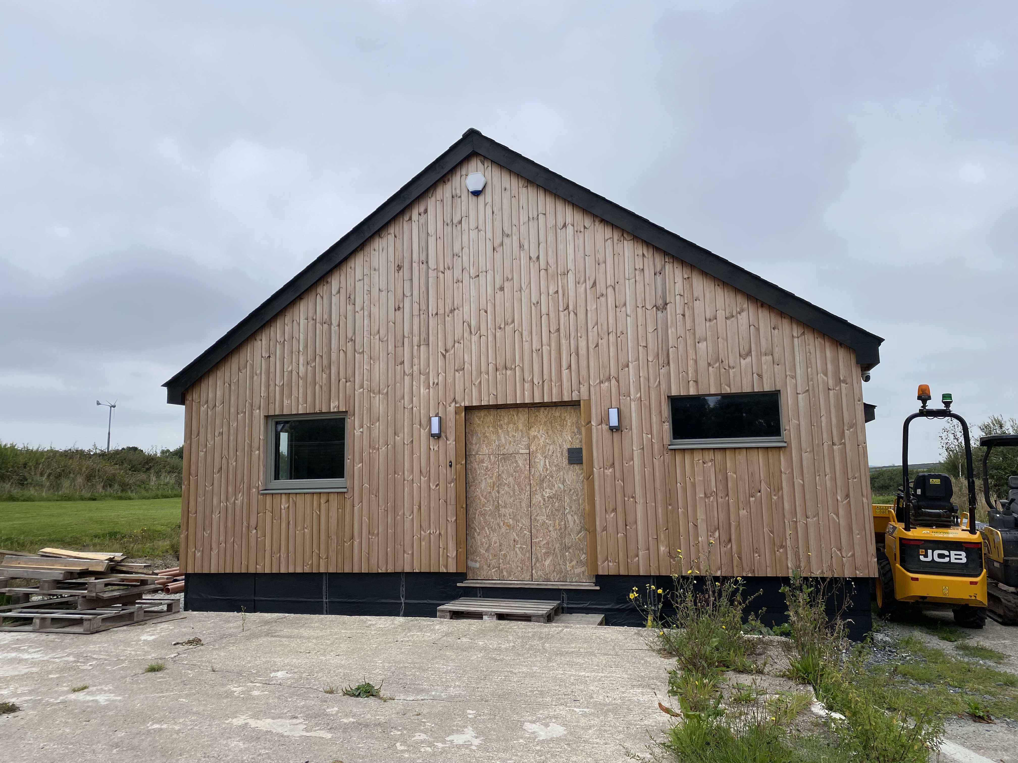

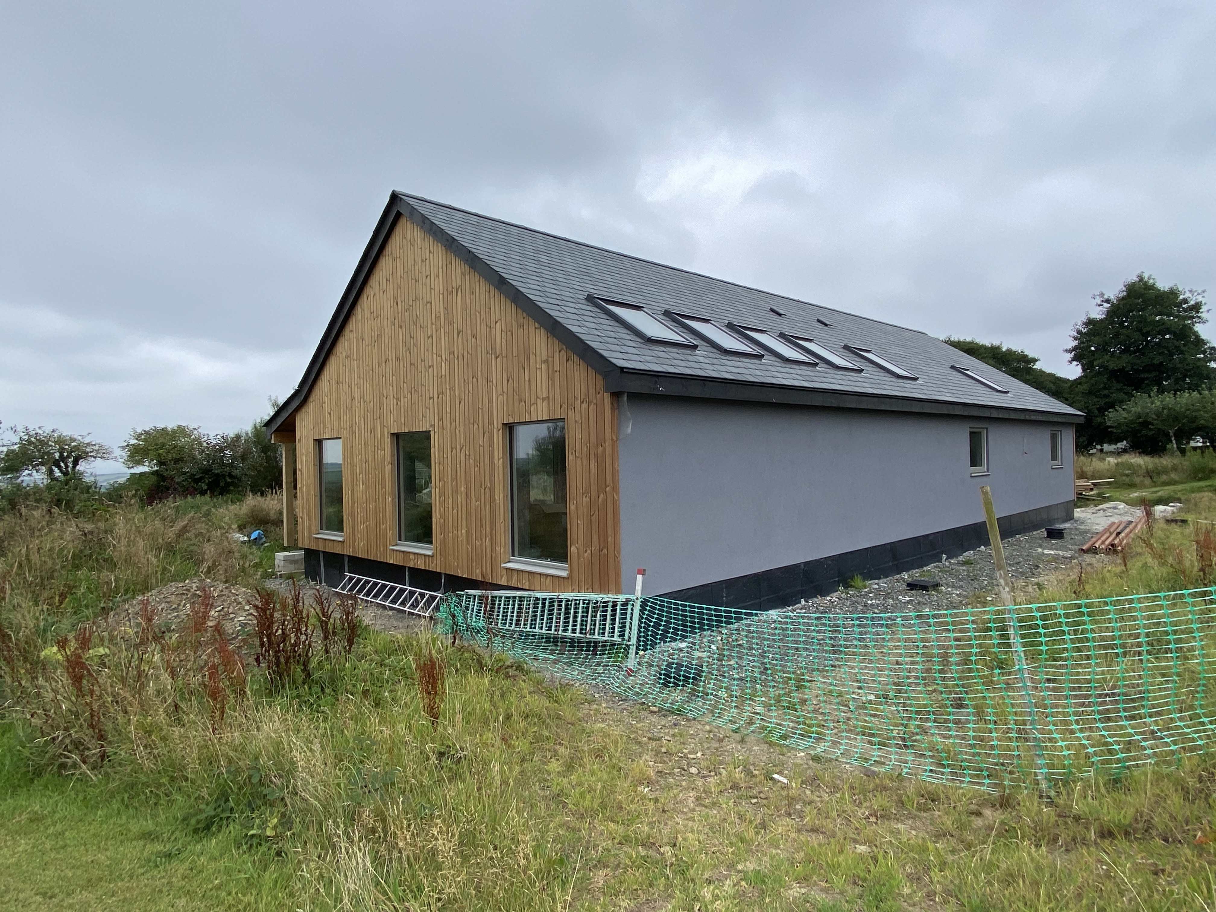

The cladding is finally complete.   David started the cladding at the end of March and I think it’s fair to say it took him a lot longer to complete than he expected, but like me he likes to get the details correct ie drip angles on bottom edges etc and neat finishing around the doors and windows.

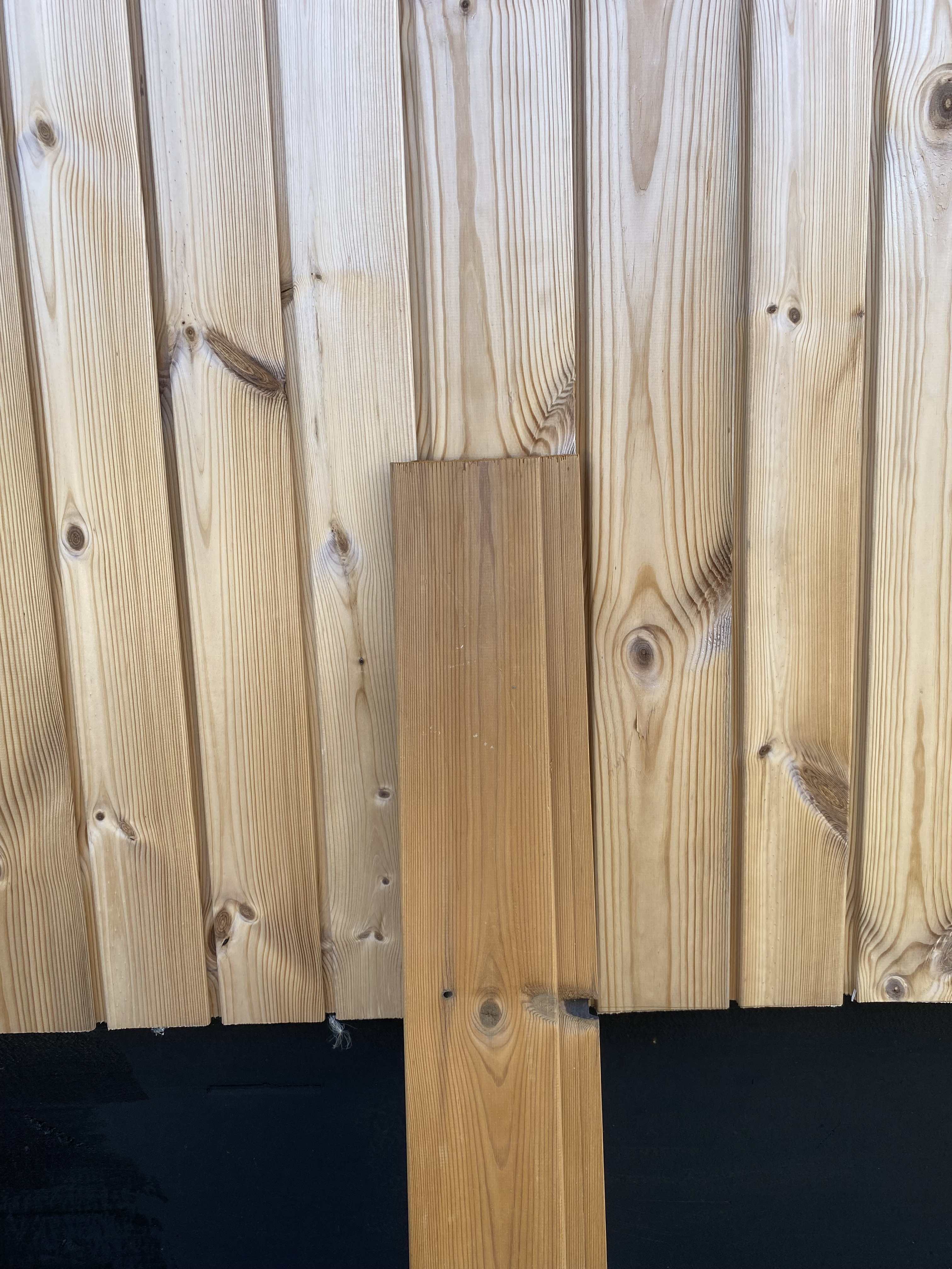

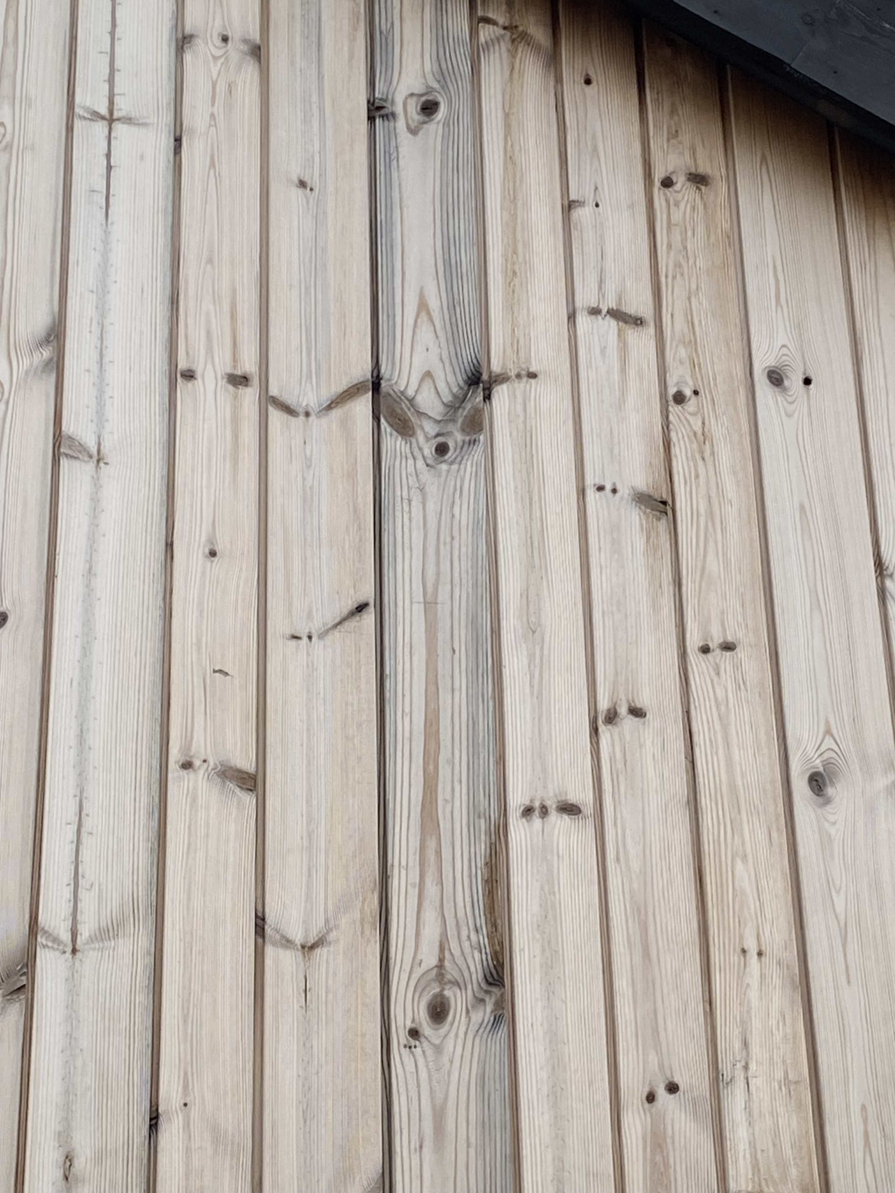

The photos show how the Thermo Pine has already started to fade.  We are happy with the colour changes it is greying nicely and hopefully will blend in with our working barn after another summer.
IMG_3172.thumb.jpeg.f7aca9c585e9291f639e7e60891b3836.jpegIMG_3174.thumb.jpeg.f6e52f1ee6f71a893adc1f89b7b12ce9.jpegIMG_3176.thumb.jpeg.ba07bdcf81c5c42b5f3db4185023f56c.jpegIMG_3191.thumb.jpeg.c79ee297ce5063f70bcd7175533d6781.jpegIMG_3230.thumb.jpeg.db21ef4bcbb4099e1be85aa31904ce07.jpeg
Above is a sample piece that has not been exposed to the weather and the other image shows the first signs of the greying colour change.

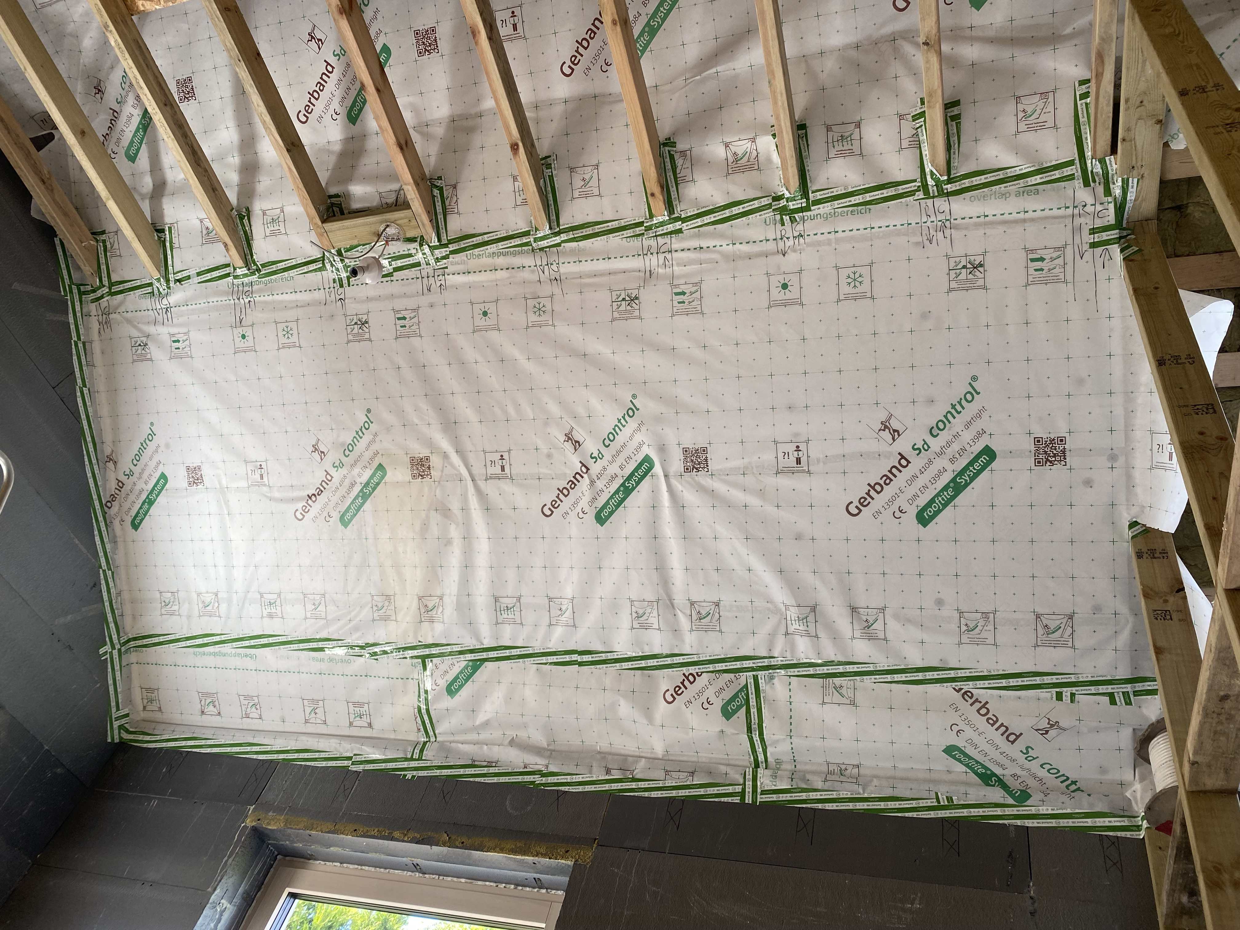

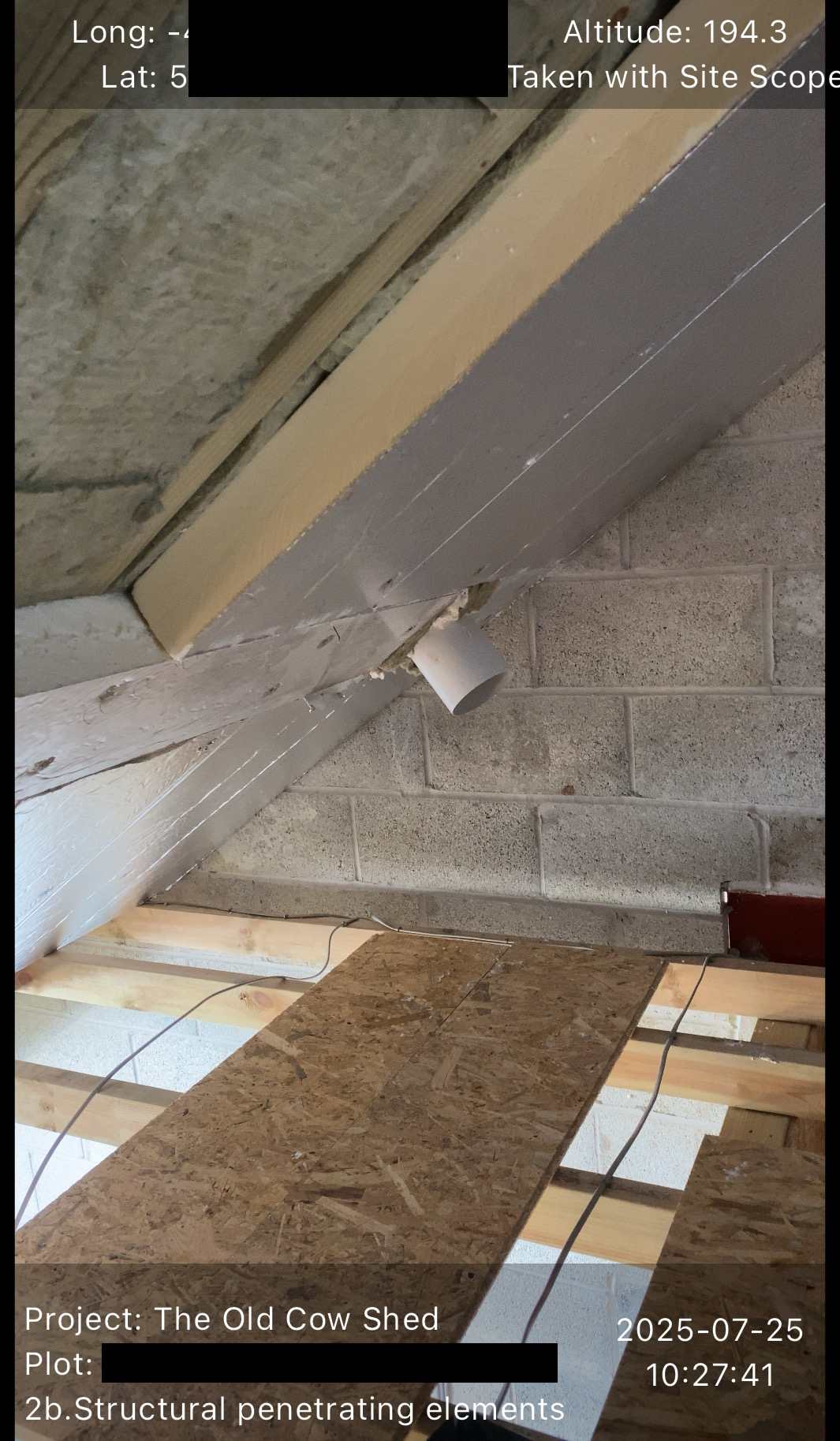

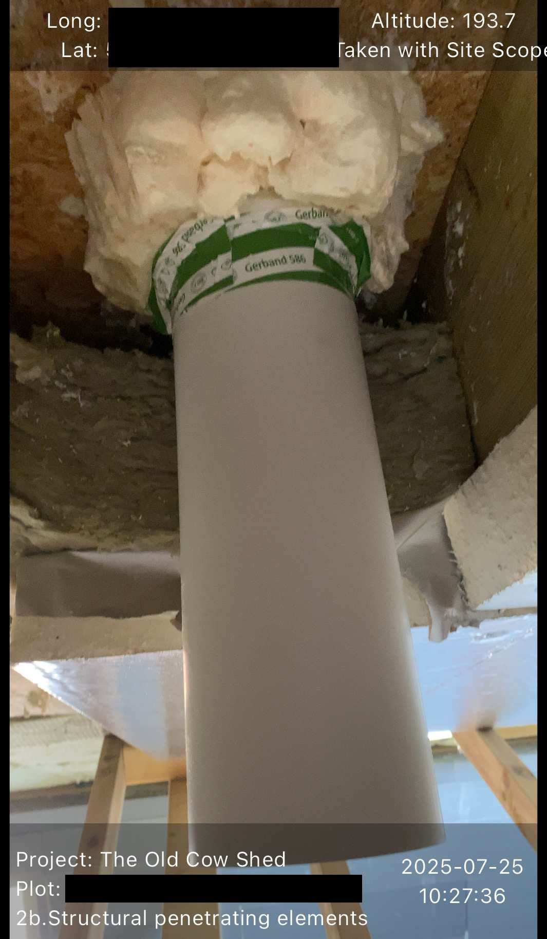

Inside I have completed most of the insulation above ceiling height, we have slopping ceilings in 2/3rds of the building that will be completed after the screed is done.  The MVHR ducts are in the roof, I carefully insulated around them as they pass through the Rockwool layer and the Celotex, then the VCL layer which is Gerband SD control. Not the most expensive VCL but still a reasonable price for a control layer.  Putting the VCL up on my own was tricky I used double sided tape to attach it to the Celotex initially pressing it on top, middle and bottom as I unrolled it for 12m. This held it in place surprisingly well leaving me ample time, (days as it often too hot to work in the loft) to tape it up properly with Gerband airtight tape.  I finally took a break from the roof insulation and moved on to floor insulation which is a much nicer job on my knees.

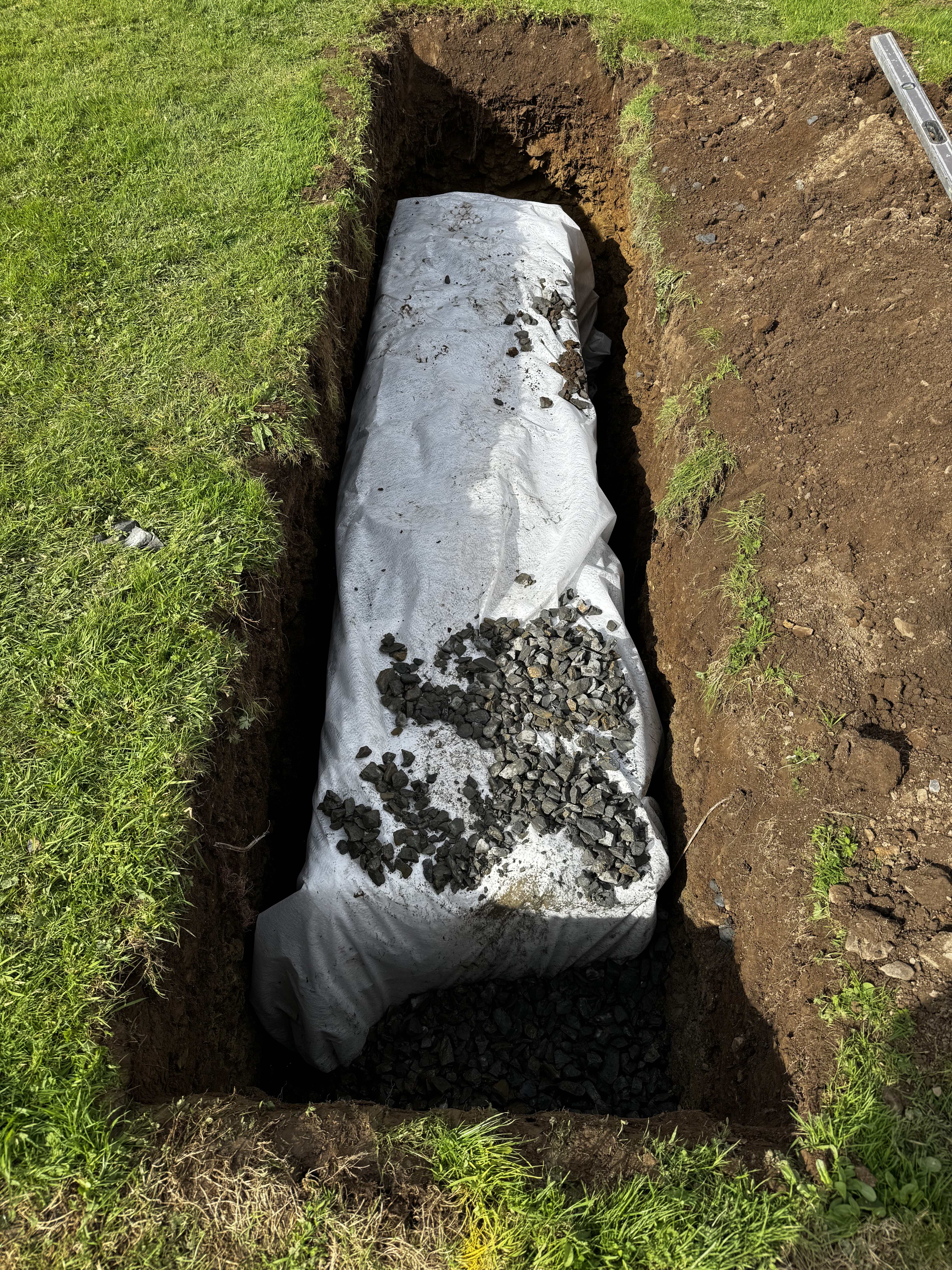

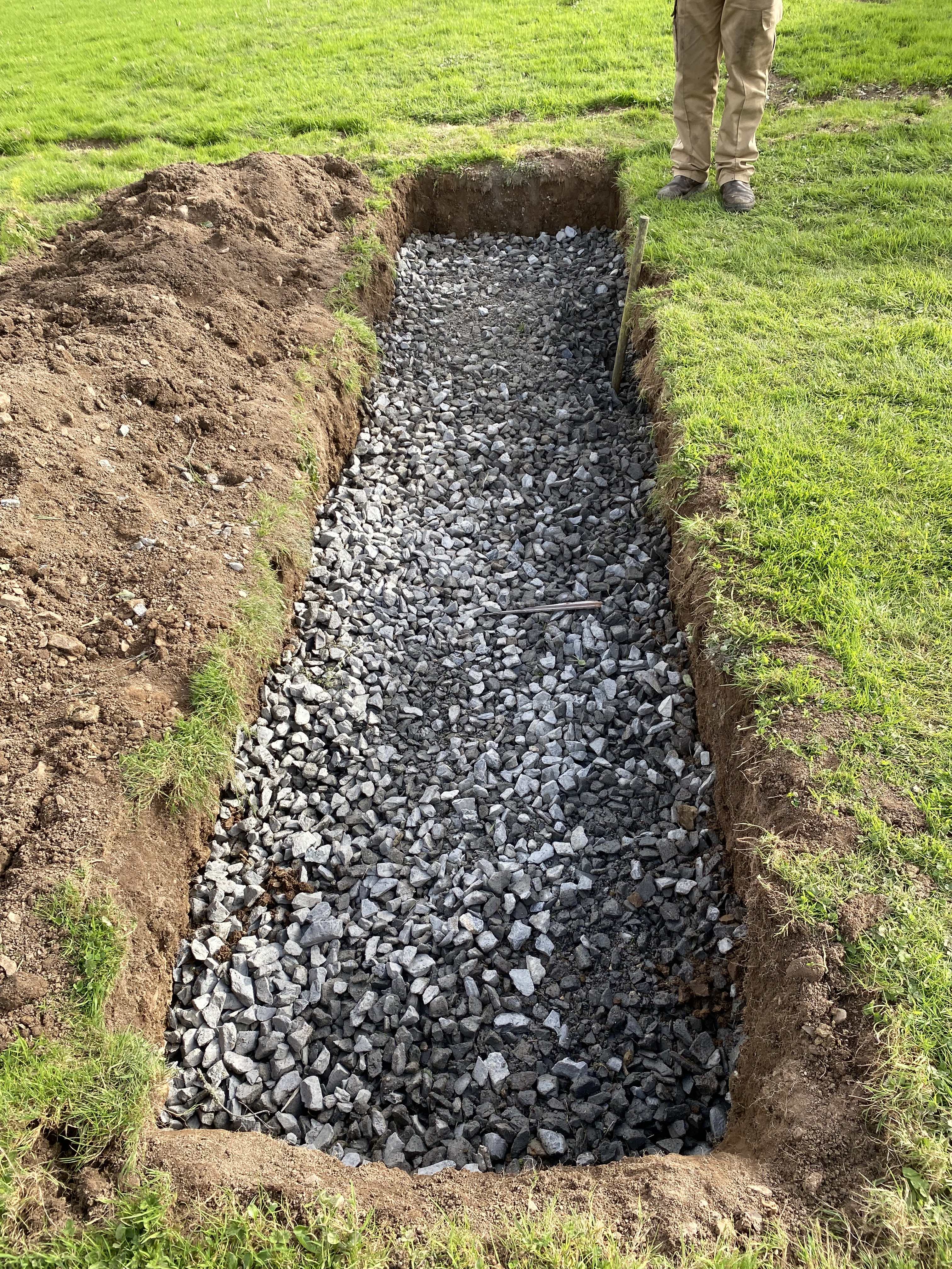

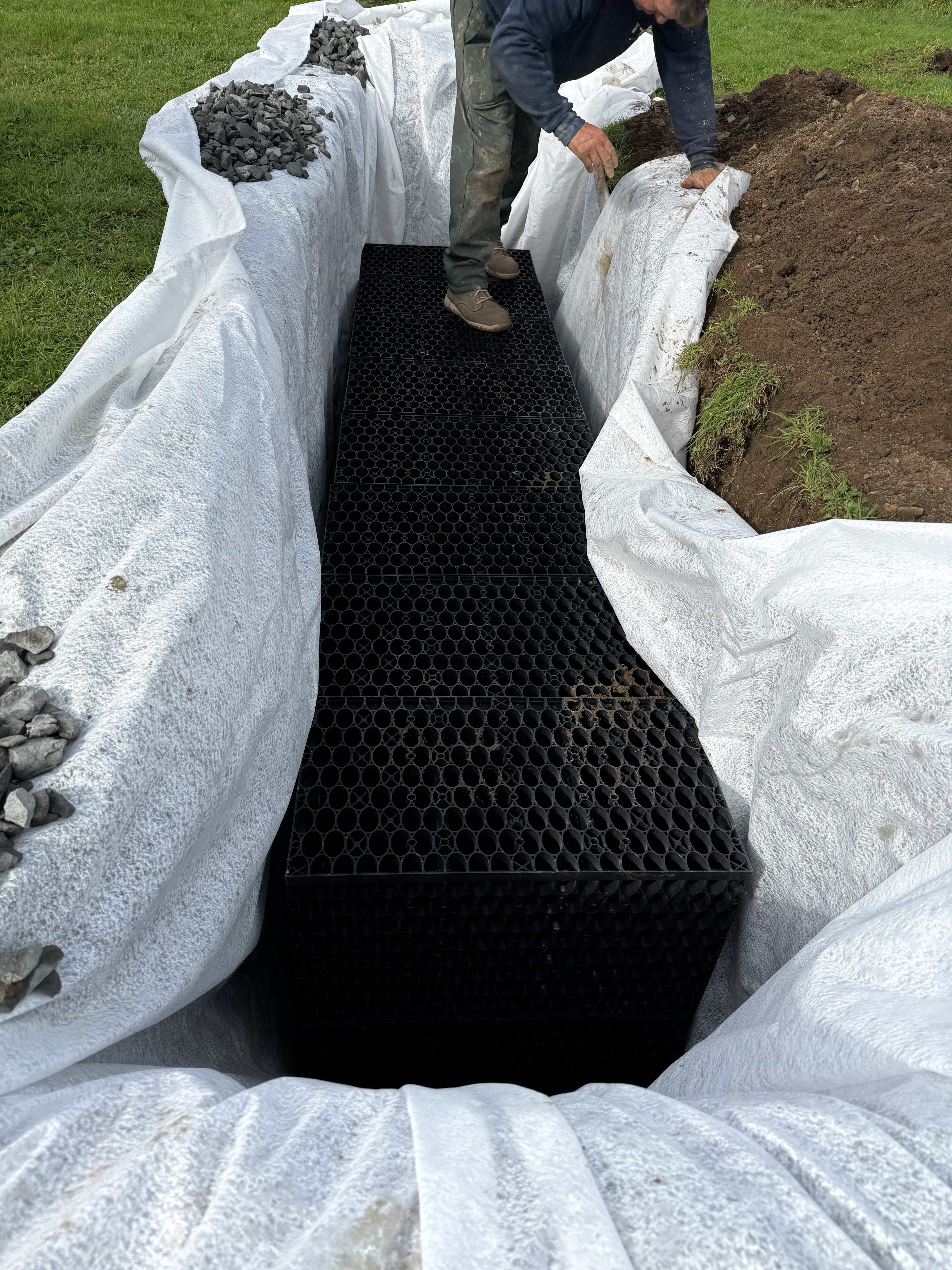

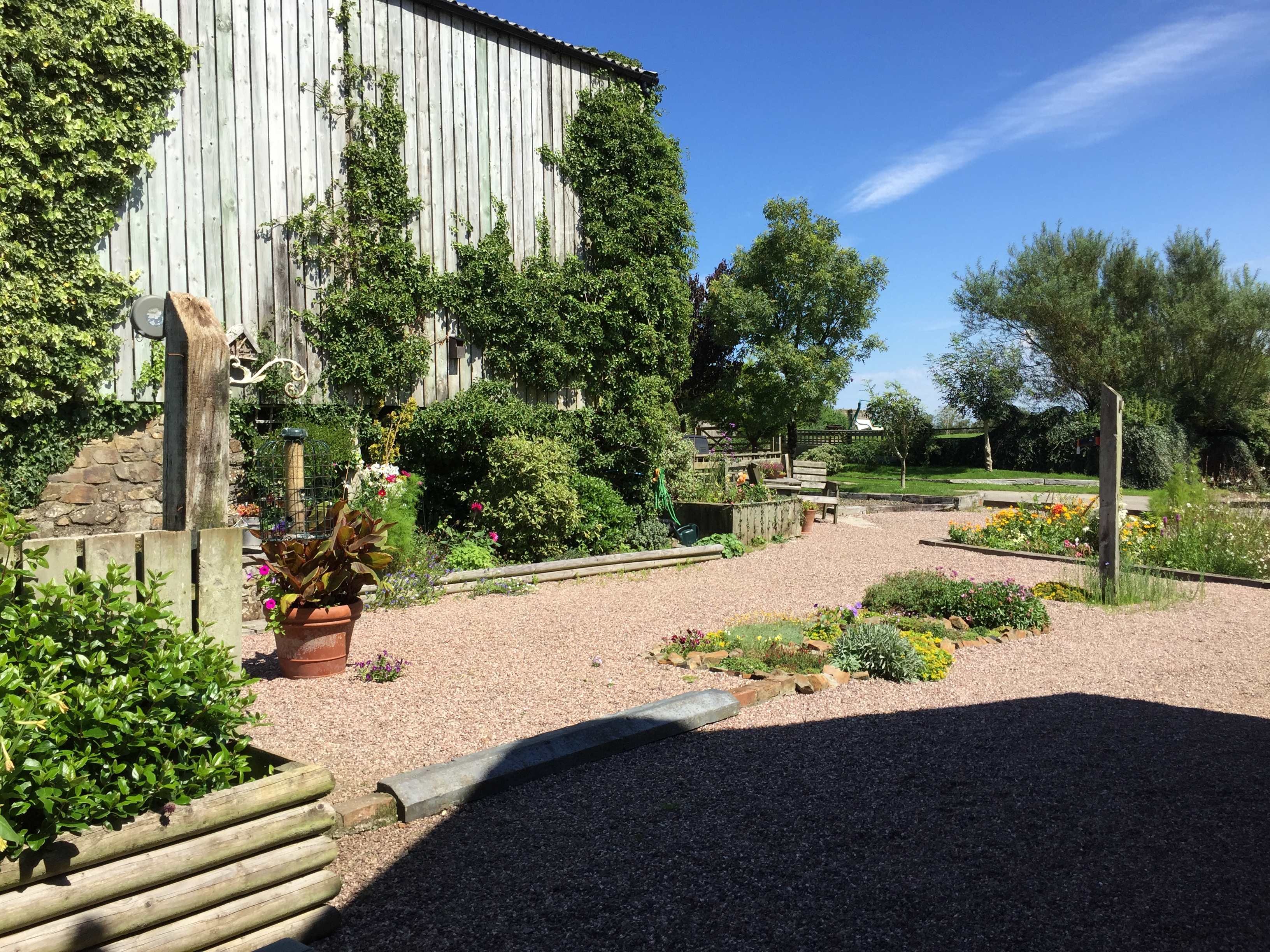

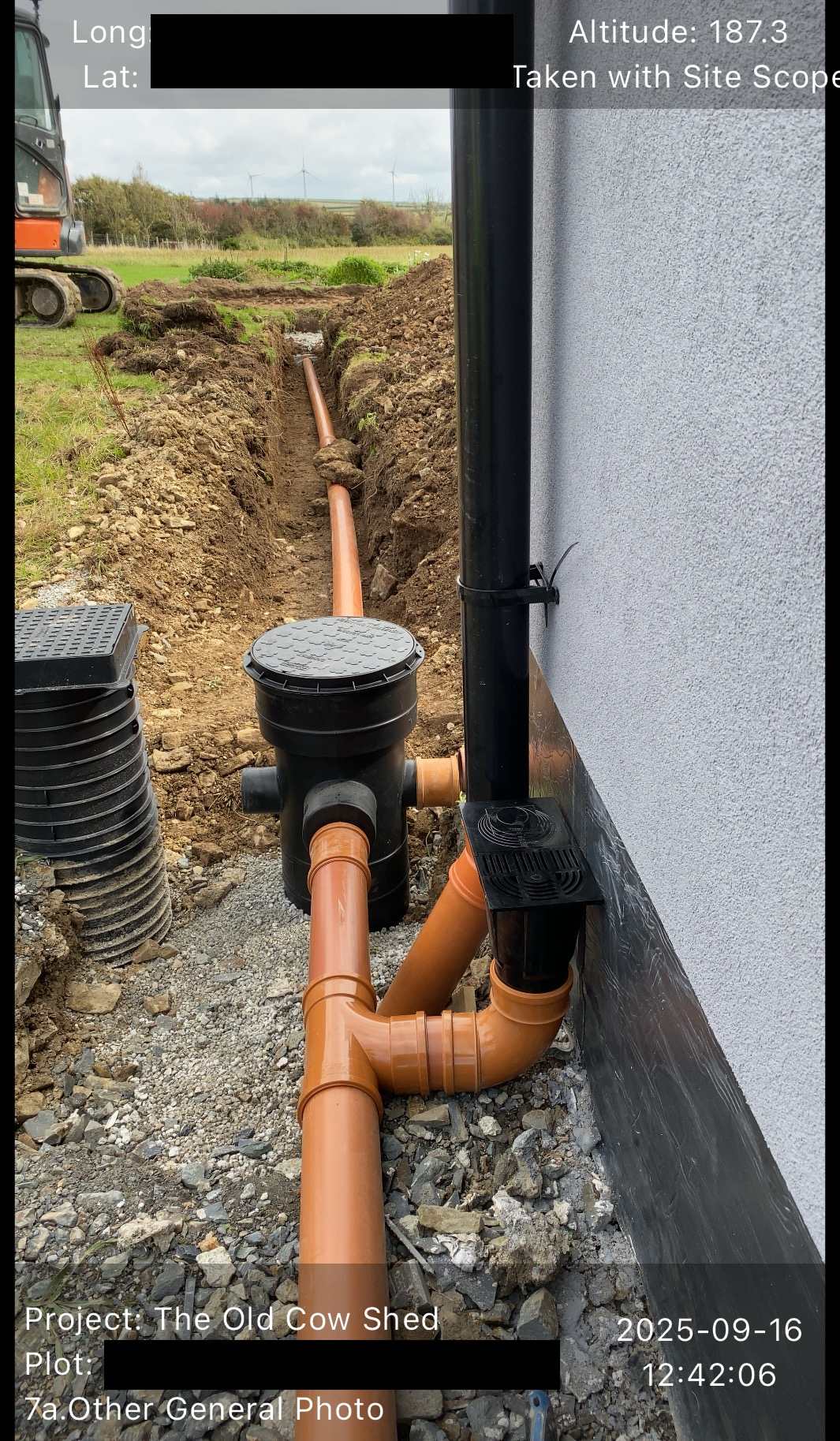

We now have drains connected to the main sewer line and our soak away is installed.  Next job will be the guttering. I had to take down my potting shed for the build but hopefully next year I can reassemble my potting shed in its new location which is the opposite side of the cow shed than it was previously, but my view is a lot nicer.IMG_3471.thumb.jpeg.41517ed4baee1ee19e957ab3465a68ce.jpegIMG_3472.thumb.jpeg.3801dca5b19a4cde4f3a6999cce8a46e.jpegIMG_3222.thumb.jpeg.548bfbb30c929d3cdd5094ba784f8bd7.jpegIMG_3236.thumb.jpeg.7d8ba1a7fc26a48da39920bc3cccb597.jpeg

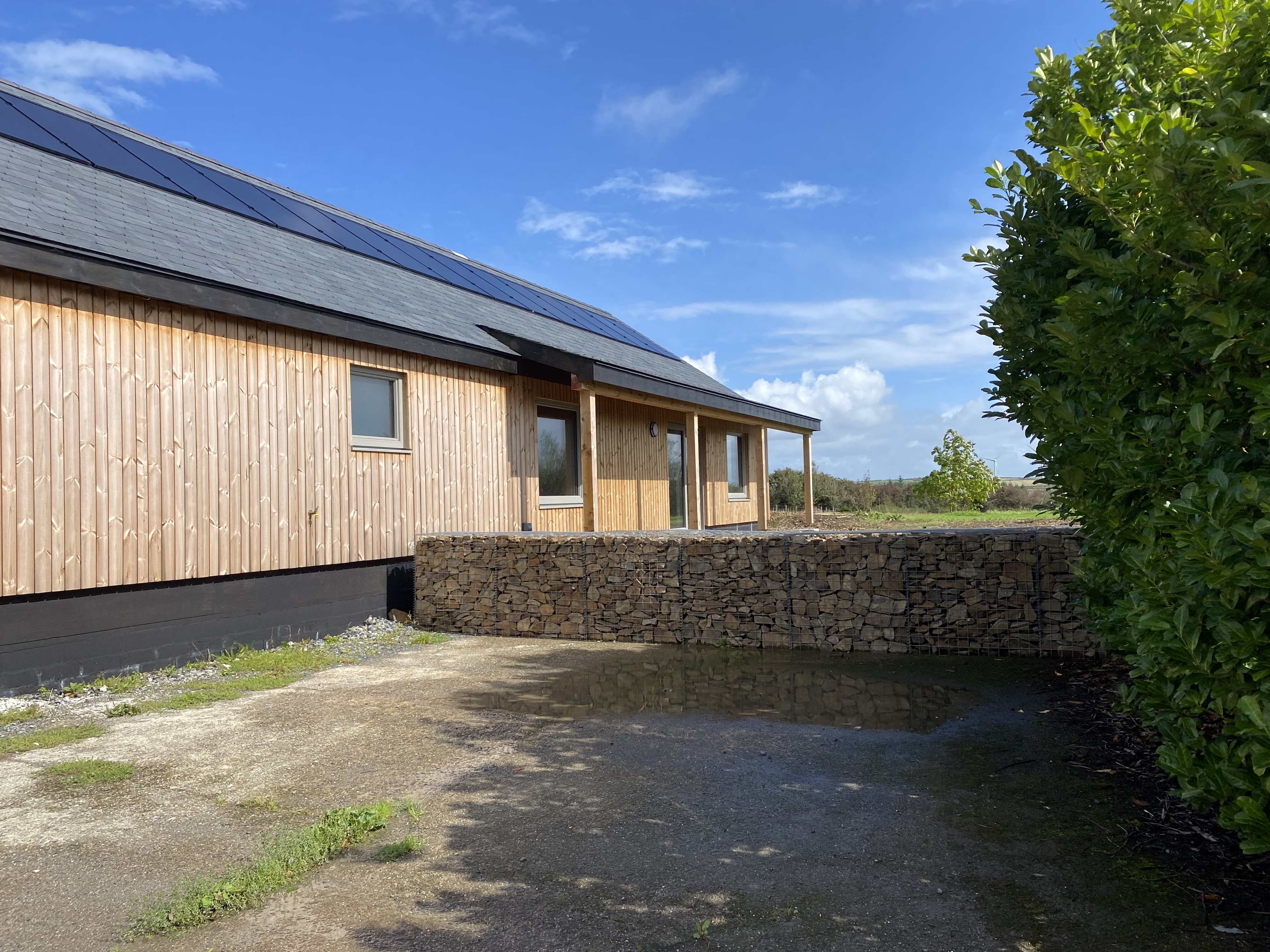

I also finally finished the Gabion wall, I used all our own stone and rubble.  Most of the stone was from the initial groundworks that we had moved down to the lower field.  This meant that I took the lawnmower and the garden mini dumper down there, climbed the piles and picked out the best stone and brought it back up to the house.  When I was nearly completed and I knew the groundworks team would be returning for our drainage connection and soakaway I decided to wait for them to hopefully unearth some more nice stone.  They did but I had to work fast to use it before it was back in the ground around the house getting the levels correct.  There is still a lot of stone in spot on the lower field but for now I don’t want to build any more Gabion walls.  Of the trades people we have had on site so far the groundwork’s have been the best and I would be happy to recommend them.
To the left of the photo is the old stables you can see how this wood is aged, hopefully our Thermo Pine will age similarly and blend in.

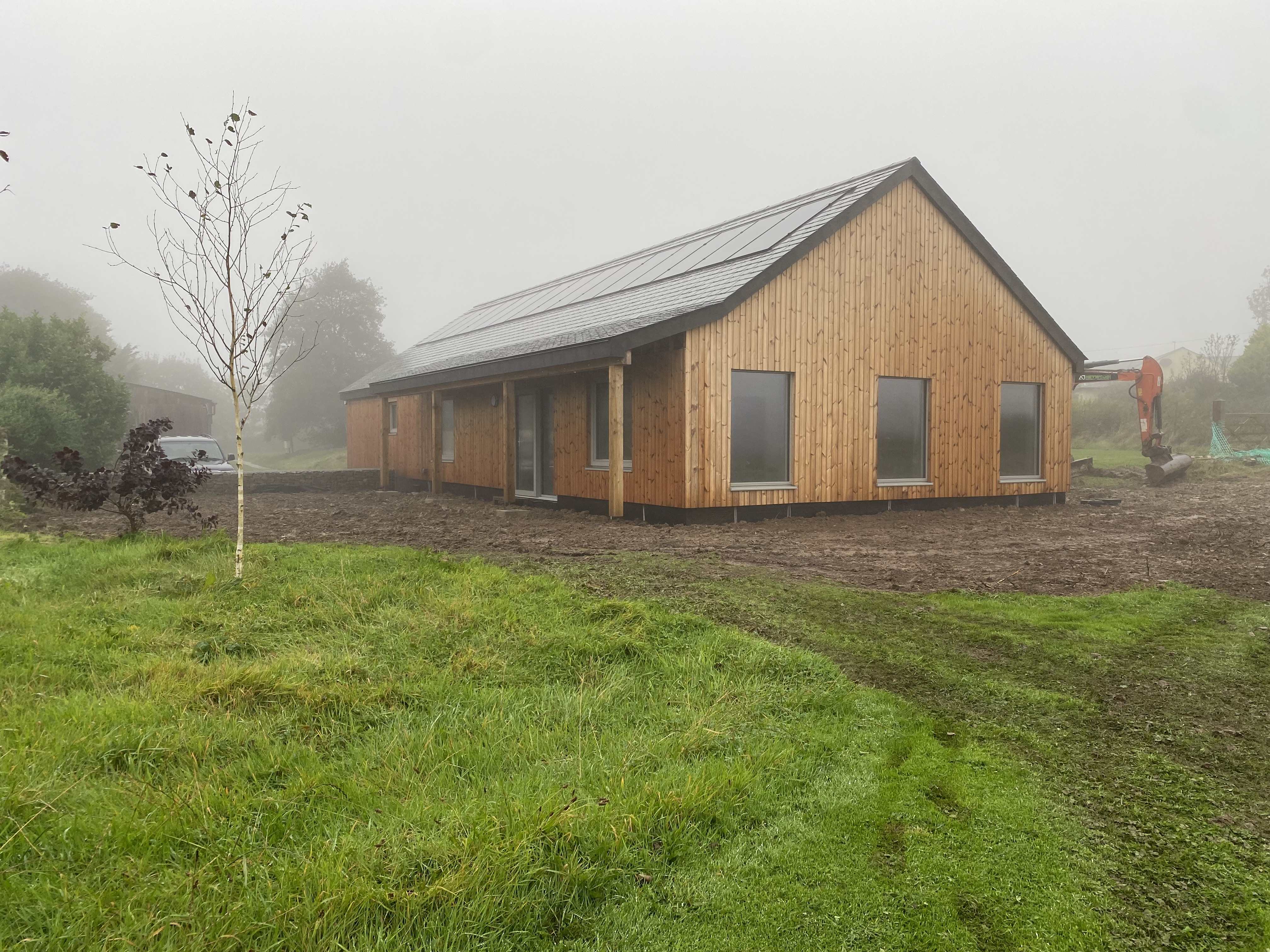

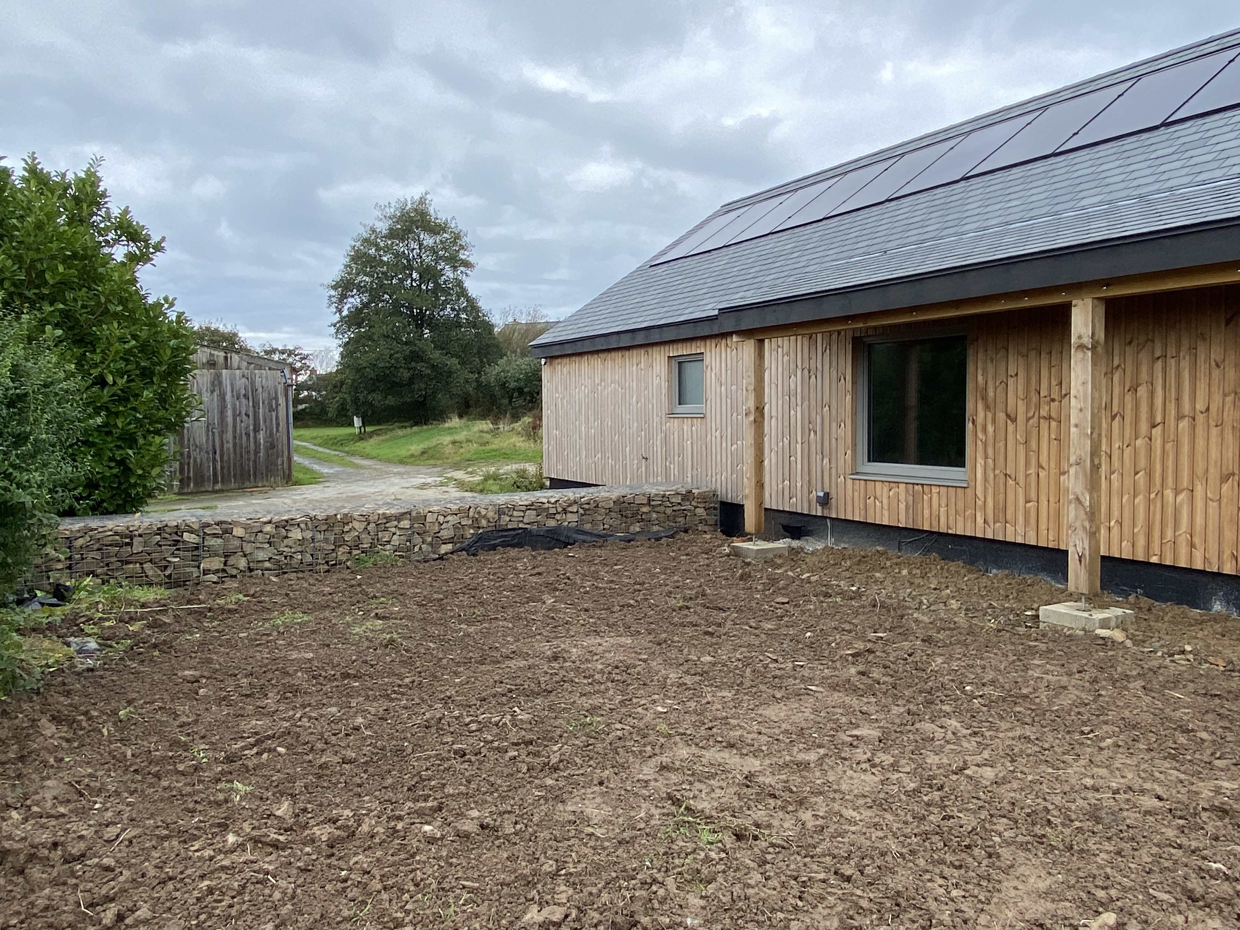

The photo above was taken just after the Groundwork's finished for the day, you can see the mist has blown in and the cladding looks different again when wet.
The following day and we can see how great a job the groundworkers have done, its hard to believe this is the same soil I have picked the stone for the Gabion walls from.
They sorted the soil with the digger and buried the bigger stones leaving quite good soil on the top.
They are returning next week with a bigger dumper truck to bring the soil back up from the lower field.  They will then fill in the bit to the right of the photo and round the front.
