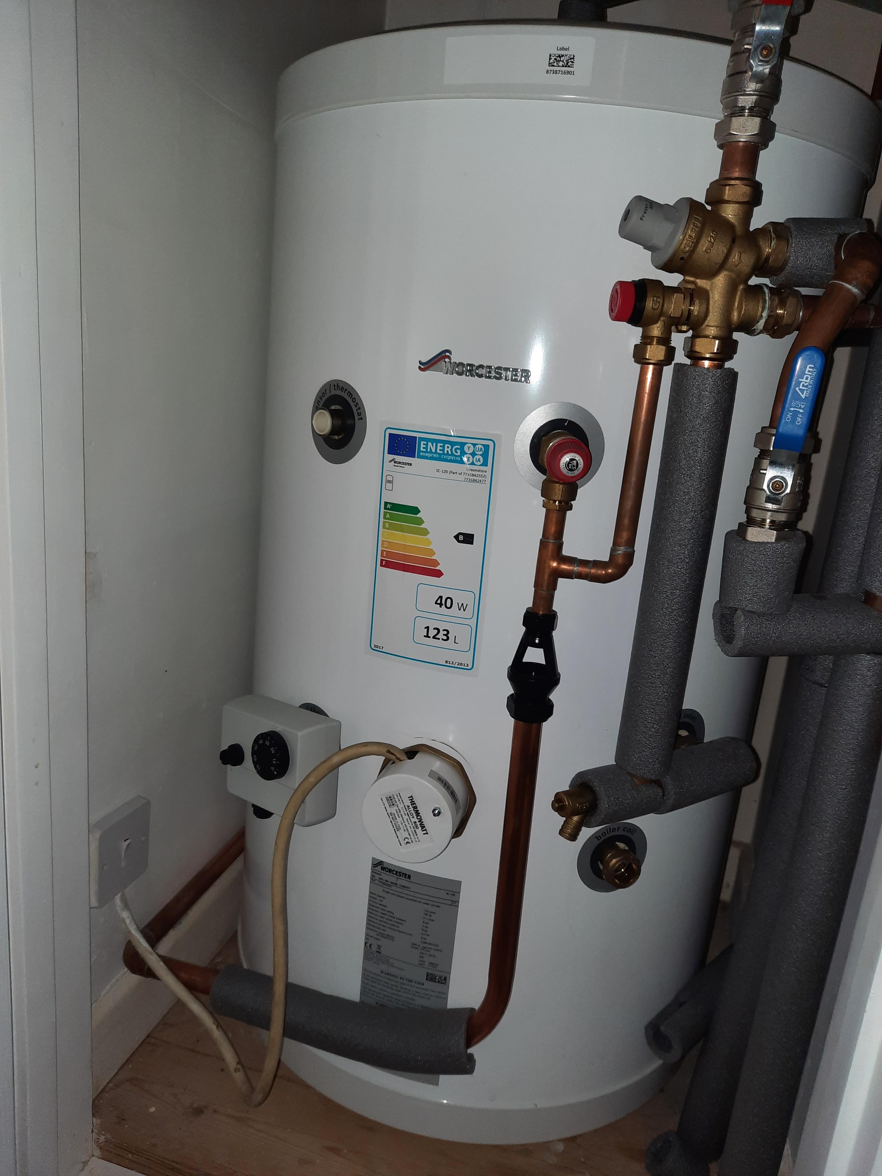

Life has been busy since I started the blog so apologies for the lack of posts.  However, the hot water went off in the bungalow on Monday so this has become an issue again.  In April, the hot water also stopped working.  I called Worcester then as the hot water cylinder was still under warranty. When the engineer arrived, he replaced the immersion but he did say that the installed hotwater cylinder, a GreenStore SC 120l indirect unvented cylinder, should have a boiler to heat the water.  We dont have a boiler.  The hot water is heated overnight by economy 7, via the immersion.  He said it was not designed to heat the water all the  time and that was probably why it failed.  It was installed in Dec 19.
So I am not sure if the plumber who provided and installed the cylinder gave us something incorrect or not?  He obviously knew we didnt have a boiler.   But too late to moan about that.

Another call from the parents this morning changed things slightly.  They had not realised but it was the whole night-time electricity supply that wasnt working, not just the immersion!  They have a very strange system with 2 completely separate rings. One, runs off daytime, and has everything on it apart from the hot water cyclinder immersion and the night storage heaters.  The other, night time has the rest.  It would make sense to run the washing machine at night but this is on the daytime ring, so uses daytime supply, whenever it is used!  Very odd.
So I therefore cancelled the Worcester engineer and called Octopus who were very good and sent an engineer out this afternoon.  he checked and confirmed that the night time supply was not getting though so installed a new smart meter.  We are holding our breathe to see if tonight, it heats up the hot water.  But the cable did light up his gadget - so it looked okay.  And the Smart meter should help us see what is using their energy as they seem to be using far more than I would have expected from a small bungalow.
