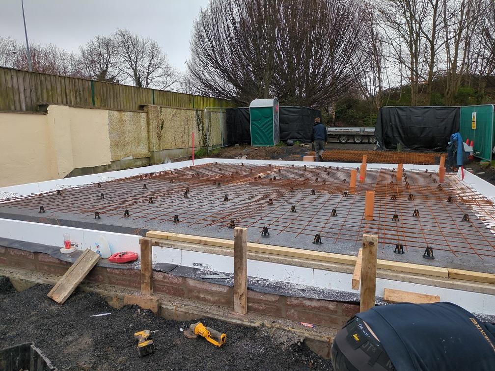

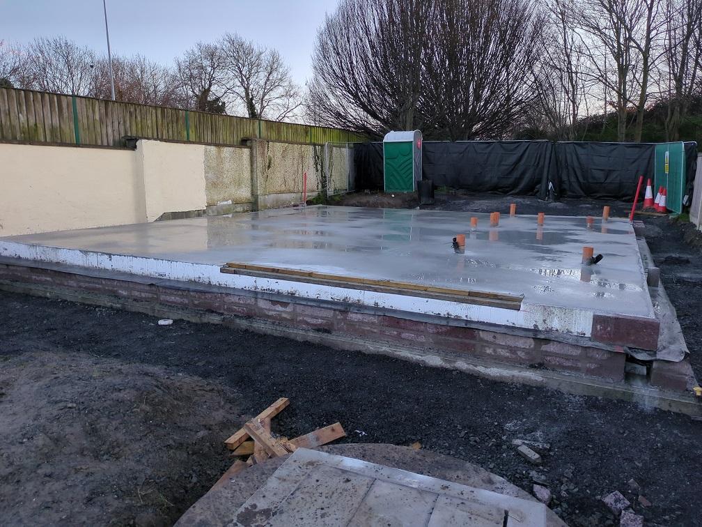

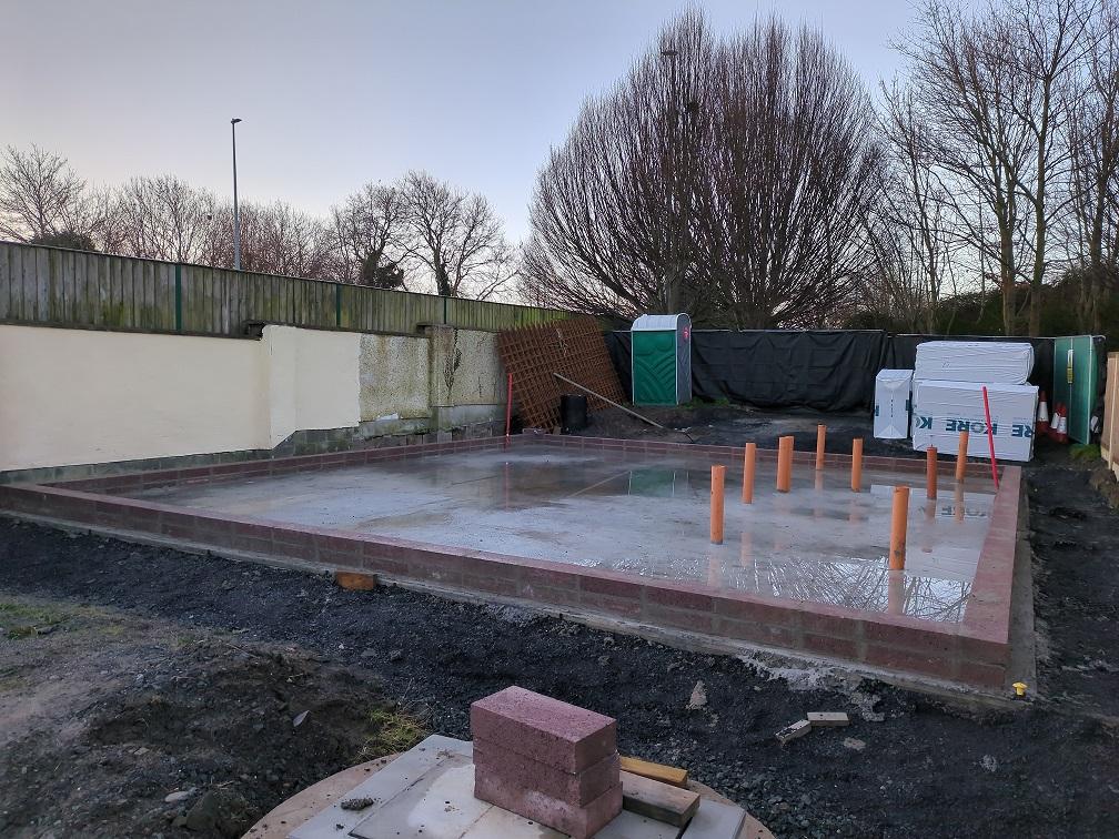

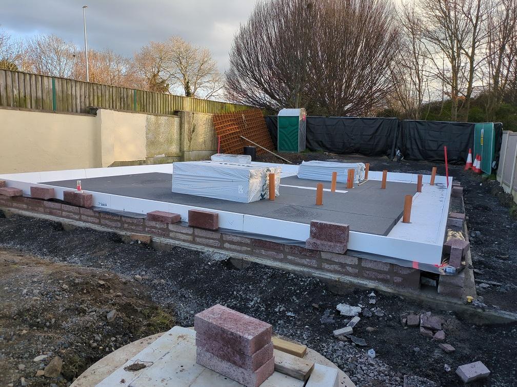

Finished the Kore Passive Raft Foundation this week. Just in time as it's currently sleeting it down out there! Cold enough to make a pour more difficult. they set in a 70mm rebate for the lift & slide door and also cut out the kore to let the concrete out to the edge (up to shuttering) for a steel post to carry the blockwork over the two corner windows. We'll insulate around that later. the Kore went in really fast, then rebar, ductwork for the kitchen island and getting it finished before more cold weather kicked in. It rained just after lunchtime which slowed down the curing. But really pleased with progress and we're ready for the timber frame next!
