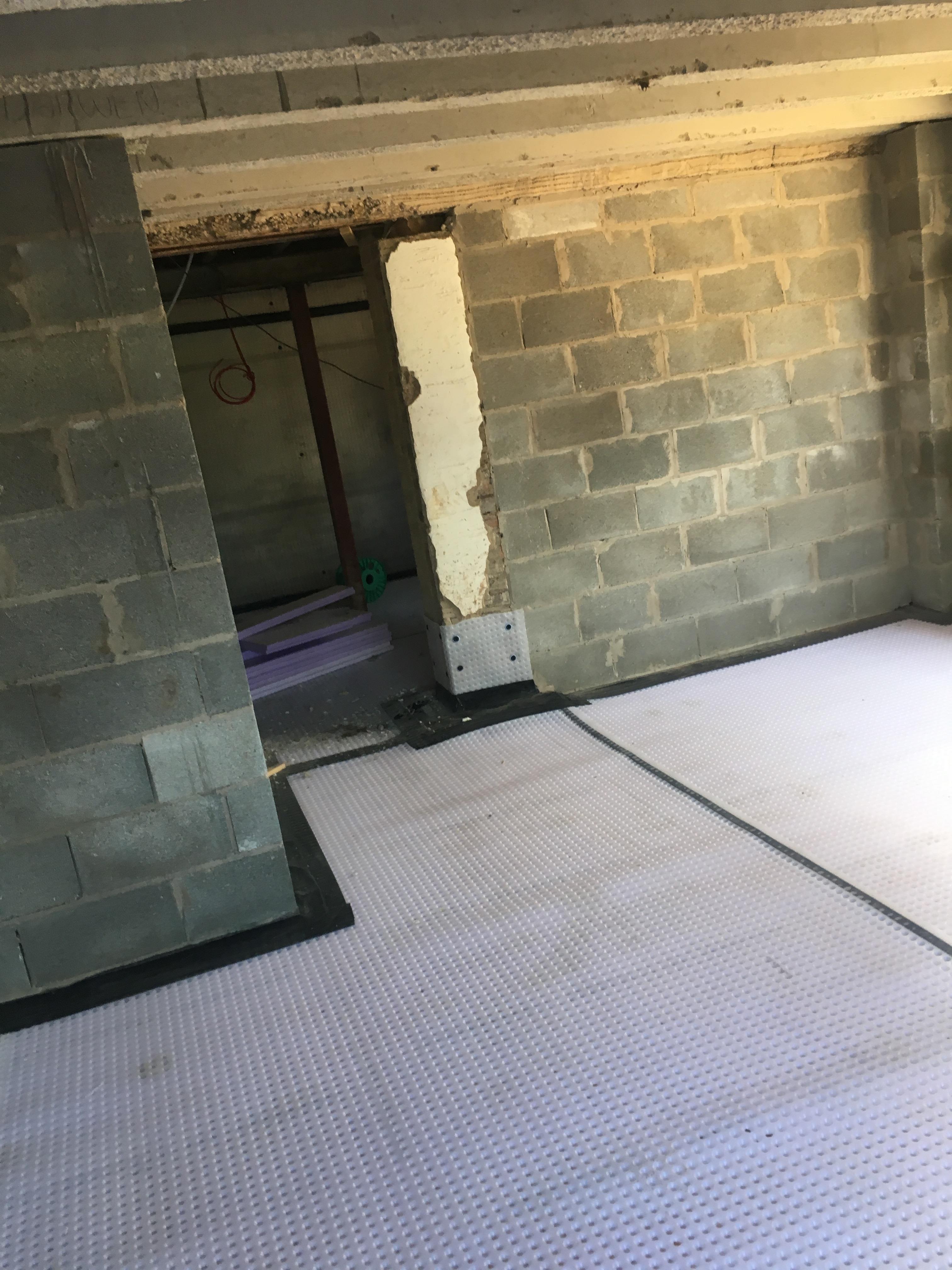

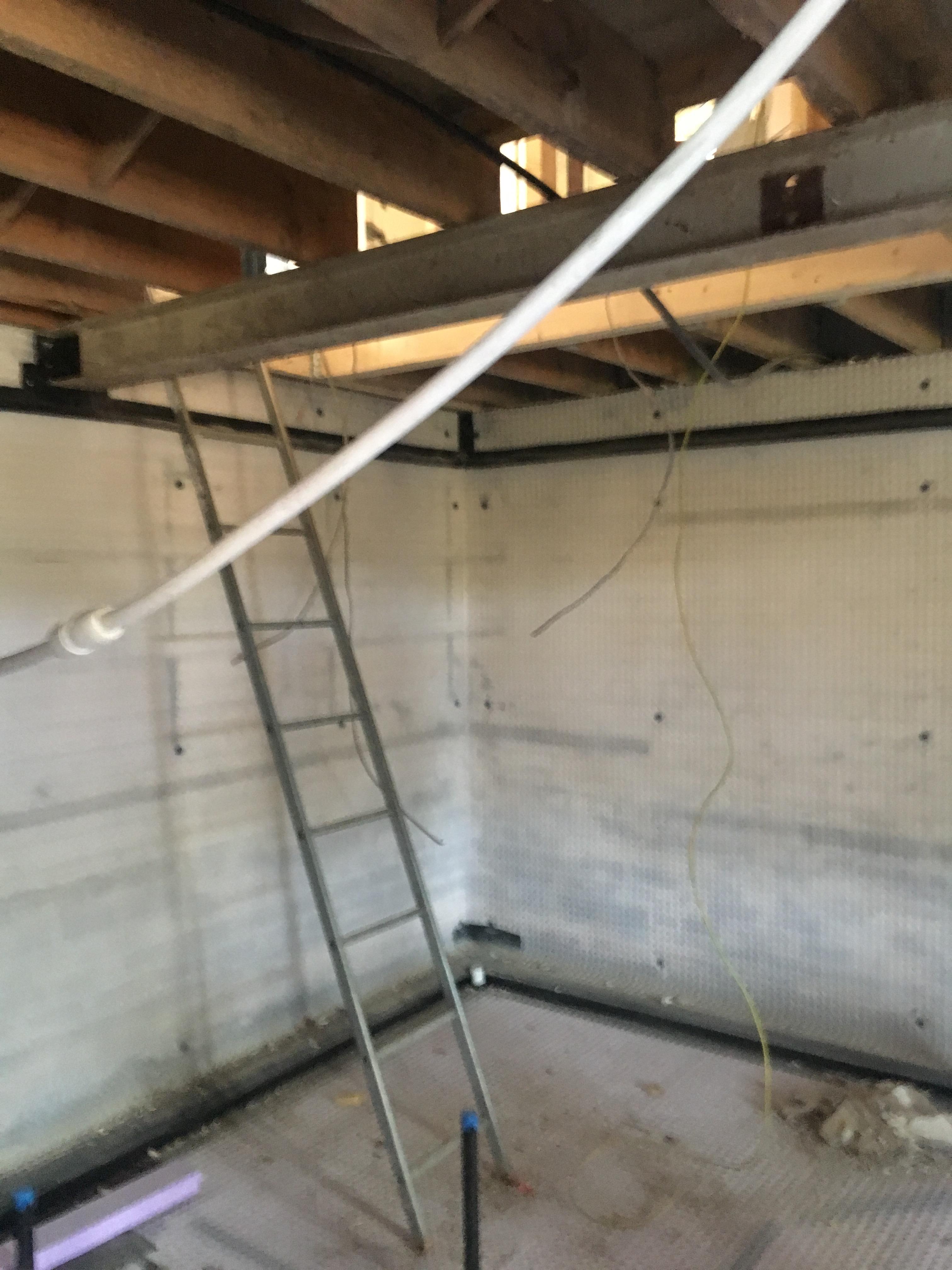

We have recently started quite a large conversion at Bilsborrow near  Preston
I remember someone asking about Mf and membranes
As you can see from the pictures is not rocket science
membrane covering floor walls covered and plugged drain around the perimeter All taped together 50 mill free standing mf stud to go around the perimeter 400 centres or perhaps i studs
To be decided Track glued to floor membrane
Thought a few pics may help someone
