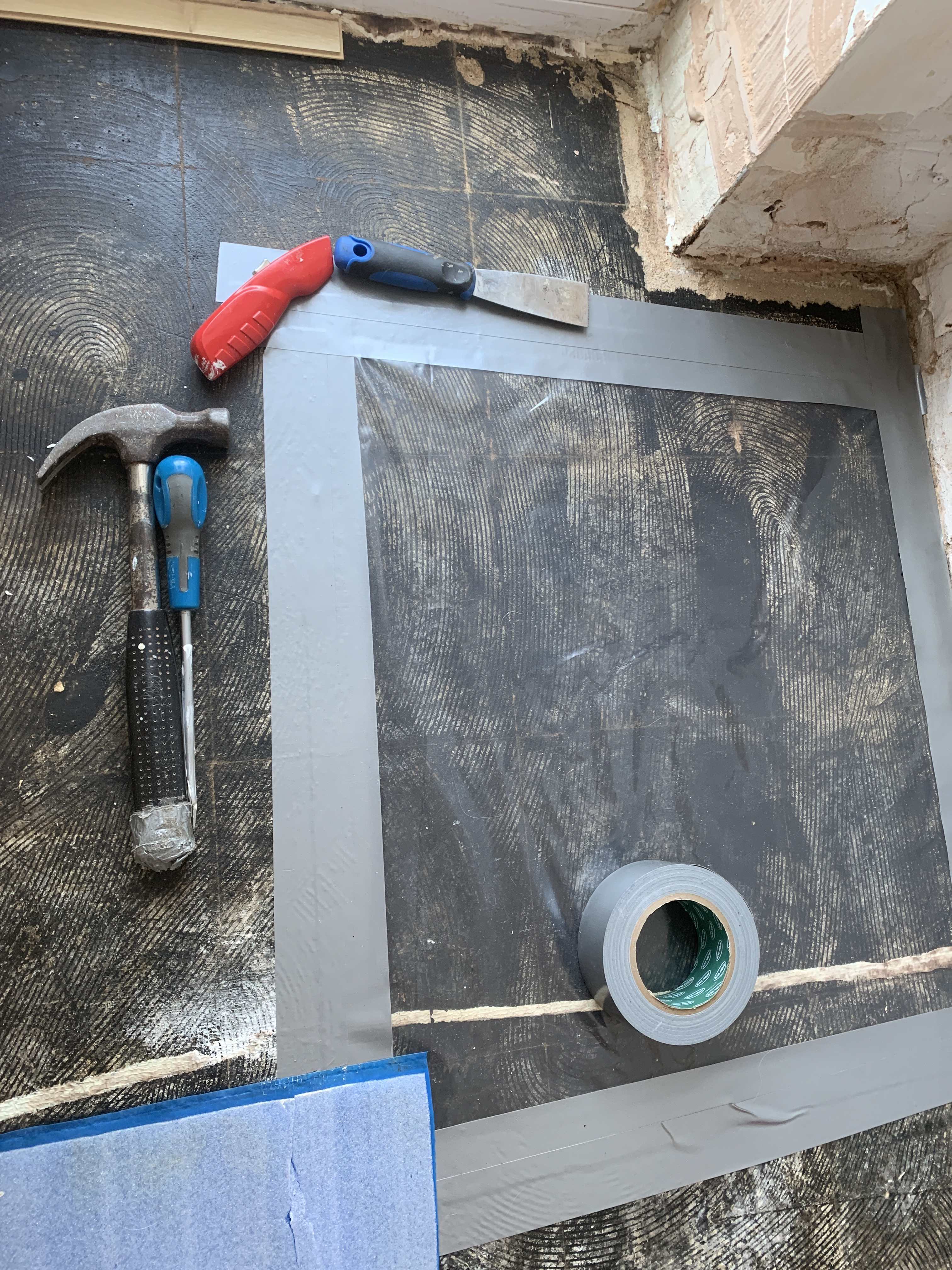

Hi everyone,
looking for some advice before I start and possibly make any major mistakes.
I'm going to be taking up an old click flooring in the hallway and laying some lvt.
Where I bought the lvt from said they would come and do a moisture test but after numerous text back and forth never turned up.
I have taped a square of polythene down but not sure if this is giving me the most accurate reading.
i can’t see or really tell if damp is present although a corner of the plaster bead is slightly rusted on one wall.
So getting to the point should I just epoxy resin prior to self level compound?
these are the materials I’ve got in my cart.
Also can you recommend the best adhesive  to use.
Regards. James

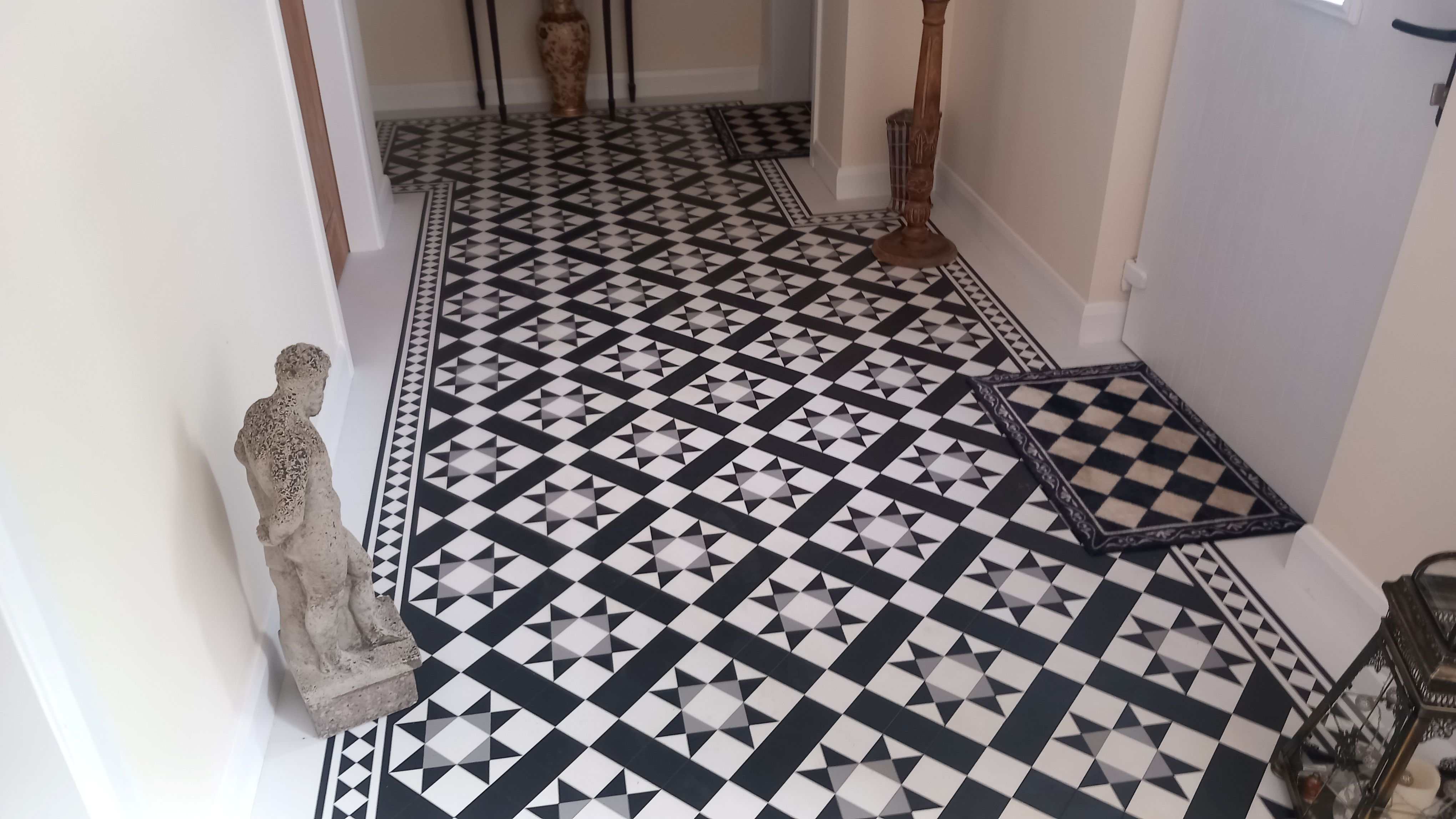

theres a perfect floor all made from little bits

@scottishjohn
thanks for your reply, I have read a few bit on here not sure if I’ve read this yet but will have another look through the forum.
the floor in question is an old existing slab which has been covered with click flooring for over 20 years.
I was hoping to just apply about 6-7mm of self level compound to raise it up and that would be ok to apply glue and lvt, I don’t think the existing floor is to bad.
this is a pic of it and you might be able to make out the rust on angle bead too.
