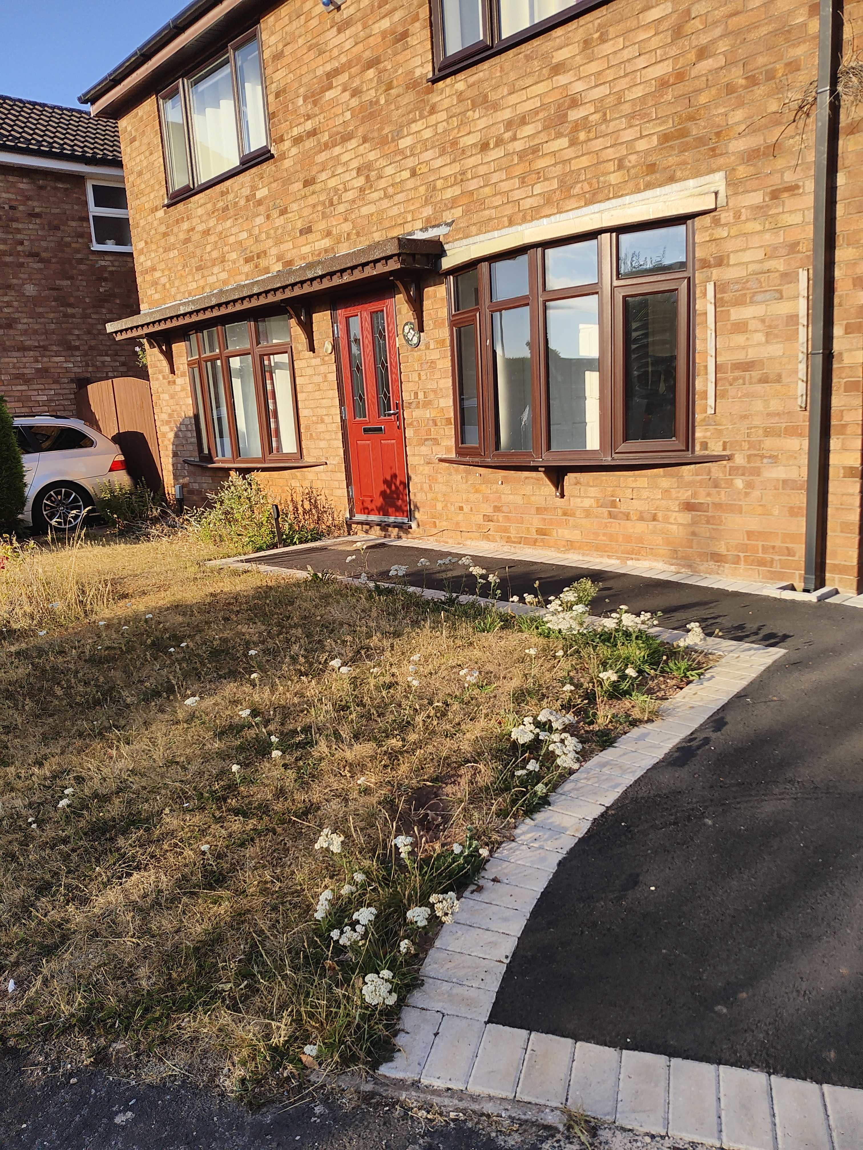

I Have fitted normal flat windows/front/back doors/french doors and sliding doors so I'm fairly confident i can fit a pair of bay windows. The kind i have are the ones that just stick out with no brickwork below or above, I think some people call them bow windows.
The current window bays are a bodge and have some big trims around the edges. so i think they got their measurements wrong so im not going to copy them. When i first moved in i peeled the internal trims off and there was some nice big gaps filled with scrunched up newspaper so i dug that out and foamed them.
Is there a way i can survey them from the outside? like ive done all the other windows/doors ive done.

the walls are brick outer block inner, no cavity closers. no check reveals.
How to measure the width of the opening is what is throwing me.
For a normal window i would measure the width externally top/middle/bottom then subtract 5mm from the narrowest. But i cant measure these externally as there is a roof/ bay window in the way, I could measure the bottom easily enough then use a spirit level to gauge on how straight the edges are.
Measuring it from the inside and adding a bit on to compensate just seems wild to me. I know folk do it this way but i guess i don't have the balls.
The window closest with the flashing tape roof would have been a flat window initially. the other is externally glazed.
The end goal is a full width mono-pitched tiled canopy. new bays. redecorate living room, sort the front garden then i will be ...Finished.. 😁

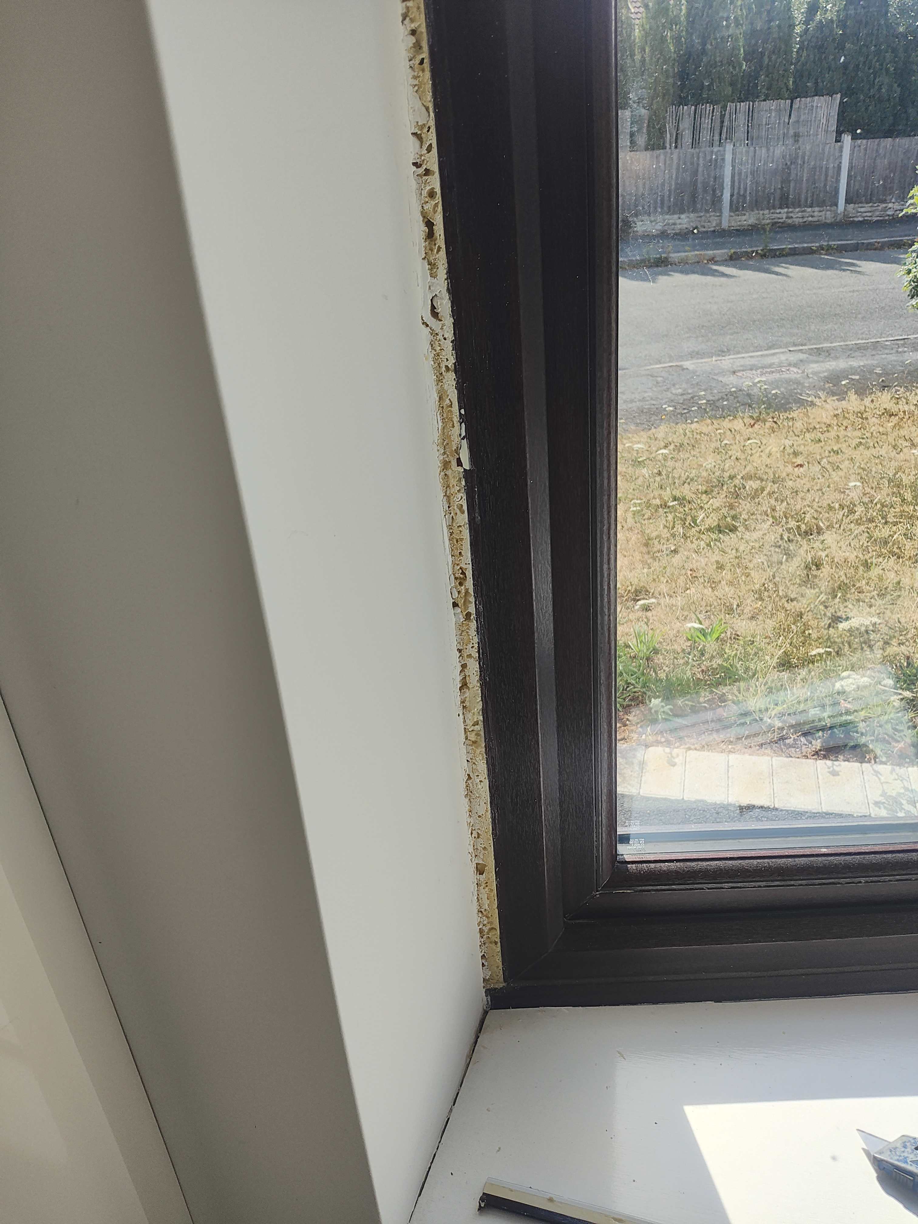

I removed all the trim off the inside of the furthest away bay in the picture with the canopy roof and it seems whoever installed it cut the internal wooden window board wrong as the upvc window sill is just floating and does not sit on the wooden sill at all i can see daylight as there is a 5-10mm gap all around the inside of the window from and the wooden sill.
The plaster board ceiling for it sits ontop of the window frames, Tap the plasterboard and it sounded hollow, grabbed a screwdriver bored a hole through in seconds, So obviously nothing above that.
Scary what you find sometimes.
