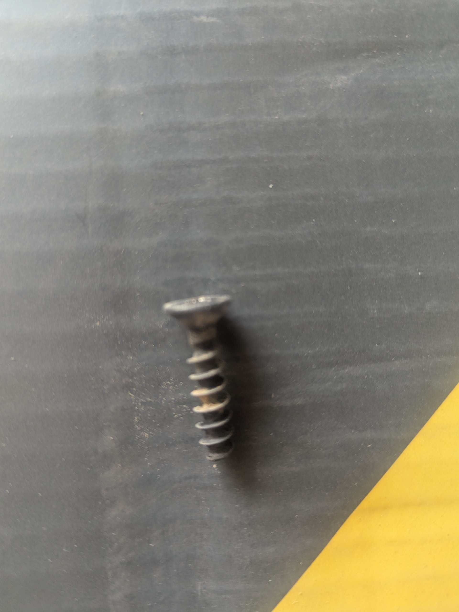

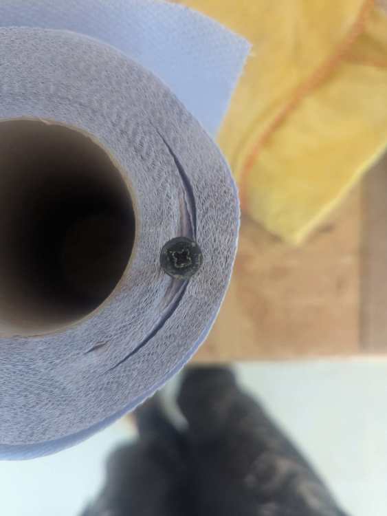

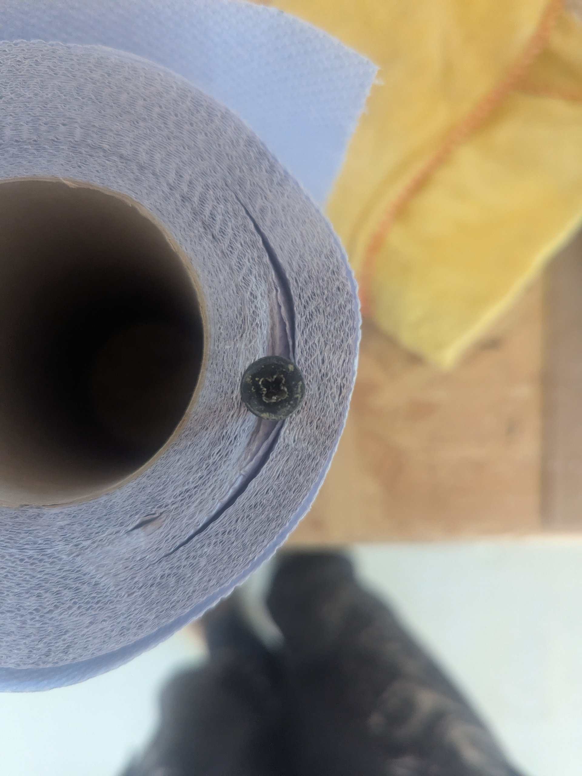

I have quiet a few Wavin inspection chamber cover screws which are damaged.
Does anyone know where I can get some replacements.

The screws are pants, in the past I have drilled the holes and tapped M8 then used M8 stainless countersunk set screws with head for hex key. You could probably get away with M6 but I just had some M8 available.
Edited by markc
Its worth doing a @markc above anyway because stainless set screws reduce the annoyance of lifting the  I/C cover when - several years later -
you're in a hurry to get it lifted .
And, of course, the slot for the screw driver has been buggered. Might be worth a Torx screw head (?)
