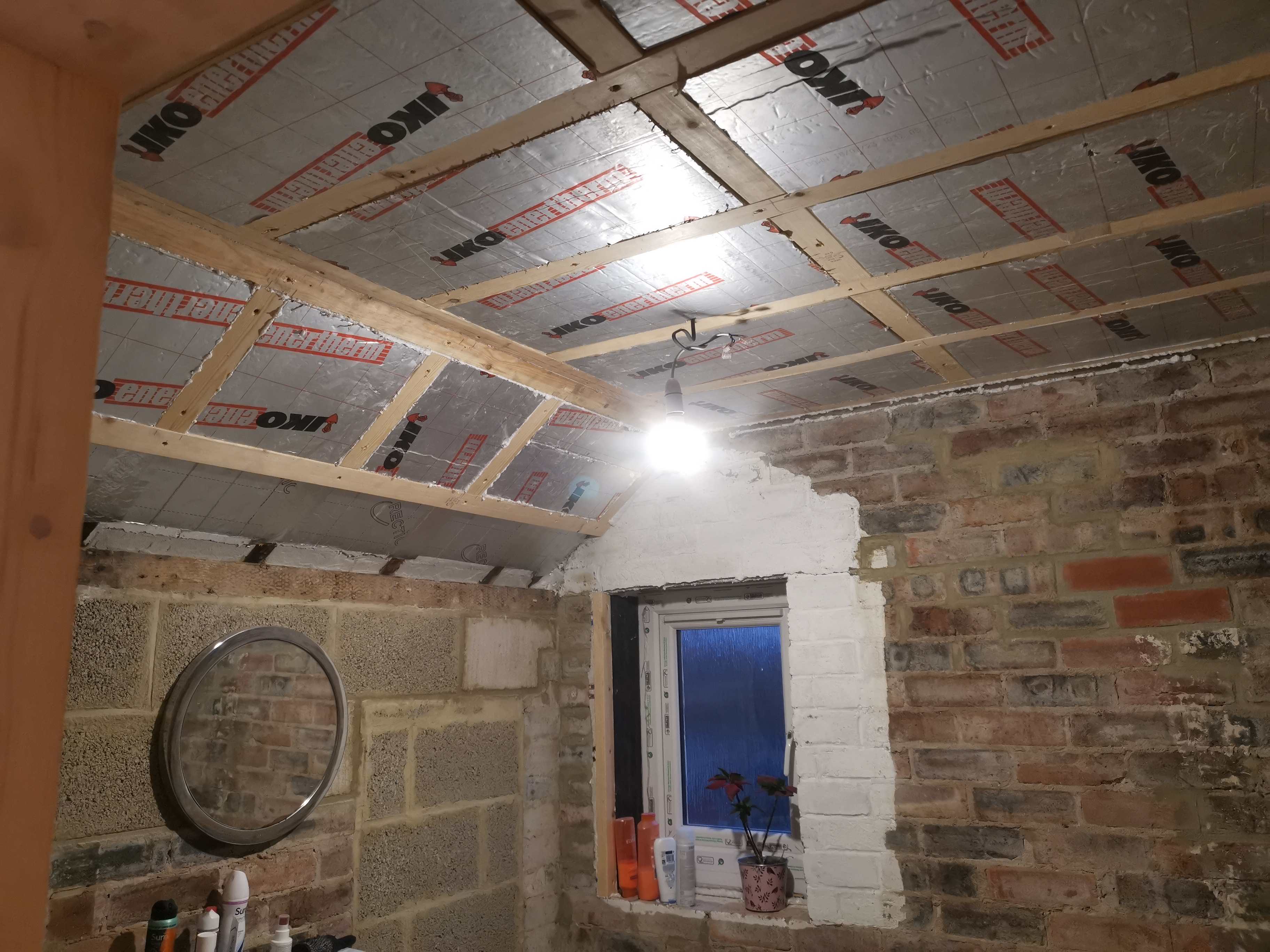

my bathroom ceiling (first floor) is a mess, looks like its been a separate toilet and bathroom at one point and then converted into a toilet, bathroom and corridor. Now its all 1 room the ceilings are all over the place so ive lowered it down with C16 to get me a level surface. Its got a loft above with fibreglass insulation between, plastering lath is still here, and its going to stay there as well as its manky above it.
My question is, should i fill this newly created dropped-ceiling void with tight fitting PIR and tape the timbers for my vapor control? The C16 is 38mm but packed out in places, often adding 25mm here and there to compensate the old ceiling, its that wonky. I could get PIR in there but it will leave dips and voids above it in places, any thoughts on mixed materials as i could pack it with 25mm fibreglass and then 25mm PIR level with the new, lowered ceiling timbers. Ceiling has a vent with an inline fan in the loft existing through the roof, room is small, 2.5m sq.

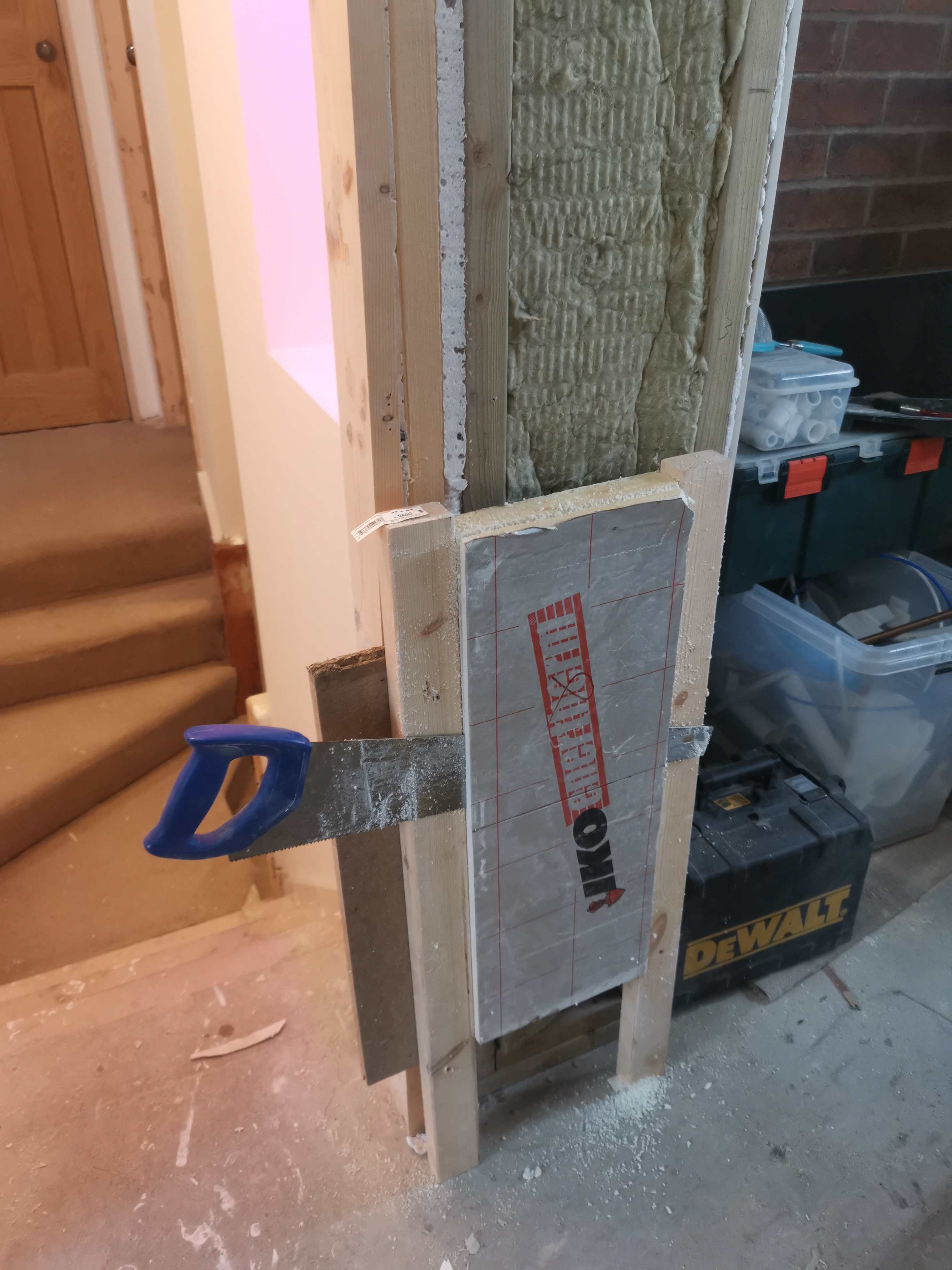

id have to take the plaster and lath off in places. I took it all off in the vaulted section and quite frankly im never doing that again in my life.
Ive tested cutting the 50mm between 2 lengths of timber and i can reduce the depth, but the question is should i, as id be losing the foil on the "inner" side.

Just to put this to bed, job done. Just need to foam it in and tape it up, which I can't do until we have chosen our light position. Cutting a board down it's depth is horrible, but it meant I got rid of the remaining 50mm stuff I've had hanging around for years.
Cheers Nick, onto the next thing.
Endless amounts of dust 😞
Now you've done the hard part, I wouldn't leave it too long before foam, tape and boarding over - you'll be surprised how quickly the insulation will bow now the foil has been removed from one side.
(Too late for you, sorry, but I'd probably have packed out the timbers with say 12mm ply strips and used longer plasterboard screws to avoid having to cut back the board depth)

its a fair comment.
But as i was lowering the ceiling already i didnt want to lower it further. In the scheme of things, 12mm probably would have made sod all difference, youre right.
