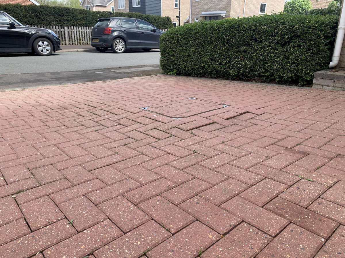

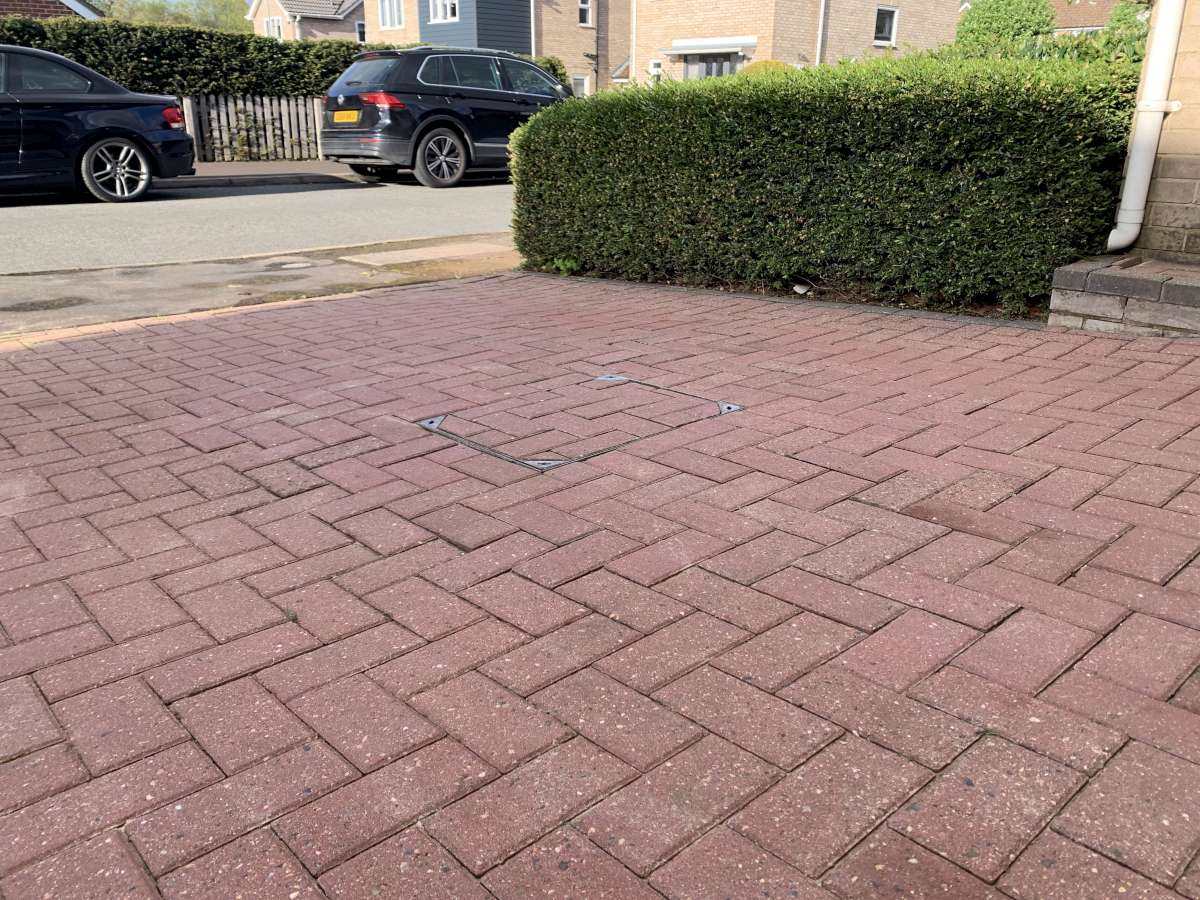

I had the drive brick-weaved about many years ago - but in the last few years the manhole cover seems to be rising out of the drive
Of course that's pretty unusual and I suspected that it was actually the area around it was getting lower but wondered how that was happening

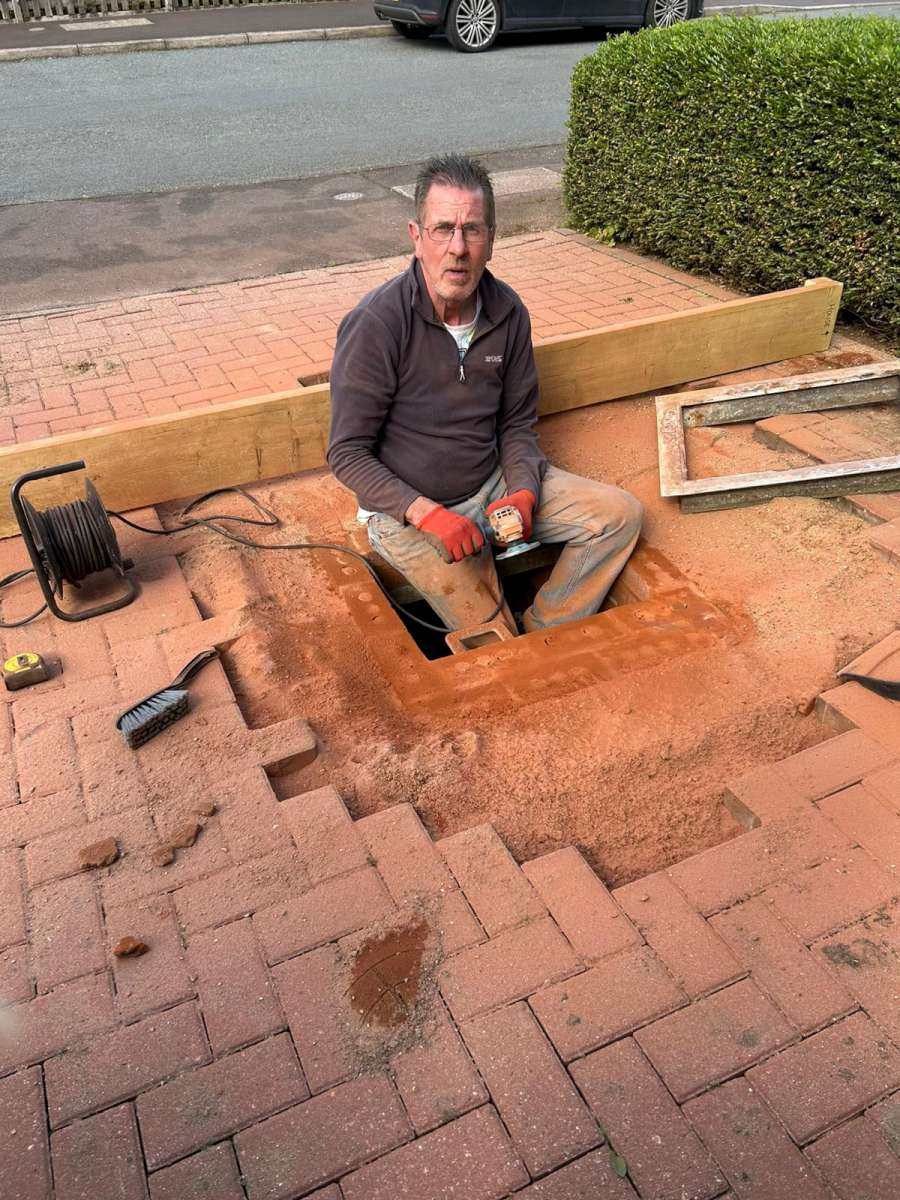

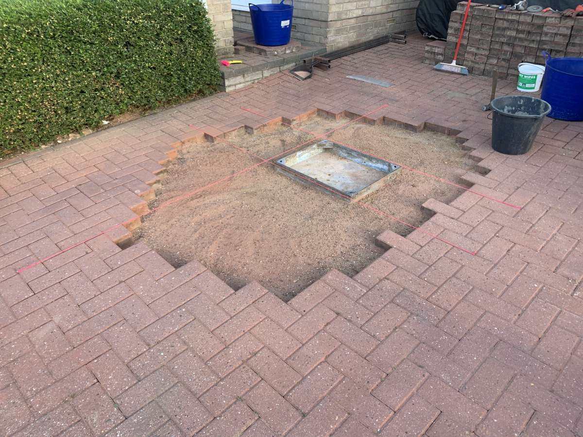

So I removed a load of blocks and then the manhole cover and found my issue - the frame was sitting on what remained of the original mortar a very uneven mess - bedded down on 4 blobs of silicone!!! FFS
So there was my smoking gun - the sand was being washed into the manhole when we had a downpour and there wasn't a car on top of it.
So I got the concrete grinder out and leveled the top off
Bedded it down on some mortar and threw the sand back in - a few sting lines to get the level and the pile of blocks can go back in
All done
