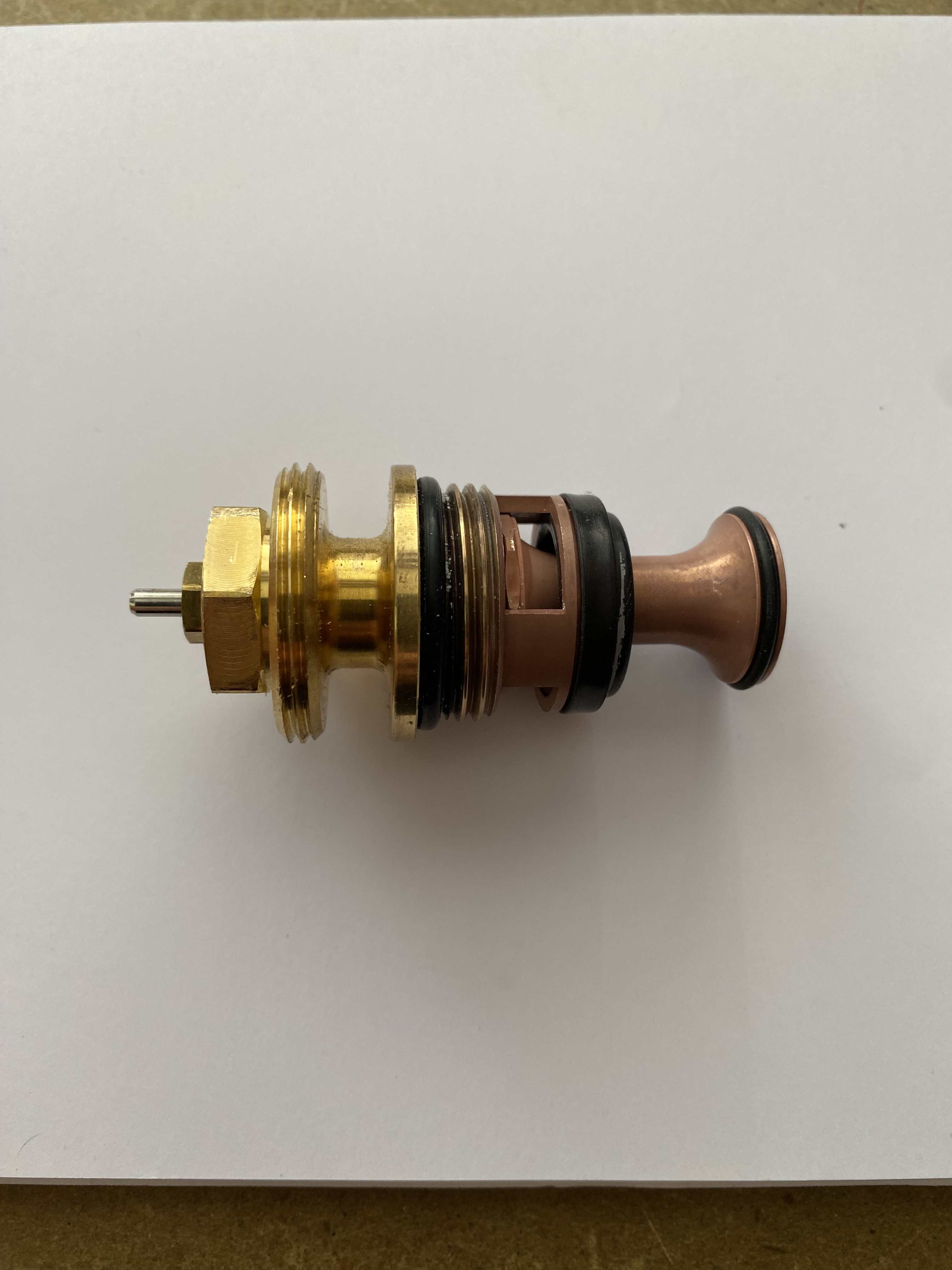

I've seen the Ivar youtube video which gives a quick view of the valve block internal mixer arrangement and I've also now removed the valve body itself. As far as I can tell it seems to work exactly as I'd expect and nothing appears broken or missing when I compare it to an online replacement part listing. I assume that it doesn't have any sort of internal wax chamber as the temp control os external to the valve (similar to a TRV)
It's the sudden change overnight from working to not-working that's stumped me.
Pic of valve attached.
Edited by Rob99

I've now removed the whole pump set. Pump looks ok internally, no sludge or other evidence of potential blockages. All passageways in the mixing valve block also clear. All waterways have a nice smooth finish.
As the only moving part within the valve block I have ordered a replacement valve insert as I cannot see what else it could be.

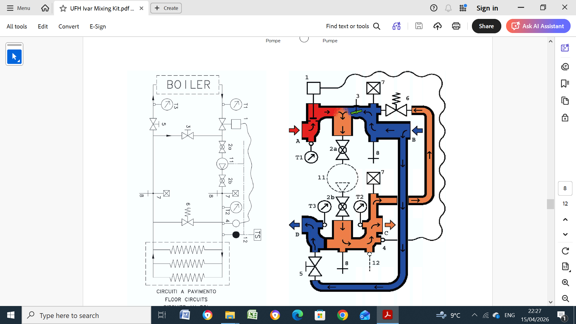

The MIs show the default mixing (Kv) valve set to 2.5 which "satisfies most demands", although your lower setting, assuming that the lower the setting the more closed off the valve is,would appear to leave less cold water to mix with the hot leading to a hotter mixed flow. MIs, if like yours, below.
UFH Ivar Mixing Kit.pdf
Edited by John Carroll
@Nickfromwales posted a shot of this replacement mixing valve in "Drop in Flow Rate" (2022) but didn't say if it cured the problem, it seems a very simple device and one might think that if the valve is moving up/down with the pin that the valve should be wide open to the hot flow with the actuator removed.

Fitted the replacement valve insert yesterday and everything seems to be working fine again.
Didn't seem to be any difference in the old and new valve but it's working so I'm happy.
