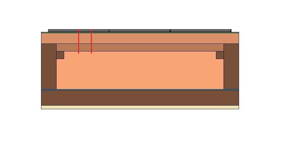

So the previous time I asked about my roof you guys helpfully established that unfortunately nailing into modern wood fibre insulating sarking boards is a non starter, but I've been loathe to give up the idea of externally insulating it's just so much more efficient and so much better for the building fabric in the long term, and it's also looking more and more like this roof will be at end of life within a few years anyway so if I need to go for a full reslating anyway that opens up some options. What I'm wondering from people with experience is firstly, how reasonable do you find BCOs to be in terms of a-typical buildups? Can they be persuaded if you demonstrate your solution will be safe and functional, or are they generally Computer Says No types when it comes to roofs? And secondly, whether the a-typical design I had the notion to build would even work in your better informed opinion.
My thinking is this: if the problems are that insulating sarking won't reliably hold a nail and that I can't make the roof assembly significantly thicker as seen from the street, can I add a substrate to securely hold the nails within the existing depth? Illustrated badly in the attachment, you'll have to forgive my terrible "plans" but MSPaint is about the limit of my artistic ability on computers. I'll list out what it shows inside(bottom) to outside(top):
  • Plasterboard
  • 50x50mm horizontal battens with 50mm wood fibre insulation batts between
  • Intello VCL membrane
  • existing 150x50mm rafters, fully filled with more wood fibre batts
  • wood runners fixed to the inside of each rafter along its whole length
  • 25mm marine ply fixed to runners and joists sitting flush with outer surface of existing rafters
  • 35mm Steico tongue & groove woodfibre sarking
  • vapour and air open waterproof membrane
  • ~8mm "heavy" slates with 75mm+ stainless or copper annular ring nails, two per slate centre & off-centre to prevent rotation
Result is essentially a solid assembly, thermally broken, three layers of water protection, breathable to the exterior at all times and to the interior in conditions that would benefit the roof but otherwise prevents transfer of moisture from interior. The slates are on top of insulated sarking, but the actual grip for the nails is provided by the marine ply sheets fixed between the rafters and supported by the runners. It would be a few millimetres thicker than the existing assembly, but so little that the slight ridge created by the necessary hidden splitting gutter would disguise it relative to my neighbour's slates. In addition to bringing the whole roof structure within the thermal envelope of the building, it would also allow continuous insulation over the whole structure with the exception of the front wall: you can't see on the image above but the stone wall is actually twice the thickness of the skew/coping and the whole area which in the illustration is a lead valley is underneath that sarking sitting on top of the bare stone of the rest of the wall, which would be a huge honking thermal bridge but with this approach needn't be.
Anyway enough blathering: am I on to something or should I just resign myself to insulating the whole property internally despite it being much less effective?

Ok I can see what you are trying to do, a few comments in line with your text which I've turned into italic.
  • Plasterboard
You horizontal timber battens on the inside introduce a repeating bridge. You can test this repeating bridge effect by using say Kingspan online calculator. I often use a continuous layer. But you need to check that the plasterboard can be fixed through the wood fibre on the inside.. it works for PIR.
Not sure about this. I would be inclined to use something impermeable like plastic.
This sounds ok in the main body of the roof and on paper. But around the roof edges, these are weak spots. leave the full fill insulation 10 -20mm shy of the underside of your ply just to let the water gas / moisture disperse. . I'm not going to to explain in great detail here but the principle of the sarking is to have gaps between the boards. You full fill is not compatible with your marine ply.. which is pretty impermeable.
Ok see that you are doing. But you have structural problems in terms of the edge distances of you fixings.
Now marine ply sounds great.. but trying to drive a long copper nail into this is not that easy.. ask an experience slater. Again it may be ok in the main body of the roof.. but you are going to have massive problems at the edges and any roof lights / service penetration.
Ok.. if you follow the manufacture's fixing detail.
Ok.. for now.
I would not slate this way on you job, rather I would adopt the traditional route. In Scotland as we do a lot of traditional sarking we do one nail in the head, every third course cheek nailed in the main body of the roof. This lets us maintain the roof easily. Commonly in England the slates are fixed to battens.
I think I can see your design intent.. but I very much doubt you can get anyone to build it dilligently. TYou design has technical  flaws.  In summary.. my advice is to say "I had a good go" but let pragmatism and budget cost prevail.

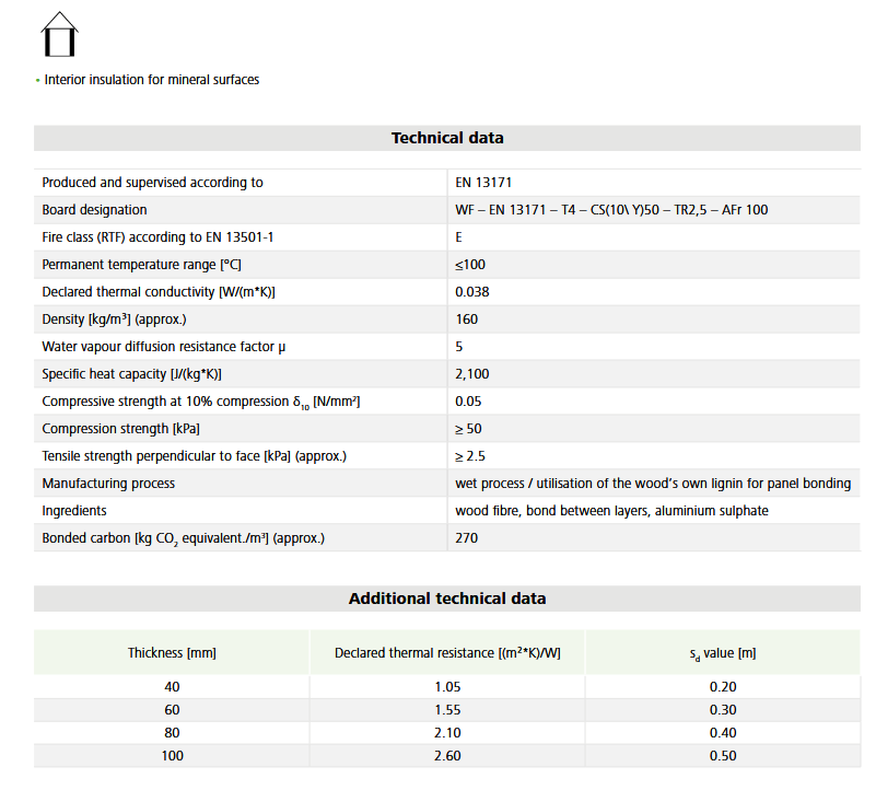

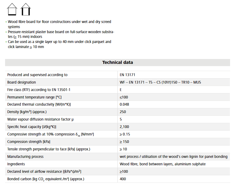

Regarding the internal battens - wood fibre batts are flexible, you need to set them between something, so I can't just fix the plasterboard directly atop them.
Yes they are. But so is PIR insulation. Below is the data sheet from Steico for thier high compressive strength insulation.
And below for thier internal insulation.
I won't go into detail about how SE's do the sums for compressive strength.. other than to say we do not use for example this value when designing as it squashes to much. For you the main thing is to look at the thermal conductivity of the two offerings. The higher compressive strength has a value of 0.048 W/(m.K) the lower (weaker insulation) 0.038 W/(m.K) which is about a 20% difference. If you remove the repeating bridges but even use the higher strength stuff you may get a better result. It's likely marginal.. but as I said before.. you need to look at the perimeter details, noggings etc and buildability.
